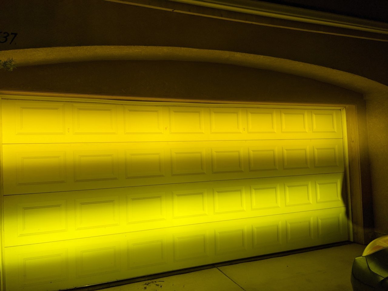

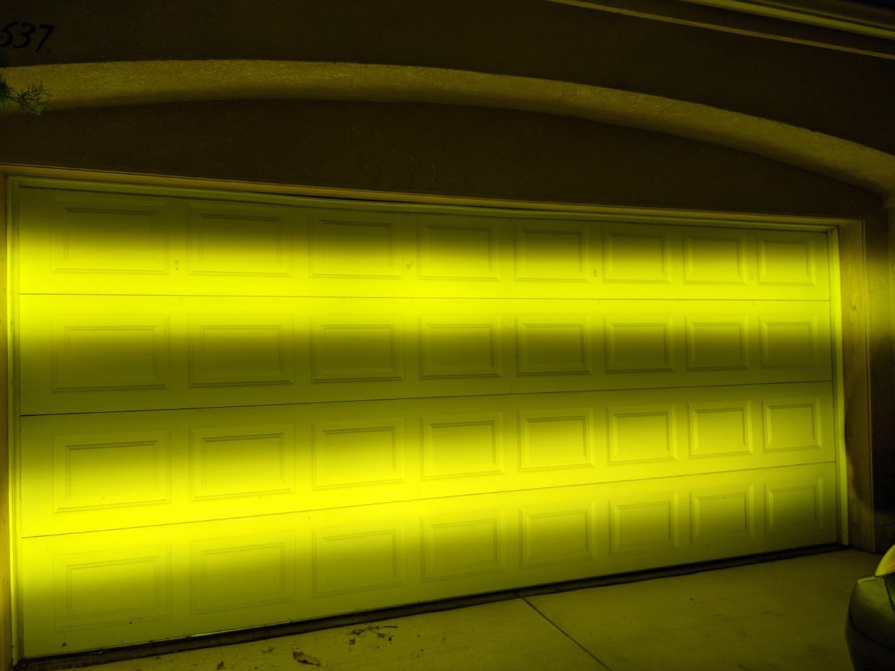

    This was a fun exercise, and I'm not sure anyone has done the deliberately wrong things I'm doing here. But, while I'm swapping lights and their bezels around, I decided to demo some different combinations. These images aren't exposure locked from one to the other, as my phone doesn't have native manual controls. But each compares two lamps at once, and the images are pretty close to what my eyes saw.
    First up, a stock yellow SS3 Max on top with a stock yellow SS3 Pro on the bottom. The two colors seem to be a pretty close match, and the difference in the pattern is apparent. The Max is definitely more intense and defined.
    Next up is the same yellow Pro fog light on the bottom, but the darker yellow Max optic installed on a Pro lamp above. The light is definitely more "amber" colored as you can clearly see, and I think it must have a drop in intensity as well.
    Finally, we have two SS3 Max lamps. The top pattern is the proper one, and it looks properly yellow as it should- nearly the same golden yellow that we're looking for (though they look different from one photo to the next because again, no exposure lock). The bottom is a lighter Pro optic installed in a Max lamp, and the result is a very pale, highlighter hyper greenish yellow.
    These are just for fun. It shows that DD really spent time dialing in the color for these Max lamps. I don't recommend actually using these as I did in this mockup, as they're likely non-compliant and frankly impractical (I don't think you can even order the Max yellow fog optic separately from the Max lamps, so you'd be spending a lot of money to do something dumb like this).
    My Pro lamps are eventually going to be repurposed as cornering lights, and the Maxes are going to adopt the bezels and fog bucket mounts from them. Looking forward to being able to dial these in and stretch the fog pattern further out!
    Edit: also forgot to add a note about warmup. The Max lamp definitely ramped temperature a lot faster than the Pro. I didn't let them stay on too long, and for subsequent tests I wasn't really paying attention due to heatsoak etc. But the first two stock lamps were switched on at the same time. The Pro slowly got temperature up, but the Max was WARM almost immediately and on its way to hot before I switched them both off.

    The difference with using the other lens is wild.
    To my eyes the MAX SS3's was something like 5-10% on the green side as shown.
    I feel as though unless you are able to have a direct comparison like this most people would hardly notice a difference.
