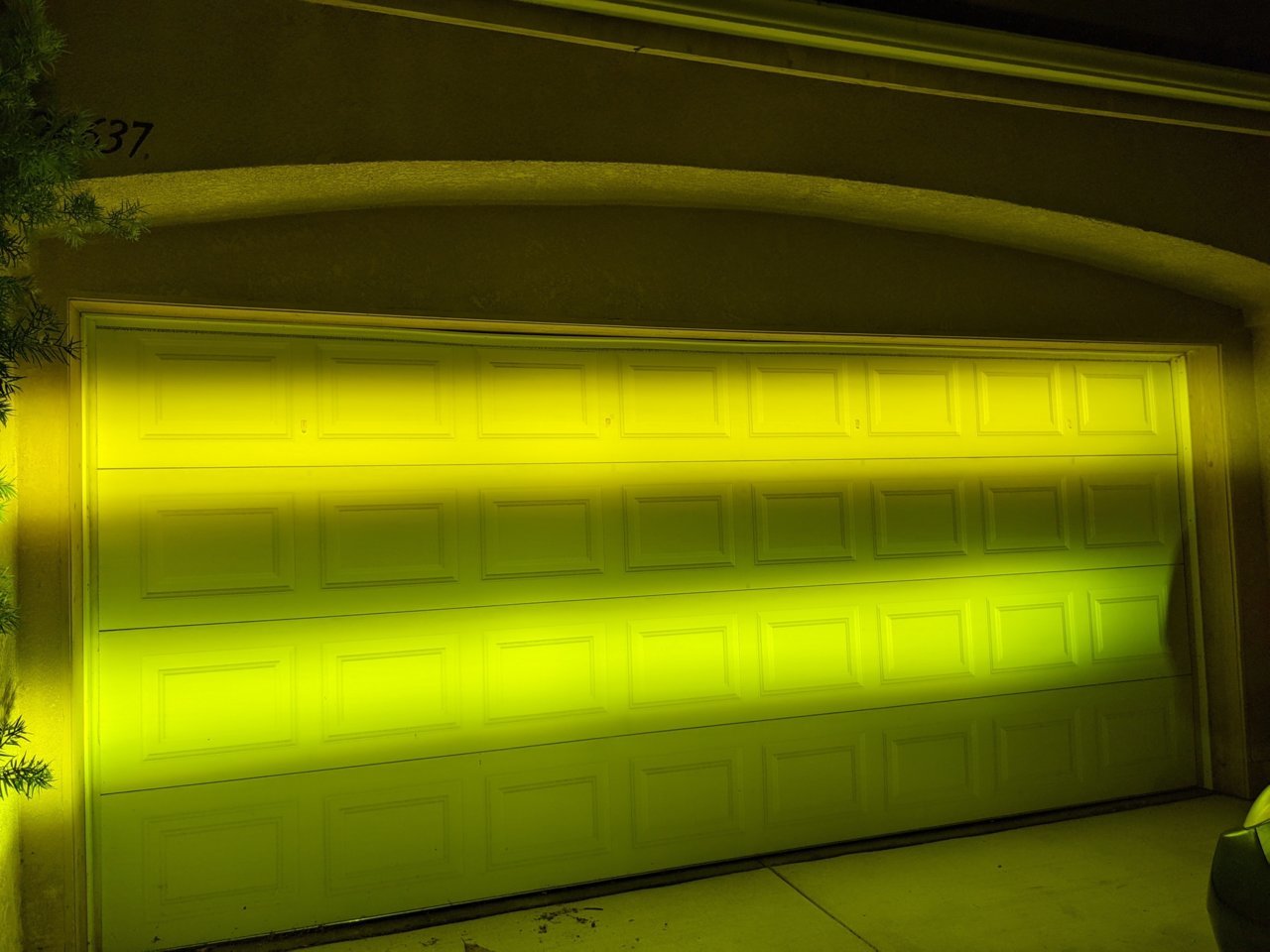

    So that is what the max driving would look like with the yellow driving lens on it, thanks for that comparison.

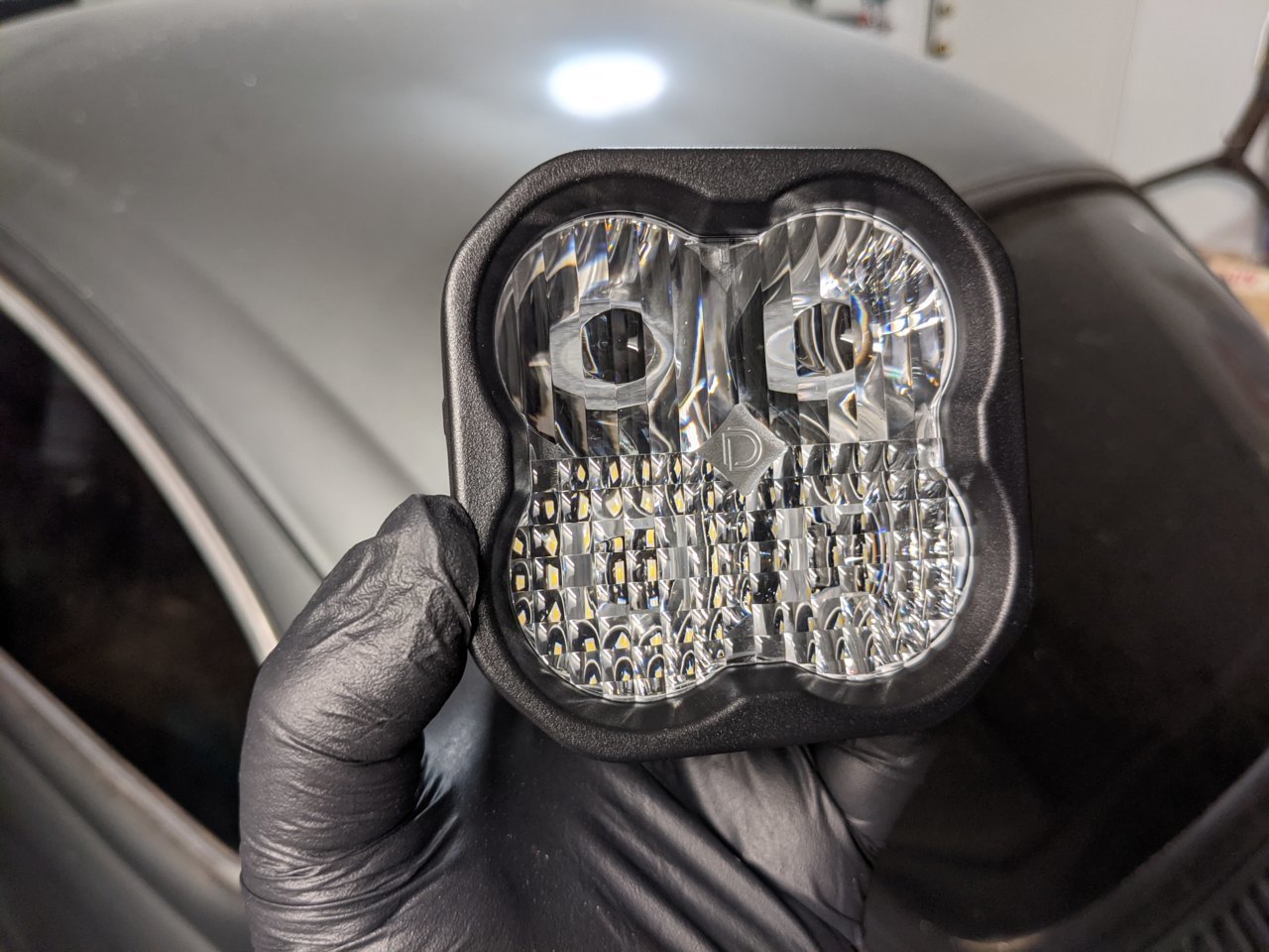

    Combo optic review here in post #3793.
    And it is compared to the driving optic.

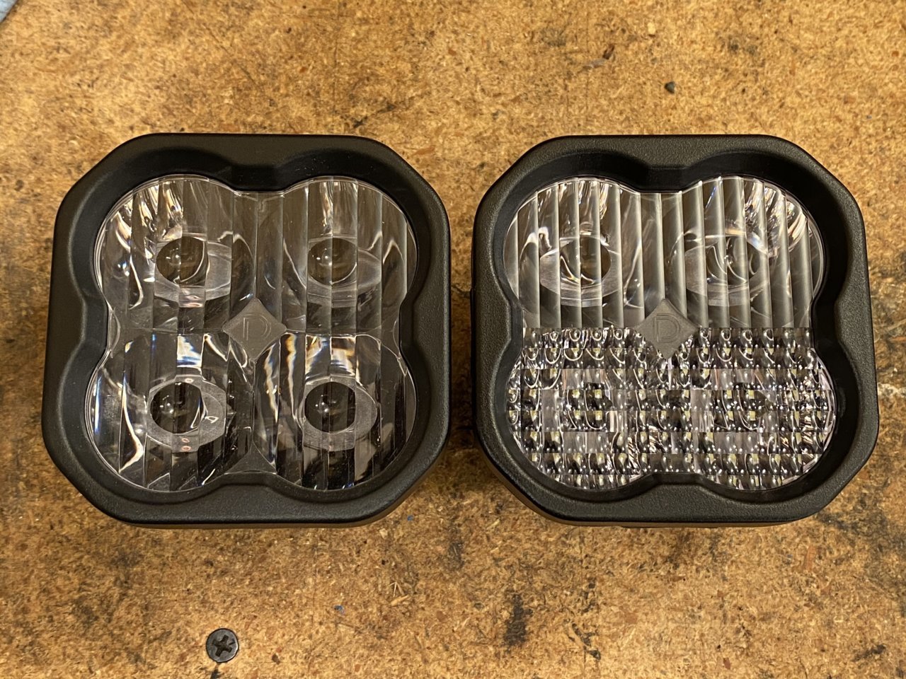

    Something that I didn't notice until recently is that the pure driving optic has fewer modifiers (columns) than the combo optic. Each driving chip has 6 full width modifiers in front of it, while the combo driving optic has 7. I'm assuming this is to make them more symmetrical with the corresponding flood pillows. As well as give a slightly bigger spread to the pattern for the combo (not as wide as a fog optic, which has many columns per optic).

    That's a good catch. I had wondered why the combo optic had lower intensity than a chopped in half driving optic would have resulted in.

    Great point. The data should have caused me to take a second look at the optic, being that with half driving one would expect the output intensity to be at greater than 50% of full driving, when that wasn’t the case.
