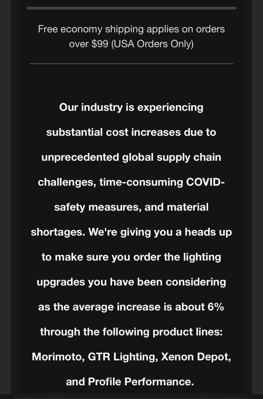

    Hey guys, just a heads up. Price will likely be increasing on many LED products in the future. Unknown when, but this is a screen shot from an email I received from Lightwerkz a few days ago. Get stuff sooner than later if you have plans for lighting. I know 6% isn’t a lot, but supply shortages are creating a lot of delays in many electronic industries as you have seen everywhere else that may affect availability. Plus many shipping issues don’t help things either. Just a friendly heads up!
    I don’t know how this affects @Diode Dynamics as they are built in the US, but I know electrical component supplies are hard to come by right now.

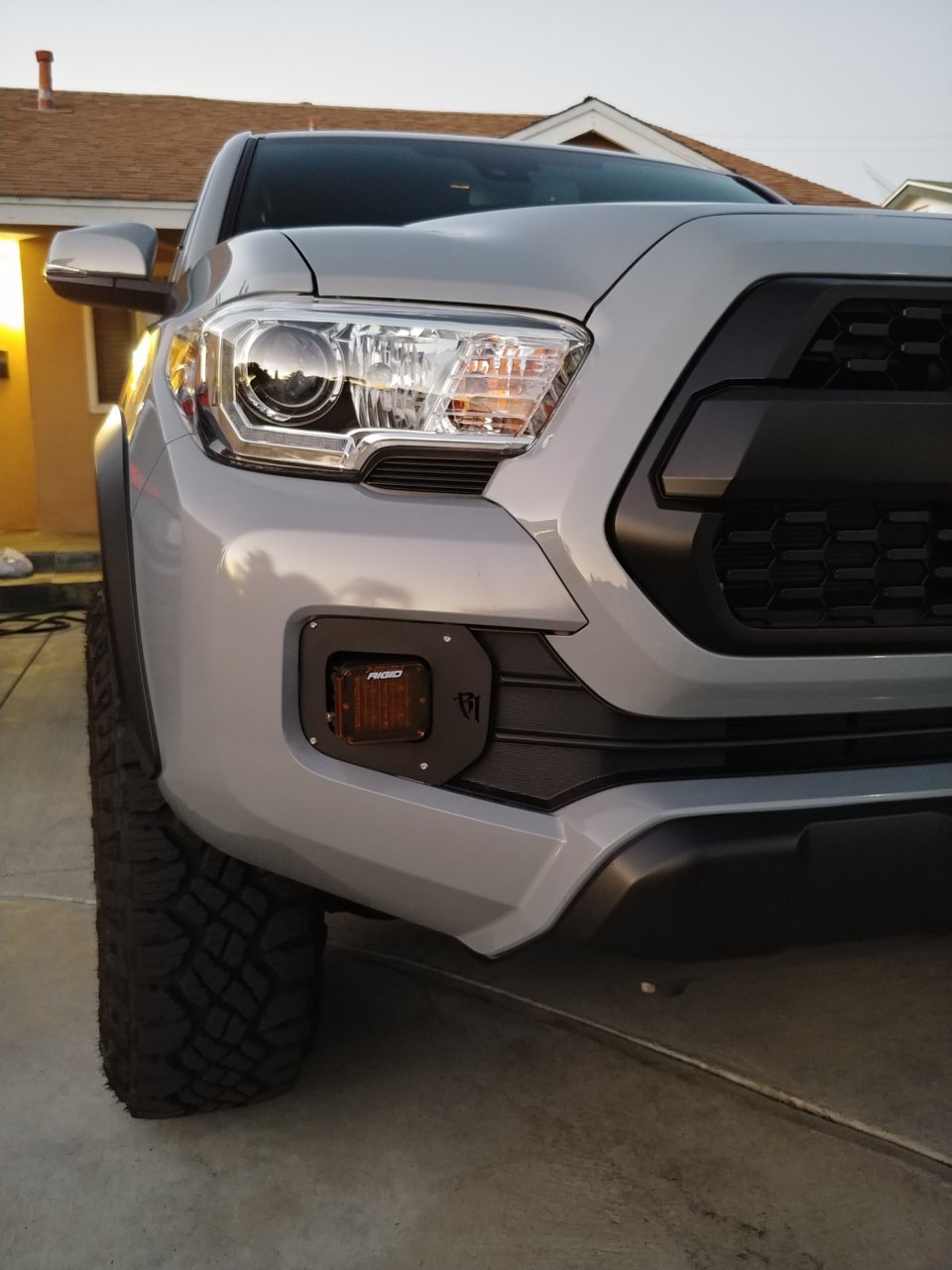

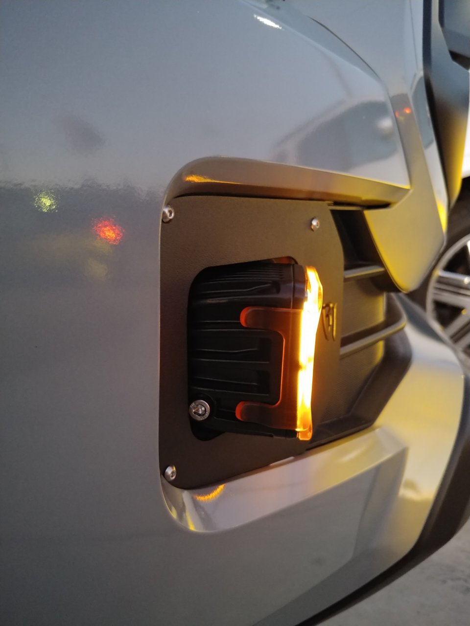

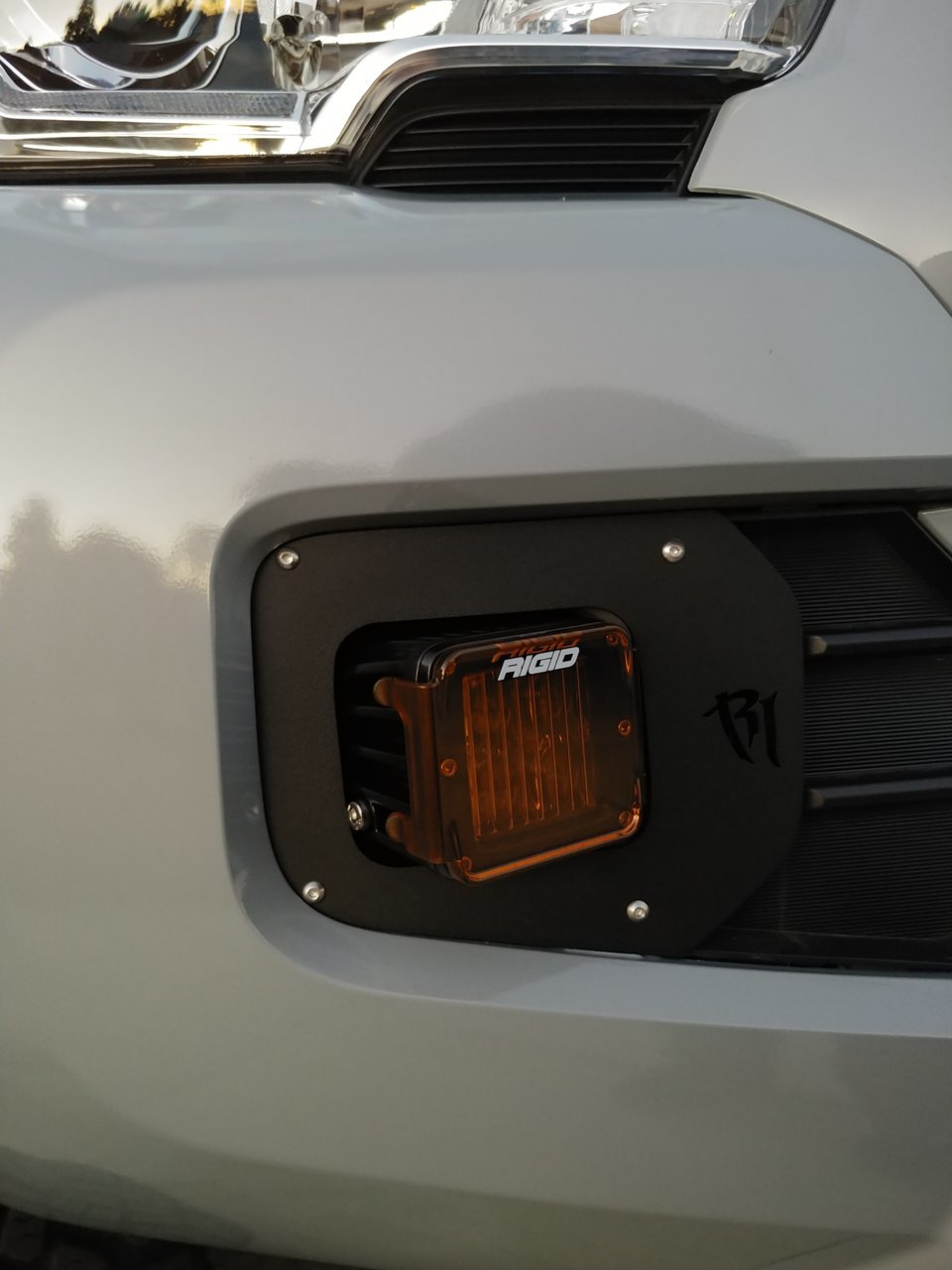

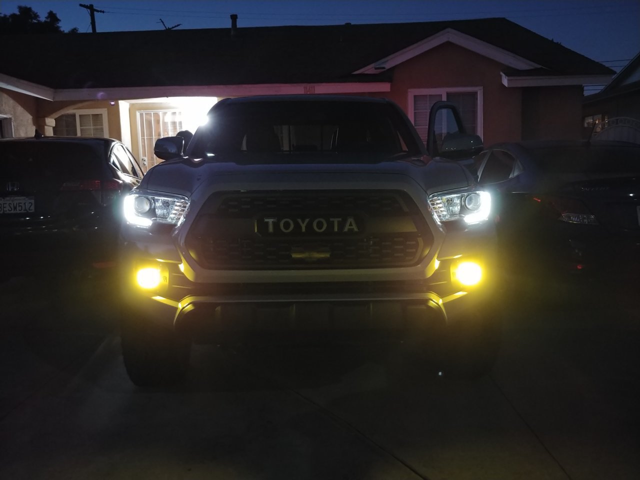

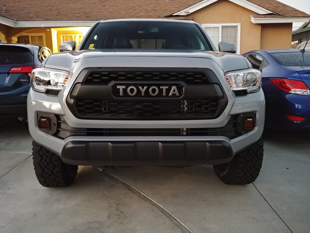

    Well. Here's digging up the past. Found this on a Google image search. Long of the short looking to do almost exactly this. Cali raised bracket and pods with the Amber cover. My googling was to see if they even fit.
    So. 2-3 years later - curious how you like this setup. I'd like to be able to relatively hot swap to Amber or white. Also - the covers are about 10 bucks and would protect the pods from general wear and tear so might last longer and easier to replace.
    Downside is - I have a set of the opaque black ones. Well. Had. They don't last in a car wash :spy: driver side yeeted into Oblivion so have a replacement set en route now and lesson learned - will remote for car washes :rofl:

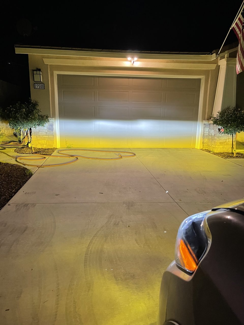

    Example:
    SS3 Sport fog width is actually too wide to even capture in the garage:
    vs LF beam on a single door
