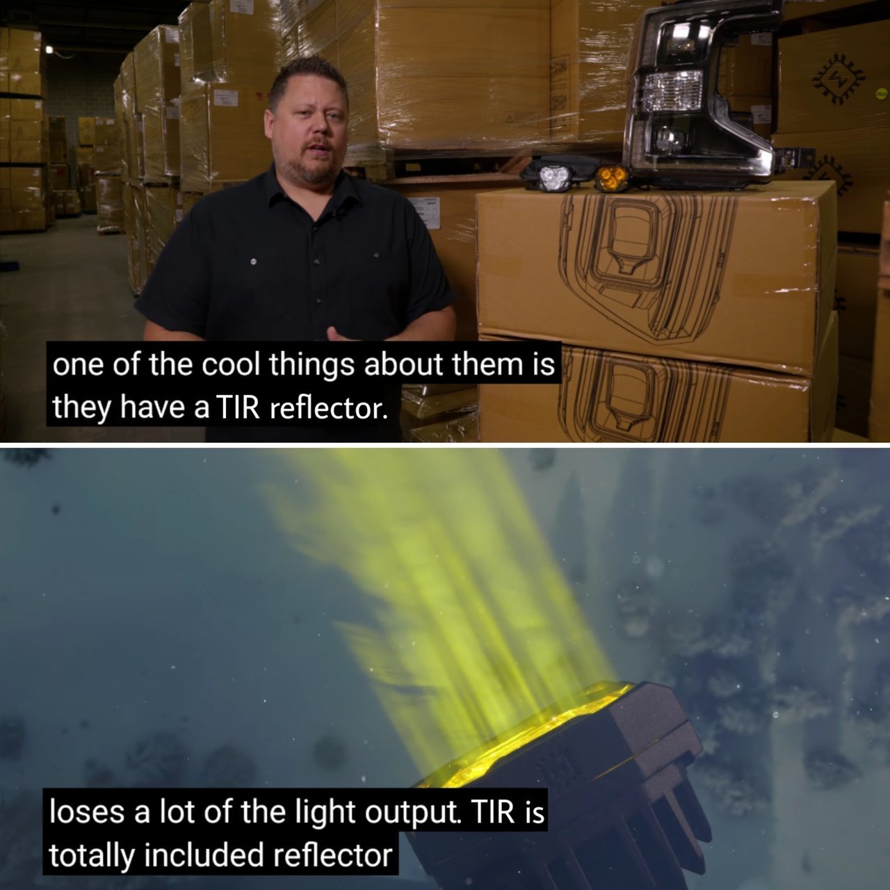

    Worse actually. They are a Baja Designs Squadron knock offs. They used to look nearly identical to the Squadrons. I actually reported this vendor to Baja for Baja to take legal action against them, looks like they updated the face of the lamp to make it look different. Bajas design wasn’t SAE compliant and required a design update. These knock offs do not appear to have the update. Knock offs are never as good as the real thing, and as a lighting enthusiast you shouldn’t support IP theft with companies trying to reverse engineer a product and offshore the manufacturing for cheap to China. Steal the design, cut all the quality and performance corners, and make it cheaper in China then try and sell it like it is the same thing, when it is anything but.
    See post #370 in the SAE J581 thread as an excellent example.

  13. Oct 15, 2021 at 8:49 PM
    #5293
    crashnburn80
    crashnburn80 [OP] Vehicle Design Engineer
    Jun 6, 2015
    #156893
    14,600
    Kirkland, WA
    2003 DCSB TRD OR
    Go Hawks!
    :facepalm:Video or it didn’t happen.

  15. Oct 15, 2021 at 8:53 PM

  16. Oct 15, 2021 at 8:59 PM

    memario1214
    memario1214 Hotshot Offroad Moderator Vendor
    Oct 1, 2009
    #23628
    19,807
    Colton
    Missoula, MT
    SOLD - 05 Dub Cab TRD Sport 4x4, CURRENT - '21 Tundra MGM Limited
    Yeah I saw that video earlier today… I really struggled with a lot of “points” made in it.

    Also- it really bothers me that its a three emitter lamp called a "4-banger." Just a peeve.

    Finally had a moment to watch the full video. For a "youtube influencer" it is amazing how they botch every technical lighting term in a video about lights as a claimed "lighting expert". Playcard straight out of Baja's book calling the new Morimotos amber, when they are clearly targeting a selective yellow chromaticity window. It is painfully obvious they have no clue what these terms mean. Also interesting is the dark color of the Morimoto selective yellow optic, doesn't look like they did any filtration optimization for selective yellow output like Diode Dynamics. Almost certain they stayed with the exact same emitters as the white pods and just put a heavier filtration optic on to achieve selective yellow, which will result in higher output losses vs optimizing with lower color temp emitters and a more efficient lighter color lens. Will be really interesting to review these when the time comes.

    “The brightest LED off road pods ever made, by anybody”.
    How much did Morimoto pay for this? There is so much inaccurate information vomited up in this ad, I can’t even help but laugh. Sounds like a cheap infomercial.
