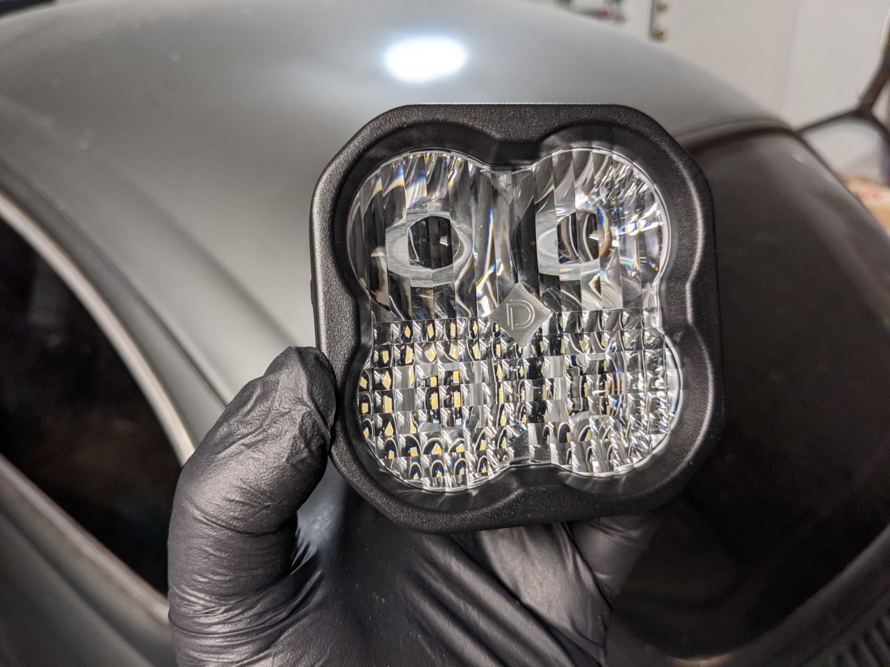

    This is what I'm doing with mine. I could sell the Pros as a blank kit, but not as direct fog light replacements because I kept the fog bezels, harness adapters, and mounting brackets so the Max lights were a direct swap in.
    I've changed the optics to clear combo and intend to use them as cornering/ditch lights (already have pro 4000K driving lights).
    My vote is hacking up the grill and using them as driving lights :D

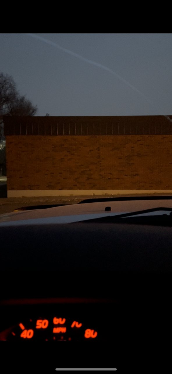

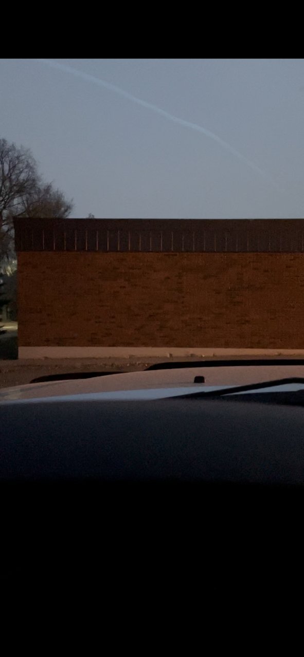

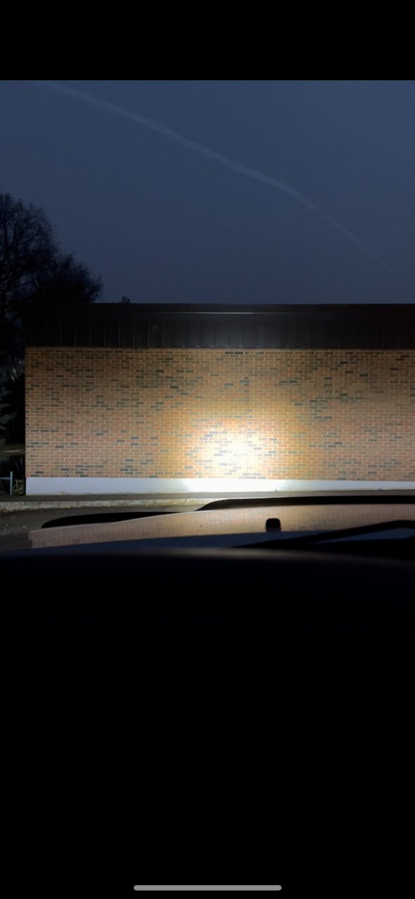

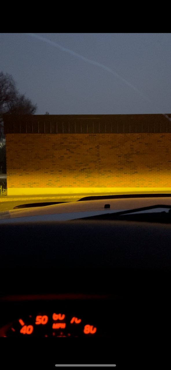

    Thanks for the info! So crazy lol
    I have definitely seen the difference between Rigid and Chinese, and wow what a difference!
    For me, especially at 18 back then, I couldn't justify the price difference for using the lightbar 1-2 times per month.
    I actually don't mind the output of my Caliraised. For me, I can see hella far.
    Here it is:
    Also, here are the DD SS3 Sports:
