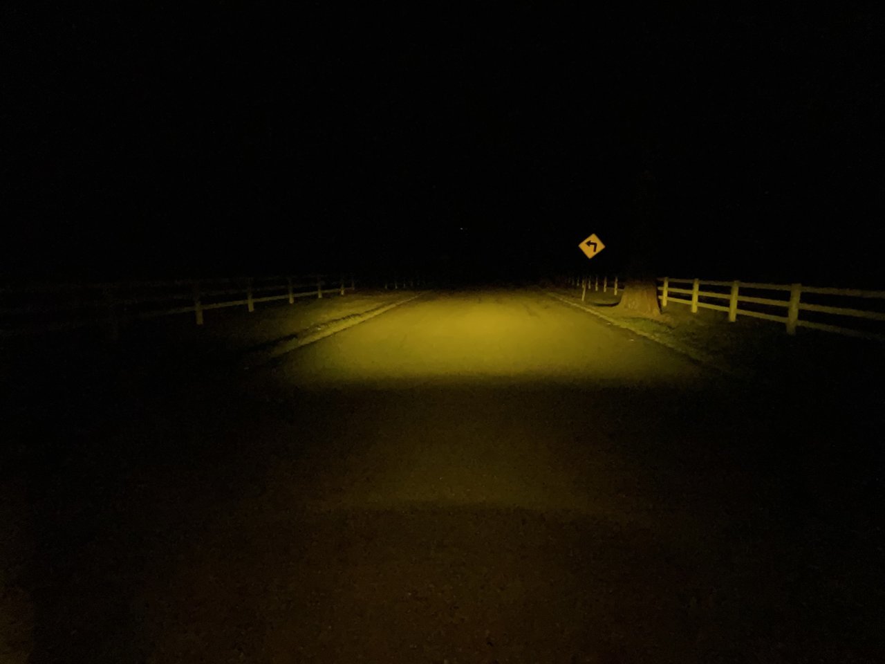

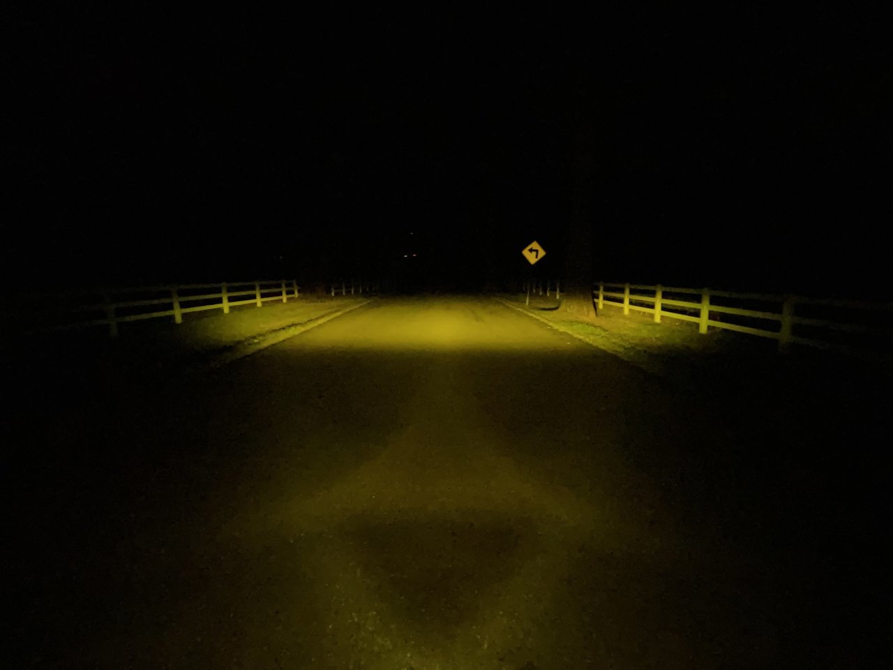

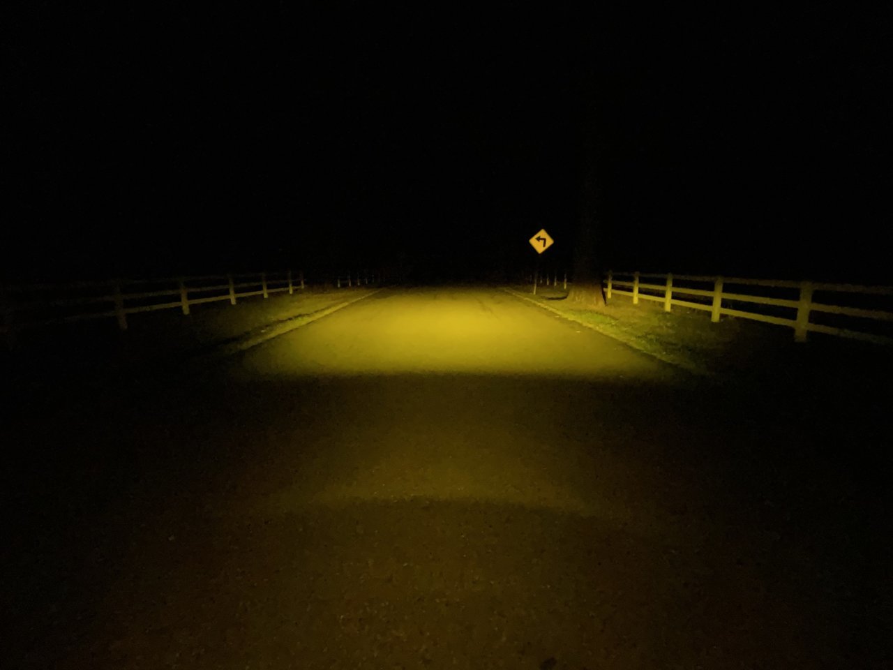

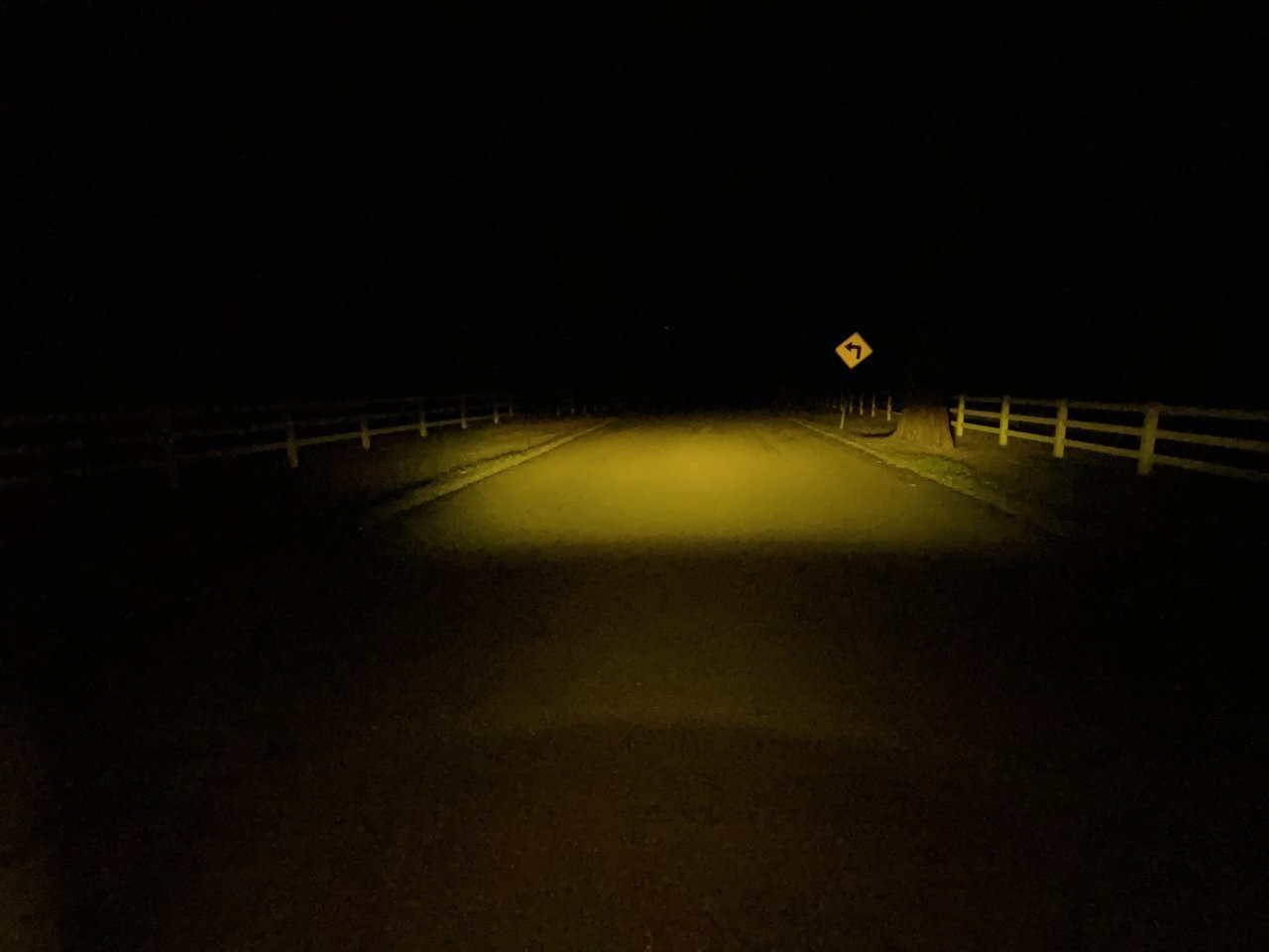

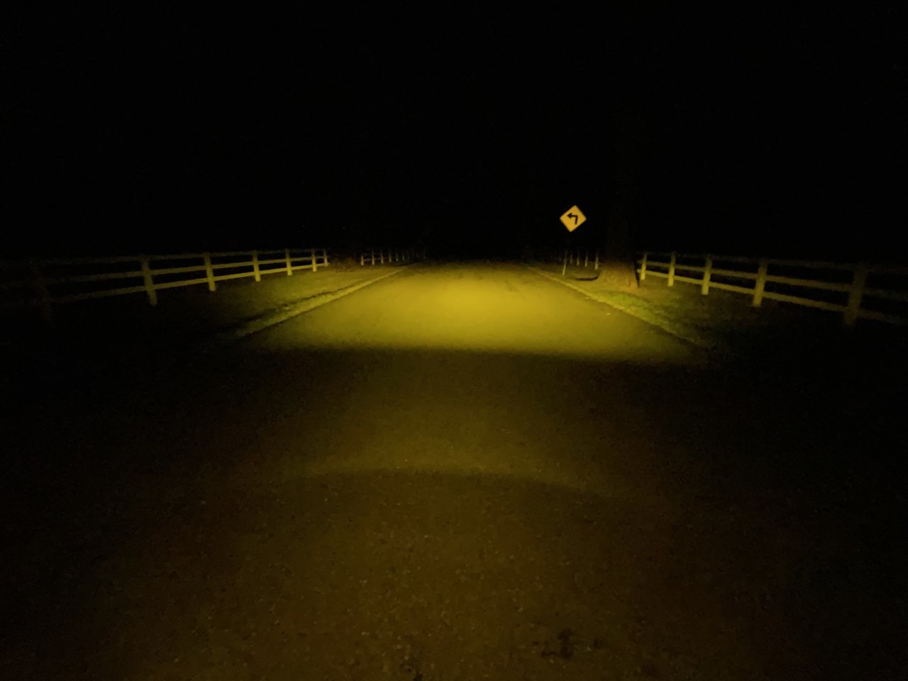

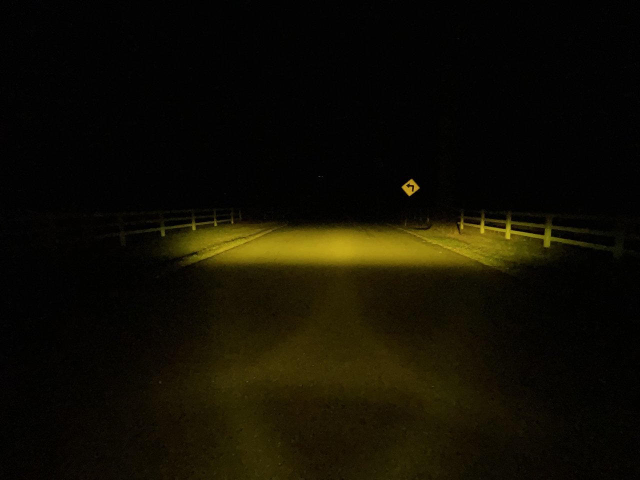

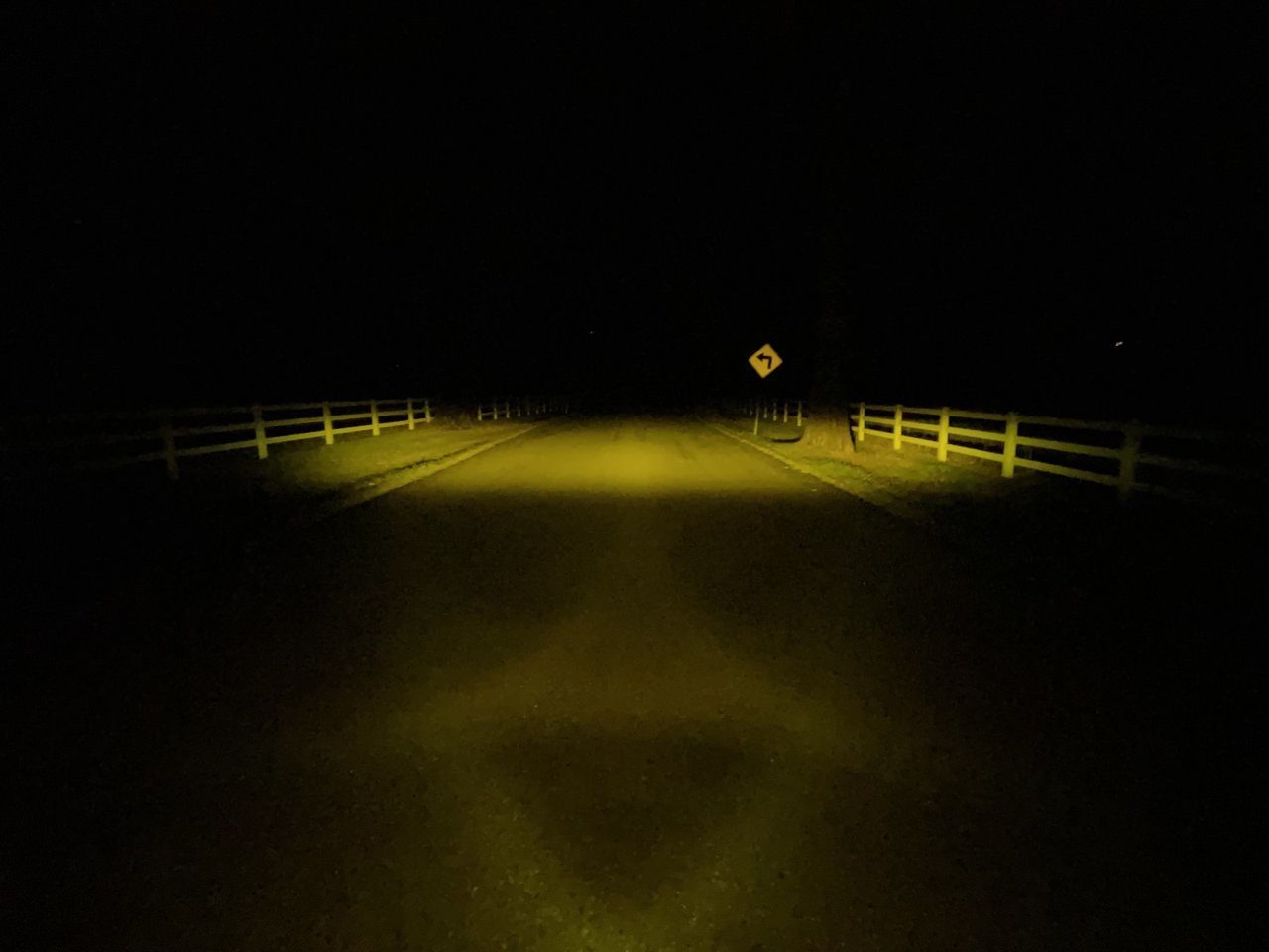

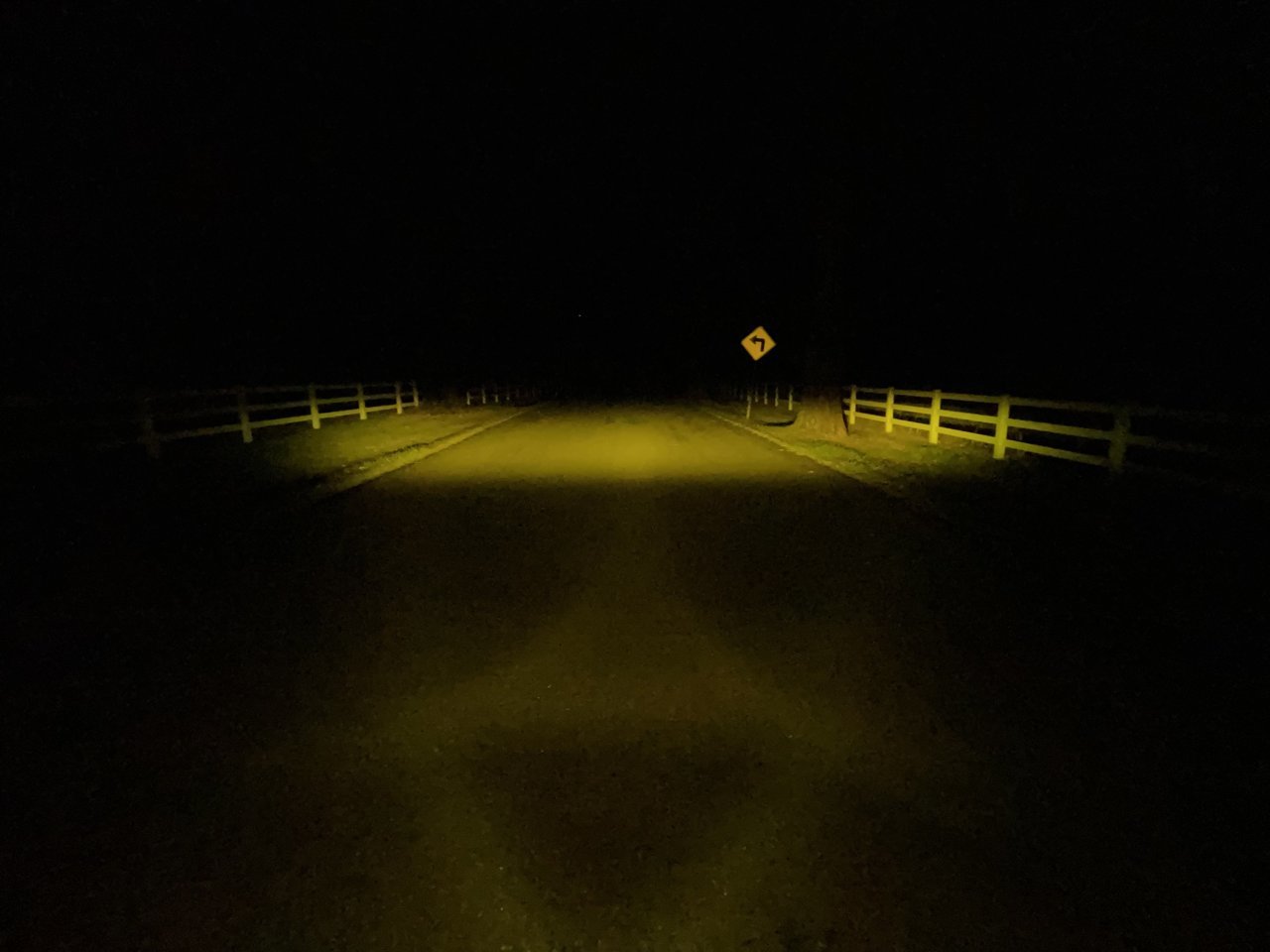

    Okay kids… here we go! Take into account I was just trying to eyeball the lights into the same spot by hand. There is NOTHING scientific about this right now. That’ll come later. Just trying to get something out there for you to feast on. What I did do is make sure all cam settings were locked. iPhone 12 Pro - 5500k WB - ISO 2500 - 1/30th. I’ll keep my thoughts to myself for the moment.
    Took 4 pics with each light. Two immediately upon startup, two after 15 minutes of constant on.
    SS3 Max initial
    6A44679E-7D28-41E8-A13C-E83B4B4518BC.jpg 009A27CA-B464-4D6C-AB3A-78395CB25C36.jpg
    4Banger Initial
    27D4622A-9912-4542-92EB-5A651D762ADE.jpg DEAA84AC-C914-4FBD-A7C6-06E843755BD1.jpg
    SS3 Max after 15 min
    031FADA7-E198-4B88-B0AE-A405D5A40DFC.jpg C112AD3A-4EC5-4E75-A87D-06613D201818.jpg
    4Banger after 15 min
    A4CEE406-B970-40AD-BCE8-B4EACAA4CAA8.jpg 6ADB34AA-863A-4002-8F2B-E6BB1837782E.jpg

    The purpose of a fog is to illuminate the ditch/shoulder for better slow speed navigation in poor weather, which requires a wide pattern. The 4banger isn’t nearly as wide as the Max, which isn’t as wide as the SS3 Pros. Though the 4banger isn’t technically a fog and not street legal. Looking forward to getting my hands on them!
    Hope you had gloves for handling those Maxes after 15 minutes! Those things will seat your skin off.

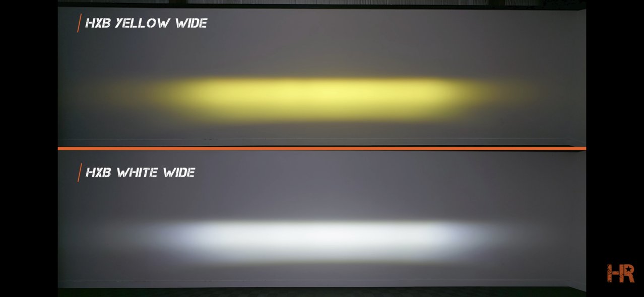

    Finally some pics/numbers for the fourbanger [insert: confused_woman_trig_geometry_equations.jpg].
    Very interesting product. Their numbers seem inflated compared to Crash's. Their testing has been called out before, for using a lux meter meant for halogen lightsources, not HID/LED spectrum resulting in inflated LED readings... Their comparison wall seemed a bit better suited to comparing the beam patterns, especially showing the difference in width between the DD SS3 and 4banger pods.
    Was also nice to see some comparison to other pods type lights. Crash's 2nd gen and 3rd gen headlamp testing comes into play here, in a roundabout way- larger optics are going to be more effective no matter the lightsource. If the 4banger offered significantly larger optics than the DD SS3 lenses, then I could see there being a much greater chance of them having higher performance threshold, and the same argument for those Denali tri-led pods. However none of these seem to offer an optic larger than what DD has spec'd.
    And it seems that the 4banger combo-beam is much closer to a mashup between the spot optic and their fog lensed one. I have asked DD previously if they ever considered designing a combo Driving/Spot lens, to allow their lights to reach a true middle ground between the pure spot or pure driving lens.
    Edit- just wanted to add, the HR video doesn't show/mention lux ratings for either 4banger model in yellow/amber Wide Beam.

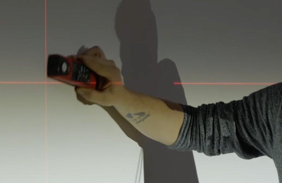

    A few notes.
    1) It appears they are actually using an LED calibrated light meter for a change, rather than an incandescent one. (Maybe they got tired of my comments pointing out the repeated blatant oversight). It appears to be a Triplett LT80 LED light meter, calibrated for white LED light sources only, meaning it cannot measure yellow LED output accurately.
    Edit: Hmm. No. Not the right meter.
    EDIT #2: WTF! See following post.
    2) "Our testing isn't scientific" (random pattern sweeps on the wall). Cringe. If you are not deliberately finding peak beam intensity scientifically, then it is just a crap-shoot where you swept the meter. Comparing two random samples of collection points isn't going to give you a scientific result, it is going to give you a semi-random one. And if the sampling is random, who's to say one pattern didn't get more attention to find peak intensity than the other.
    3) The 4banger width on the wall is clearly positioned to maximize the illumination area on camera. You can see on the right it is starting to fade right at the end of the screen. The SS3 products are significantly wider in pattern, but they cut off the right with no signs of fading, somewhat concealing the pattern width difference.
    4) Easy to see in the video that the 4banger products have a higher intensity hot spot in the center of the pattern. That isn't how a foglight is supposed to work, you want an even/uniform pattern intensity spread, as the important area for a fog is actually out to the shoulders. But what a hot spot in your 'wide' pattern does provide, is a higher peak lux number for marketing, even though that isn't beneficial for the purpose, nor is the pattern SAE compliant. You want a consistency high intensity pattern especially to the shoulders to actually help in poor weather conditions.
    5) "I couldn't get my hands on a Diode Dynamics SS3 Max Spot" [But the SS3 Sport spots are the best we tested]... L.O.F.L... They literally just showed the DD SS3 Max fog, and have the SS3 Sport in Spot. You just swap the lenses, which they are clearly readily aware of, that is a complete fib. What that says is we don't want to show those numbers, because the Max in spot is vastly superior to our product when we can't even match the SS3 Sport.
    6) Curious on how they got the yellow output measurements if they lack the proper testing equipment. Their yellow losses of 30% do sound very reasonable though, so I don't think they are attempting to be misleading there.
    7) They tout how much smaller the 4banger is in all dimensions, including the heat sinks. Smaller heat sinks means the product runs hotter which equates to lower peak operating output. Would be very interesting to analyze.
    8) Best part of the video was the swipes at Auxbeam and RC, people seriously need to check the idea those are serious lighting products.

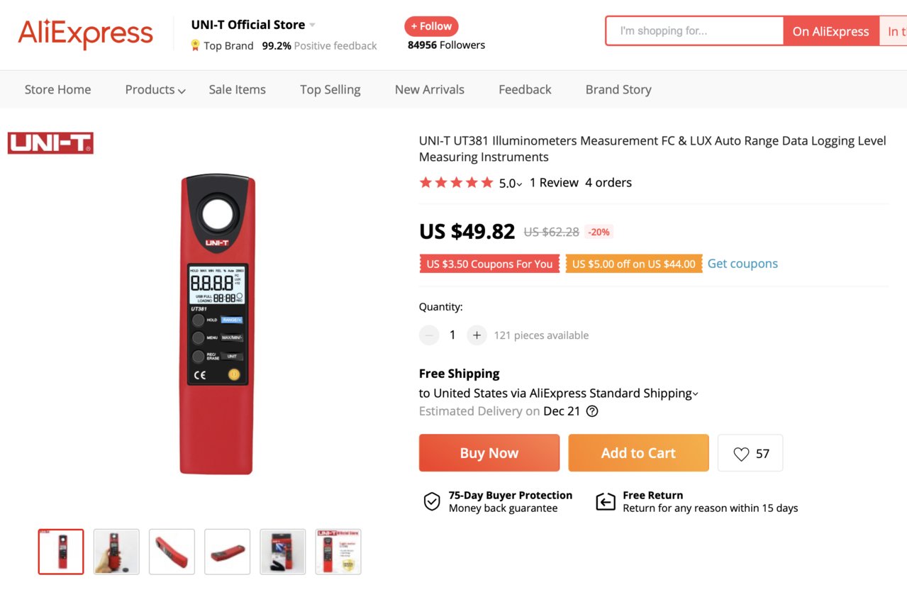

    For their highly professional video they are using an AliExpress light meter, that isn't able to measure LED light sources, it is for incandescents only. The meter is garbage and all measurements in the video are entirely inaccurate and not credible in the slightest.
    It just continually floors me how these guys are so incompetent.
