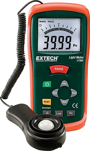

    Looks like the same Extech LT300 they've had for years. My memory says it's not accurate for LED spectrum but I could be wrong.
    9fMzDxD4CW-cIvZ0WUCDbOdEx6TL69ZLK3hEn4W2_4a55c067f12aa70181420fc62eeb66b90e03eb41.jpg

    Heat is a good and bad thing for LED fogs. I like hot fogs, so that in snow they won't freeze over as that is one of the use cases of a fog light. But with LEDs, the hotter a product runs, the more output is reduced so it is somewhat of a balancing act. 10-15 minutes is not adequate time to reach stable operating temp on the Max, it will be much closer than startup but really needs closer to 25 minutes. Uncertain on the 4banger. What is interesting though is that the video shows nearly identical peak intensity (very unscientifically) between the Max and 4banger, which is not inline with TRS/HR/DLG claims for peak intensity when they claim higher output intensity than the Max. It could be that when warmed up, the smaller body of the 4banger is less efficient at cooling and therefor the higher operating temperatures take greater losses in stable operating output. Hard to say really without comparing them first hand. Too bad in the video they don't show the beams compared in an un-obstructed view. Lightwerks is using an inadequate meter for LED, it is for incandescent light sources.
    It is not accurate for LED. The LT300 is a nice meter, I have one, but it is for incandescent light sources and not LED. It is way nicer than the cheap alibaba meter HR was using though.
    Extech LT300 (incandescent meter) vs proper Extech LT45 LED meter measuring an LED light source.
    And just to demonstrate it isn't the placement of the photo detector, I swapped their position:
    This is because the standard lux meter operates on the assumption the light spectrum slope is constant between sources, because all incandescent lights have almost identical relative linear slopes. But the spectrums are completely different between LED and incandescent. A standard lux meter will sample a small number of points in the light spectrum and apply a spectral sensitivity curve fit on the assumption that the spectrum is a linear incandescent slope and use this to calculate total lux. But the LED light spectrum is very different potentially throwing off this calculation depending on where the sampling points are measured in the spectrum, and what the LED spectrum curve looks like. Margin of error might be small or it might be significant, but the point of taking a measurement is to have accurate credible data.
    Measurements I've taken using a full digital spectrometer to show light source spectrum differences:
    (Anything past 700nm is just IR and not factored in lux.)
    You can see the spectral sensitivity spec chart from Extech for the LT300 below from the manual, and see that it the meter response is deficient in the short wavelength spectrum. If you compare that deficiency to the spectrum profile of the Morimoto XB fogs I posted earlier as a sample LED light source, you can see that that it is missing out on including a non-trivial amount of light output in the measurement from the short wavelength high amplitude spike. The LT300 is calibrated to light sources of 2800k as it is for incandescent lights, if measuring a source significantly outside of that color temperature, it will be inaccurate.
    All that said! While the incandescent light source spectrum distribution is very linear and predictable, the LED spectrums vary depending on the LED emitters used. However, while the LT300 meter readings will be inaccurate, because they are measuring two products using the same emitters, which in theory would have the same output spectrum (though the video implies they might not), they in theory would be inaccurate in each reading by the same percentage thereby providing a likely reasonable relative comparison. I still don't understand how all these LED companies don't use the actual proper measurement tools to do the job, like this is what they do professionally.
