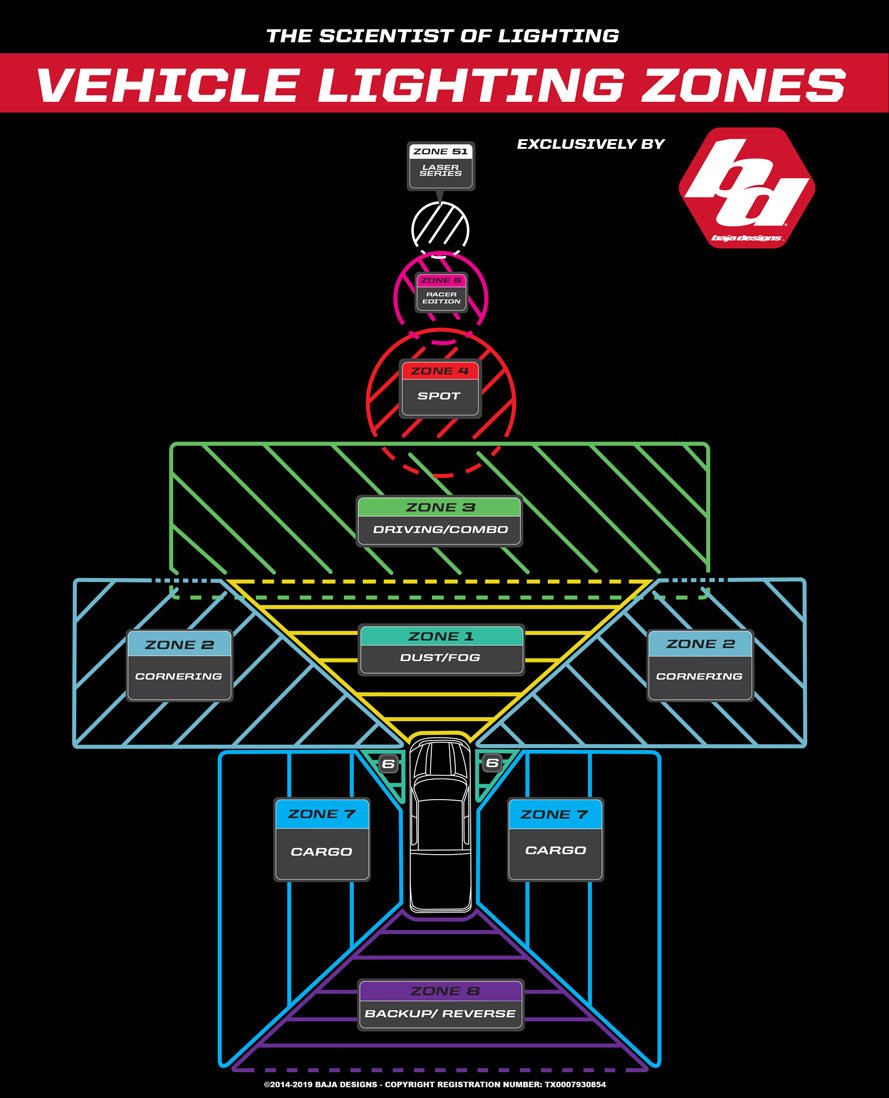

    This is the diagram I based my purchase off of. I don’t know how accurate it is to the pattern the WC have, but that’s the area I was wanting to hit

    Personally, I struggle with a "wide cornering" beam actually being that wide without actually mounting the light on an angle. In fact you might have to mount them as a ditch light to get that spread and angle. Let's see what our resident lighting expert @crashnburn80 has to offer.

    Good point. I believe the website said mount them at 10 or 12 degrees. I’ll see if I can find that.

    I think you'll find that an SS3 Pro or Max mounted in the fog light position (straight ahead) and maybe a flood pattern mounted as a ditch light would cover all of that area. Of course you could only run the fogs when driving on the street. The ditch / floods would be off road only.

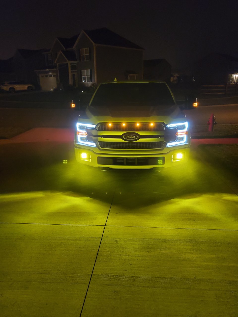

    I have the max yellow fog f150 kit, also max driving but they aren't mounted yet. Both from Mr memario1214 who treats people great.
    Thinking about putting the max driving here and dud a little mock up to check out the glare on hood. Not bad at all. There is a KDF mount to put 2 pods in the bumper but aiming them is supposed to be a royal PITA plus with adaptive CC you have to realign the radar sensor after removing the bumper.

    I have the wide cornering BD on my ditch brackets and they are angled outwards at least 10-12* to get that wide of pattern I still don't think it's that wide. Now after owning and having Rigid, BD, and DD I am looking to replace those BD with a DD product. I've been far more impressed with the DD products than BD.
    For woods riding all you need are some decent rock lights, good headlights and fogs, and some up on the ditch light area, maybe a set of the SAE driving lights. But that has been absolutely plenty for me any more and it's garbage IMO. Only thing I really want is to hook up some "chase" lights and some better reverse lights.

    Interesting. If I don’t like them as WC I’m glad I have the option to swap the lens for another pattern. The pros driving combo blew me away last night. Maybe the DD are superior, but I’m totally stoked on what I saw from the BD last night.
