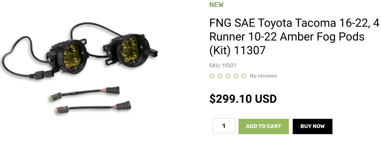

    Also, the 4banger is being priced at $300 and $500 for the NCS/HXB respectively, plus $75 each for model specific bezel kits (fog location). The direct comparison at those prices would be SS3 pro and max, and I'm just not seeing the value proposition there. The NCS is maybe comparable to the sport spec in terms of output, but are priced nearly 70% higher. And the HXB shows much less stable output than the max for the same price, and they've presumably saved at least 25% on the cost of chips. The fit kits are twice the price.
    I'm seeing a lot of "copied homework" (pay us the same money) without "showing your work" (stable output and optic refinement). These either have to improve substantially or become extremely aggressive on pricing for them to be relevant.

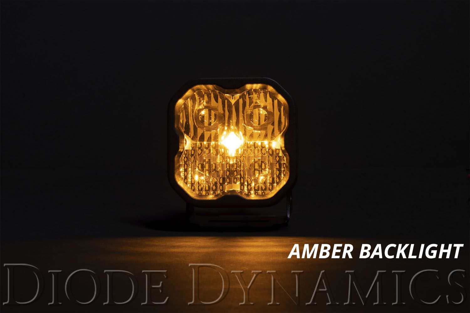

    Are there any examples of what the SS3 fog lights look like with and without the backlight? Is the backlight on even when the fog light is off?
  5. Nov 23, 2021 at 10:38 AM
    #5545
    paranoid56
    paranoid56 Well-Known Member
    Jul 25, 2012
    #83443
    3,444
    San Diego
    14 double cab taco
    this is what it looks like with the back light on. you would need to wire it to come on.
    light off.
    crashnburn80[OP] and Toy_Runner like this.
  6. Nov 23, 2021 at 1:01 PM
    #5546
    ShermanOhio
    ShermanOhio Well-Known Member
    Sep 22, 2009
    #23170
    59
    So if they are off (just hooked up normally), there is no difference from afar?
    I don’t really want them on unless I turn them on. This would just be cosmetic when the fog lights are switched to on then?
    Thanks!
    Edit: never mind, I think you meant these run when the fog lights are off but have to be wired specifically to do to. The only plug and play option would be the standard fogs without backlight?
  7. Nov 23, 2021 at 1:16 PM
    #5547
    paranoid56
    Jul 25, 2012
    #83443
    3,444
    San Diego
    14 double cab taco
    yea, if you wired them up to the stock fogs that backlight feature wouldnt get used. so would be on when your fogs are on and nothing on when its off. this is how i have my DD fogs wired up also. I actually never wire that backlight lol
    crashnburn80[OP] likes this.

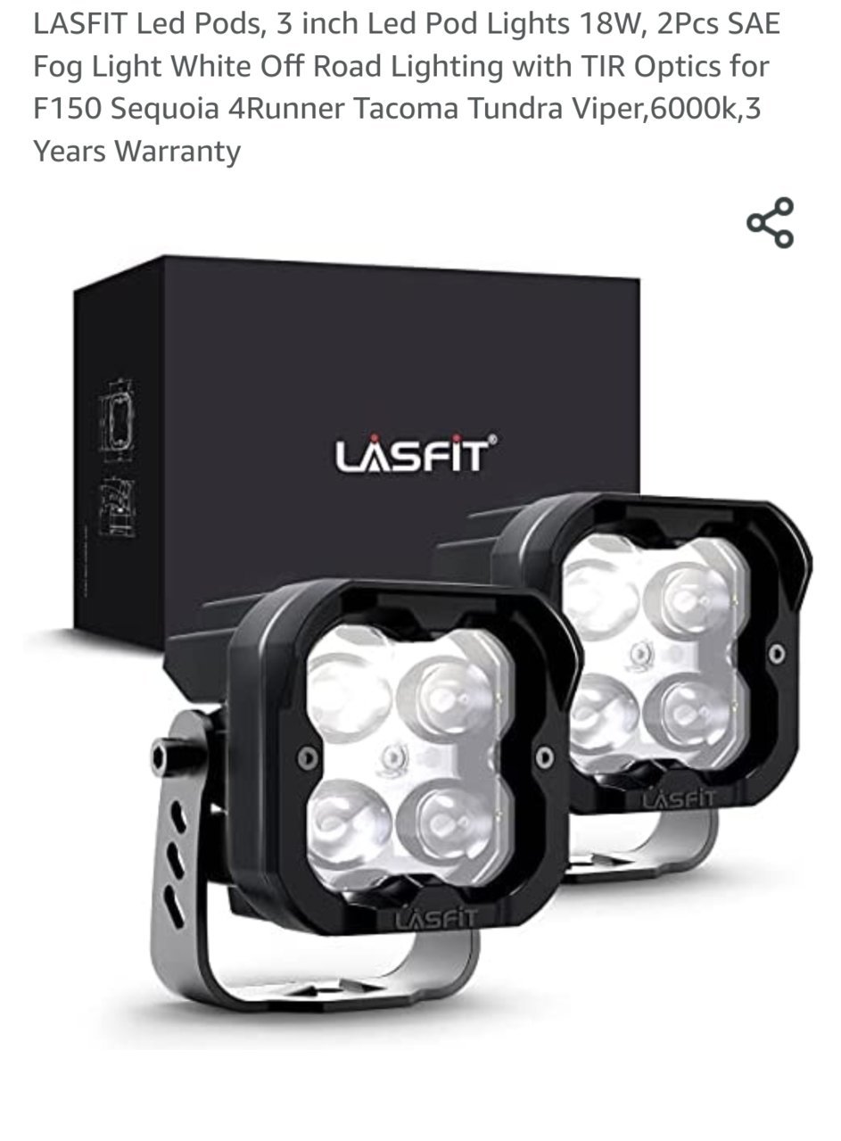

    That oval optic looks to be very similar to the LasFit pod lights "fog beam" optic. Rip off of a rip off, or rebrand of a rip off?

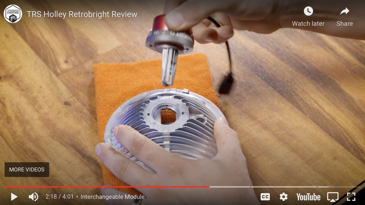

    Also, because the SEMA coverage of the morimoto Retrobright lights seems contained here, TheRetrofitSource has another video up about them. More details on performance. The lamps are built around a replaceable LED bulb (which isn't necessarily bad, given they have the opportunity to design the reflector and lens for the lightsource, rather than shoehorn in a functionally out of focus bulb). Highbeams look terrible. Blotchy and streaky.
    https://m.youtube.com/watch?v=Mbxi8rNFrsk

    I knew they looked familiar but I kept thinking of the Denalis. You are right, they do look very similar to Lasfit. We saw what a train wreck those counterfeiters were, covered in post #370 here for those that missed it.

    I really like the general concept of this product. However having removable LEDs will make them not technically street legal. Seems like a poor approach in general, every legitimate headlight manufacture makes these same sizes as complete sealed LED assemblies, it is typically only the cheap low quality ones that sell them with removable LEDs. It would be interesting to know if the optics were specifically designed for this replacible LED unit, vs using a generic optic. Screen shot below shows a very unique tri-directional LED. With screw mounts it seems like it could be proprietary and not a generic optic, and not using a generically replaceable LED. Very disappointing. This product could have been executed so much better. You are not going to get the performance out of a shallow mount reflector headlight using a replaceable side-firing LED, regardless if the optics are optimized for it. Pretty easy to study Truck-lite or KC reflector optic designs for how to do this the right way, by reverse firing the emitters directly into the reflector for maximum intensity and focus of reflected light. Also interesting that they opted for a plastic lens on a classic car product instead of glass.
    This could make for a fun comparison test in a 200mm lamp for 1st Gens and classic Toyota pickups (I had a few), and pit these against say a Hella H4 lamp upgrade with some stock wattage performance H4s. Hmm. TRS would have you believe in the video there are no sealed beam upgrade options available for these types of lamps, and that simply isn't the case at all.
