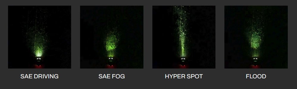

    I'd be hard pressed to say there's any difference between their fog and driving beams. Maybe fog is different in China? Having been there though, I can tell you it's pretty much the same.

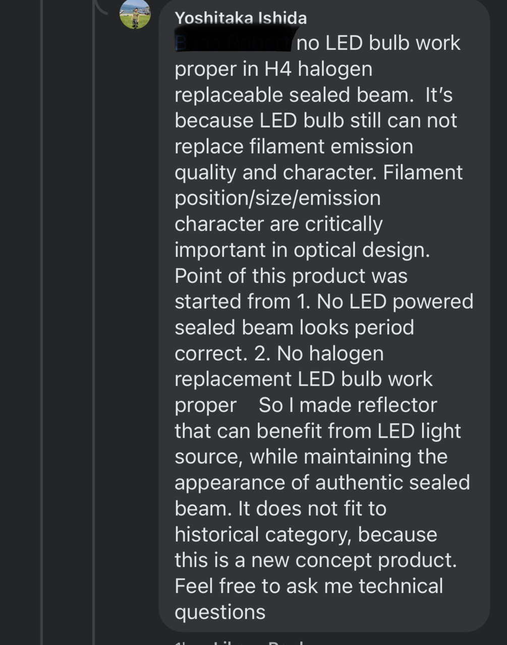

    Not SAE fog related, but because the new Retrobrights were discussed here I thought I’d share a comment from the products designer from another group when asked why they didn’t make it use an H4 style LED. It sounds like the optics are uniquely designed to the specific proprietary LED light source. I’ll have to get my hands on some.

    The words contained in that statement should be required reading for anybody considering slapping drop in LED bulbs in their factory housings. Pretty much exactly the opposite of all of that marketing BS that states "Product X (and Y, and Z) have solved the problems of early LED replacement bulbs by duplicating the location of their LEDs to the incandescent filament."

    Yes but that logic would run counter to the bulk of the products they sell :rofl:

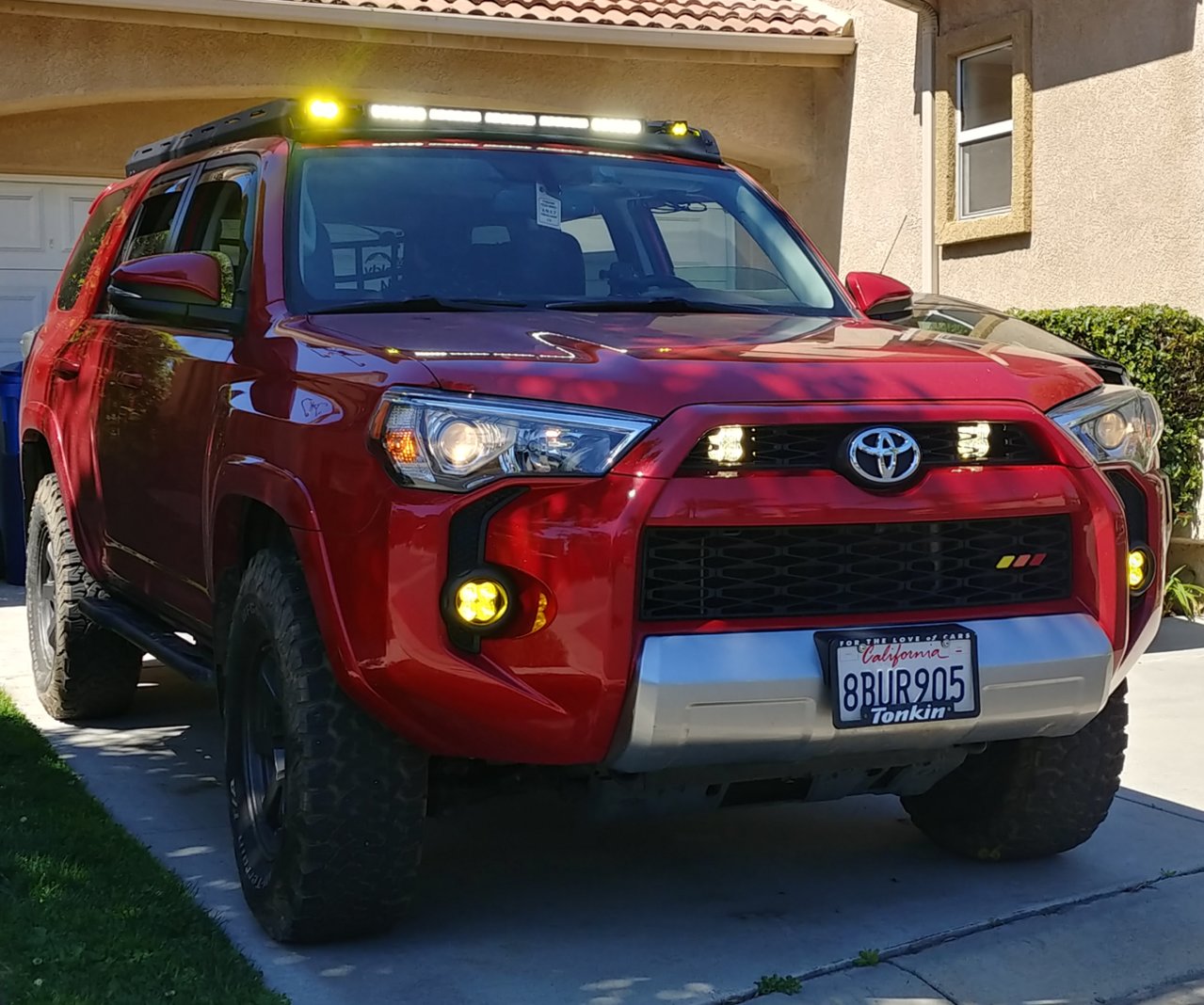

    How do you plan on aiming them? If straight over the hood, I'd stick with the driving only optic. If angled off to the sides, I'd go flood for low speed work or combo for a good mix of cornering and fill lighting.
    Color is up to you. I upgraded my yellow pro fogs to yellow maxes, and therefore had an extra set. At the advice of @memario1214 , I went with clear combo optics for 4000K cornering/ditch lighting (also matches my driving lights). The extra 10% of output over the yellow optics makes for a better punch.
    I'm still debating about where to put them. Easiest place is on traditional hood mounts, but I'm trying to decide if I want to redo my brackets so they can be placed next to my driving lights in the grill.
