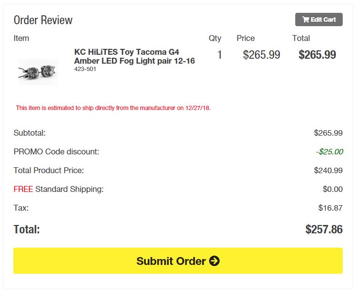

    This is the cheapest I've found them, but not shipping until around 12/27.
    I'm going to wait on Baja Designs to see what they come out with, since my original order of Squadron Sports was cancelled and being returned now.

    Yep, that's what I was trying to pay for them through KC (265.99).

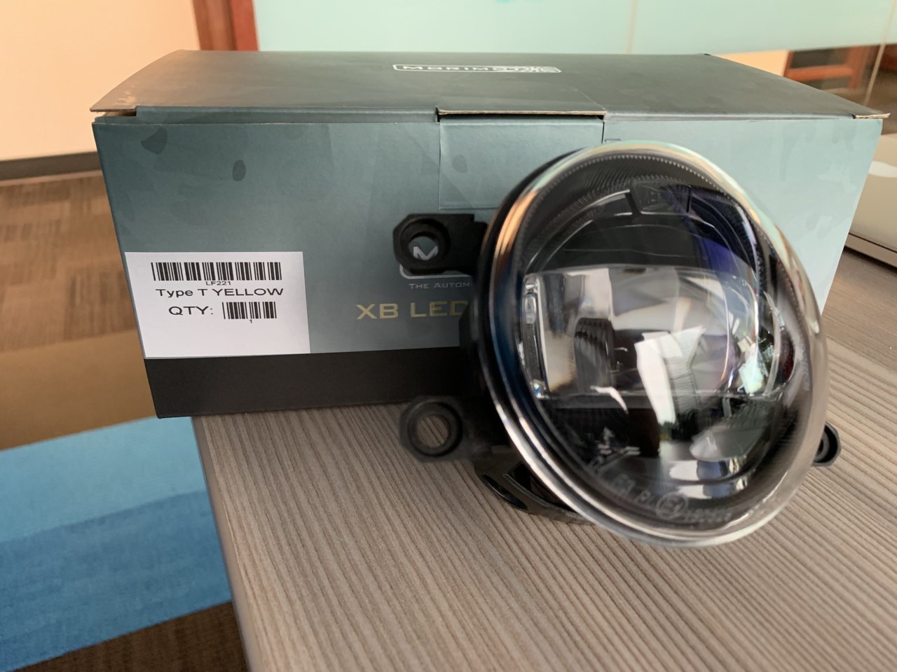

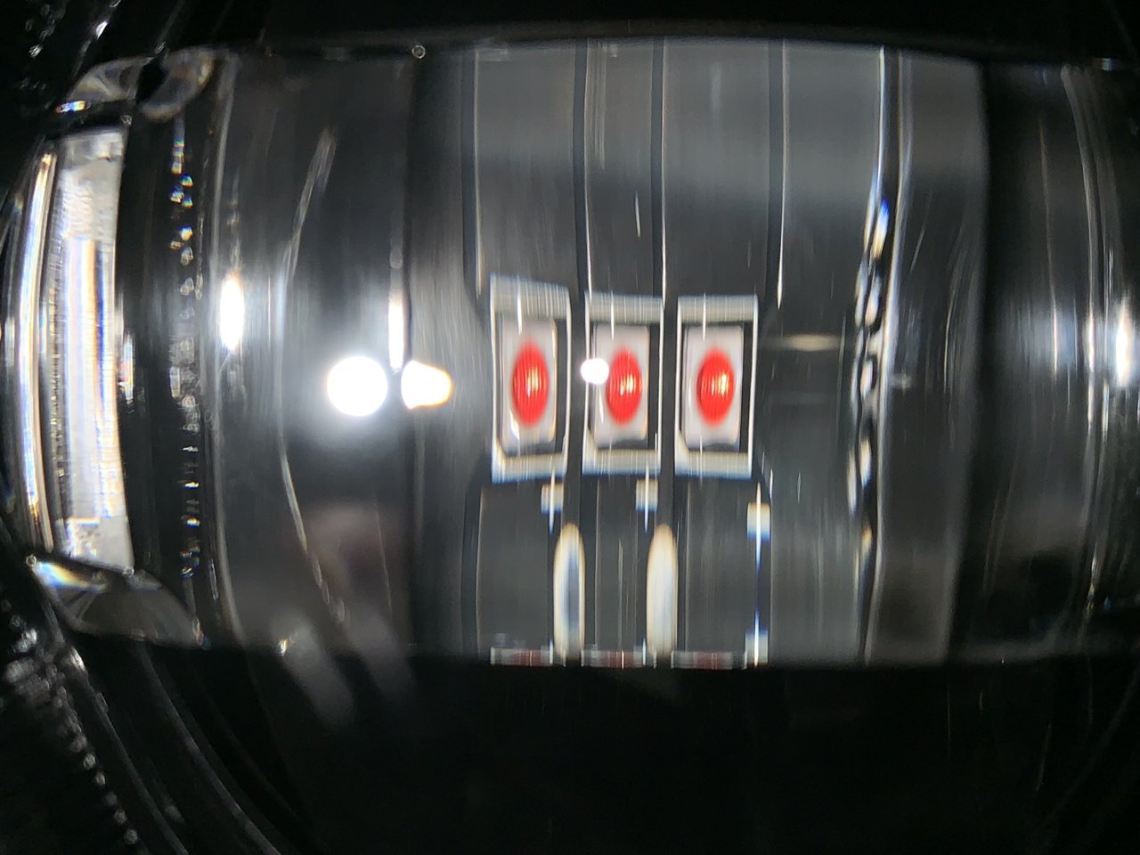

    They arrived.
    Interesting the box calls them yellow. Likely a change from when they were going to use an amber lens with a white light source, which produces yellower output before changing to an amber light source and not updating the sticker labels.
    The LEDs look pretty red. This isn’t powered, just illuminated via flash.

    My best guess is they took the standard yellow version they make, and substituted the amber emitter per special request. Just boxed them up in the same cartons that were already on hand. Looks like a cree XP diode

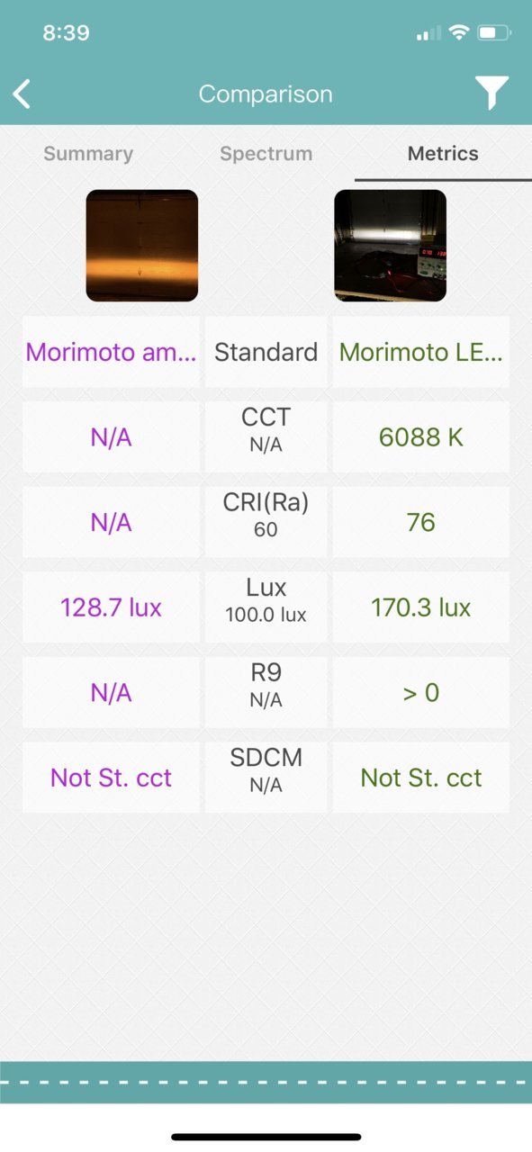

    Morimoto Amber LED SAE fogs
    Output color, 599nm
    Power draw: 0.64A x 13.2w = 8.5w
    Output comparison to the white Morimotos:
    You can see the white Morimotos are 32% brighter than the amber version, 128.7 vs 170.3 lux. A drop in output is expected for an amber light source, this is actually a fairly reasonable (good performing) one. The beam pattern is identical to the white version of the product. While the wavelength (color spectrum) output of the amber Morimotos is extremely narrow causing me not to be able to get a color temperature reading and failing to even get a CRI reading, you can see peak output is at 599nm and completely eliminates the short wavelength light found in their white version.

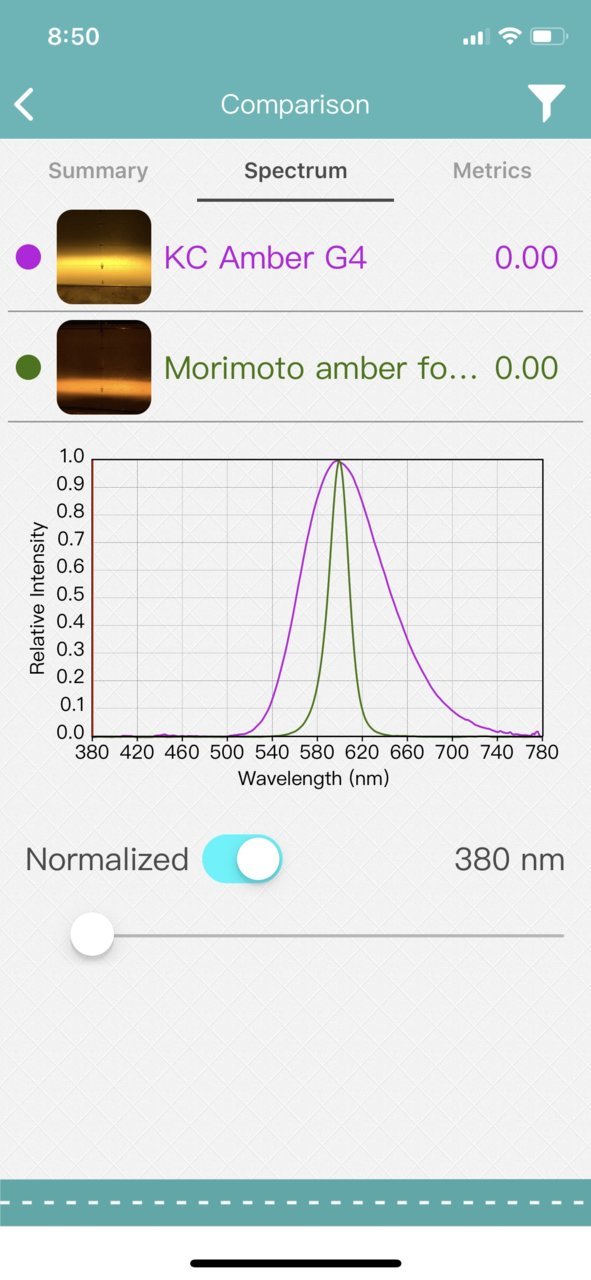

    Of course the obvious question is how do the amber Morimotos compare to the amber KC G4s?
    Output intensity measured in lux is about identical between the Morimoto amber fogs and the KC G4 amber fogs. However the KC fogs do have a much larger illuminated area coverage, giving roughly 2x the pattern area. So while output intensity measured at a single point is about the same, the KCs are putting out roughly 2x the light.
    You can see in the spectrum charts above, both Morimoto amber and KC have nearly identical peak output wavelength. The chart on the left is absolute while the chart on the right is normalized for relative intensity, showing the peak intensity is almost identical. While they both have the same peak intensity, you can see the Morimotos use a much narrower spectrum output LED than KC which has a wider spectrum output. Particularly, in the chart on the left above, you can see how while the KCs peak at the same intensity as the Motimotos, the spectrum is slightly more skewed to longer wavelength. While people mention the output seems a bit red, I think this is just because the output spectrum is so narrow compared to the KC which has the same peak output intensity, but wider spectrum coverage.
    So while peak output intensity measured at a single point is about the same, the KC G4s produce roughly 2x the pattern area coverage at the same peak intensity with approximately 2x the overall output (not to be confused with output intensity).
