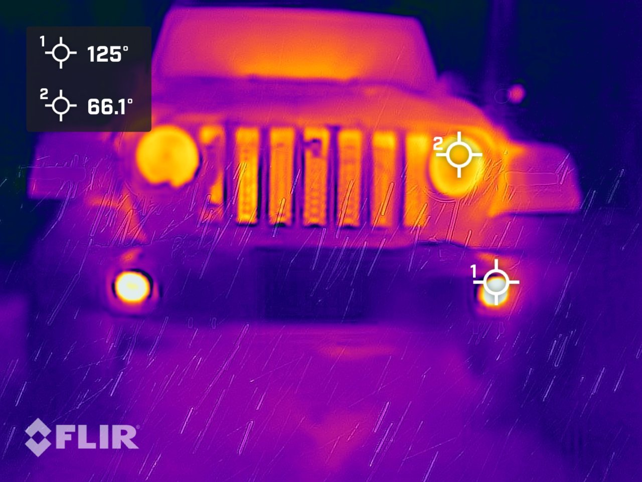

    Tested after freezing the truck for the evening in 25 degree F temps in the snow, I fired it up and took measurements after 15 minutes run time. The heated JW Speaker J2 headlights had heater failures again. The DD Max fogs take 30 minutes to reach stable operating temp, but even after 15 minutes the Max fogs were at 125 degrees in 25 degrees ambient in snow.

    Are you sure that's not all the warmer they get? I'll make the assumption that you already know what the values should be though. I'm just saying that they're both considerably warmer in relation to ambient (isn't that snow falling in the photo), and they are both the same. It would also be very curious that they both fail independently.
    Maybe they just... suck. :notsure:

    Interestingly, a Land Cruiser owner recently contacted me wanting to sponsor a 7” lamp comparison and Koitos are on the list.
    The headlights were running for 30+ minutes in the photo, the heat is just from the power consumption by the assembly. The heaters when active get hot to the touch, way beyond those measured values. I validated the heaters worked prior to install. But I think my test logic was flawed here. I bet idling with no movement, caused the engine temp to be warm enough to switch off the heaters. They probably need some cold air flow to register the cold temp and keep them active. Going to take it for a spin and test that theory.
