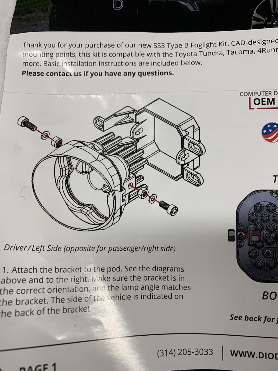

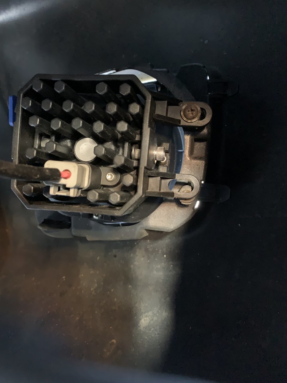

    I guess this fitment is normal? I was surprised I could only get one screw in because the brackets are too close together.

    Yes. I think 3rd gens only have 1 screw holding the stock fogs in, but that may not be correct. I was able to get 2 screws back in my 2012, but realized it made the light crooked.

    See the original SS3 review where this is covered: Diode Dynamics SS3
    The lights are designed for 3rd Gen brackets, 3rd Gen only uses one mounting screw. They are compatible with 12+ 2nd Gen if you also only use one mounting screw. Attempting to use both screws on 2nd Gen will not allow the light to sit level.

    10-4. Installed SS3 Fog amber max last night... just wanted to be sure I wasn't missing some method of having both screws in. Light output is awesome!

    does this apply for all 2nd gens or just the 12+ 2nd gens.
    Still need to install mine haven’t had the time to do it and was just wondering

    12-15 only. 05-11 use a completely different mounting system.
