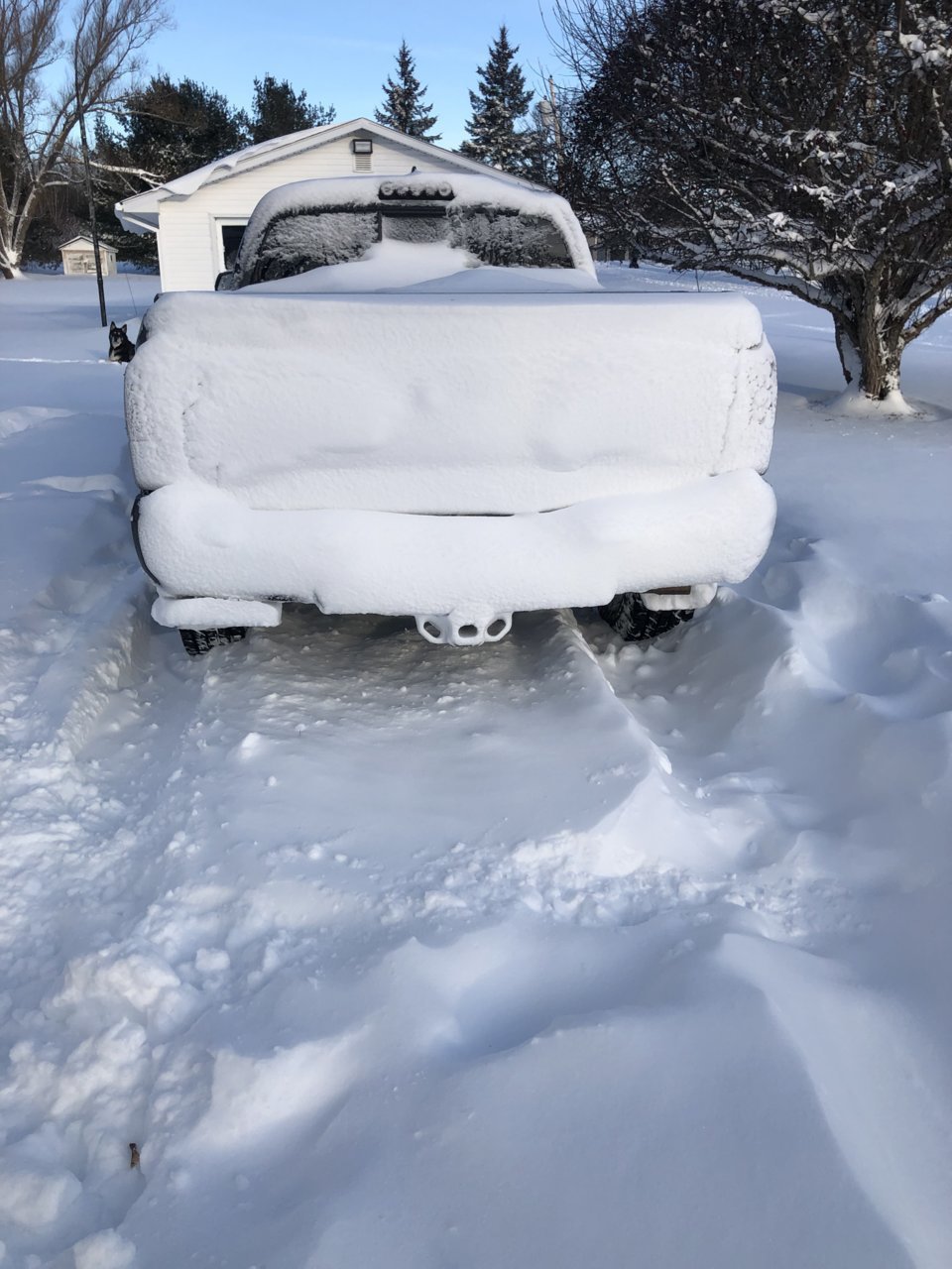

    Don't want to mess up crashes thread since I already have a rear fog thread started. Short answer, a LED that will melt snow. You know for days like this..

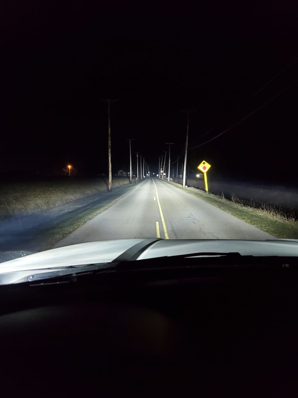

    Looking at the website, there seem to be a good amount of options for these fog lights. I do a lot of freeway driving, so I was considering the white driving light. Do they actually help to see further down the road as they claim on their site? I usually don't have my fog lights on unless there is fog...
    Also, how would the white driving lights do with fog? I do encounter thick fog driving out in the country and going up to the mountain a few times a year.
    Also, I can't seem to figure out exactly what it is that the amber backlight does?
    Thank you!

    Should be asking about the driving lights in the driving thread but yes. You'll see much further down the road.

    Driving lights will do very poor in fog. A fog light is designed to have a wide short beam to illuminate the edge of the road in low visibility conditions so you stay on the road. A driving light has a much narrower beam, focused on distance illumination, it is highly effective for distance illumination allowing you to see further in clear weather, it will be completely ineffective in fog. 6000k also will give you a lot more reflection off of fog, making it more difficult to see beyond it compared to selective yellow.
    A fog light will not extend your distance illumination, and does not help you see further. It is wide and short range to see the edges of the roadway for fog.
    A driving light will not help you in poor weather and will be ineffective in fog. It is narrow and long range to help you see greater distances in good weather.

    oops my bad! I’ll head over there. But wow, what a difference they make!!
