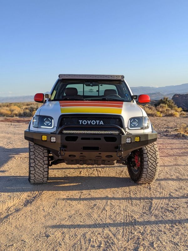

    I'm a little curious, though, how the backlight looks with the clear lens compared to selective yellow on the MAX.
    I have max fogs w clear lens on the Odyssey and selective yellow on the Tacoma. In an ideal world I might want both options, clear for clear nights, selective yellow for poor visibility and true "fog" use. I can definitely see how a backlight option on the MAX with selective yellow optics might be unimpressive during the day.

    The osram chips the Max uses are not available in anything resembling a neutral white color temperature, lowest color temp range on their spec sheets is ~5000k, with 5500+ more typical in whats available.
    With either the Sport or Pro models, you could buy the selective yellow pods, then swap to the clear lens, then carry a set of the pop-off yellow lens covers for use in inclement weather. The max would not remotely work like this, as its selective yellow lens has to filter much more green from the emitters. Going clear lens + yellow pop-off covers would just result in a funky Greenish-yellow color, and probably some attention from police.

    Yep, fully aware of all this as I own 2 sets. I may plan for it with the bumper on the FGT and possibly try to get double fog pod spots so I can be picky choosey choosertons. More fun to overpay for double lights than to be messing around with an allen wrench in a storm :)
    Something like this setup, though it could be tempting to go with a combo or driving optic on the clears.
