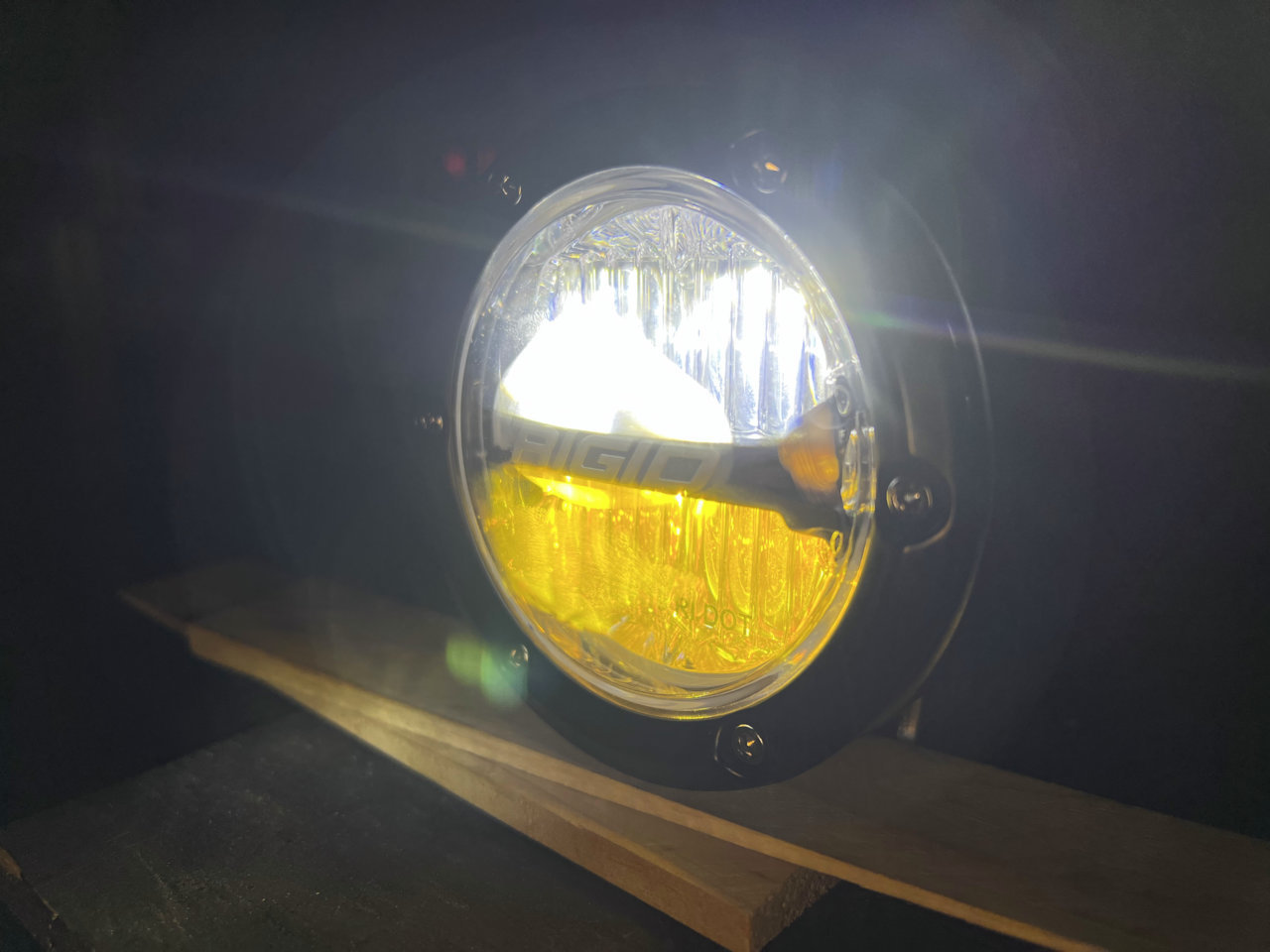

    Hmm. The one I tested were certainly not up to par with the Pros in the single color output. However there may have been some alterations to the design afterward based on feedback. The dual color units I have test spot on par for intensity with the OEM Tacoma TRD Pro Rigid fogs for white, and typical losses for yellow filtration. Here I have it setup running both, which gives a warm white color. Unlike the previous 360s that had a dual top and bottom pattern with a separation between, the optics are now designed to overlap the pattern to just one band. I'll check to see what (if any) updates were done since the units I received.
