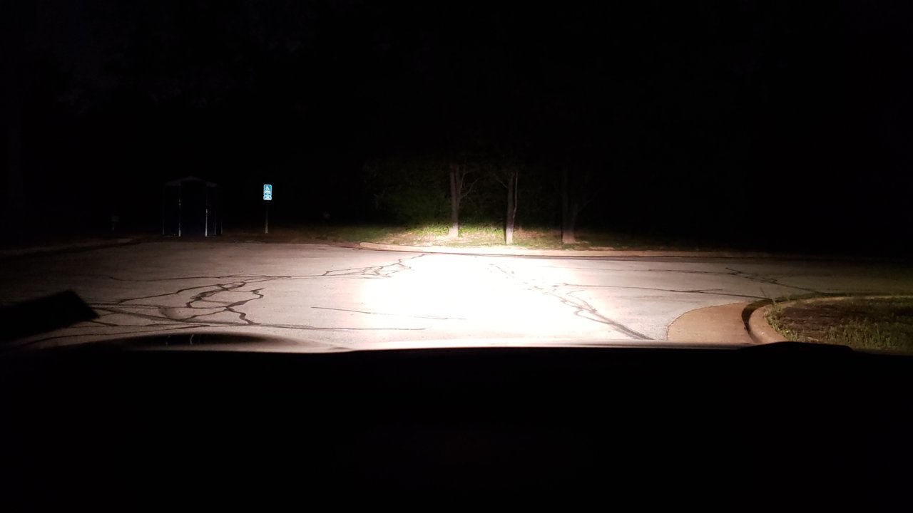

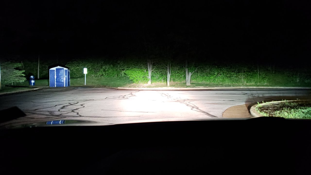

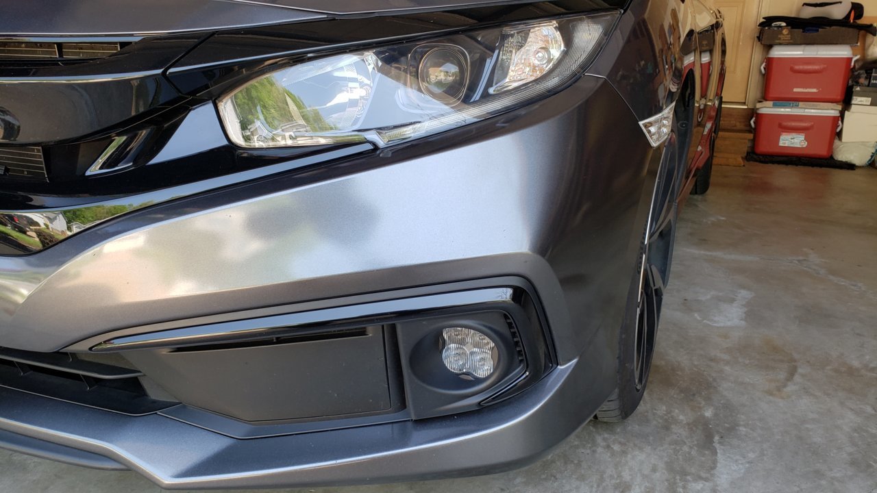

    I cannot thank @crashnburn80 for this testing. I'm sick and tired of Civic groups recomending these switchback PnP LEDs for the fog lights. It's NOT a functional upgrade. Though in my case, I opted to use the non-backlit model with 6000k LEDs since I don't experience inclement weather that often.
    Though my only concern is aiming them. The faceplate touches the fog light bezel.

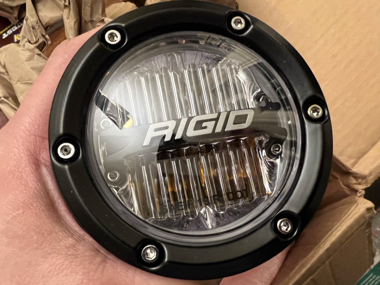

    Switchback PnP LEDs cannot work properly as it isn't possible to place both sets of emitters required to support multiple colors in the exact same location as the halogen filament to maintain optical compatibility. No credible manufactures make such a product. If you want to support multi-color in an SAE compliant fog pattern, the latest Rigid 360 is the only SAE product to do so in one assembly. You can run white, yellow or both for a warm white. Performance is not up to par with the latest offerings from Morimoto and Diode Dynamics though.
    As for the aiming, there is play in setting the depth on the SS3 bracket, so you should be able to loosen the side mounting screws on the SS3 and slide it further back on the mount.
    Edit: I know I still have that Honda headlight comparison to do as well!
    Rigid 360 SAE dual color

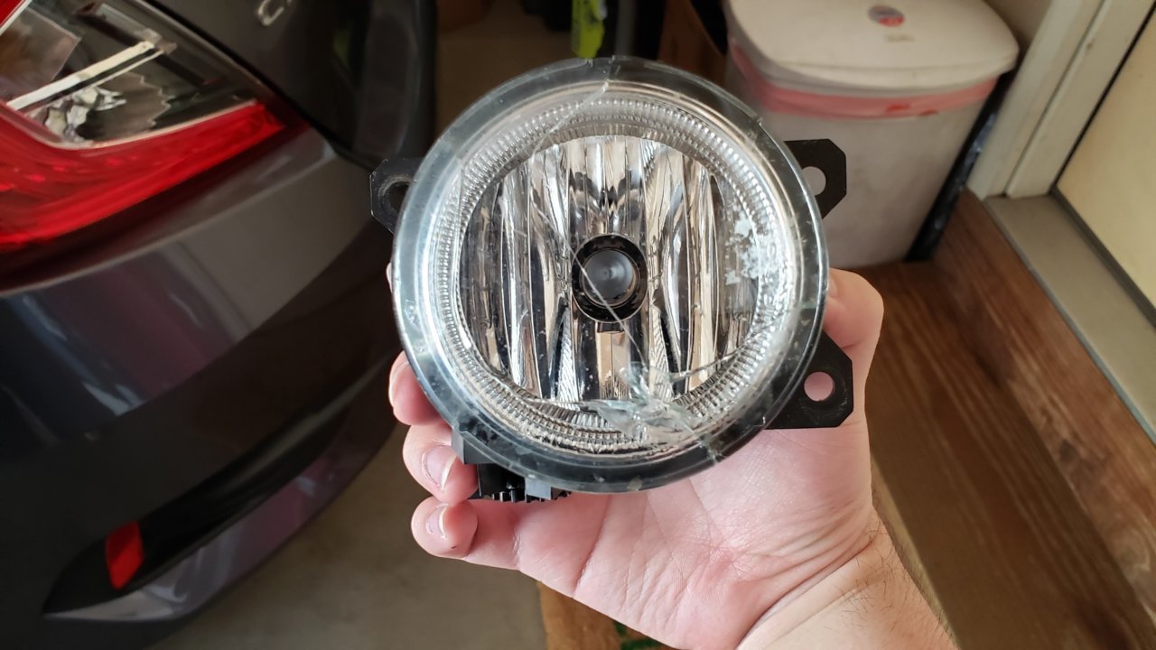

    No rush on testing. Though that doesn't stop from hoarding parts like a madman! As for aiming, I'll see if it needs to be adjusted. I hate to say it, I had a DD installer do the work (the horror). If these were the Elite Series, I would have tried to do it myself. In my case, the bumper cover has to come off in order to acces the screws that holds the fog light garnish.
    Though two weeks before I had the SS3s installed, fate intervened and road debris cracked my fog light.
    It was a sign...

    Yep I need to adjust these... damn it. This will not be fun.
    Low beams only
    Fog lights on
  11. May 9, 2022 at 7:35 PM

    Wow. Definitely. You may be able to have some adjustment just pressing on the lamp face depending on how tight the side bolts were installed.

    Which fog lights are those?
  13. May 9, 2022 at 9:01 PM
    #5933
    NotATacoFC2
    NotATacoFC2 Well-Known Member
    Dec 8, 2021
    #384174
    229
    '24 Civic FL2; '23 CX-5 KF
    Diode Dynamics SS3 Max

    I had similar trouble at first with our Crosstrek too. With all of the liners in the way it was difficult to adjust the depth and height on the car or tighten anything. I ended up setting it all the way back in the bracket and guessed the angle before mounting. It took a few tries but we got there.

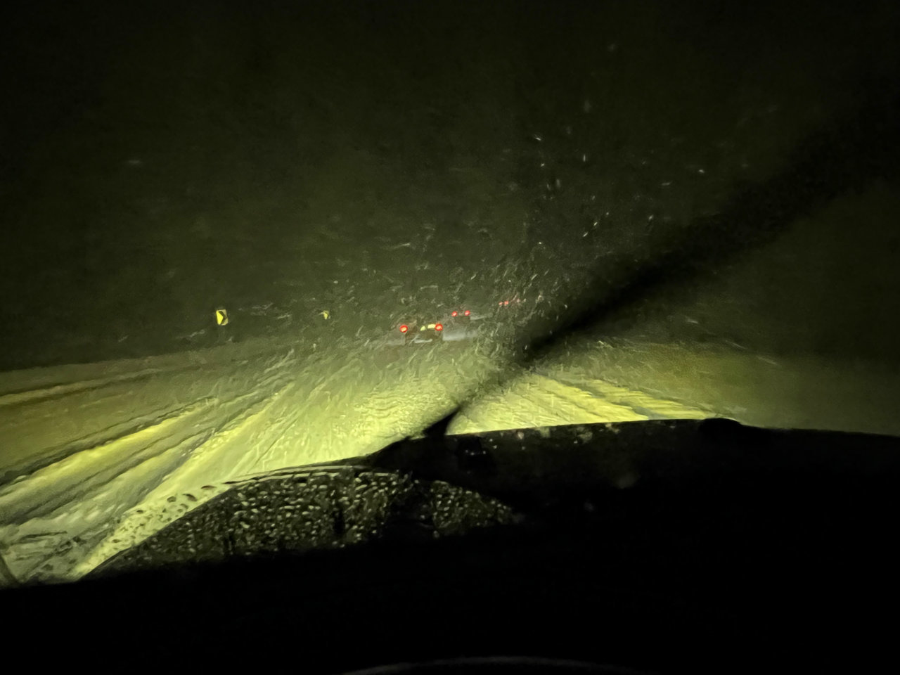

    A note about height- when mounted low in the bumper and aimed as traditional fog lights are, any light below your line of sight over the hood is wasted. You might get small peeks of light in the tiny gap between your A-pillar and hood on the driver side. But for the most part, you want to try to have the bottom of the pattern end parallel with your hood line or just inside it. As a result, pattern height is a delicate balance to hit, especially for a universal aftermarket lamp. This is why I don't think that increased pattern height is always a good thing.
    @crashnburn80 can you speak to why there is roughly a 500K difference in base white light color, even with the same emitters and clear optics? I'm also puzzled by the apparent color temperatures of 7000K and 8000K in the wide angle parts of the pattern.

    Agreed on vertical beam height. Here is the SS3 Max in a snow storm crossing the pass aimed correctly with a 4" drop at 25' as specified by Stern in the Gladiator. The Max overwhelms the headlights and since the fog cut off has a vertical aiming maximum an extra tall beam pattern provides no benefit. As shown, light closer to the truck provided by a taller pattern would not provide any visual benefit to the driver. Wider is certainly more beneficial.
    As to the color temps in the wide angle part of the pattern, look at the pattern photos. Note the edges of the pattern as more blue than the central pattern. I'd speculate that the higher energy shorter wavelength light is more willing to follow the TIR to the outer extremities, but for a better technical explanation one of the manufactures may be better able to answer.
