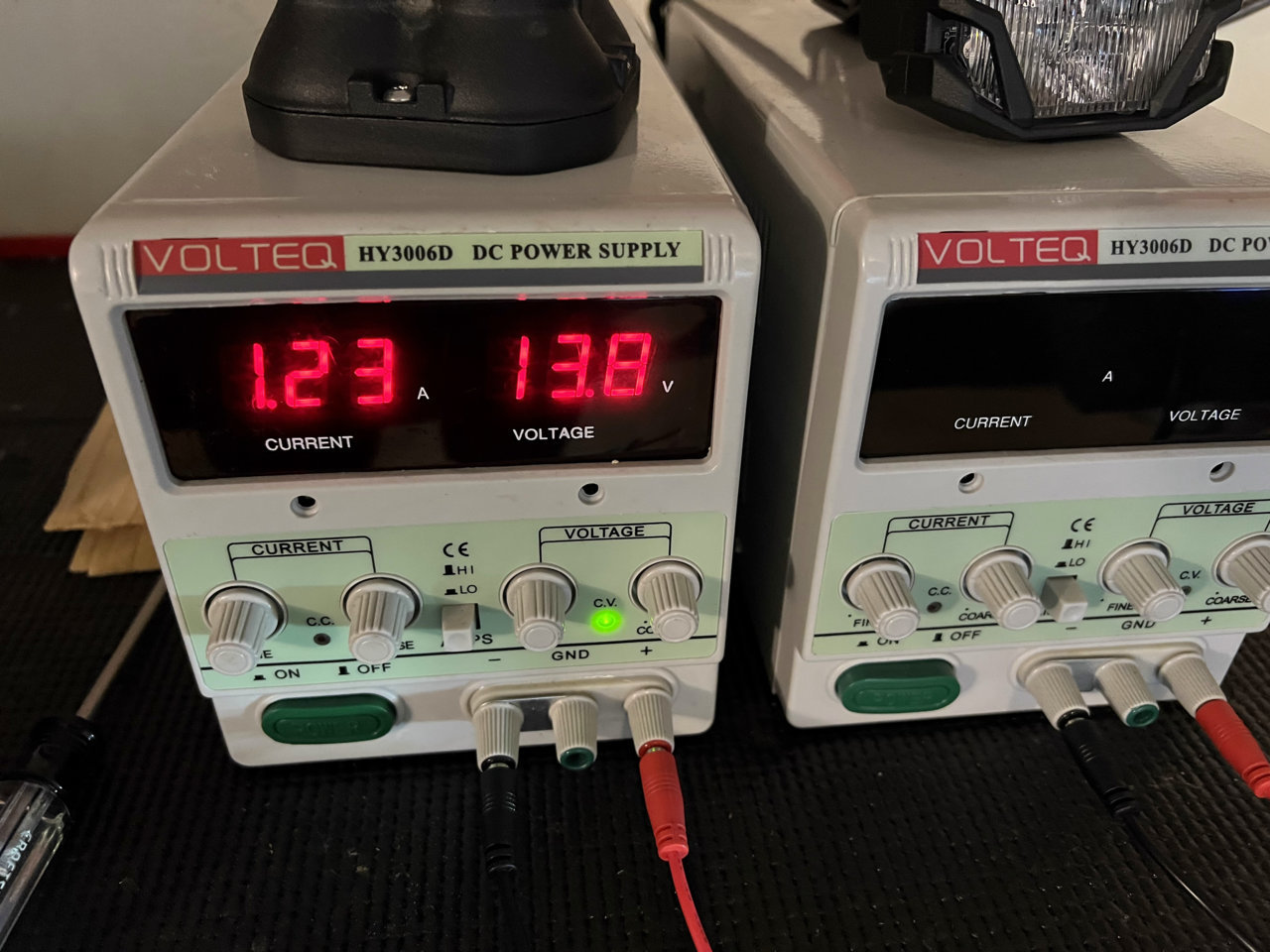

    The lower power sibling to Morimoto's HXB fogs, the NCS units claim an SAE J583 F compliant fog pattern like the HXB's F pattern. Despite being advertised in advance as a compliant fog product, the lamps are missing the needed SAE compliance markings found on other products. The product is also mis-advertised as "SAE Wide" which is not an SAE pattern. Unlike the HXB units where both the white and selective yellow lamps use the same Osram HX Boost emitters, the NCS units use different emitters for white vs selective yellow output, similar to Diode Dynamics SS3s.
    Like the HXB units, the NCS units have good cut offs and use graduated intensity in the pattern, with higher intensity in the upper portion of the pattern, similar to OEM Toyota.
    Evaluating the width, like the HXB units the NCS prioritizes the pattern to be more forward facing and less output intensity to the side. This makes for a less ideal fog, as light to the shoulder is the purpose of a fog to find the edges of the roadway in poor weather conditions.

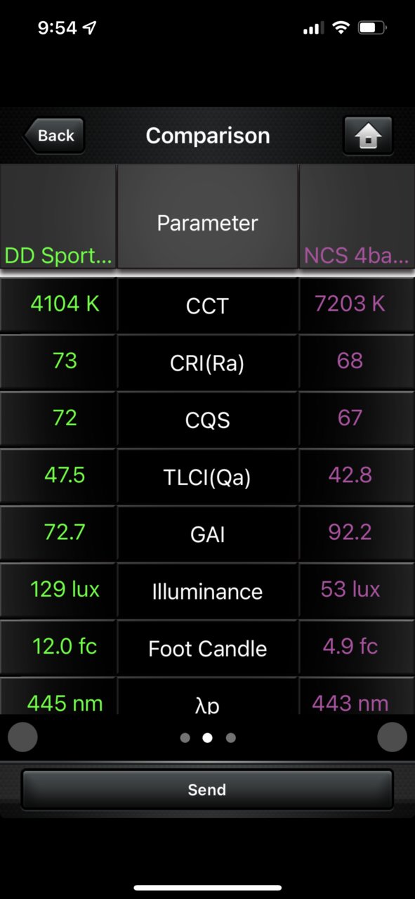

    Diode Dynamics SS3 Sport 4000k top vs 4banger NCS 5700k bottom. It is worth noting that the white NCS units use Nichia NCSY131F 5700k emitters, vs the 6000k HXBs. (I don't have DD 6000k SS3 Sports on hand, 4000k output is tested to be identical to 6000k Sports)
    Tape is placed at 33 degrees right of the lamp. The lamps are positioned in the left fog position facing the door or the left bay.
    Peak intensity, the 4bangers beat out the SS3 Sports.
    33 degrees right, the SS3 Sports are 2.4x+ higher intensity than the 4bangers.
    NCS white initial, using Nichia NCSY131F
    NCS white stable using Nichia NCSY131F
    17w initial dropping to 16w stable. Much smaller drop than the HXB as this power level does not generate the extreme heat that significantly reduces output. Both these measurements are short of the manufacture spec 20w power claim.

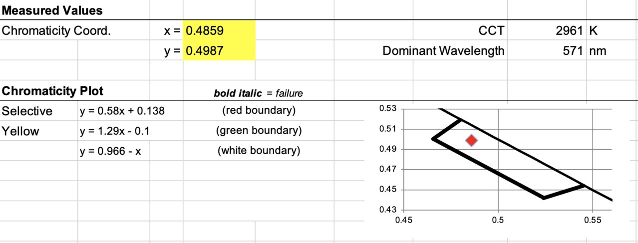

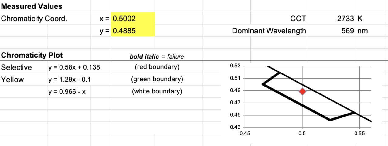

    Chromaticity window, a legal selective yellow

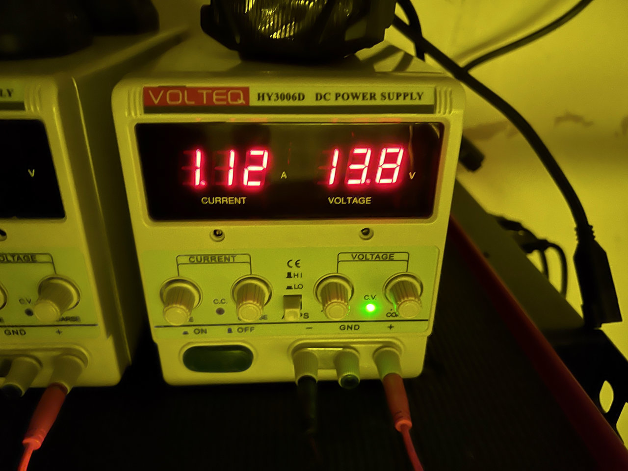

    The selective yellow lamps draw slightly less power than the white lamps. Initial startup on the selective yellow NCS.
    Stable power on the NCS selective yellow
    16.4w initial and 15.5w stable, about 0.5w less than the white lamps and again not close to the 20w power spec provided by Morimoto.

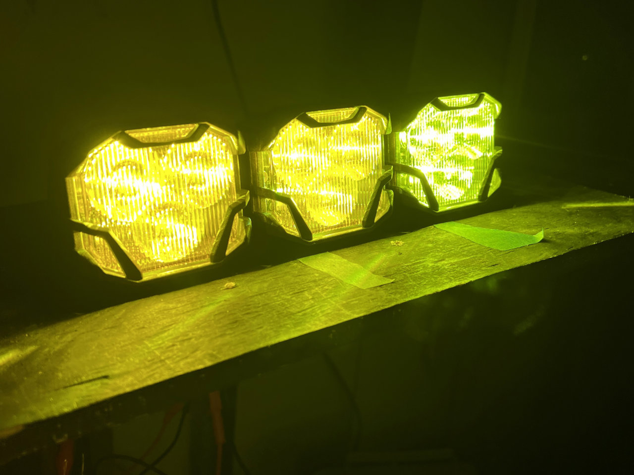

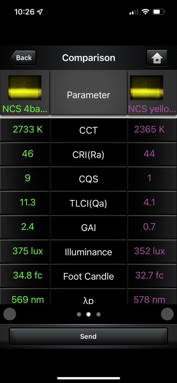

    NCS yellow w/ yellow lens (stock) vs NCS white 5700k w/ yellow lens vs NCS yellow with clear lensEC2CEECF-F293-42CA-B6B3-7C98D5C36056.jpg

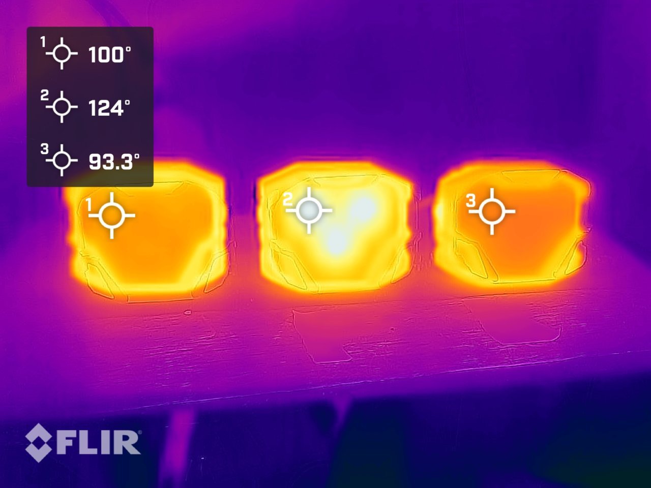

    Lens temps. 25min runtime at 71 degrees ambient.
    4banger NCS yellow with clear lens swap. Clear lens swap results in a legal selective yellow chromaticity window output.
    Yellow NCS w/ clear lens swap vs yellow NCS (stock)
    While the yellow NCS with clear lens swap falls in the legal chromaticity window for selective yellow, it is pretty green and not a modification I'd recommend.
    The NCS yellow incurs about 15.5% output loss though the yellow optic filtration ontop of the 18.5% output loss by using the NCS yellow emitters. Overall output loss from NCS white to NCS yellow is 31%, which is among the worst for yellow efficiency in the industry. Compared to Diode Dynamics SS3 Sports in selective yellow incurring a 7% loss from white to yellow due to the optimization with equal output 4000k emitters and lighter yellow more efficient optics.

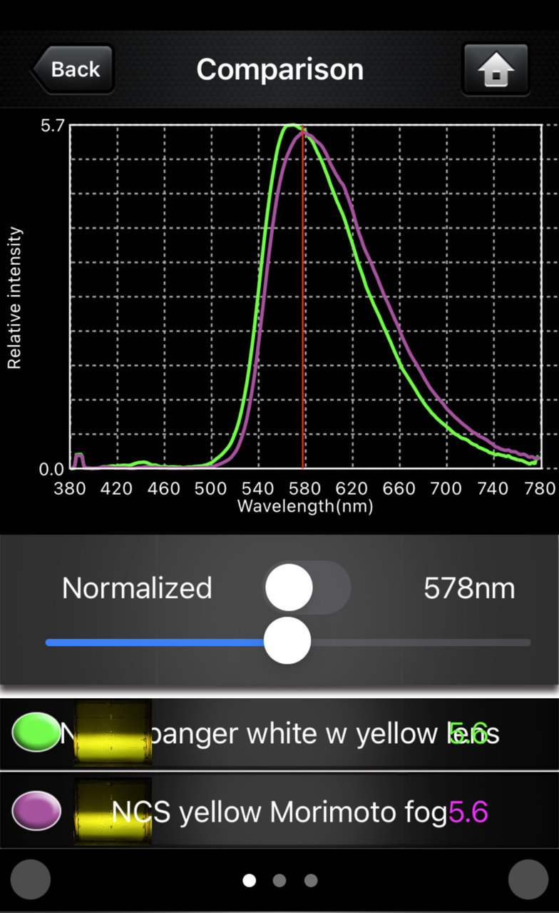

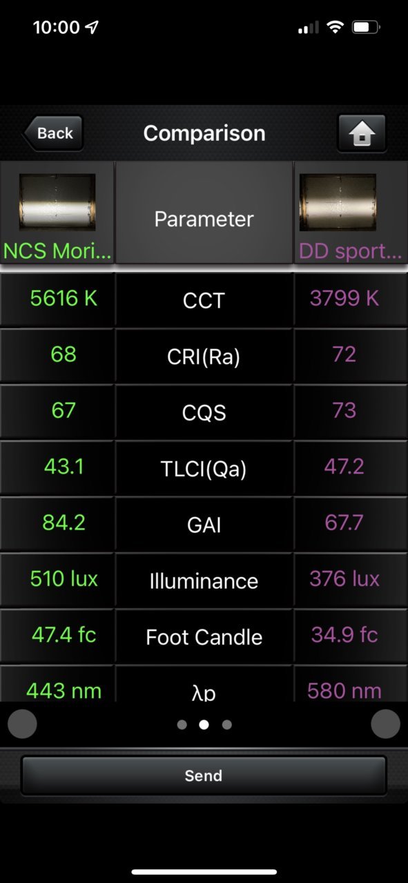

    Spectrum comparison of NCS white w/ yellow lens (green line) vs NCS yellow with yellow lens (purple line).

    Thank you for showing that spectrum comparison, it shows both scenario is fairly similar range other than peak difference and slight survive at 440 looks like.
    I must add explanation combination to CQS and GAI score of between two for fog penetration. Your spectral analysis is very useful to explain how fog penetration works with selective yellow.
    Yellow lens over NCSY really cut down color variation based response, allow to show in contrast.
    Plz highlight CQS and GAI difference.
    Lower CQS means, complete opposite of what general lighting want(CQS is potency of color information display ability)= view rely on mono-tone contrast view.
    Lower GAI = less potency shows color variation information
    It has considerable difference between in fog/dusty particle penetration potency.
    NCSYellow +Clear lens CQS 13 GAI 3
    NCSWhite + Yellow lens CQS 9 GAI 2.4
    NSCYellow + Yellow lens CQS 1 GAI 0.7
    But,,, it is good point that you pointed out NSCwhite + Yellow lens can create 13C more heat at lens surface, this is something deserve some attention.
    Even though, ambient +30C surface temp still won't significant enough to battle heavy sticky snow/blizzard, it does help with light frost.
    Difference in fog penetration ability won't matter if its covered with snow ultimately. I shall add this notes to development research memo!

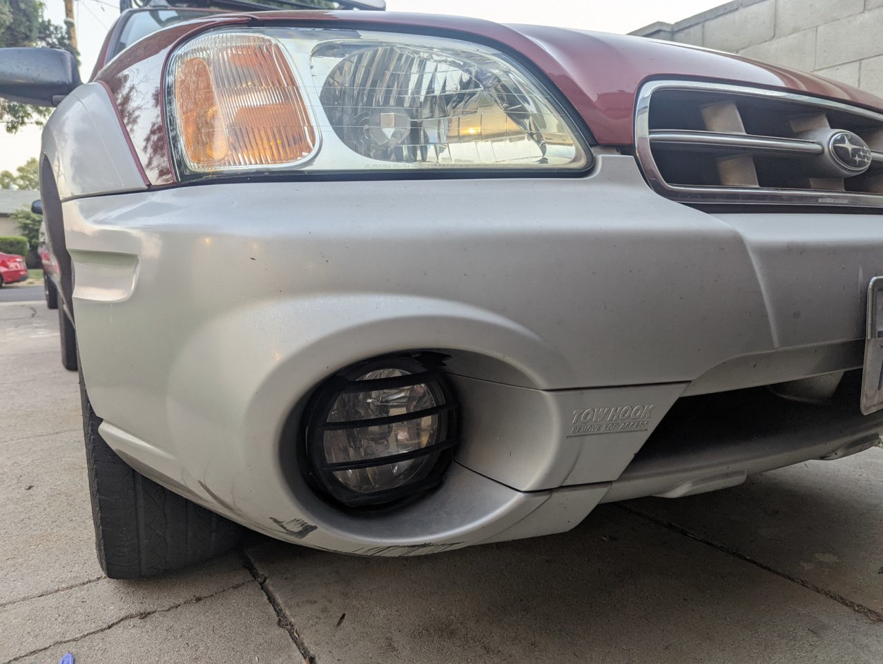

    Check out these monster 6"+ lights in the bumper of my Dad's Subaru Baja (pretty sure they're fogs but didn't turn on the car to confirm). Don't know how they perform either.
    dpele and Aws123 like this.

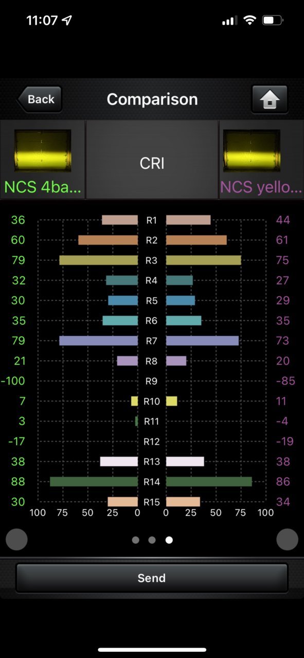

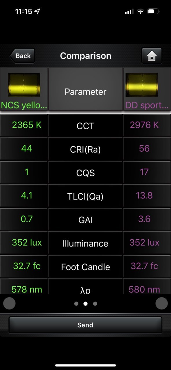

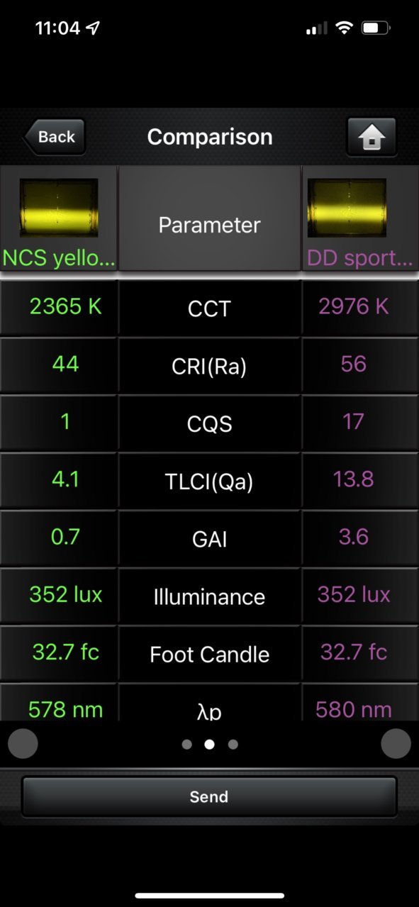

    White NCS w/ yellow optic vs yellow NCS w/ yellow optic
    Higher CRI and GAI means more accurate color rendering (aka better).

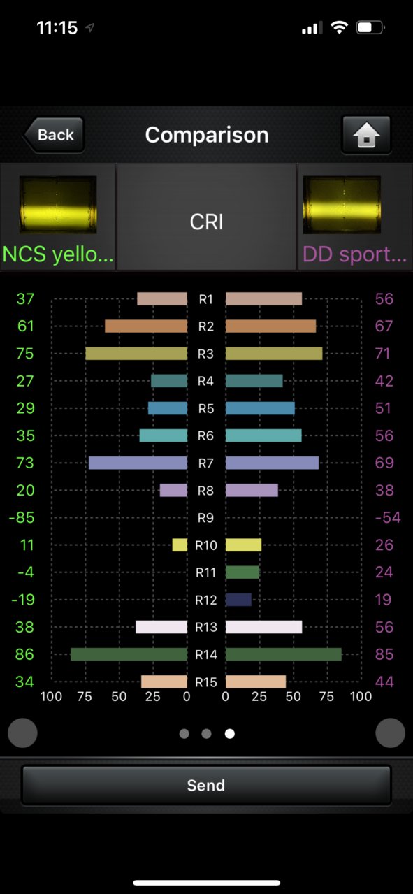

    Breaking it down to specific R-values:
    R-values to compare lighting quality with selective yellow optics to the competition:
    Morimoto NCS selective yellow vs DD SS3 Sport selective yellow
    Again, higher CRI and GAI means more accurate color rendering (aka better) along with higher R values. Diode Dynamics SS3s offer far better color rendering quality than Morimoto which have gaps in the color rendering for selective yellow.
    Note that automotive industry standard is 70 CRI for white LED headlights. Yellow fogs are lower in CRI lighting quality.
    Subaru has some pretty crazy fogs. I haven't tried those large 6"+ units, but I did experiment with these Subaru fogs in the Tacoma here.

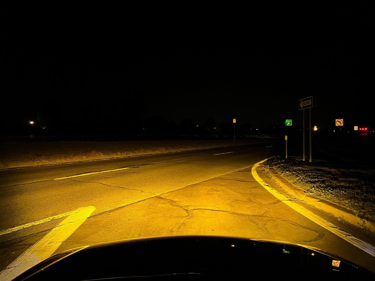

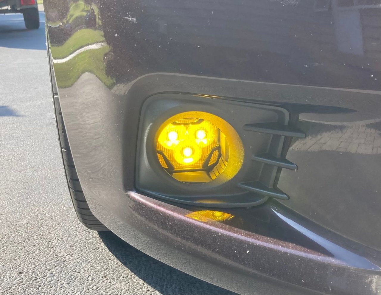

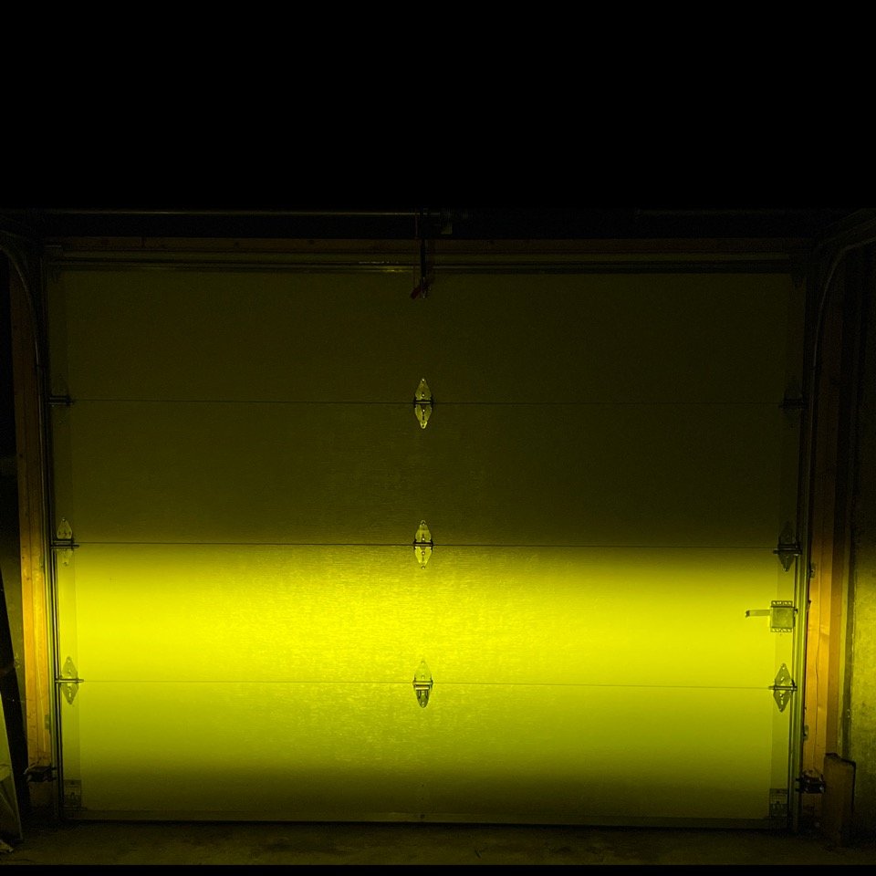

    Sorry it took me so long, but I got my hands on a set of fog pattern 6000K HXB 4Bagers and they went into my son's 2013 Scion tC replacing a set of Diode Dynamics selective yellow fogs.
    Not bad for a car driven year-round in the rust belt and having 165,000 miles on it huh?
    Why this car and not my 4Runner? I'm pretty happy with my DD Max fogs, but my son didn't care for the less well-defined horizontal cutoff with the Pros. Since the brackets and wiring are exactly the same in both vehicles, they went into the tC. How do they perform? See below.
    A few observations here. First, the pictures were taken out of an open sunroof, so the angle is significantly different from the driver's seat. Second, the yellow hue is very, very nice. Third, these things are definitely impressive! (I think they could come up a bit, but they're actually aimed correctly.) Finally, the pattern is definitely narrower than the DD Pros, but very much in line with what my son was looking for.
    So, we're going to leave these in my son's car for now and let him try them in all sorts of weather conditions since the car is driven year-round. I'll keep everyone informed, but so far, both my son and I are quite impressed.

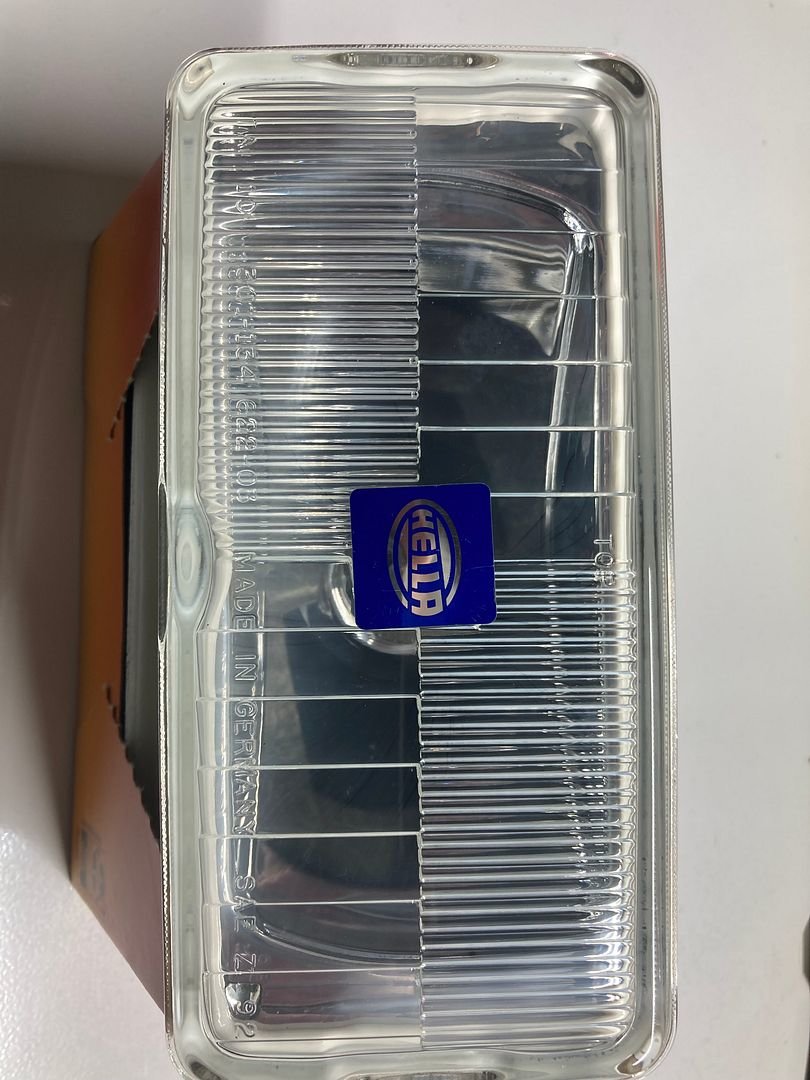

    With the clear lens and a fog pattern, they might actually be just what you need.
    toledoupsguy[QUOTED] likes this.
  19. Jul 1, 2022 at 9:09 AM
    #5979
    Toy_Runner
    Toy_Runner Well-Known Member
    Nov 19, 2019
    #311172
    1,132
    99 4Runner SR5
    3" OME lift, heavy coils f/r 3/16" steel skids Modified Coastal Offroad diy bumper 5spd swap ('98 donor)
    Too bad SAE Z beam standard has gone the way of the dodo. Being able to run a secondary set of (effective) lamps with lowbeams would be useful for lots of reasons.
  20. Jul 1, 2022 at 11:17 AM
    #5980
    Too Stroked
    Too Stroked Well-Known Member
    Jan 24, 2017
    #208501
    3,926
    Tom
    South shore of Lake Ontario
    2021 4Runner SR5 Premium
    Guess what's sitting in my basement stash just waiting for the perfect application?
