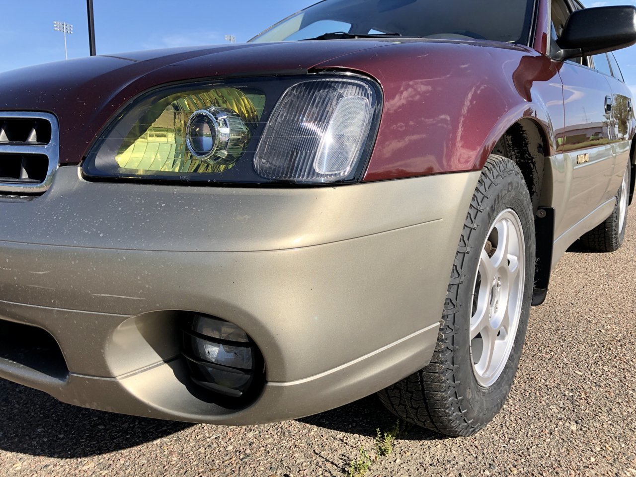

    I have those fog lights on my 01 Outback. They are not impressive at all. Even when using a 9012 they don't provide much useful light. They are more of a fill light than anything. The width isn't good and there isn't any usable distance added , there is no redeeming factor other than style. It was common to use PIAA 520's or 510's and Hella 500's for better fog lights back in the day. I haven't bothered trying to improve mine since I did a retrofit on the headlights and it's my beater car that I don't really take far from town.
    You can definitely see the way the Morimotos have less width compared to the DD's in the picture with the car in the right lane. It hardly even reaches the ditch on the side of the road by the looks of it. Great pictures by the way!!

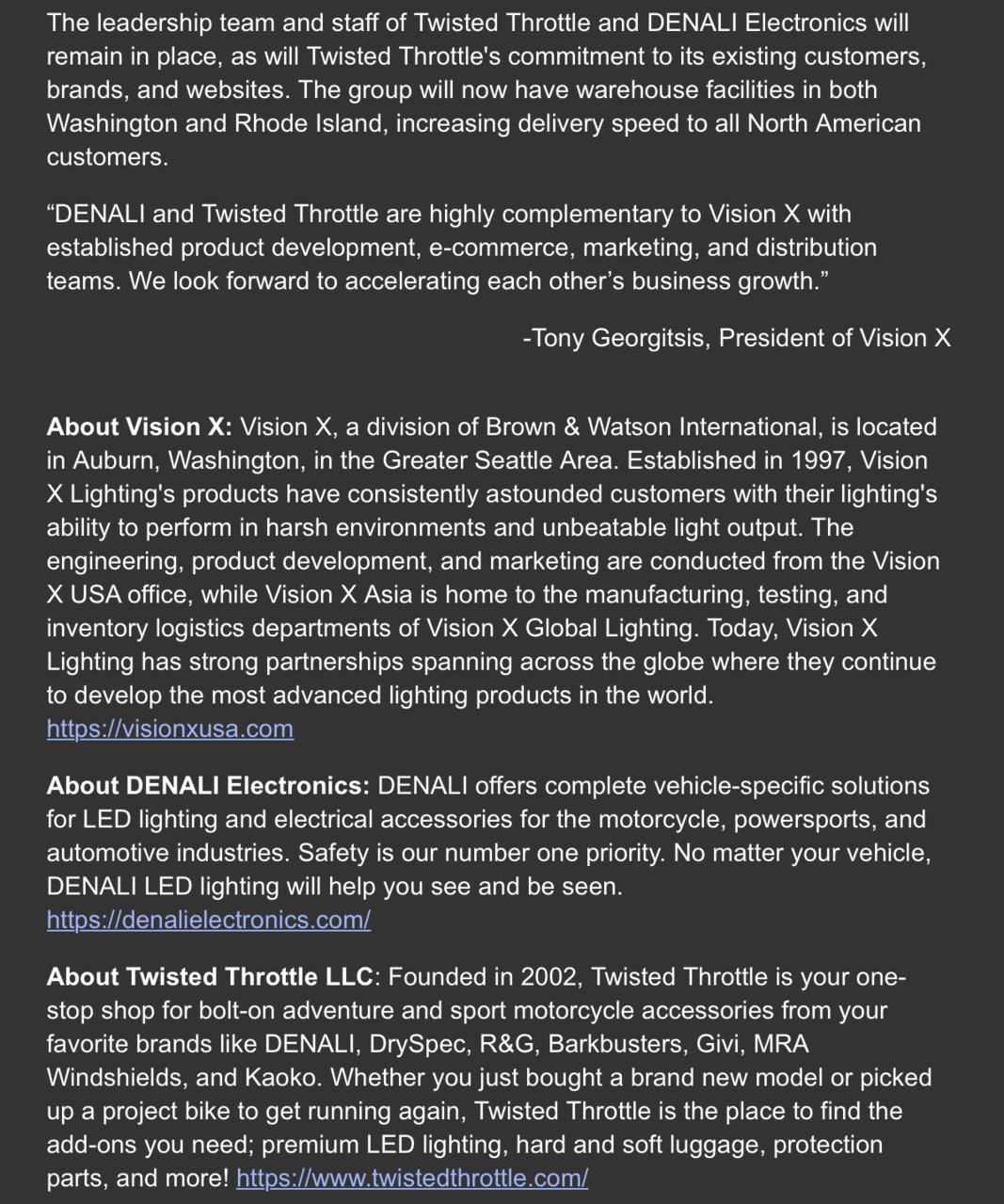

    Interesting news this morning, VisionX has acquired Denali Electronics. While VisionX made headlights, they did not make any fog lights and specialize primarily in off-road lighting. Denali makes headlights as well, but specializes in lighting for street use, including their SAE fogs.
    And it looks like Denali finally got their fog pods in stock.

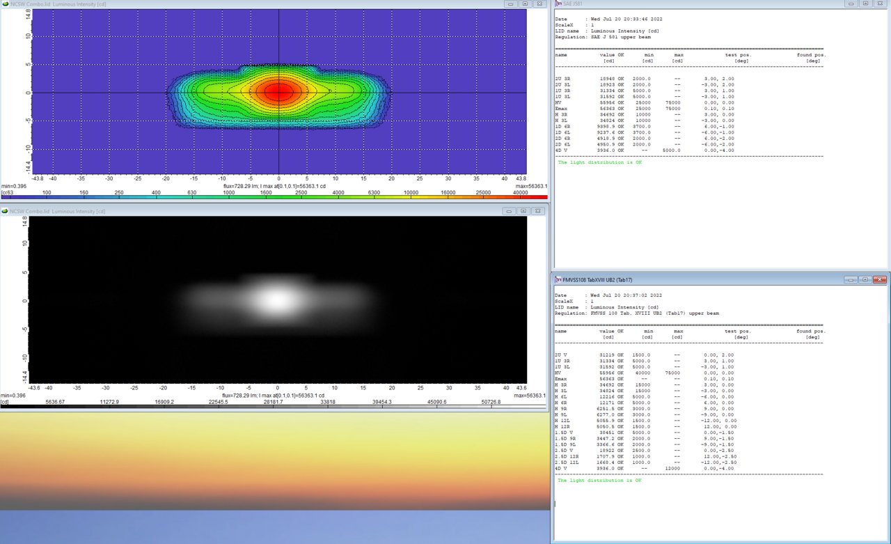

    Only 4 banger Combo NCS is equivalent to J581. HXB has too high E-max, But ok as R112
    NSC combo also satisfy UB2 as high beam stand alone, but didn't bother advertise that way. If someone want to build full headlamp and send to test, NSC Combo can be well adopted as high beam optics component. I labeled as mid-distance coverage lamp. Not as peaky as spot, not as foreground heavy as wide beam, just in between coverage.

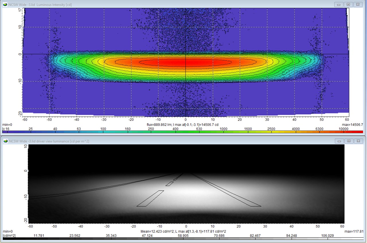

    I can't say using combo as J582 lower beam substitute is acceptable. Combo beam is very much like high performance high beam, therefore, glare will be very severe if aimed straight angle. If aimed low to prevent glare, then way too strong hotpot too close to driver view.
    NCS wide covers similar to weak low beam, but without distance illumination capability and very heavy foreground. At -3 degree aim, it will not cause glare at mount height of 24" ish.
    So as low beam, I don't like it. No distance throw capability. To prevent glare, must aimed properly at -3 degree.
    However, if you want to make great HIGH beam, you can combine NCS wide+Combo to create very much desired high beam pattern like this.
    (NCS wide -3 degree aim + NSC Combo +1 degree aim)

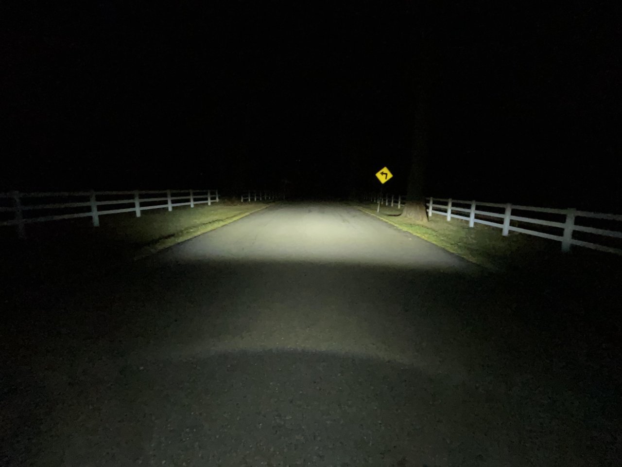

    Is he looking to use it as more of a low beam? It honestly isn't terrible for that. You don't get the full width of an SS3 of course, but you do get a taller boxy beam. I've been playing around with a set in wide on my A-Pillar on the Tundra as of late and kinda like it. I like a spot pattern mounted there significantly better, but if not aimed as a fog light I think it would produce enough light down-road to be acceptable.

    That's a great visual!! Thank you!
    He is looking for more of a low beam. I was actually thinking the SS3 Pro may work well since it does have some light bleed which would illuminate signs and critters yet may not be bad enough to bother oncoming traffic. He really wants a light bar that can run vertically to run along the inner edge of the radiator shroud, but to my knowledge there isn't a light bar that is vertical with a beam pattern that would be acceptable for low beam use.

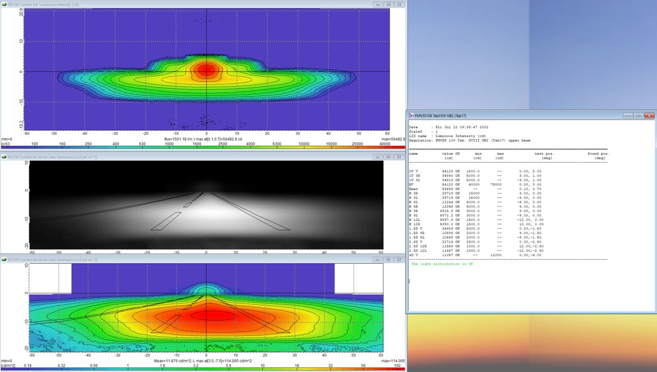

    Fog pattern cannot substitute low beam like distance, check below image,
    This is simulation of
    From the top
    LED Low beam projector ( LB2V)
    4 Banger HXB
    SS3 Pro mock up
    4 Banger and SS3 Pro mock up is aimed at angle which does not cause glare ( evaluated by LB2V table = low beam table)
    Fog pattern will pull view impression unsafely too close to driver, unless intend to drive very slow, it is not safe to drive by using fog beam pattern substitute as low beam.
    All lamp are set at 0.61m (=24") from ground, driver view height 1.12m in driver view image.
    I feel responsible to make sure to mention, 4 Banger NCS or HXB wide does NOT substitute low beam. Feel free to enjoy as off-road wide beam, or aim properly to use as fog lamp.
    But as low beam, it just cannot have enough down road illumination capability and foreground point ( 4D,4R) point score way too high = what generally called, too much foreground
    Visual impression shall explain why it's not good to have too much foreground
    it will greatly reduce mid-distance detection capability.
