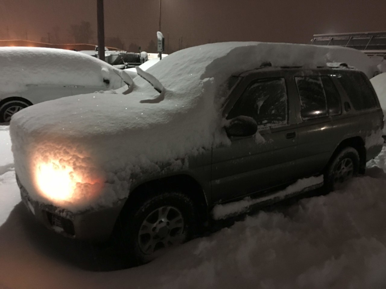

    I was thinking the same thing lol
    But the snow is wet wet when it does snow. There's a reason why the whole city shuts down.
    Canadian Caber likes this.

    Yes, but it's chaos when it does.

    I grew up there, I don't miss it. Folks outside the lower mainland are generally better prepared for winter driving though the first storm of the year is chaos wherever you are.
    Canadian Caber and dpele[QUOTED] like this.

    Pretty much west side of the Cascades south through OR. Nothing like 32 degree slop falling and then clearing out into the teens.

    Please don't tell me this is a recent photo. As much as I love seeing the SS3 snow-melting power, I am not ready for that yet...

    His profile reads E Tennessee... If this is current(ish) Hell hath frozen over...
    Squirt and 308savage like this.

    January 2021, but it sounds like this winter is gonna be a bitch!

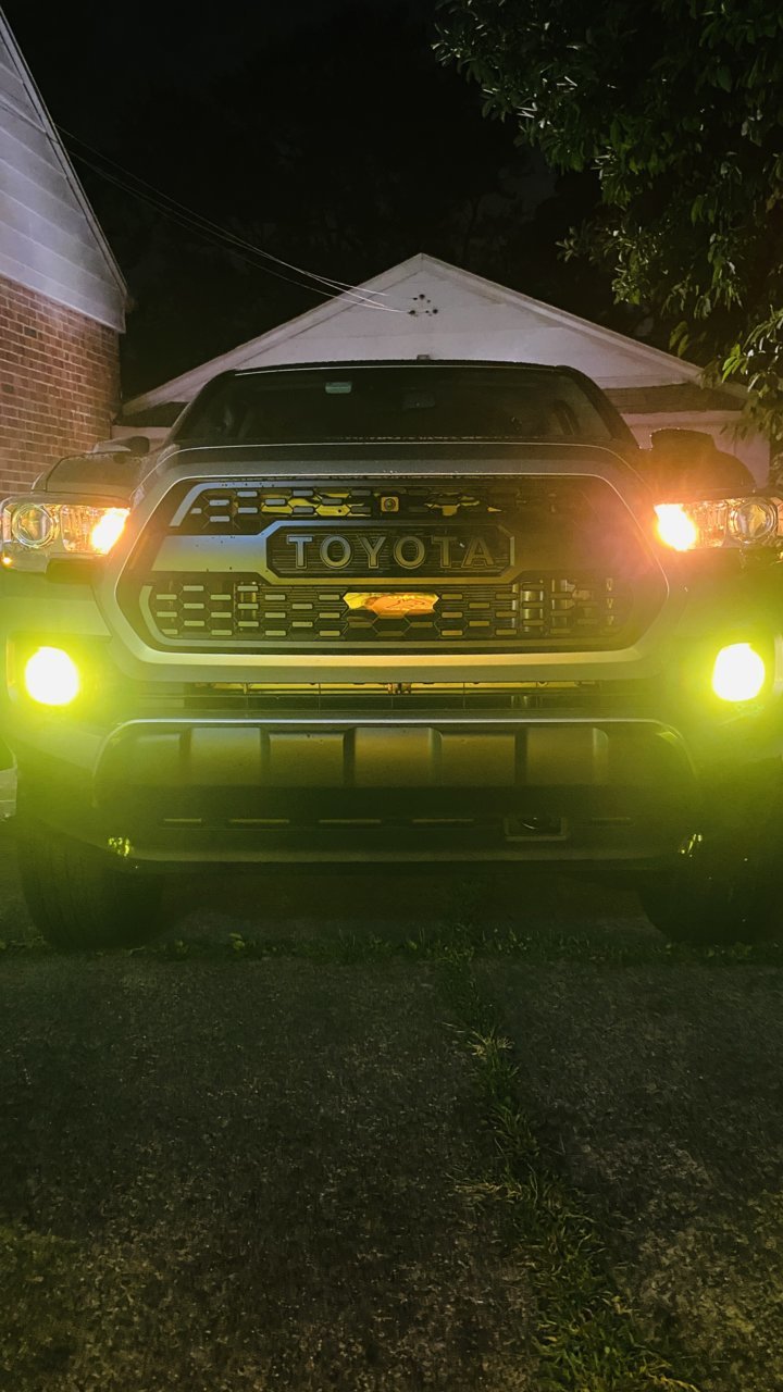

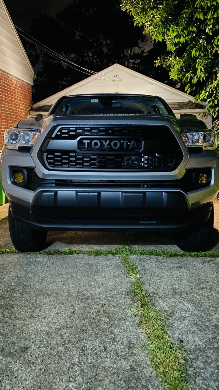

    Glad you're at least prepared even if you don't use them much for snow they should help a lot in the rain, that's at least what I am hoping I just finished installing mine.

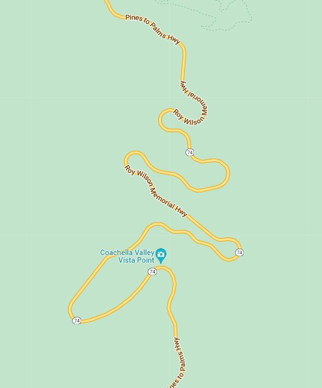

    My favorite spot for the SS3 MAX was this stretch of 74 into Palm Desert. Downside is, even late at night you still have oncoming traffic heading up the hill while you descend. I would drive that with one hand on the stalk to control fogs like I did higher up with high beams. Super nice when you have clear roads to enjoy the width and hit the curves as smooth as possible (my wife routinely gets carsick and the kids have puked in the van a few times too, not super fun).
    Granted, only once did I see heavy fog and it was mostly at the top rather than the ascent/descent.
