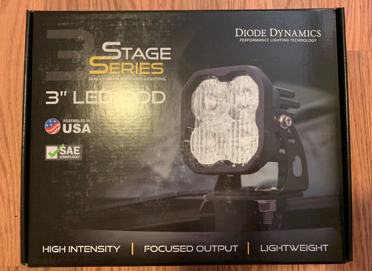

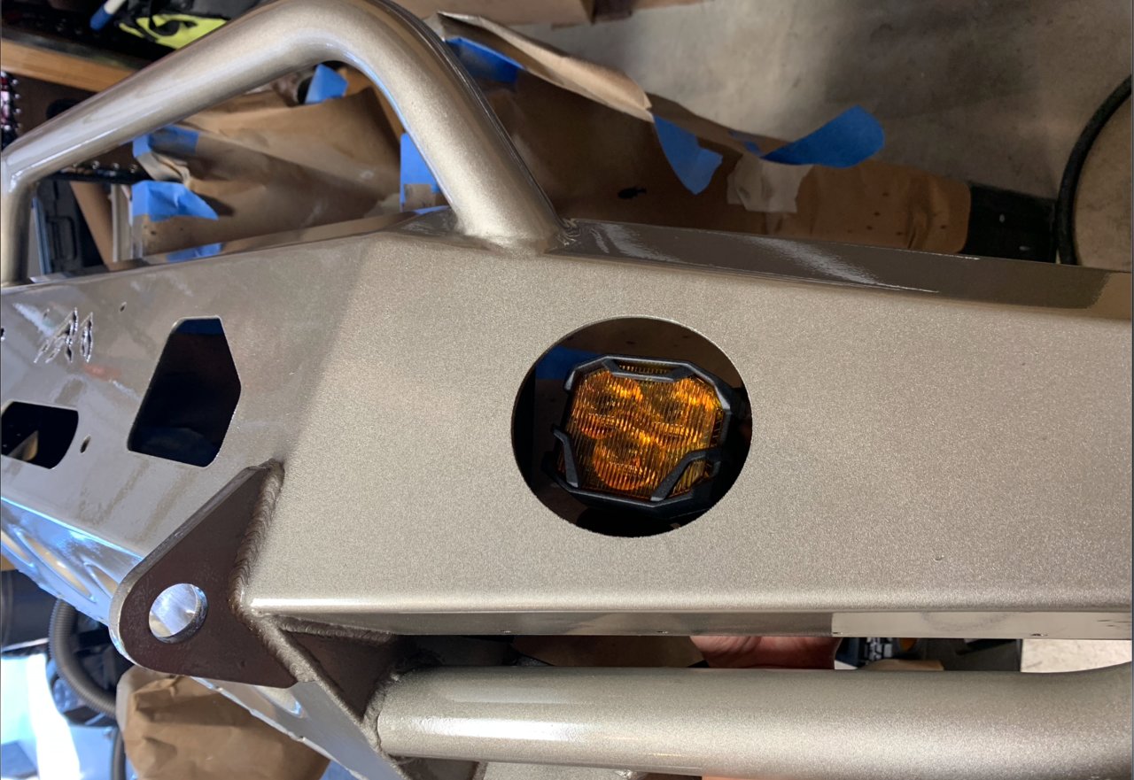

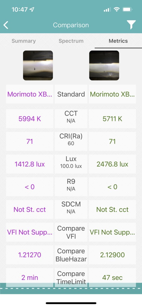

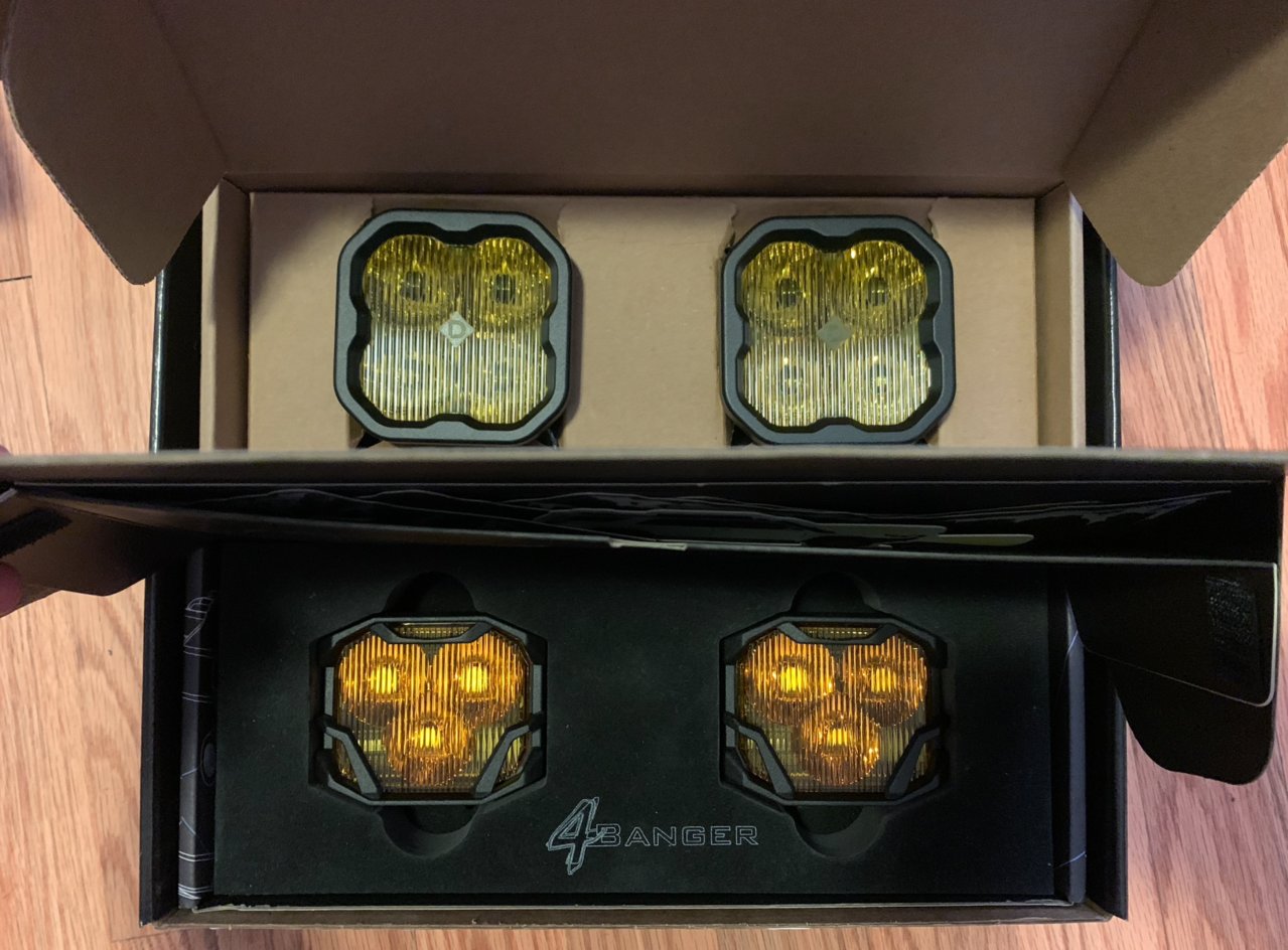

    Bought some DD Pros and opened the box and surprise Morimoto HXBs inside?! Crazy how it be like that...
    I finished paint matching my steel bumper and I'm really excited to throw the HXBs in the fog holes and DD Pros on pillar ditch light brackets or the center bar.
    Not bad for a garage paint job!
    Screen Shot 2022-09-03 at 3.27.23 AM.jpg Screen Shot 2022-09-03 at 3.27.30 AM.jpg Screen Shot 2022-09-02 at 6.17.43 PM.jpg
    Edit;
    Is it acceptable to clock the fogs outward?

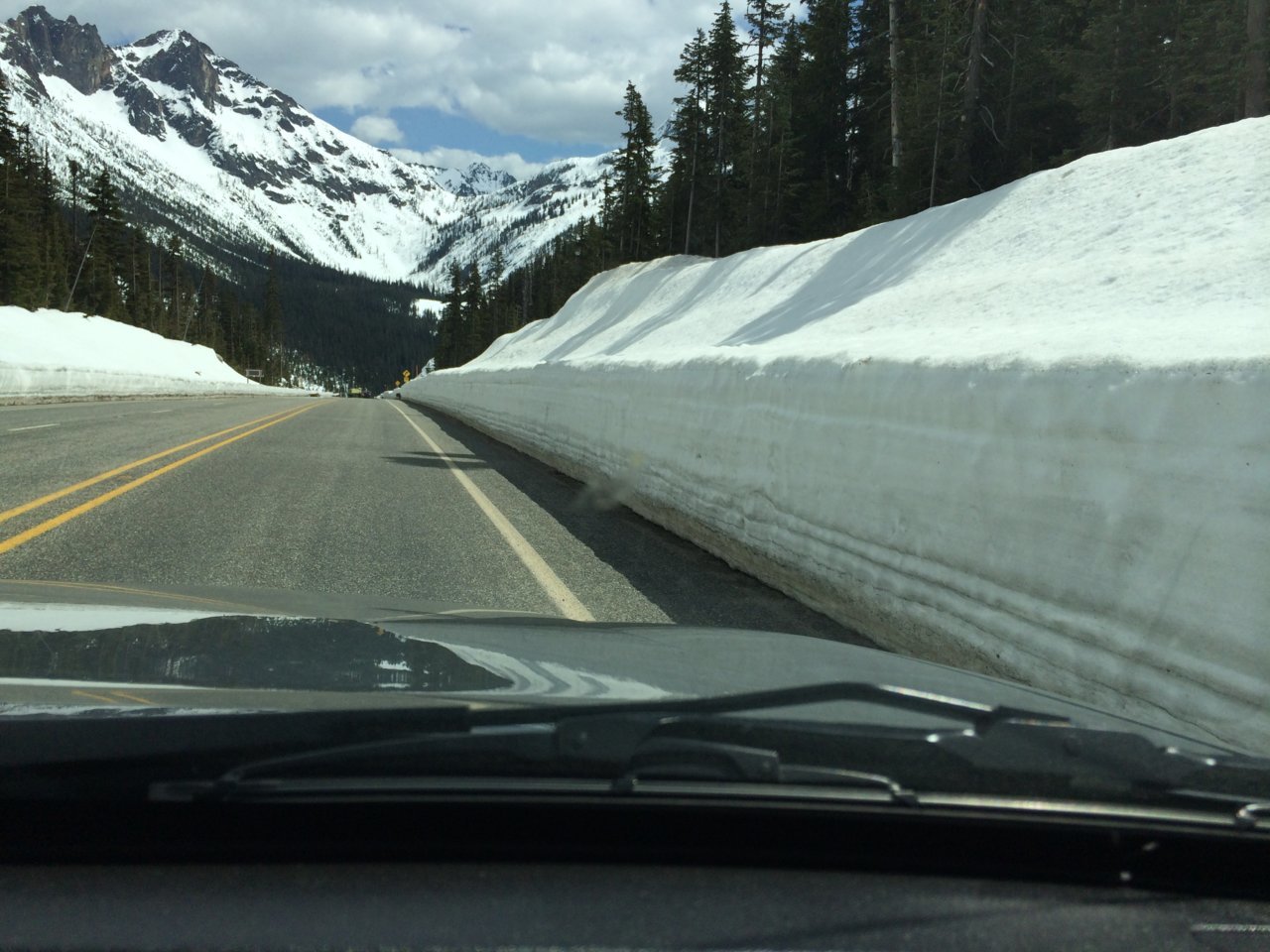

    Highway 20 is absolutely beautiful even though it is a pretty hazardous roadway and closed much of the year. But it is closed for good reason in the winters.
    Snowblowers working to reopen the highway in the spring.
    Photos of my last drive across 20 in my 2nd Gen, in mid-May.
    Even better to cross the highway in late summer when the snow has melted so you can really appreciate the views. Zero chance I'd attempt this highway in the kind of white out snow storms seen across highway 2, even if it was still open.

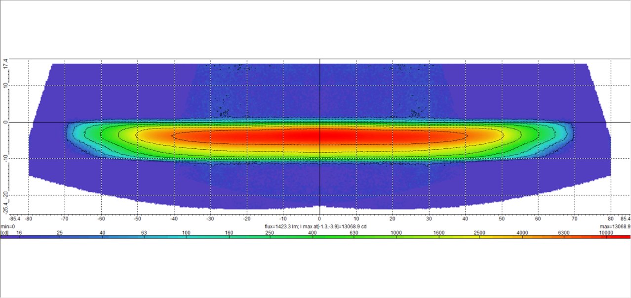

    It should be ok to clock fogs outward.
    F regulation does not define R and L combined beam evaluation, but equivalent evaluation is allowed in F3 regulation such as side specific coverage lamp
    applying same concept, to keep combined beam acceptable as fog, I would say 15-20 degree to outward the most
    It’s important to note 4B HXB also require 4.5D aim to use as on-road fog lamp to prevent glare

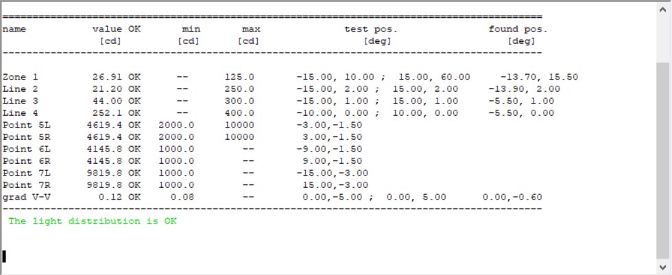

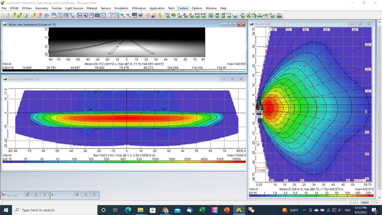

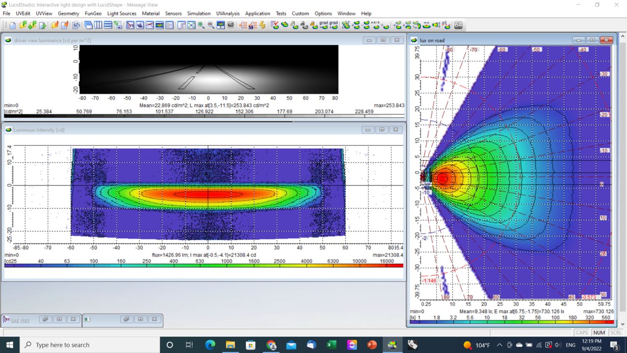

    My simulator allows evaluating side-specific aim combined beam.
    And here is an estimation of 20 degrees outward aim of 4Bnager HXB. At 20-degree outward aim, the beam center on the wall shot, you will see about 40% intensity reduction, but still remain above 13,000Cd equivalent ( as single side fog lamp ). And same as SS3s, peak intensity below 4D won't even be in the driver view range.
    You will not experience a hot spot void at the beam center straight view. And gain far outer reaching width.
    For comparison, this is the original aim ( no outward adjust) This shall illustrate beam impression difference by the horizontal aim variation.

    That's good to know and backed up by simulation. Thank you so much!
    Data is beautiful

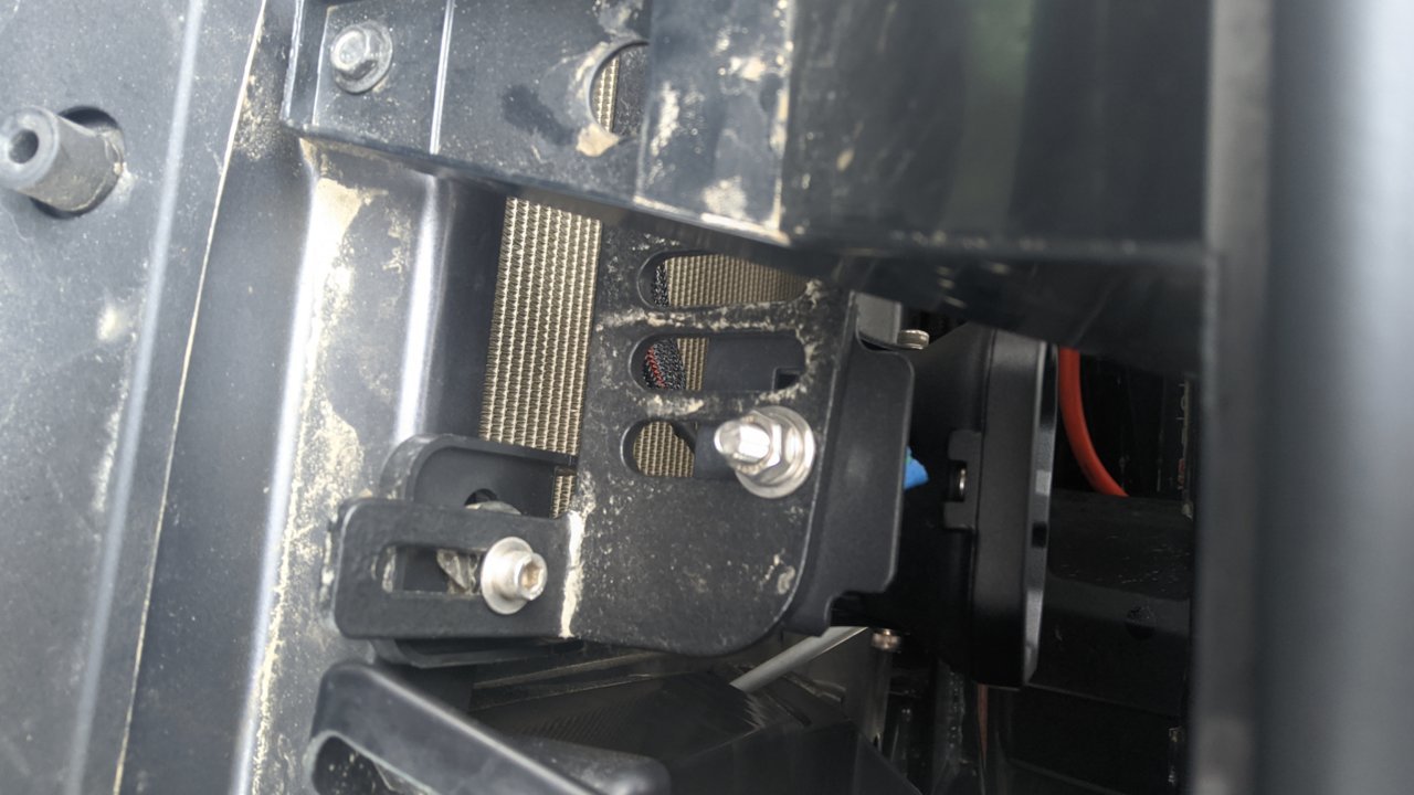

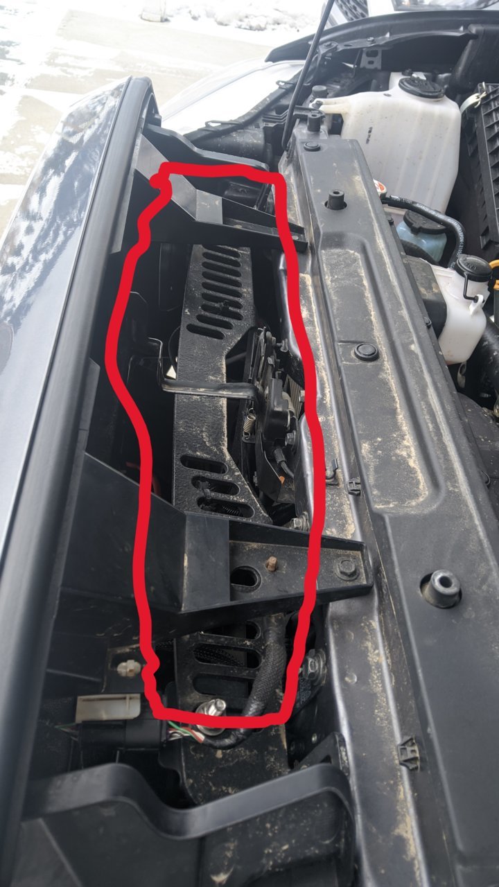

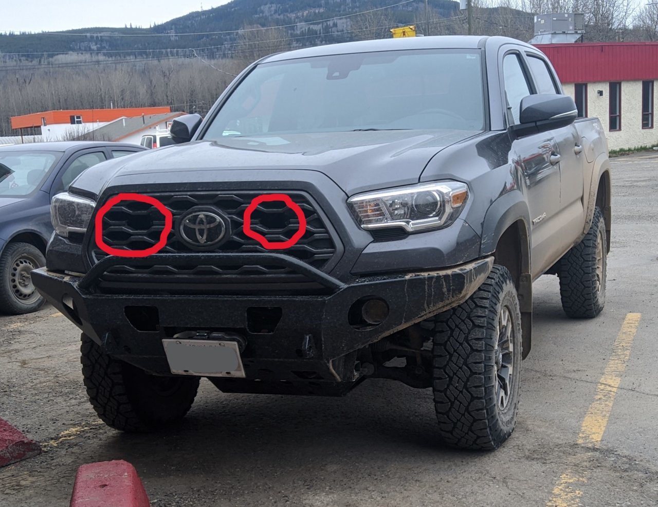

    BAMF Mount came with all the mounting hardware for it and the DD lights had their own.

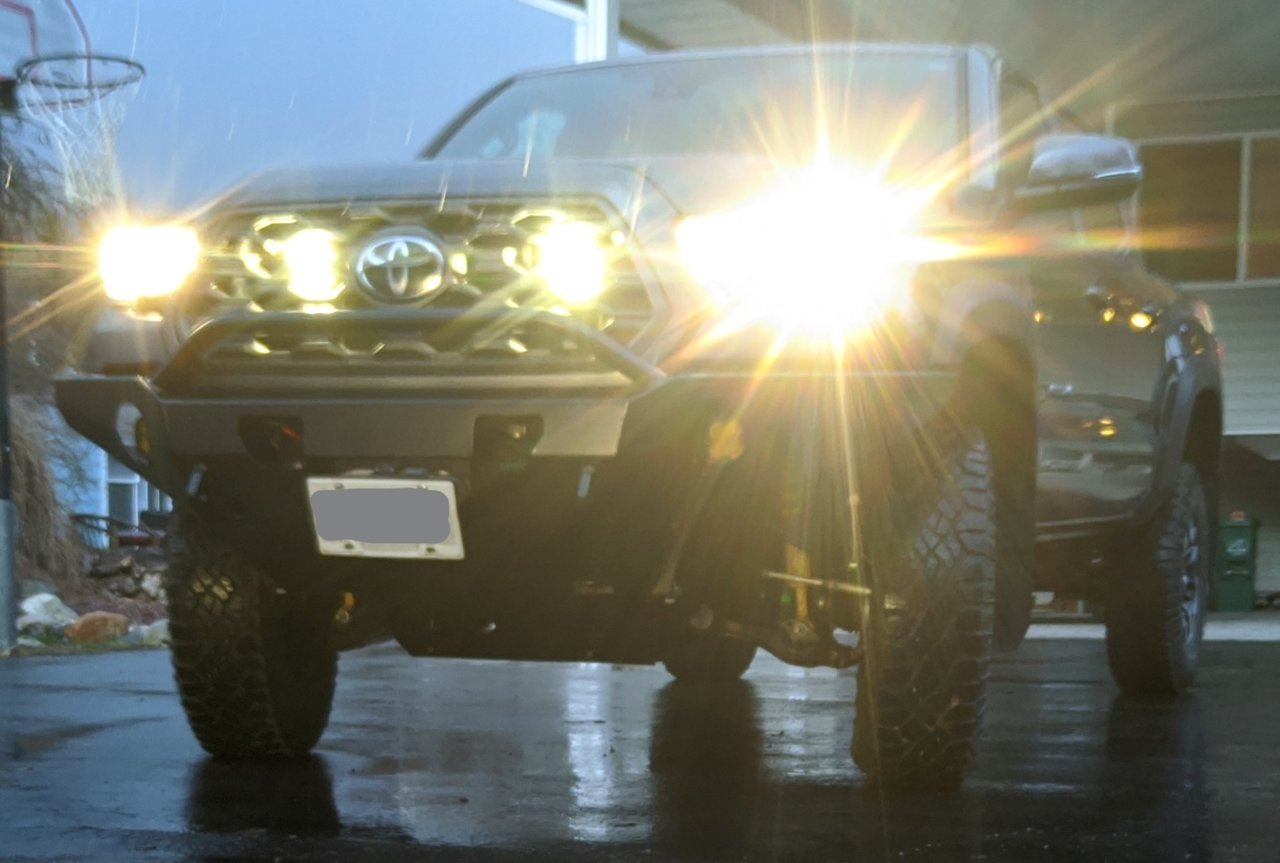

    One thing I did was to make two cutouts in the grill for the lights.
    I also made a wire harness that taps to the HighBeam fuse under the hood so they come on with the high beams and I also taped into the in cab fusebox so I can turn them on independently using a 3 way switch from anytime backup camera.
    Cutouts in the grill
    BAMF rack
    Light hanging from rack
