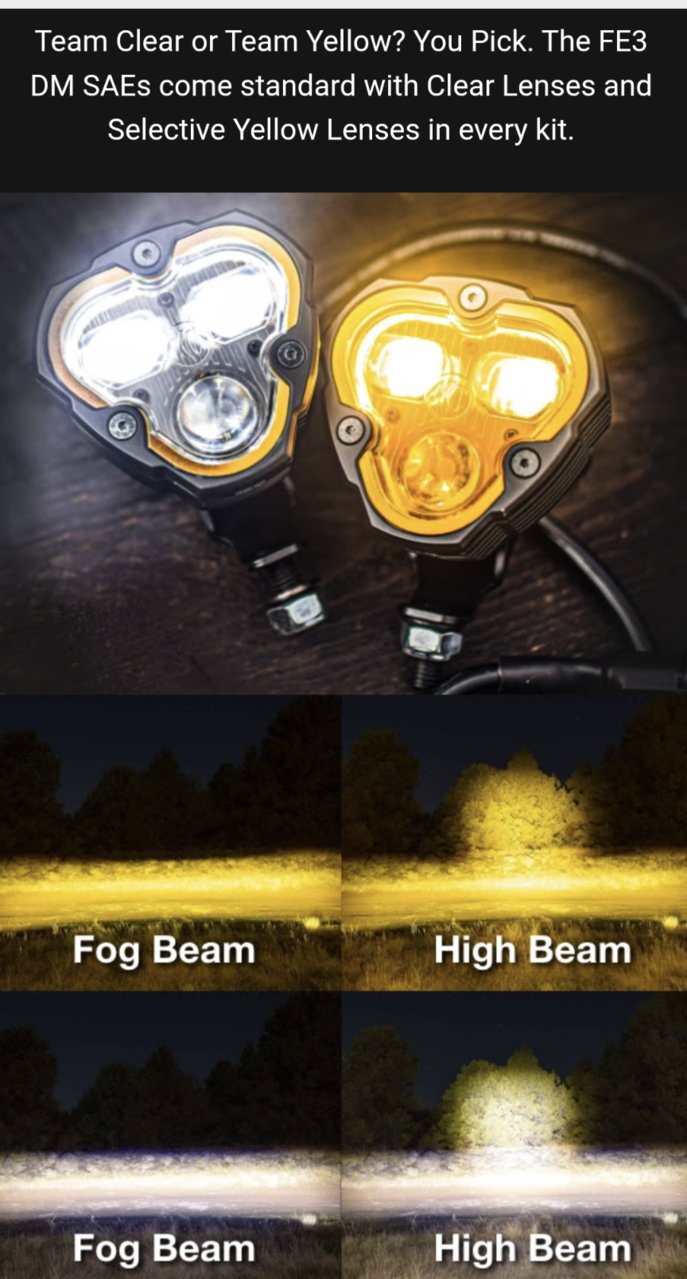

  15. Oct 25, 2022 at 2:05 PM
    #6075
    mynameistory
    mynameistory My member is well known
    Jul 3, 2012
    #81862
    1,046
    Tory
    Redondo Beach, CA
    4Runner
  16. Oct 25, 2022 at 2:12 PM
    #6076
    crashnburn80
    crashnburn80 [OP] Vehicle Design Engineer
    Jun 6, 2015
    #156893
    14,771
    Kirkland, WA
    2003 DCSB TRD OR
    They are not the first to have the fog and high beam integrated into one light. Would be interesting to test and see how they compare. One of the design issues though is you want high beams mounted up high, and fogs down low, so putting a high beam at the bottom of your fog location is certainly not optimal for a distance light.
    Toy_Runner and atc250r like this.
  17. Oct 25, 2022 at 2:14 PM
    #6077
    Too Stroked
    Too Stroked Well-Known Member
    Jan 24, 2017
    #208501
    3,912
    Tom
    South shore of Lake Ontario
    2021 4Runner SR5 Premium
    Interesting. Not sure I'd want a fog and high beam pattern at the same time though.
  18. Oct 25, 2022 at 2:16 PM
    #6078
    Jev425
    Jev425 Well-Known Member
    Mar 11, 2021
    #359001
    105
    Seattle Washington
    It’s technically 2 separate lights in 1. You have the low(fog) beam and the high beam with a 3 way switch.
  19. Oct 25, 2022 at 2:24 PM
    #6079
    Too Stroked
    Jan 24, 2017
    #208501
    3,912
    Tom
    Hmmm. The pictures appear to show both on at the same time.
  20. Oct 25, 2022 at 2:43 PM
    #6080
    Darthyota
    Darthyota Well-Known Member
    Jan 12, 2012
    #70487
    509
    Alberta
    Blown BSP X-Runner
    TRD s/c @ 9lbs, Unobtanium Welding 321SS Full Race Exhaust, B&M s/s, TRD 1st Gen CAI, sittin sic track ready drop, TSW Tanka's with 275/40/18's all the way around, 4300k hid's in headlights and fogs, with more to come
    Maybe not on something like a tacoma but if you had a low car with poor mounting options and could only get one set of lights in the grill it might be an okay compromise.
