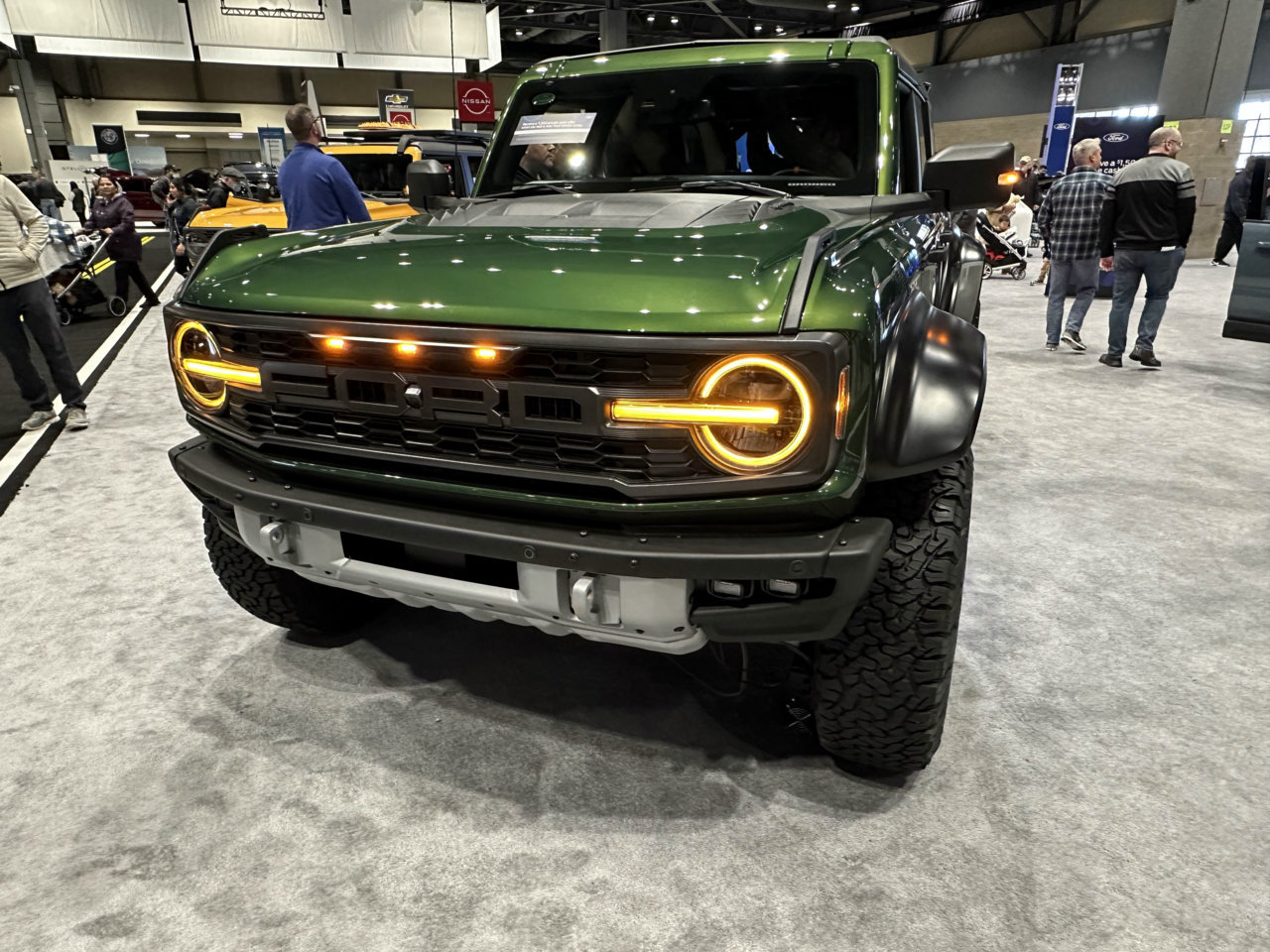

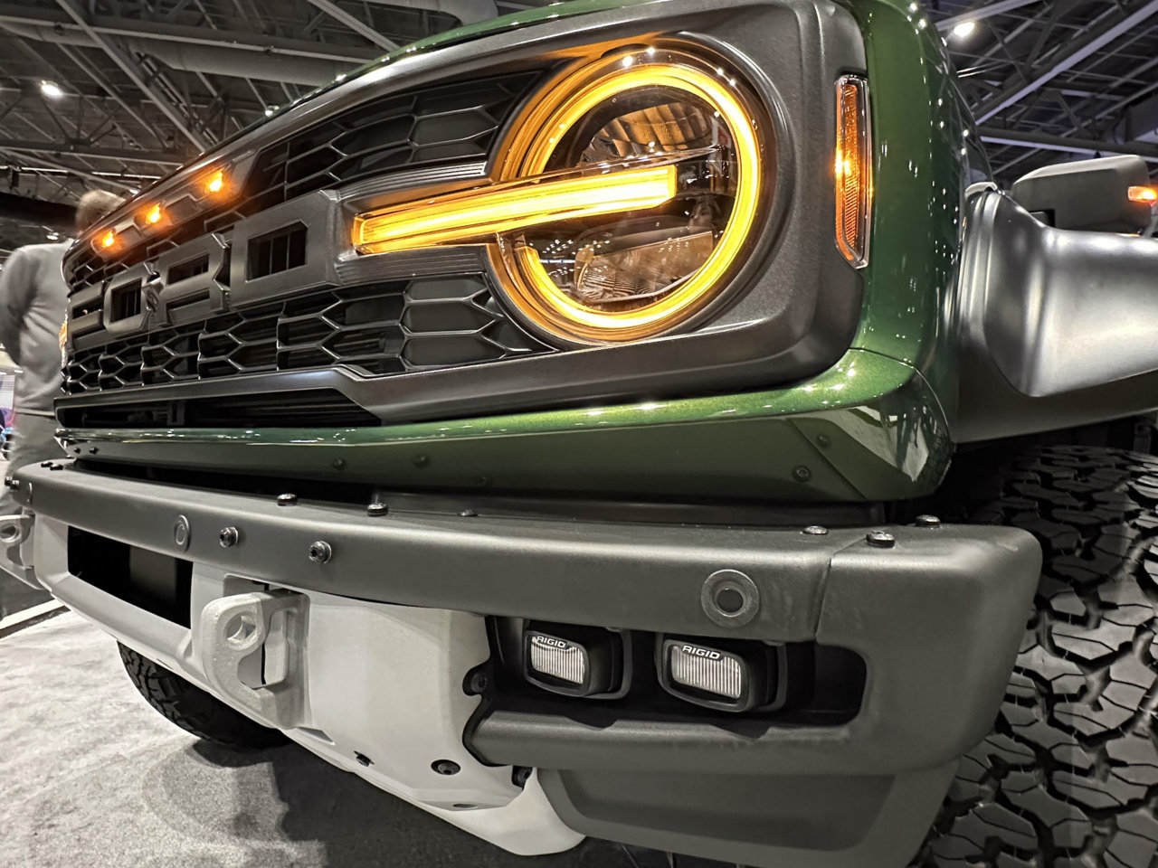

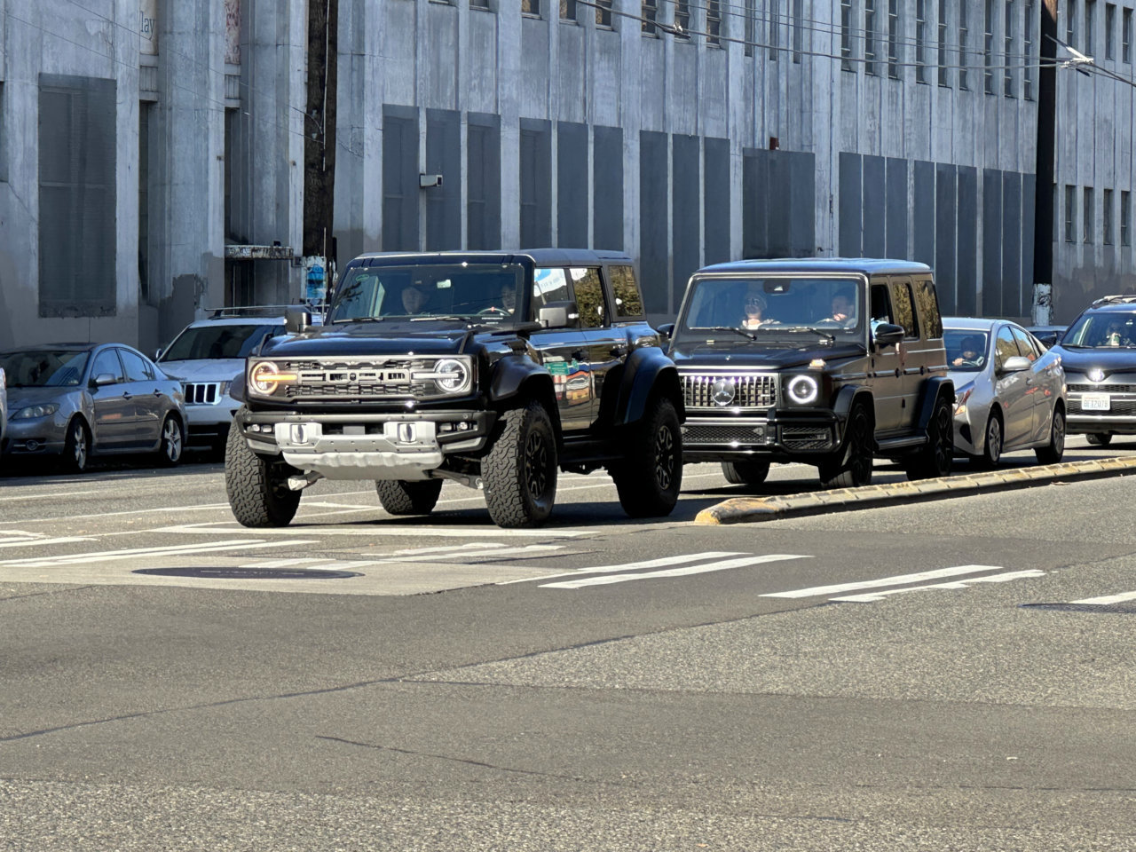

    Interestingly, the new Bronco Raptor uses Rigid SR-M fogs, like the Tacoma TRD Pro. Toyota's Pro Rigid units have a unique optic gradient that is not found on the standard Rigid SR-M fogs.
    Curious though, only 1 pair of fogs is legal to use on the street. The Bronco Raptor has 2 pairs.
    However, Ford's website has one pair shown with covers, and the on-site test vehicle also had the inner set covered.

    The f150 Raptor uses the rigid srm sae fog as well, but like the Toyota only uses a single.

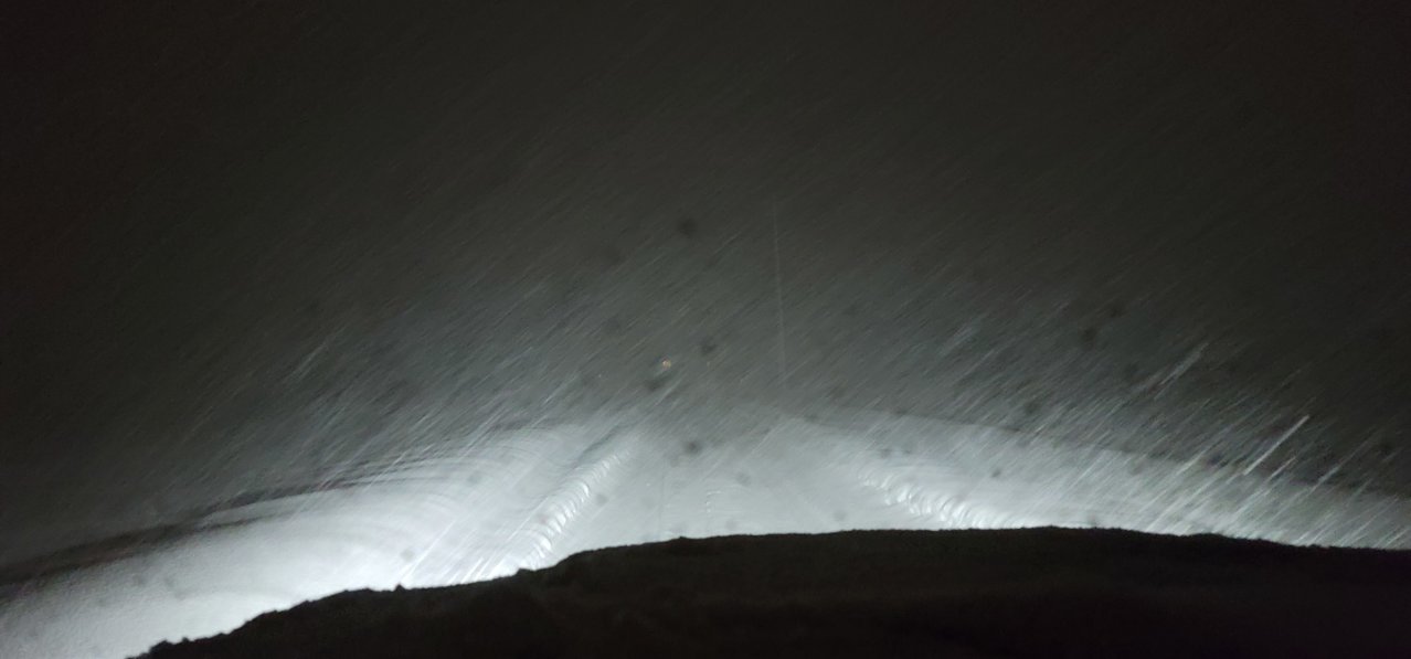

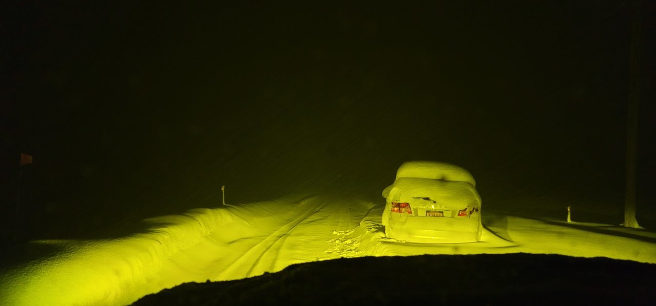

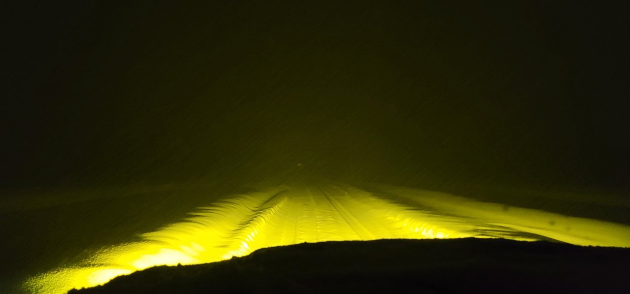

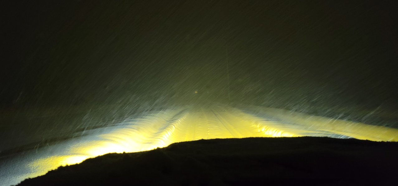

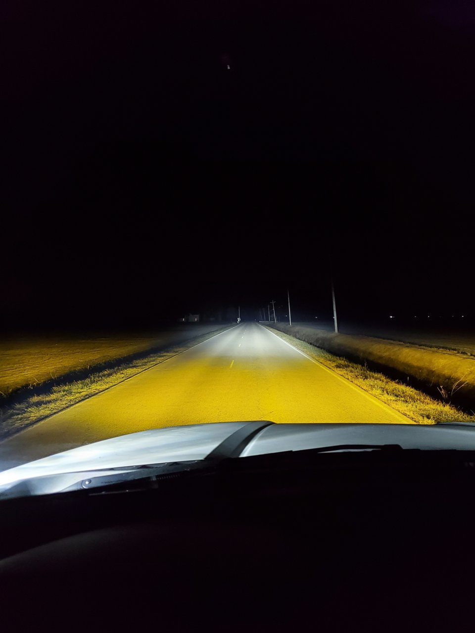

    I wanted to add some of my pictures from the recent snow storm we had. I changed out my stock fog lights on my 2022 OR and I went with the Diode Dynamics SS3s Max. 20221118_204000.jpg 20221118_204027.jpg 20221118_204038.jpg 20221118_204032.jpg

    Look at that cutting through the snow!

    Great pics demonstrating the poor weather superiority of selective yellow. As someone that regularly puts their fogs to the test crossing mountain passes in snow in the winter at night, that is a good depiction of reality.
