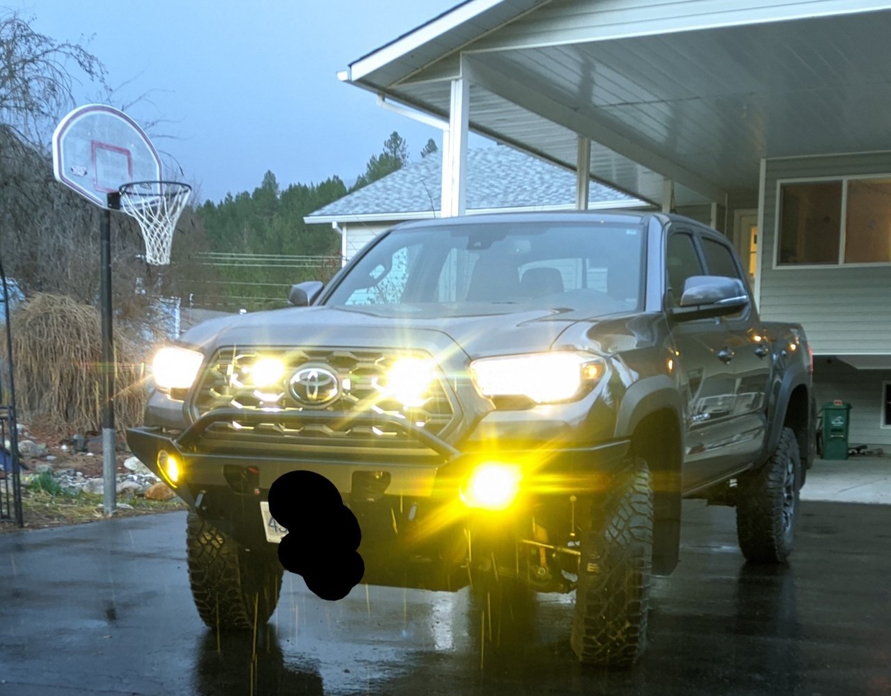

    I have pros mounted in an aftermarket bumper on my lifted truck (2.5" front). I only turn them on when required and I also spend a lot of time in the bush on forestry roads. Aim them properly, used when needed, and the bit of up spill works for me when offroad.
