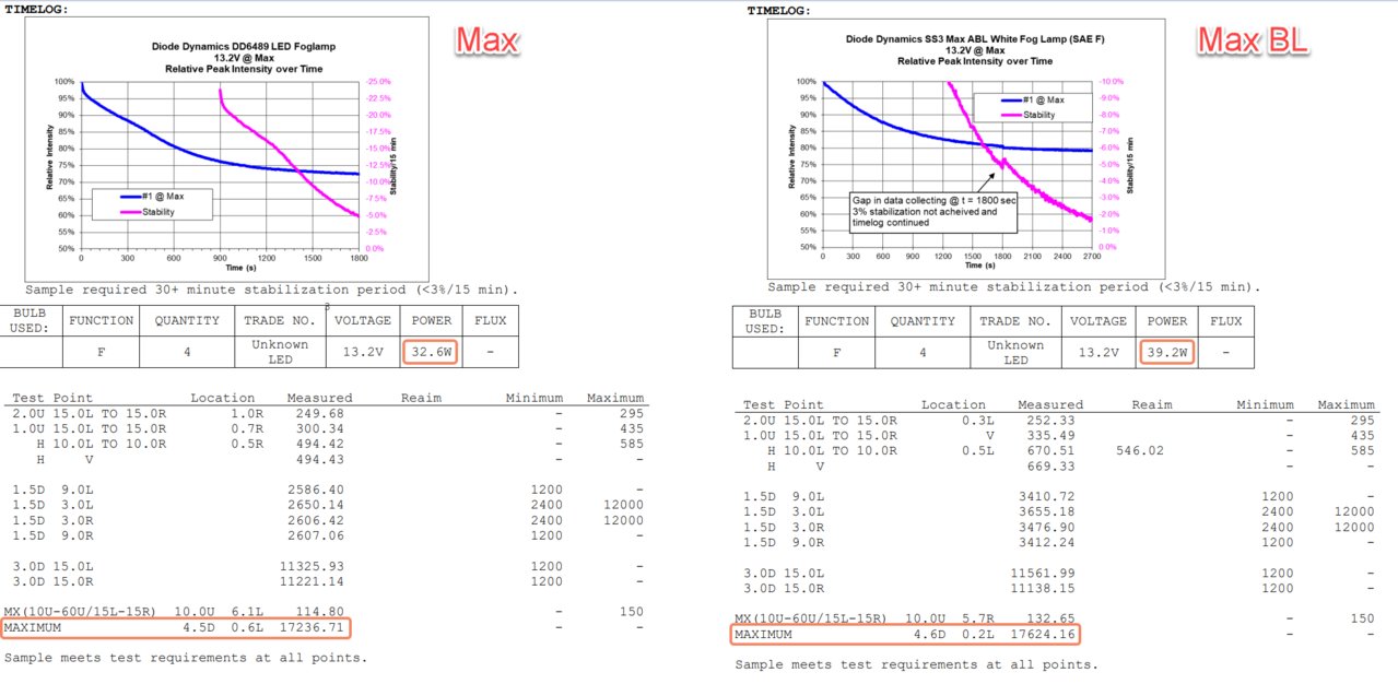

    @Diode Dynamics what are the official output gains for the 6000k white and 3000k selective yellow SS3 Max with the backlight vs the standard Max without the backlight? All beam patterns if you have the specs or if I have to ask for one, it would be the selective yellow in SAE Fog. Thanks.
  5. Nov 29, 2022 at 8:03 PM
    #6265
    Yoshi I
    Yoshi I Well-Known Member
    May 10, 2022
    #396897
    117
    Yoshi
    Not selective yellow data, but here are sample data I have obtained for white color. Max with back light improved stability at T=30 greater than 6% Power was bumped up by 20% but E-max increase was only 2%
    It's limit of heatsink capacity, but considerable amount of thermal resistance reduction is estimated.
    Total heat power is 20% higher with Max with back light, for snow combat potency is highest with Max with back light.

    Specs I've seen show similar power bump of roughly 20% but a slightly better output intensity increase of ~5%+. The backlight circuits have higher thermal resistance, accounting for the loss of efficiency despite the higher power. Regardless a few percentage points are not going to be perceivable to the naked human eye, only in good instrumented testing. So I'd call it a wash. If you want a backlight, buy the backlight. If not, don't. Personally I prefer simplicity and don't see the need or complexity for backlights.

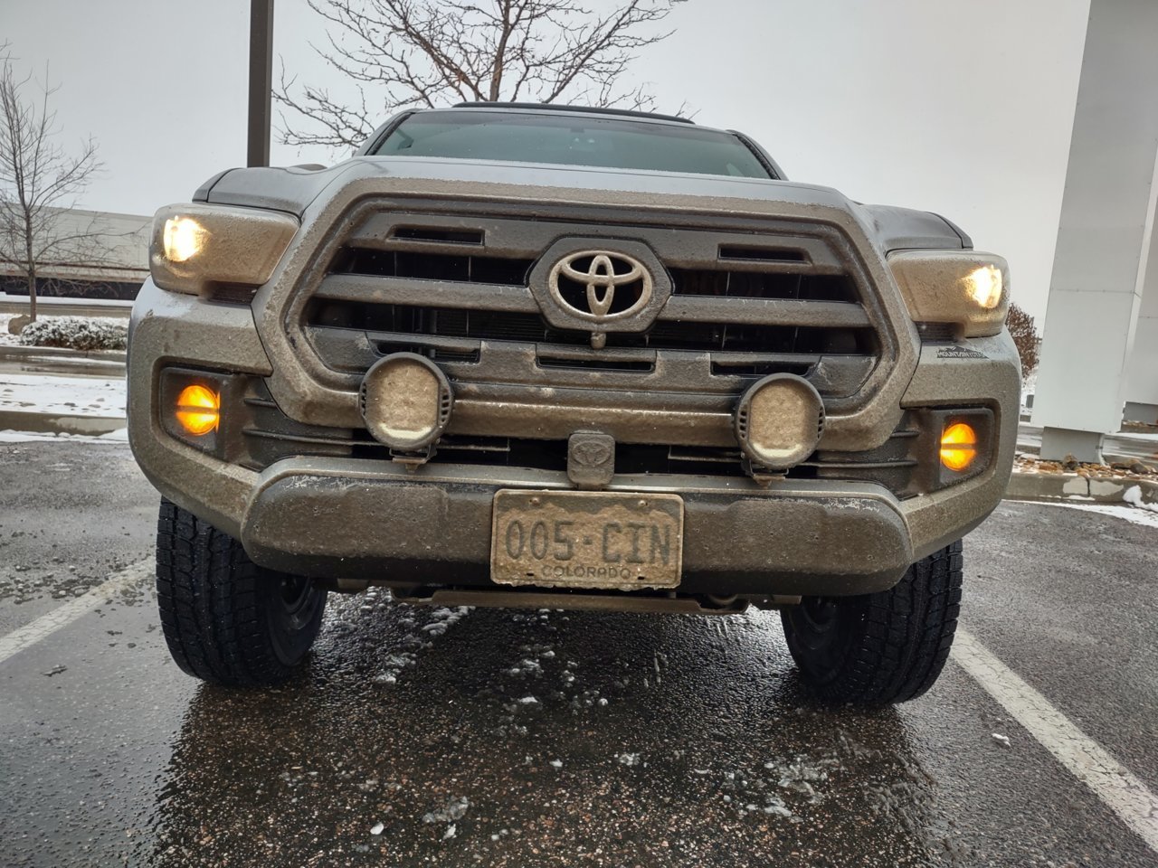

    higher elevation does not necessitate a need for non-DOT lights, I live at 7000' in Colorado.
    That chance of getting pulled over using them on the Colorado roads is high. I know quite a few that have LED light bars and have been pulled over while using them.
    Get a set of four dedicated winter tires and be much safer than blinding the person coming at you who is not on winter tires.

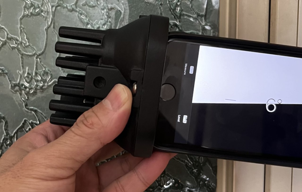

    We do not recommend aiming any of our products down by 6 degrees. This is only being recommended by our competitor who claims it is necessary to meet photometric compliance at certain points. We do not agree.
    Our fog lights (and I would argue most fog lights on the market) should be aimed according to the following instructions, which represents about a 1 degree downward aim.

    Ahh, thanks for clarifying that through my I70 winter road trip infused brain!
    Colorado MgCl2 crap covered halogen stock headlights and KC G4 fogs:
    My KC couldn’t melt/cut the MgCl2 from the lens the way the stock halogens did. The stock halogen fogs would melt the crap.
    IIRC the diode does not make much heat at all but the electronics powering it do though are behind the reflector.

    I think you are confused “cutoff line to be 1degree down ( 0.75D for F, 1D for F3) with beam itself aiming angle
    1 degree down only make sense IF fog beam has cutoff line right at the H line at straight aim (assuming SS3 front bezel surface to be perpendicular against the ground )
    But SS3 beam is vertically symmetrical. Peak at the H line center and spread upwards few degree
    Let’s say SS3 has visible cutoff line, but at straight aim, cutoff line is not at H line, to make that cutoff line to be 0.75D ( Or you can do 1D to be conservative), Entire beam must move 0.75 degree PLUS as much as angle beam spread above H line
    SS3 did not show defined enough cutoff criteria, so using method of test point that upper glare limit goes below allowance max, then beam center had to be adjusted to
    Pro 6 degree down
    Max 4.5 degree down
    this goes same for
    4Banger HXB need to be aimed 4.5 Degree down
    NCS 4 degree down
    that makes cutoff / or equivalent ( I call it’s equivalent because SS3 does not have visually referable cutoff line, line where glare amount become below regulation limit) 0.75D
    4Banger HXB also does not have visual enough cutoff to me
    So to make it SAE F table to be satisfied,
    Based on angle adjustment is only way to prevent glare.
    if you only aim “beam to be” 1 degree down, large amount of upper spread, even main brighter band will point at directly to oncoming driver.
    0.75( or 1 degree down) definition is “ cutoff line to be” down. Not beam.
    I show you visual explain in a bit.

    I realize there may be some confusion in the reference point used - of course, an average consumer cannot aim properly based on an H/V center reference, they need to aim based on the tools they have, which means adjusting with reference to the top cutoff.
    Again, I recommend aiming based on the instructions linked above. I appreciate your input, but I think you are complicating this a bit more than necessary, again, for the average user of these products.

    Ah, so the 20% increase in power consumption for a max w backlight means more heat in back but not necessarily hotter lens where snow melt matters. Super good point there.
