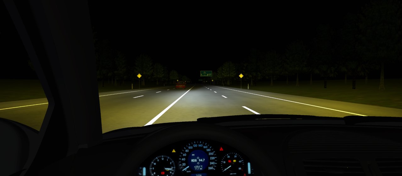

    I got images ready, let me explain one by one what SAE F function fog mean. Since this is SAE J583 thread.
    First step is to understand what is proper aim of proper fog lamp.
    In J583 F regulation, lamp shall be aimed so maximum gradient (=cutoff) align to 0.75D 0.75 degree down from H line ( horizontal reference line= lamp center )
    This equal to what many heard about
    4" down at 25'
    This is easier if fog lamp beam has actual visually distinct enough cutoff line.
    Many fog lamp are designed at straight aim without adjustment, typically beam cutoff aligns about 0.75D to 1D ( 1D is used for F3 regulation)
    And H line maximum intensity to be no more than 585 Cd ( definition of glare)
    But issues on many offroad pod fog lamp does NOT have referable cutoff line. And many of lamp is designed with vertically symmetrical beam. Unlike some of fog lamp intended fog lamp,
    many offroad pod LED fog has peak in the center, spread upper and lower about same amount.

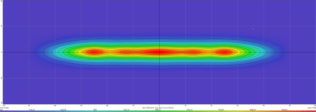

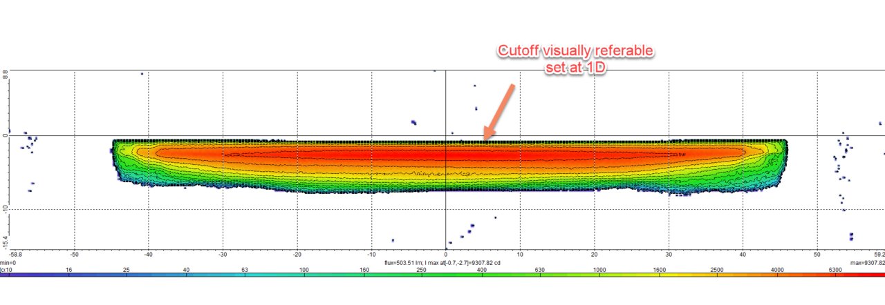

    For example, this is Pro beam I made optical mock up ( I even recreated 25R/L island brighter spot of SS3 beam too!)
    To make this beam work with SAE J583 F function
    Rule is to make cutoff at 0.75D
    But then, where is cutoff? Can you tell?

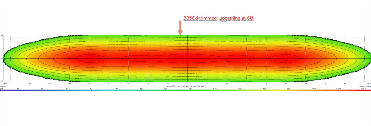

    Based on 585Cd maximum allowance for glare, I trim beam with 585Cd threshold, and it look like this.
    585cd threshold is at 6 degree up line.
    This is the reason I suggested 6 degree down aim for Pro if user want to use as SAE Fog ( at least to prevent above regulation limit glare)
    To make this line at H line, entire beam must be aimed 6 degree down.

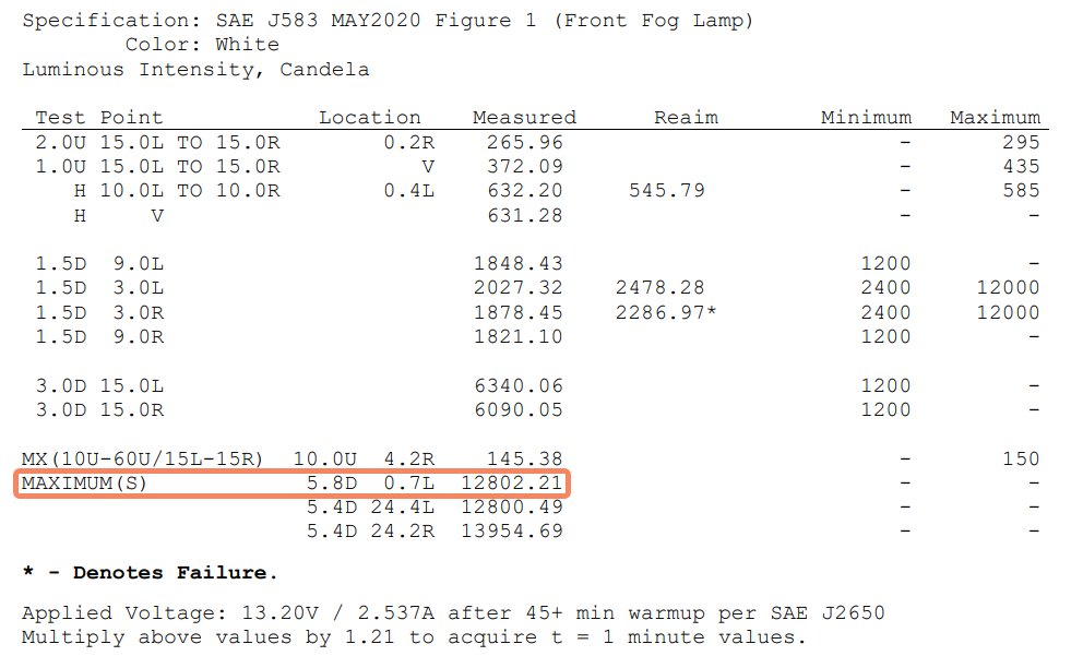

    This is photometric data of Pro white.
    SS3 did not have defined enough cutoff criteria, so I requested to make it work at least on photometric table itself by keep aiming down as much as needed to make H 10L - H 10R ( horizontal line from 10 degree left to right) maximum intensity below 585Cd.
    This way, at least beam is not causing glare defined by J583
    and here is no glare aimed Pro.
    Maximum at beam center is 5.8D down. ( entire beam had to be aimed 5.8 degree down, the reason I suggested 6 degree down aim)
    My suggestion is consistent to obtained data.

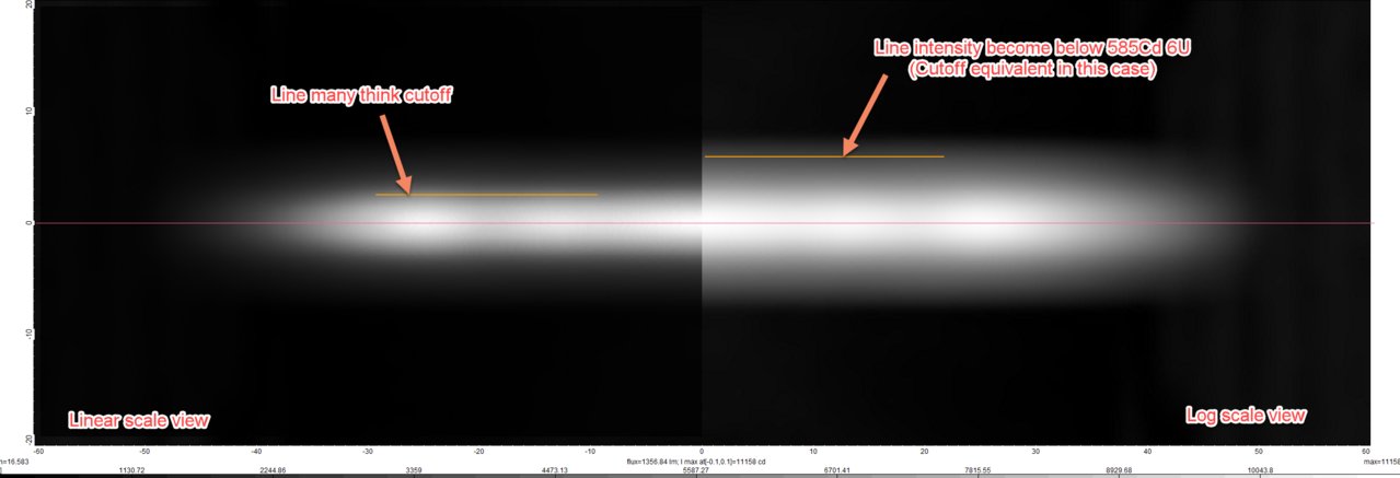

    Something to note, SS3 Pro had E-max at 24R! not center. This translate to extremely strong performance at far side view angle illuminance capability at offroad usage.
    Visual translation in gray scale view, for more familiar beam appearance.
    Left is linear and right is log scale view.
    Linear view is most likely what many see, and have impression of.
    Can you tell where is cutoff line?
    Vast majority only can guess cutoff by, somewhat brighter impression zone. Many think cutoff is visually somewhat brighter impassion upper edge.
    Which is around 2.5 degree up.
    But if you based on this line, still large amount of above glare limit beam scatter leak upward.
    Actual glare limit safe cutoff equivalent is much higher than many think.

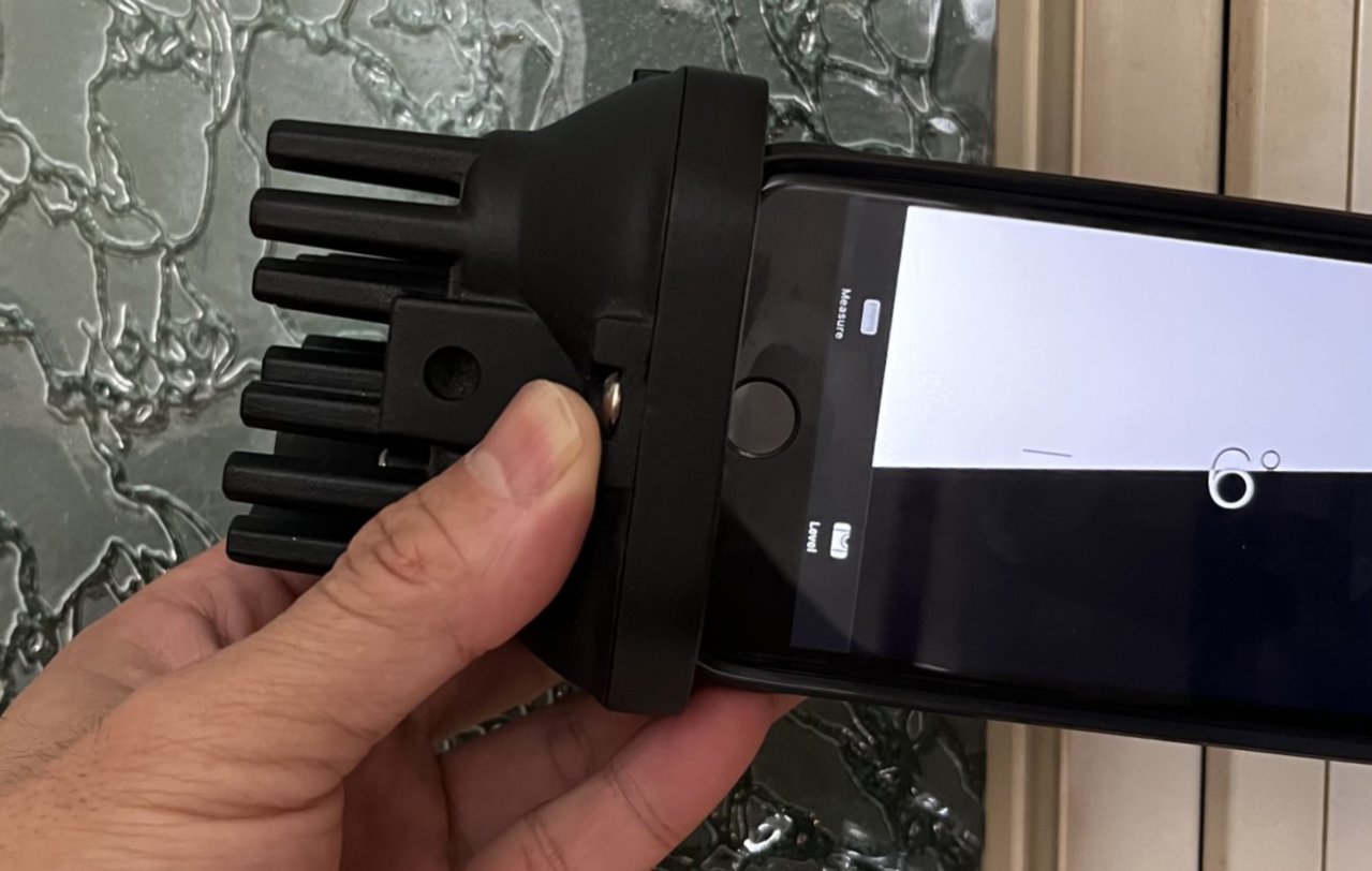

    And this is the reason I suggested to use phone app, digital level. That's only way to accurate achieve proper aiming to prevent glare.
    Because this is the angle photometric data shows safe for glare defined by SAE F function.
    IF someone wrongly believe and aimed lamp based on guesstimated cutoff line, and do 1 degree down for example,
    anything above 3.5 degree to 6 degree spillage will be facing directly to on coming traffic.
    This is particularly tricky, because SS3 Pro really don't have visible cutoff, many not understanding definition of cutoff, guessing wrongly.
    Not understanding causing glare to oncoming traffic.

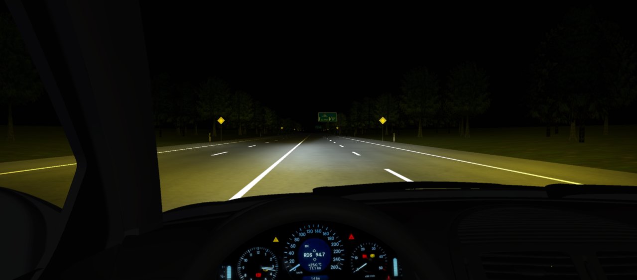

    For example, on the wall, since fog lamp is mounted lower than headlamp, it will give false impression of my fog beam is way below low beam such as image below.
    But this is how it look like 1 degree BEAM aim down ( which still is causing severe glare)= cutoff equivalent line is still 5 degree up.
    This is the estimated impression of beam aim 1 degree down by wrongly understood aiming process.
    You won't see much of beam reach above low beam cutoff, this also gives false sense of my fog isn't blinding.

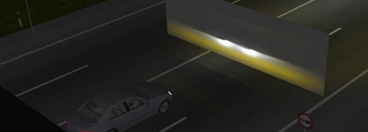

    But when add oncoming vehicle at 50m, this is what actually happening.
    If somehow someone define guestimated visual cutoff( at 2.5 degree up line), and carefully align that to 1D line, that will be 3.5D beam down.
    And this is expected impression
    Top 2.5 degree of above glare limit upper scatter still hit oncoming driver

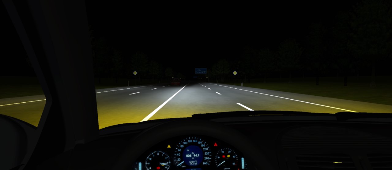

    for reference, at 6 degree down aim this is how it should look like
    I hope those visual reference help more user to properly educate about aiming, and beam character of each lamp.
    This was case study using SS3 Pro, and the reason I keep saying strict aim protocol. And the reason is based on photometric data set.
    And only reason I am strict about here is, because this is SAE J583 thread.
    Enjoy lamp with understanding, and if you go outside of SAE regulation, then enjoy accordingly. with proper education, I am certain you will know when and how to use lamp for your best interest and optimum way.
    But if you don't know about detail, you maybe blinded by "term" of SAE, and wrongly causing severe glare.
    Summery
    Fog lamp must be aimed so CUTOFF line 4' below lamp center at 25' of distance. ( this only possible with fog lamp with actual defined enough cutoff)
    SS3 Pro does not have visually referable cutoff to aim properly.
    Therefore, to make it simple for average users, I suggested to use Level app.
    SS3 Pro 6 degree downward suggested
    SS3 max 4.5 degree downward suggested
    If you use elite, then use very defined cutoff line, adjust to 1 degree down ( 5.2" down at 25' F3 aim)
    if you use 4 Banger HXB 4.5 degree down NCS 4 degree down
    4 Banger HXB is too bright and cutoff also not sharp enough to my opinion, I do NOT suggest for onroad fog usage.
    If you want to use because of snow melt, aim 4.5 degree down, don't attempt to aim with visual guess, cutoff is still too weak, and can glare severely with wrong aim.
    And lastly, this is the reason why photometric data set is extremely important. It looks Ok, no one flashed me has no validation to fog beam isn't blinding. SAE j583 is designed for on-road use.
    If anyone has question about SAE F function, feel free to ask me. I try my best to share as much information I have, or studied.

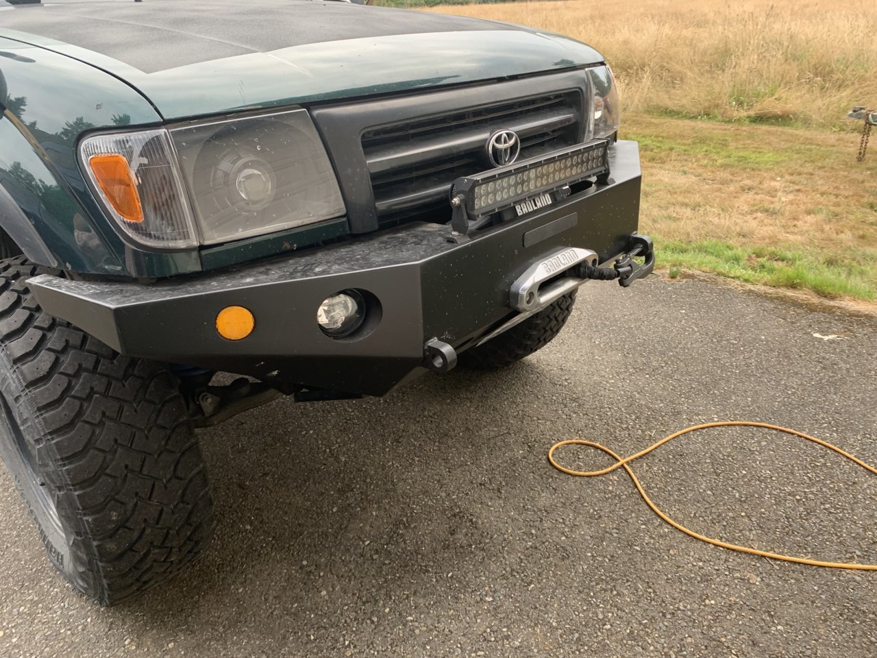

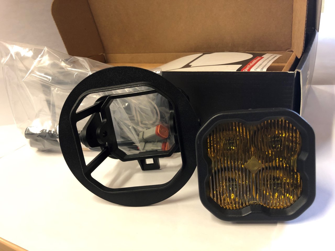

    Thinking about my install of my @Diode Dynamics SS3 Sports in selective yellow, I'm pretty sure I had to push the lights all the way down and tighten the mount.
    I have these installed in my factory bumper on my 2010 Taco.
    I feel like I don't have the proper adjustment to go low enough. The metal "pin" with the ball end also doesn't fit in to that plastic piece. I followed all the instructions, but I feel like the fitment isn't the best.
    I was able to meet the 4" @ 25ft but the rotation is maxed.
    I hope this makes sense... lol

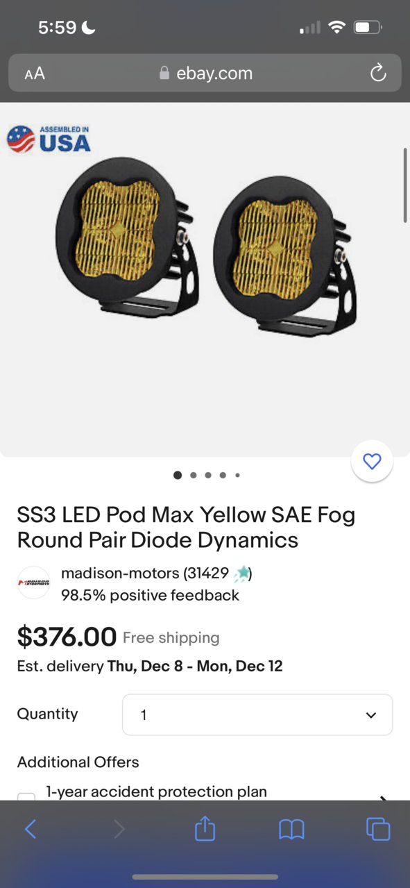

    I stumbled onto a bit of good luck- SSC3 Max amber fogs for $403 and some change after tax and shipping, pretty stoked! 4590366E-6463-4A36-B0FA-824DDB846158.jpgI checked the posting and they went up to $418 shipped before tax, so looks like I scored.
    Checked the seller before purchase, Madison Motor Parts is on Diode Dynamics approved sellers list, fingers crossed I’m getting what I expect.
    I’ll use them to replace some Morimoto XB fogs. I was driving around in the snow a few days ago, perfect conditions for everything to stick to the headlights and fogs, 1/2 hour and I lost probably 20% of the usefulness of my headlights and the fogs were almost useless.

    02C392A0-A30F-45F6-8CA4-02F81D9591B1.jpg I fabricated the holes to for the XB’s. I’ll have to rework how I mount them as the XB’s use a stock mounting system for a late model Toyota, so likely just weld a plate across the hole at the depth I want them to be recessed at. I intend to set up the mounting so I can adjust height and level, something that wasn’t as easy to adjust with the XB’s, though I had them adjusted properly and only used them when I needed them.
    The truck’s no longer my daily driver, honestly it feels like a bit of a waste of money and not sure how often I’ll drive it in inclement weather, it’s more my summer camping rig now. I question whether I should have bought a fog light upgrade for my 2018 Silverado. I really like Diode Dynamics, I installed 35 watt upgraded headlights for my Silverado, huge improvement over oem 20 watt.
