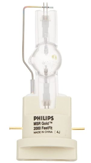

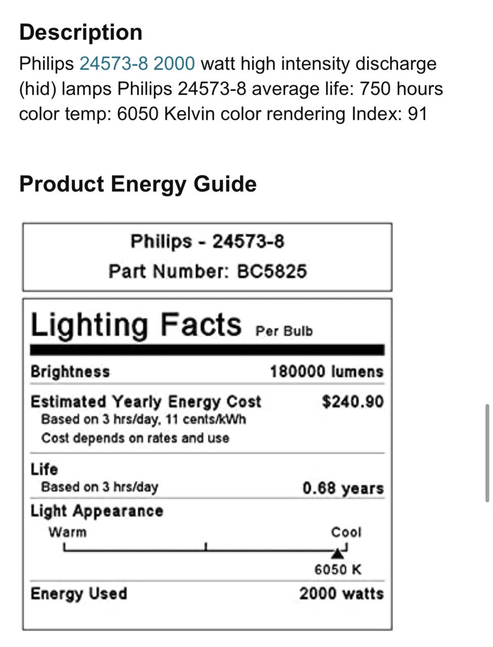

    Which is a real bummer. This miniature 2000W HID bulb could do such great things for offroad applications... or fog lights (see, it's on topic)

    180,000 lumens. :rofl:
    Granted you’d need quite the alternator upgrade to run a pair.

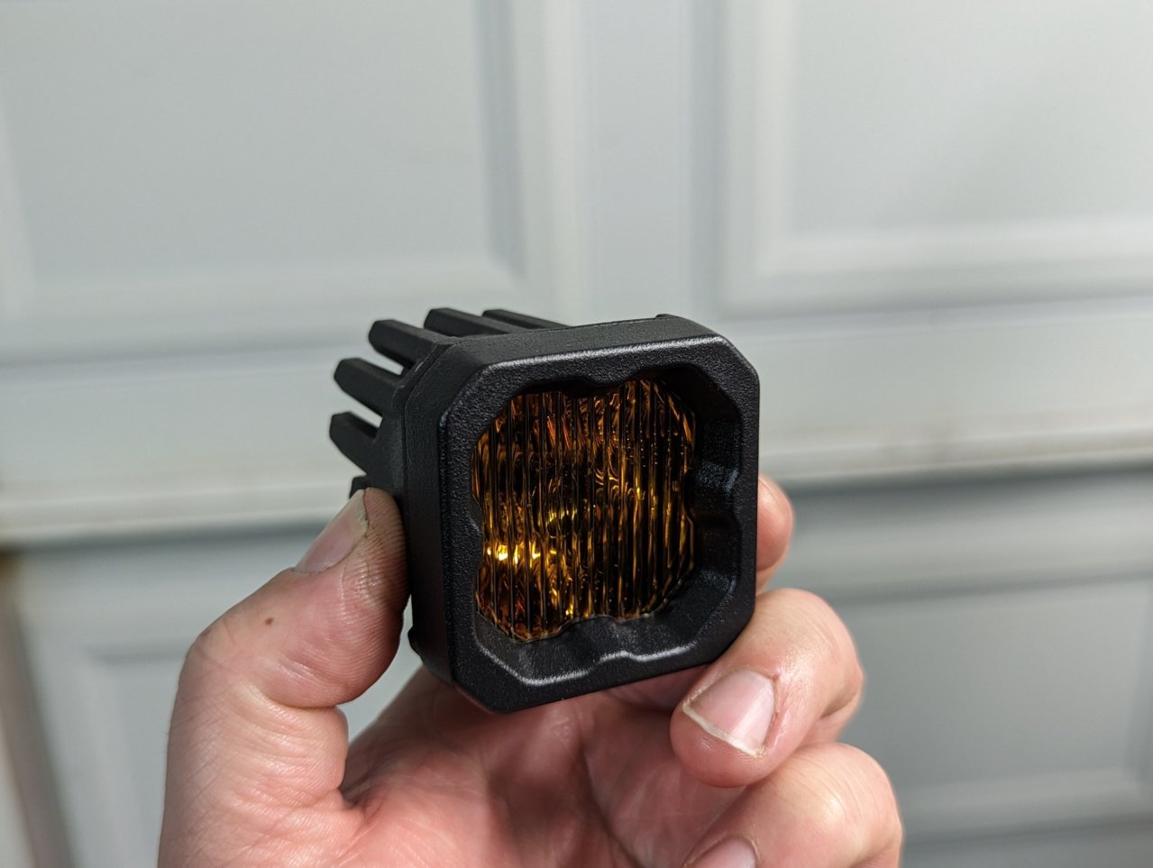

    I believe the "Pro" SSC1 uses a cree xhp-50, which a 4 die LED utilizing (4) cree xp-G dies. I'd assume based off the lux/lumen rating the sport models use a single xpl-Hi (same LED as the SS3 pro). While the boost HX *can* handle 8+amps if kept cool, the LEP ssc1 model would still get much higher spot intensity.

    I think the fog SSC1 is the only one in the lineup that has boost HX chips.
    https://www.diodedynamics.com/stage-series-c1-yellow-sae-dot-fog-standard-led-pod-pair.html
