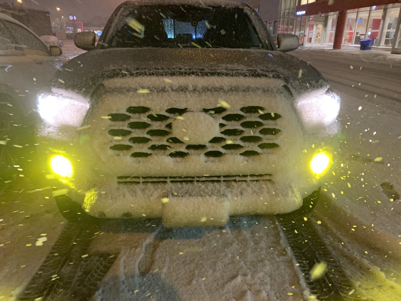

    Installed the elite fogs. Had the opportunity to test in some rain then sleet that transitioned to wet snow. They worked great in the rain but they completely packed in with snow and had zero benefit. Not he best photos it was a challenging drive and I wanted a few beers. Hopefully in colder weather they will work better. Remarkable in clear conditions.IMG_2103.jpg IMG_2098.jpg

    They dont generate enough heat for heavy wet snow, if its cold and or dry snow they should be fine.

    That's too bad. I'm leaning towards the Elite's myself, but it is disappointing they aren't hot enough to melt the snow build up. I prefer the round OEM look.

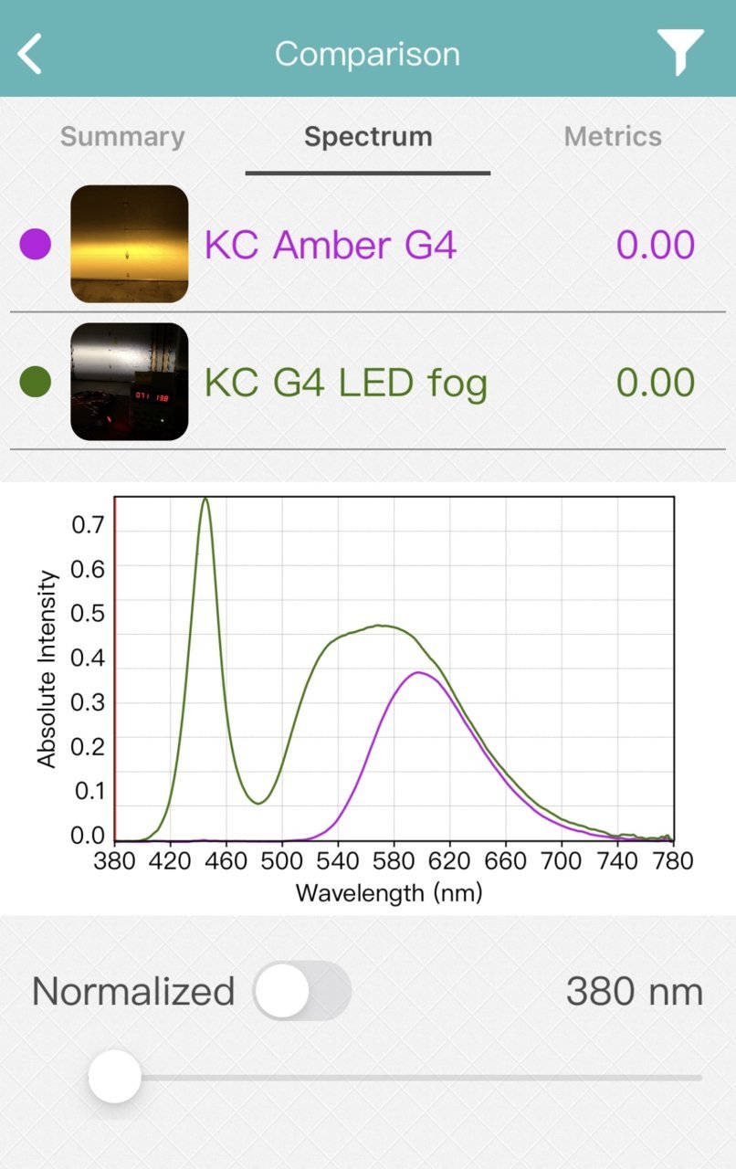

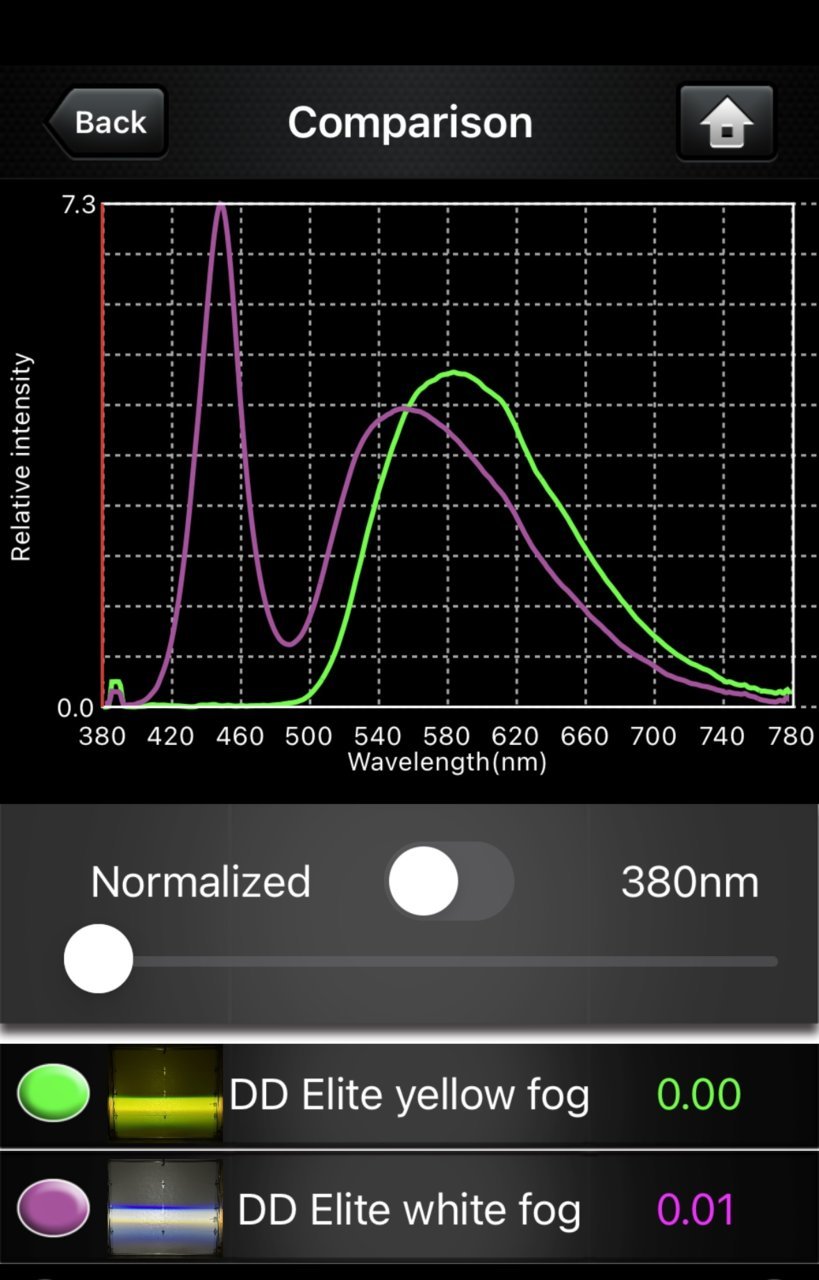

    When I started this thread there were only white LED SAE fogs, the KC G4s had the best color temp at 5000k, but all the others were at 6000k+. 6000k makes for a poor foglight for use in poor weather conditions, which is the sole purpose of a fog lamp. 6000k is highly reflective off of rain/snow/fog or wet road surfaces and people are more sensitive to short wavelength blue light so that reflected light is going to have disproportionate negative effects on visibility. Anyone with 6000k LED headlights driving in snow has experienced this compared to driving in snow with halogens. There is a significant Star Wars light speed effect that makes it difficult to see the road beyond the radioactively glowing snow fall in the foreground reflected by the the high color temp lights. Bluer light is also more difficult to visually process than warmer color temps. Personally I would not run any of the white LED products and after testing nearly all products on the market I continued on with my OEM H11 halogen fogs, which also had the benefit of melting snow.
    When the KC Amber G4s hit the market, they were the first non-white SAE LED fog. For the first time an LED SAE fog didn't have the problematic short wavelength high color temp light. It was a step forward for actual poor weather use. Morimoto followed soon after with an amber version backed by Kustom54lighting. While eliminating the short wavelength high color temp light was good, the amber fogs were very monochromatic (especially Morimoto) and the output intensity was rather poor. OEM halogen fogs were still higher performing. At this point in time for those wanting LED fogs, amber did look appealing over white.
    Reviews: KC Amber, Morimoto Amber
    You can see how the ambers remove the sub-500nm reflective light from the spectrum, whereas the white LEDs have a huge short wavelength high amplitude spike. Unfortunately though total output intensity is also low, as determined by area under the curve.
    Rigid then came out with the first SAE selective yellow fogs with the D-Series Rigid Selective Yellow. Monochromaticity was no longer an issue, the output was substantially improved over amber, and for the first time color filtration produced a heated lens. Everything for performance was better than amber, but the square pod did not mount easily in a fog location without drilling and the use of adapter plates. Then Diode Dynamics SS3s came out with selective yellow fogs that mount into the OEM location, provided substantially higher output than Rigid, had higher power options that ran hotter and provided a richer yellow and it made all other LED fogs obsolete at that time.
    Reviews: Diode Dynamics SS3 Max, Diode Dynamics SS3
    You can see that selective yellow also eliminates that sub-500nm light, but doesn't take the same output loss as amber. There is more output in the 500-540nm range, but it isn't in the offensive category like that high amplitude spike of the short wavelength light of the white fogs.
    So the recommendations have continued to evolve over time based on new technologies and new products.

    Certainly not surprised, this was called out in the review. Good pics though backing what was stated in the review. For snow conditions the SS3 Max in selective yellow is what is recommended. Data in the selective yellow max post shows the extreme lens surface temps and I've personally put them through blizzard conditions in the mountains where all lights failed due to snow but the Maxes remained perfectly clear.

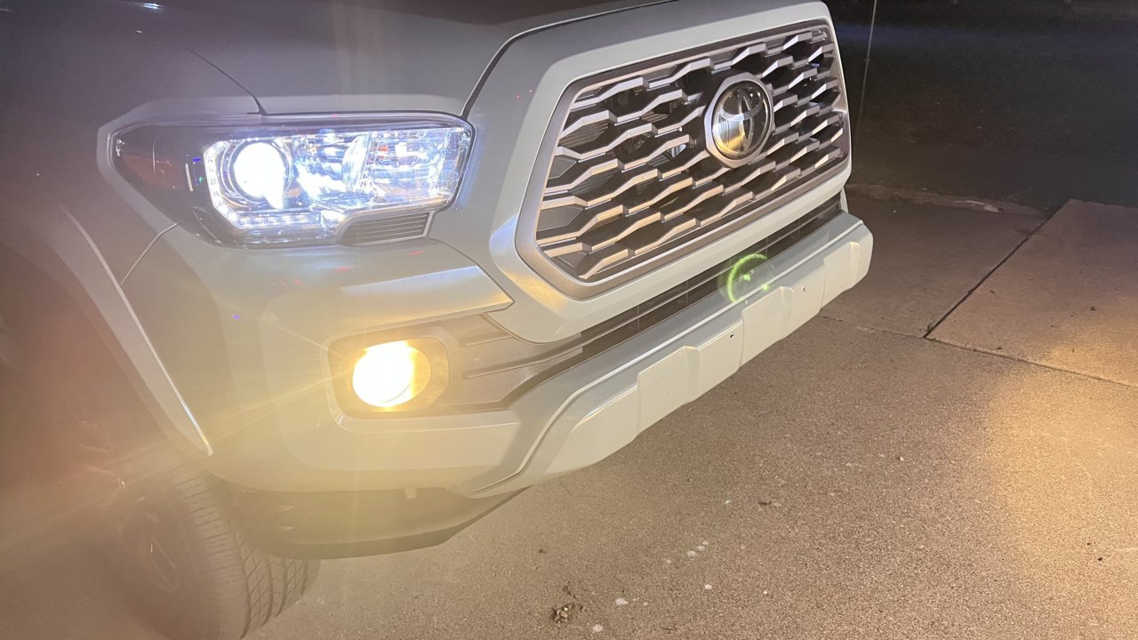

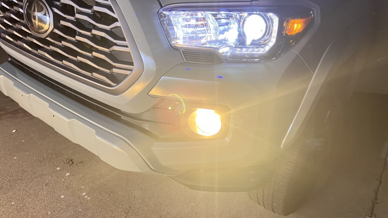

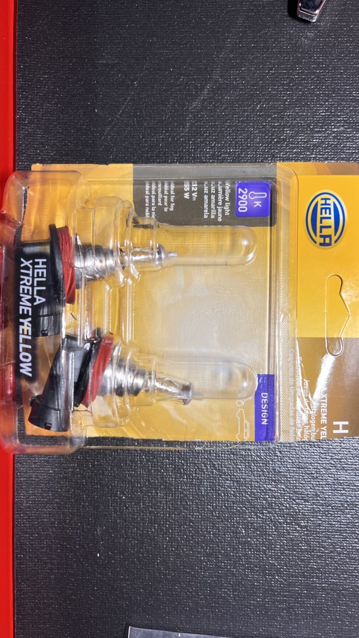

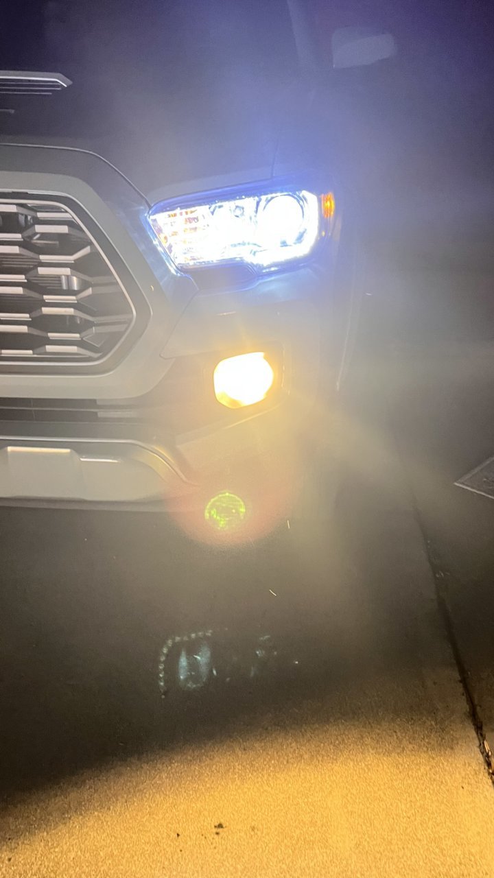

    Nice and bright yellow LEDs I suppose so I just installed some super yellow hella bulbs in to my fog lights these are rated at 2900k
    I was more in to the way they look when I’ve seen others but these did added some easier. Visibility in the dark; I literally had them on for 15 minutes and started this search so I might post later once I get to drive at night some more and share my thoughts.yours look awesome
    I’ll post a couple of pictures in case it helps anyone to compare

    Yellow bulbs are lower output than stock bulbs due to the yellow filtration coating which removes short wavelength higher color temp light to shift the color to yellow. All filters remove output. That said halogens do not have a lot of high color temp light, so output loss is minimal vs trying to make a halogen whiter by removing warm color temp light, which is the bulk of the halogen output.
    These look like your stock bulbs in the Hella blister pack, since the Hellas are visibly yellow.
    What are you running in your headlights? Those appear pretty high in color temp, but cameras can sometimes skew the perceived color when photographing light sources that differ in color substantially.

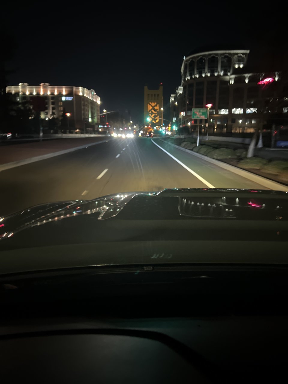

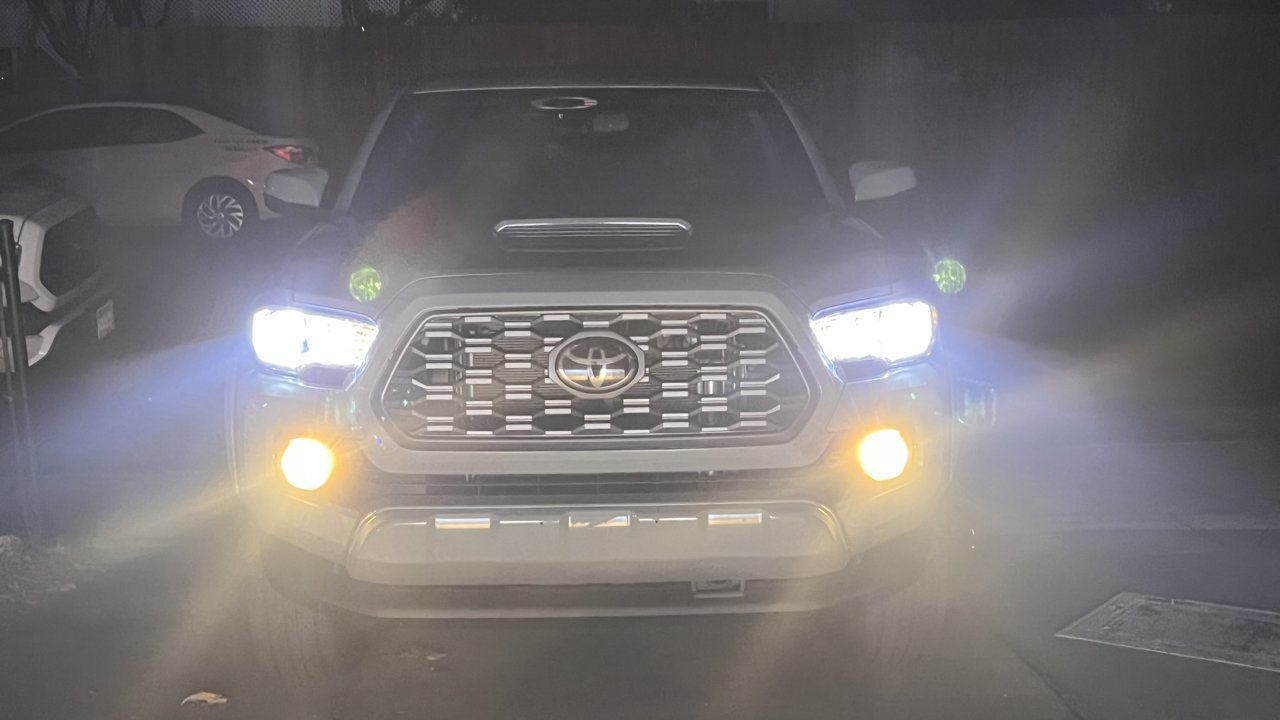

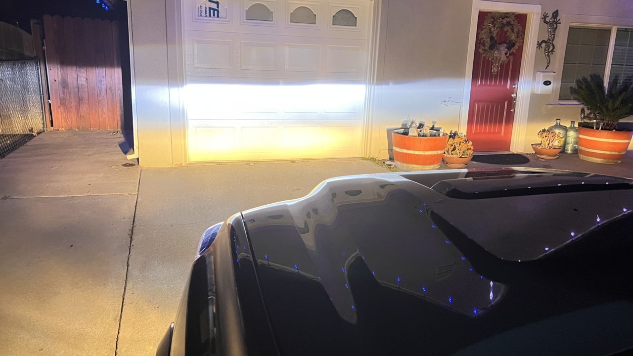

    image.jpg I’m actually running Sylvania LEDs they are quite brighter than stock as my truck was not originally equipped with LEDs
    My understanding is the same brand makes The fog light LED replacement bulbs I might try those in the future instead of the yellow Hellas
    I went driving for a few minutes they are actually cool looking and the current LEDs are bright enough to the point I don’t think I need anything brighter but the pursue of change will most likely kick in and I might try something else in the near future lol!

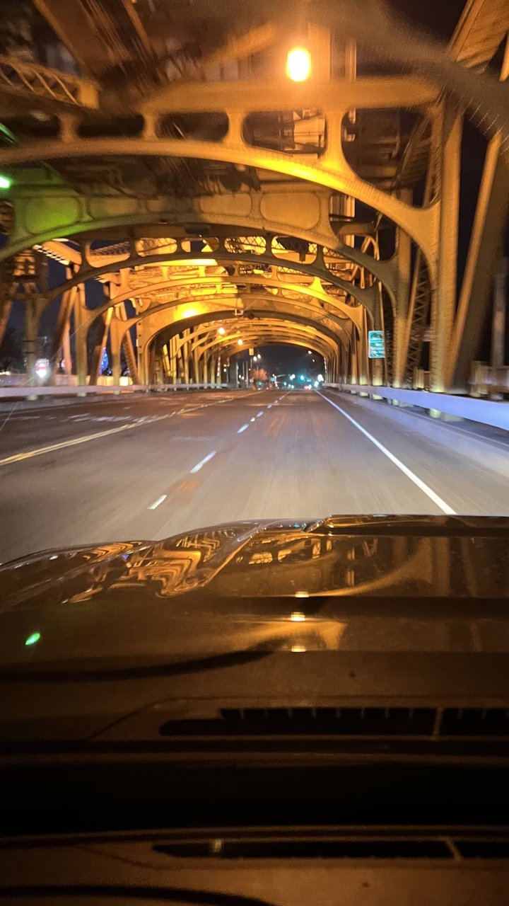

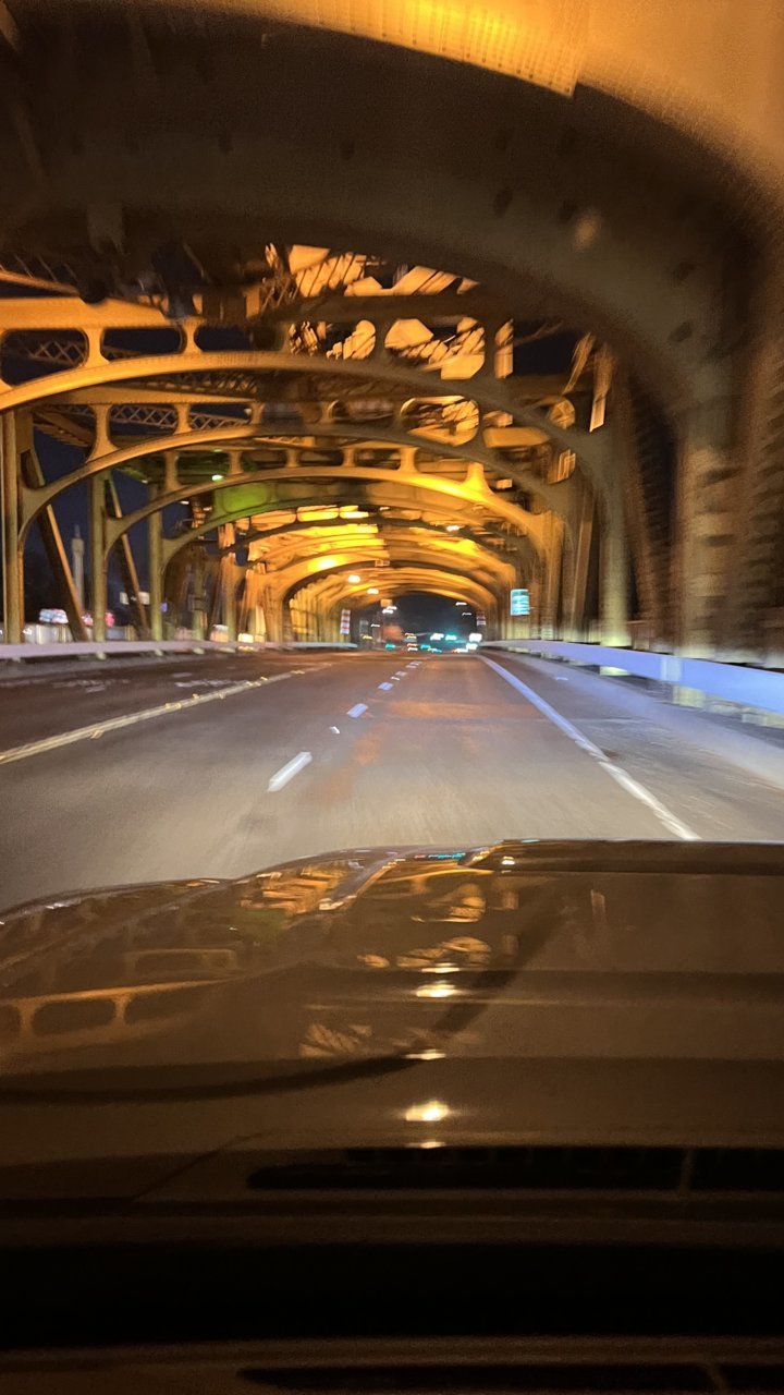

    Here is at the Golden bridge in sacramento California 0046A771-C77B-4390-AD22-4CA6E68D1B76.jpgD08B11CE-839E-4F4F-B39B-5E2E48886F22.jpg

    The Sylvania LEDs are actually a downgrade from stock. You've lost distance projection and output intensity while shifting your pattern to foreground light which makes you believe you can see better even thought the opposite is actually true. Sylvania does not sell their headlight LEDs in North America as replacement LEDs for use in headlights on public roads is illegal in the US, so Sylvania only sells their low powered, low output replacement fog LEDs in the US. Many vendors will mislead consumers selling the fog bulbs as headlight bulbs, even though they are far too underpowered for a headlight product. To have the actual Sylvania headlight LEDs you'd need to directly import from Europe or Japan, if bought domestically you have the low powered fog LEDs.
    But let's just assume you did the research and went above and beyond to import headlight grade LEDs out of Europe like I did, rather than running domestically purchased Sylvanias which Sylvania explicitly warns should never be used for headlight applications due to inadequate output. You can see the Sylvania LED headlight bulb review posted here. Not a recommended product. If wanting to run LED the recommended product is OEM LED covered in post #3626 here. If set on wanting replacement LEDs, the Morimoto 2stroke 3.0s is by far the best option covered here, however they are easily outperformed by halogen upgrades in the halogen projector.
