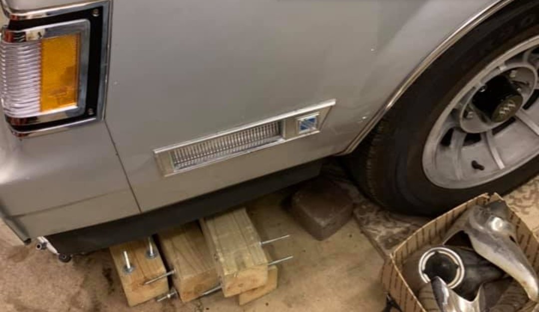

    As discussed, anything above your headlamps wouldnt be legal to use on the road. However your basic idea is neither novel nor illegal (state regs may vary). A lot of vehicles used to have turning lamps or cornering lamps which were illuminated when the turn signal was activated. This would actually be a perfect use case for a small pod such as the SSC1 or SSC2, in the white lens (federally speaking fog lamps that provide a cornering light function, or lamps used as cornering lamps must be white, fog-only lamps may be either white or selective yellow). The fog lamps optic woyld be a better choice than the driving light optic, as it would provide a much wider pattern to illuminate the side of the vehicle/the roadway.
    You could tie these to trigger off your left/right turn signals independently with a latching relay so that they dont flash on/off with the signal, but you don't have to turn them on or forget to turn them off. The additional load of the latching relay shouldnt be an issue on your existing fused turn signal circuit.
    For example take a look at the cornering lamp on this buick regal (quick pic via google)
