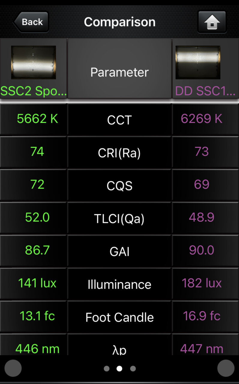

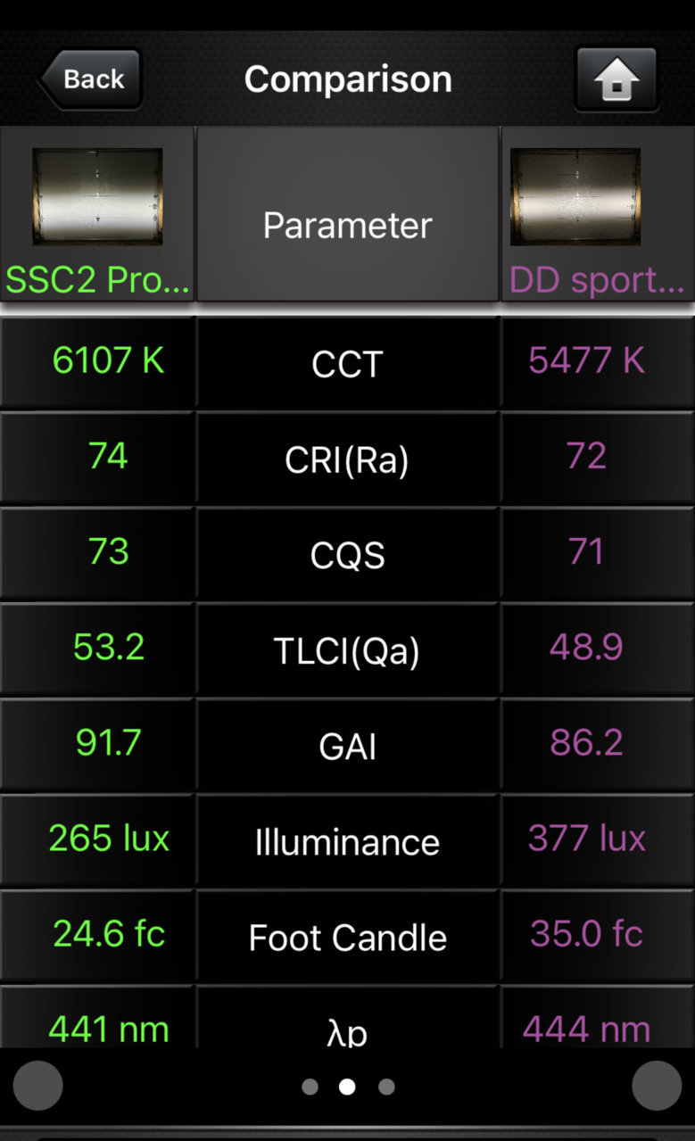

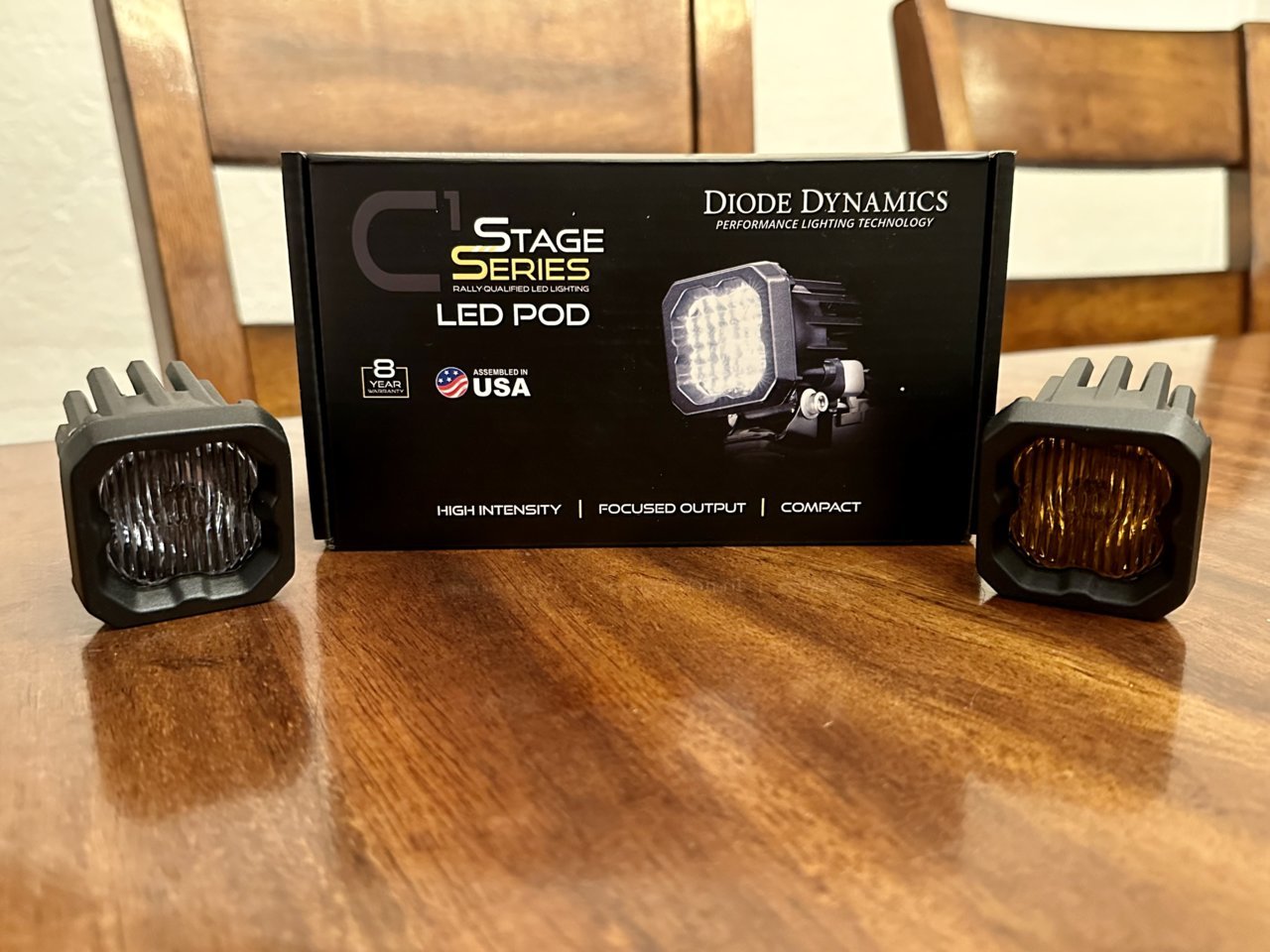

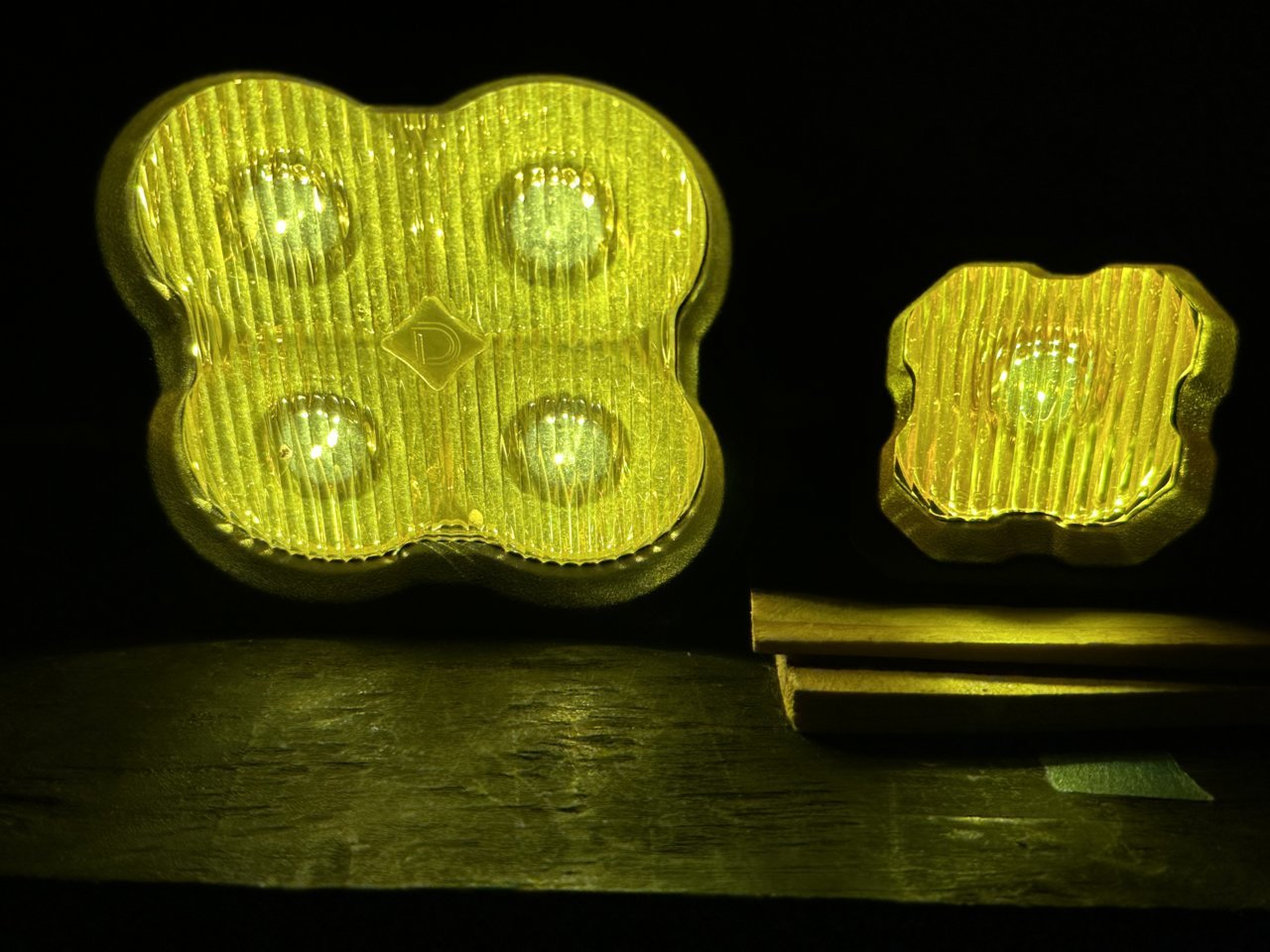

    Diode Dynamics SSC2s
    Like the SS3s these lights are available in 6000k white, and selective yellow and 4000k warm white by using yellow lamps with a clear lens swap. These lights are half the size of the SS3s in a 1x2 emitter configuration vs the SS3s 2x2 emitter configuration. I only have the 6000k SSC2s, so this review is only going to cover 6000k white. Per the testing in the SS3 post, DD Sport/Pro selective yellow incur an impressively low ~9% output loss for selective yellow. That can be used to approximate the selective yellow output based on the 6000k numbers.
    SSC2 Sport
    Vs SSC2 Pro
    Like the SS3s, the SSC2 Pros have a larger vertical pattern and softer cut offs, which isn't best captured in these images.
    Sport top vs Pro bottom

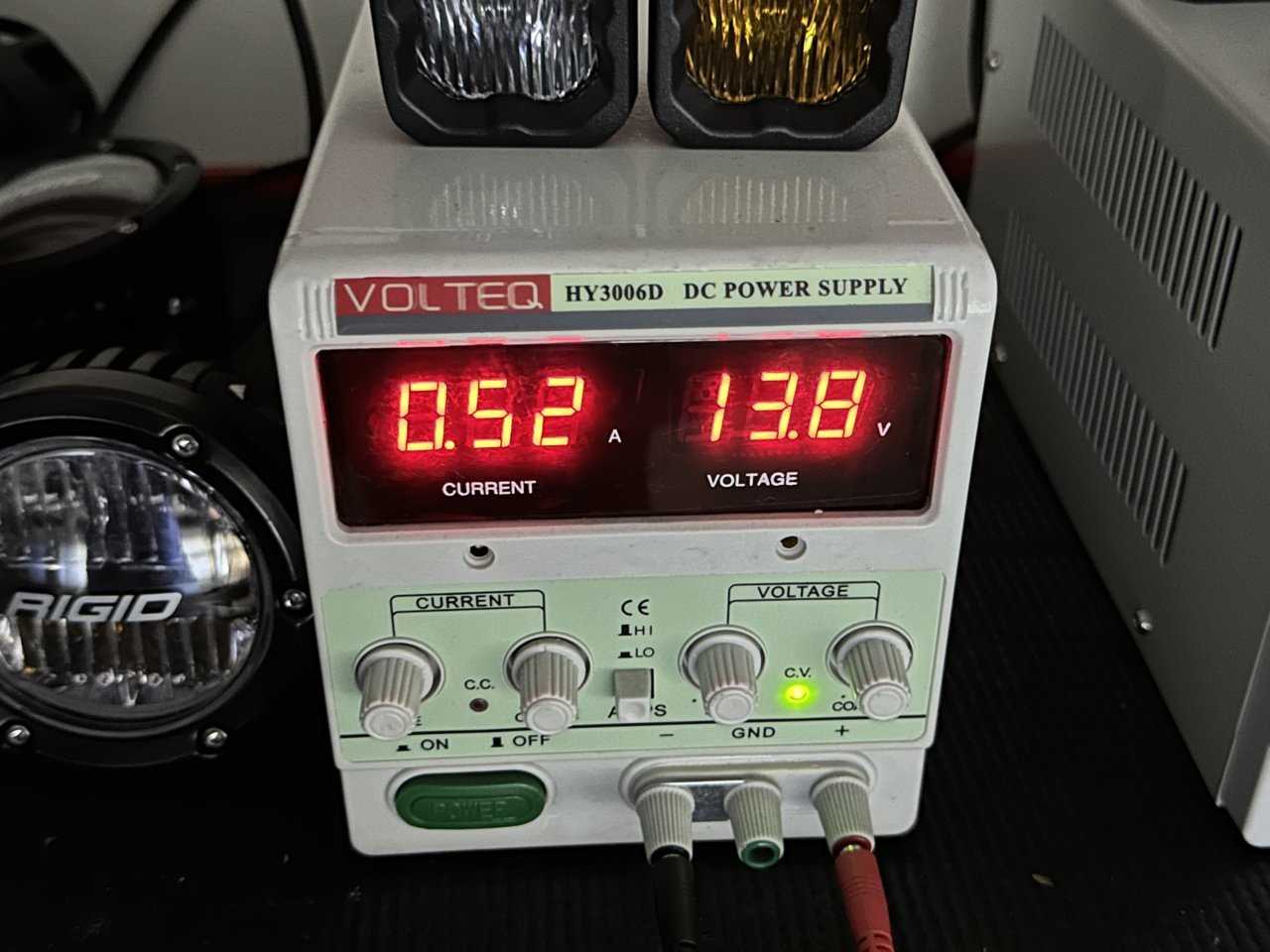

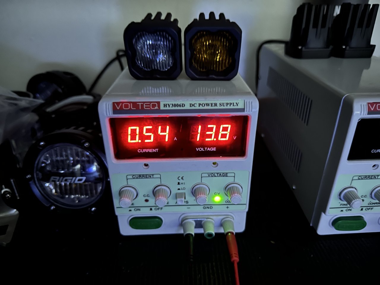

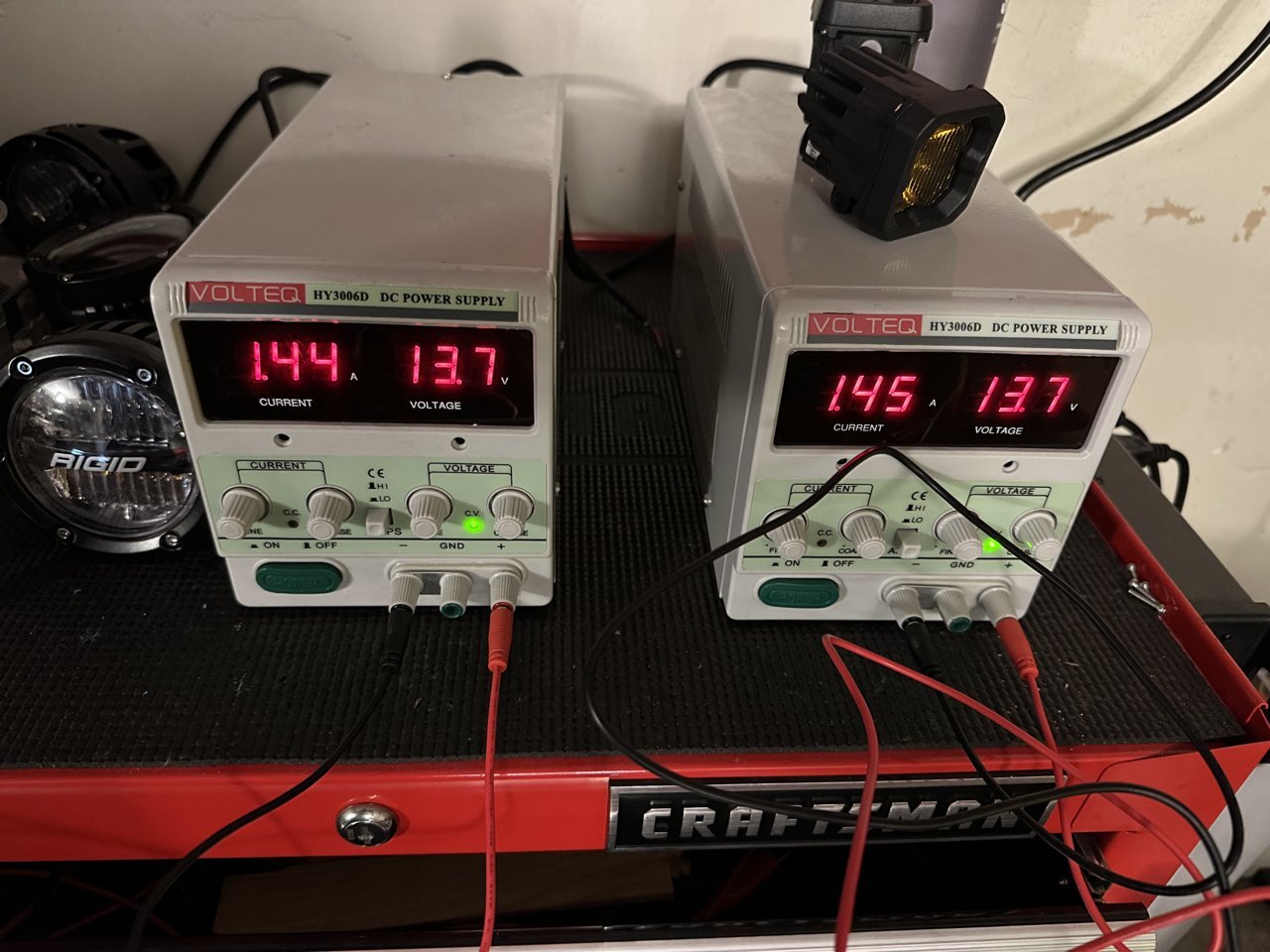

    SSC2 Pro initial power, 23w at 67 degrees F ambient. Spec is 25w.
    SSC2 Pro stabilized power after 40 min run time, 21.7w at 67 degrees F ambient
    SSC2 Sport initial power, 7.5w at 67 degrees F ambient. Spec is 7.7w.
    SSC2 Sport stable power after 40 min runtime, 7.2w at 67 degrees F ambient
    The SSC2 Pros incur about a loss of ~1.4w or about 6% from start to stable vs the Sports loss of ~0.3w or about 4%. Not surprising given the Pros higher power.

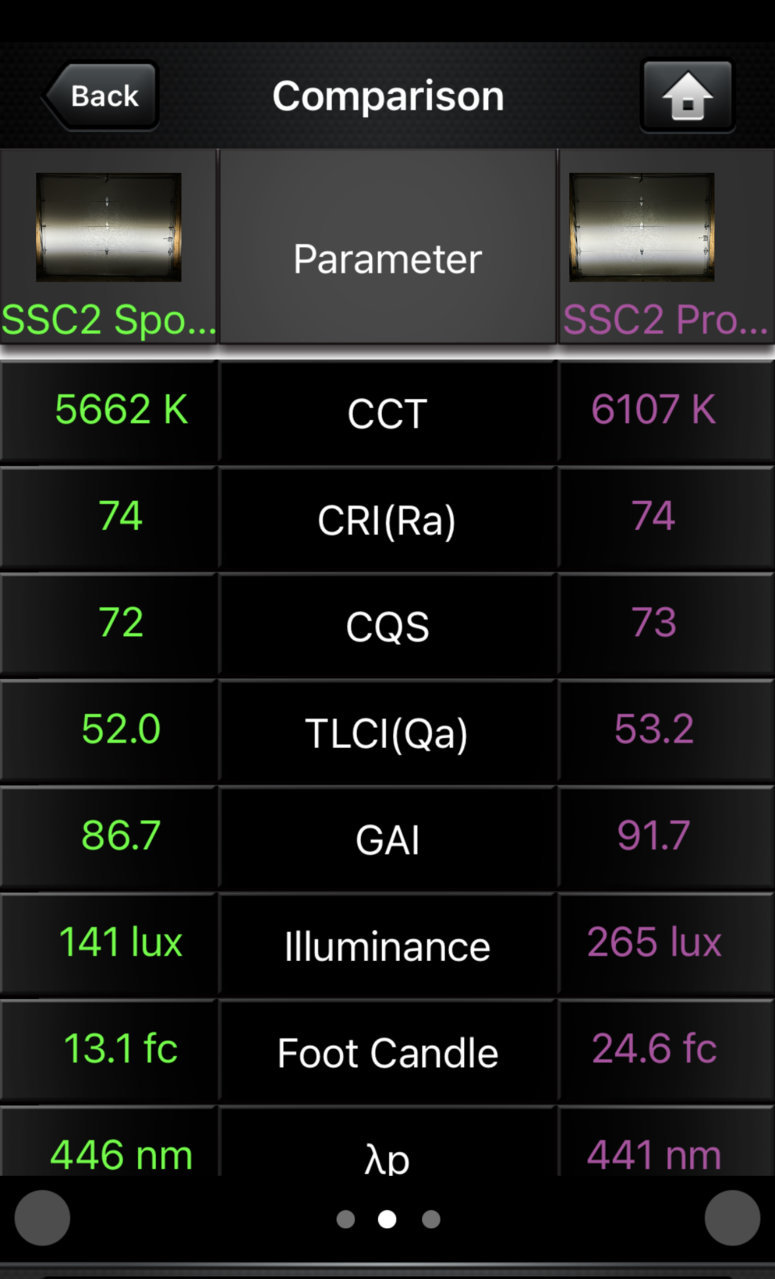

    Output intensity, SSC2 Sport vs SSC2 Pro
    The Pros are about 88% higher in output intensity than the Sports while also having a larger pattern but softer cut offs with more light spill.
    SSC2 Pro vs the larger SS3 Sport
    The 4 emitter SS3 Sports have about 42% higher output intensity than the SSC2 Pros, while having sharper cut offs.

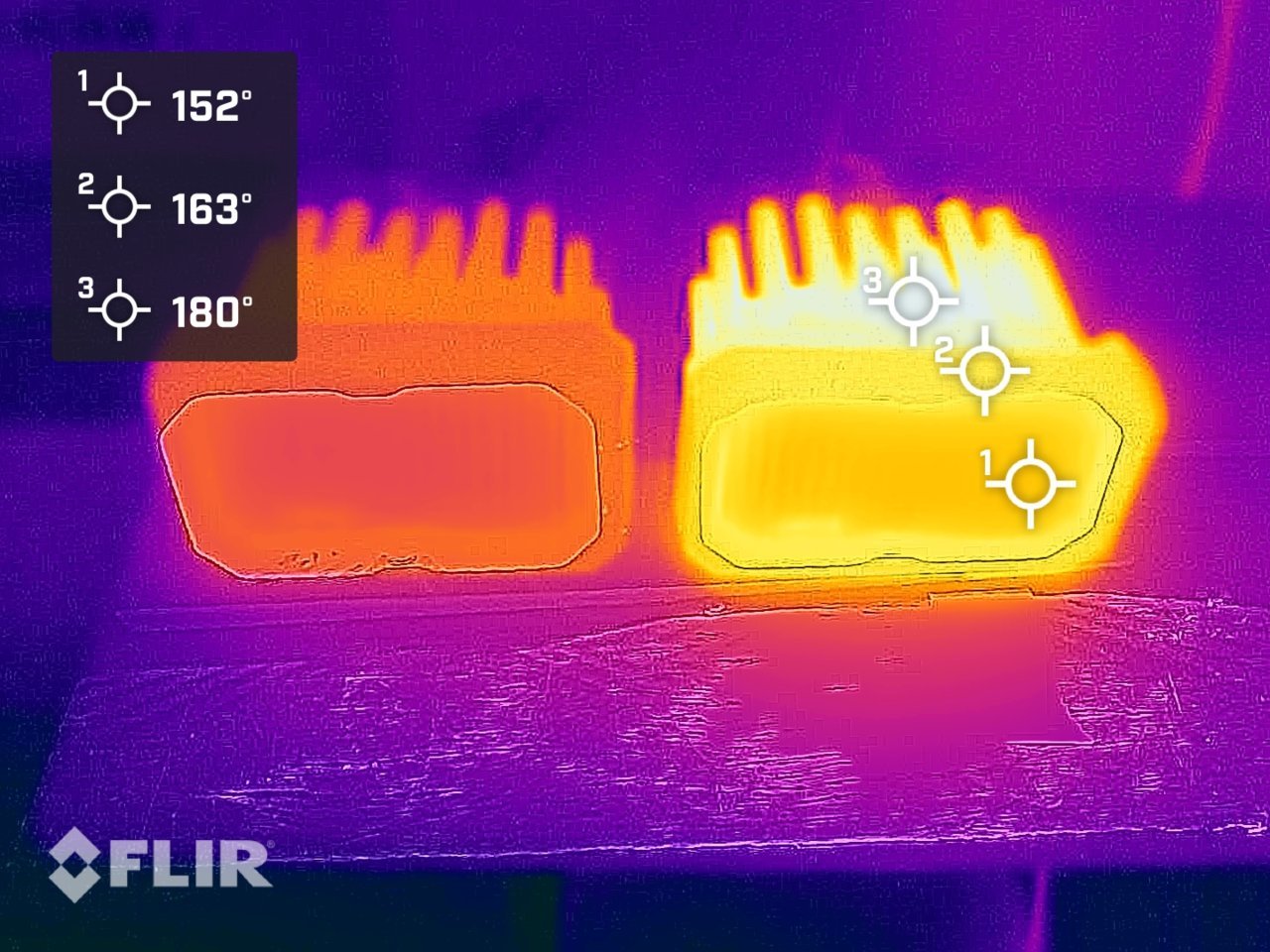

    SSC2 Sport thermals in 67 degrees F ambient
    Ideally I run the thermal tests on the yellow lenses, which do run warmer on the lens than the clears. On the Sports even the front aluminum bezel is only +39 degrees F over ambient. These lamps will have insufficient heat to combat snow conditions.
    SSC2 Pro thermals in 67 degrees F ambient
    Again ideally the lens would be yellow for better heat performance, but even so the lenses are running 85 degrees over ambient with the bezel at 96 over ambient. These should do decent in snow conditions, and better with yellow lenses, though not as hot as the recommended Max lamps for snow.
    Sport Top vs Pro bottom

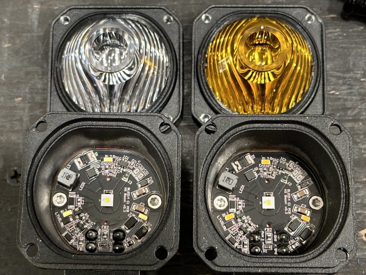

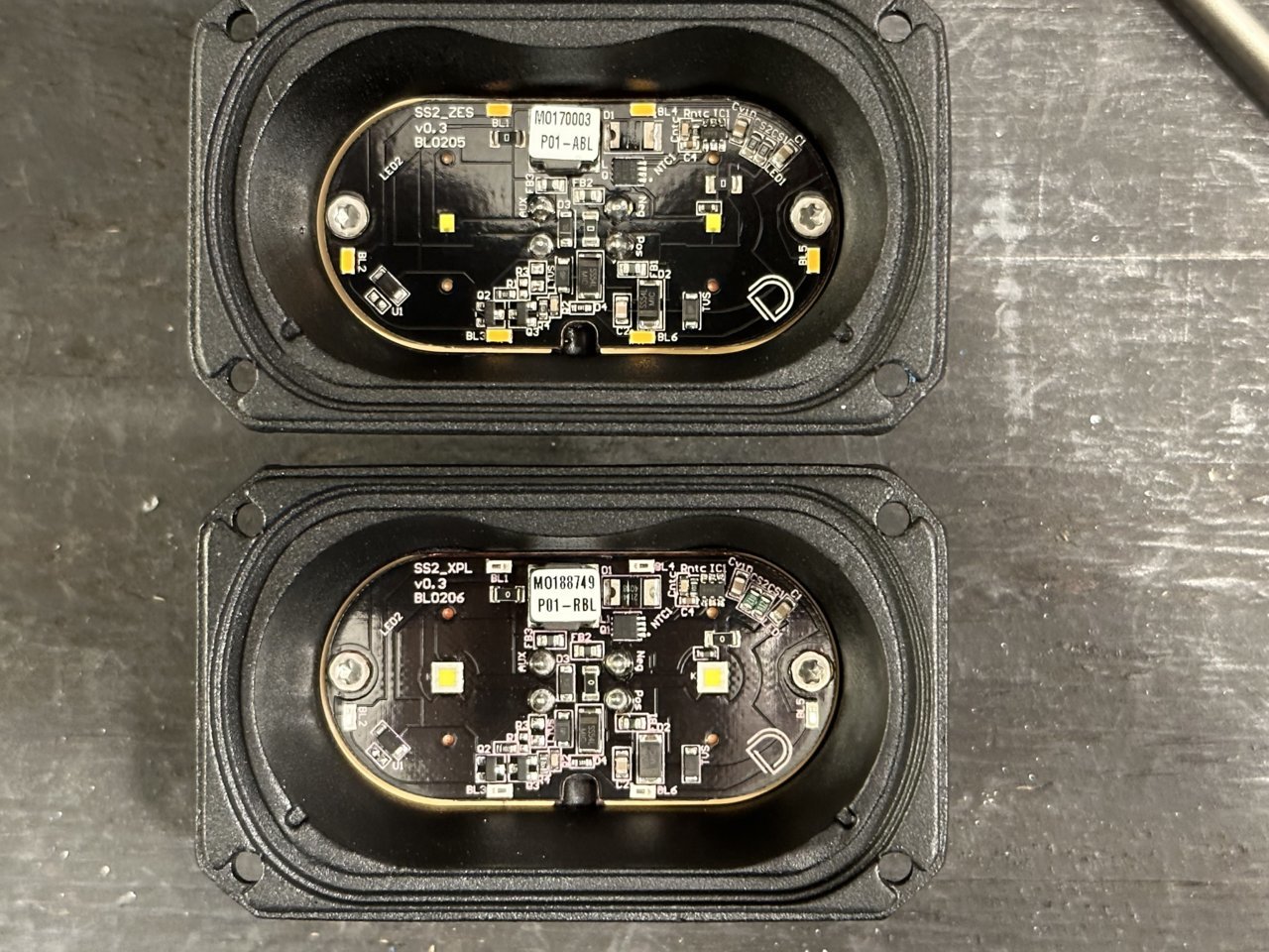

    Note that back light emitters around the perimeter in the Sport. Like the SS3 the Sports use smaller emitters for better focus over the Pros larger emitters.
    Interestingly the SSC2s have notches in the body and corresponding tabs in the TIR optic. On an optic that can be rotated 90 degrees this makes sense, to prevent someone installing their fog pattern facing vertically for example. But in the 1x2 optic configuration that isn't possible. Only thing you can do is install upside-down. For the patterns currently offered upside-down doesn't make a difference either. However, on the TIRs I have the tabs don't seem to protrude enough prevent reverse installation.
    On the SSC2 and SSC1 the breathers have been moved to the bottom vs back of the lamp.
    In supporting a backlight, the connectors have changed from 2 pins as found on the original SS3s to 4 pins
    Great to have additional compact fog options. Predictably the smaller lamps are lower performing that the larger and more powerful SS3 fogs. I do like the low profile form factor of the SSC2s for A-pillar/ditch lights over larger lamps and their compact size gives them many other versatile uses with the other optics available.

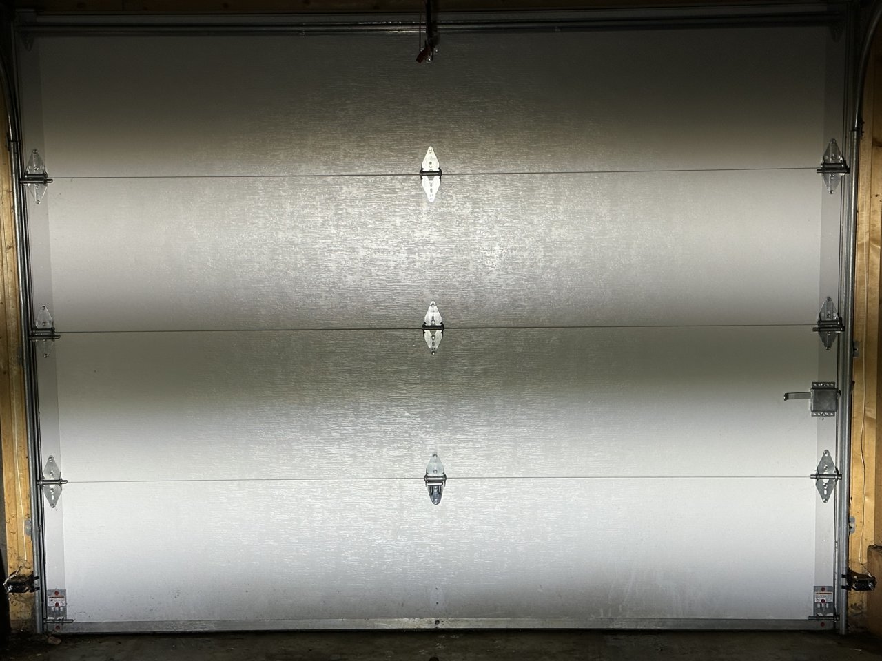

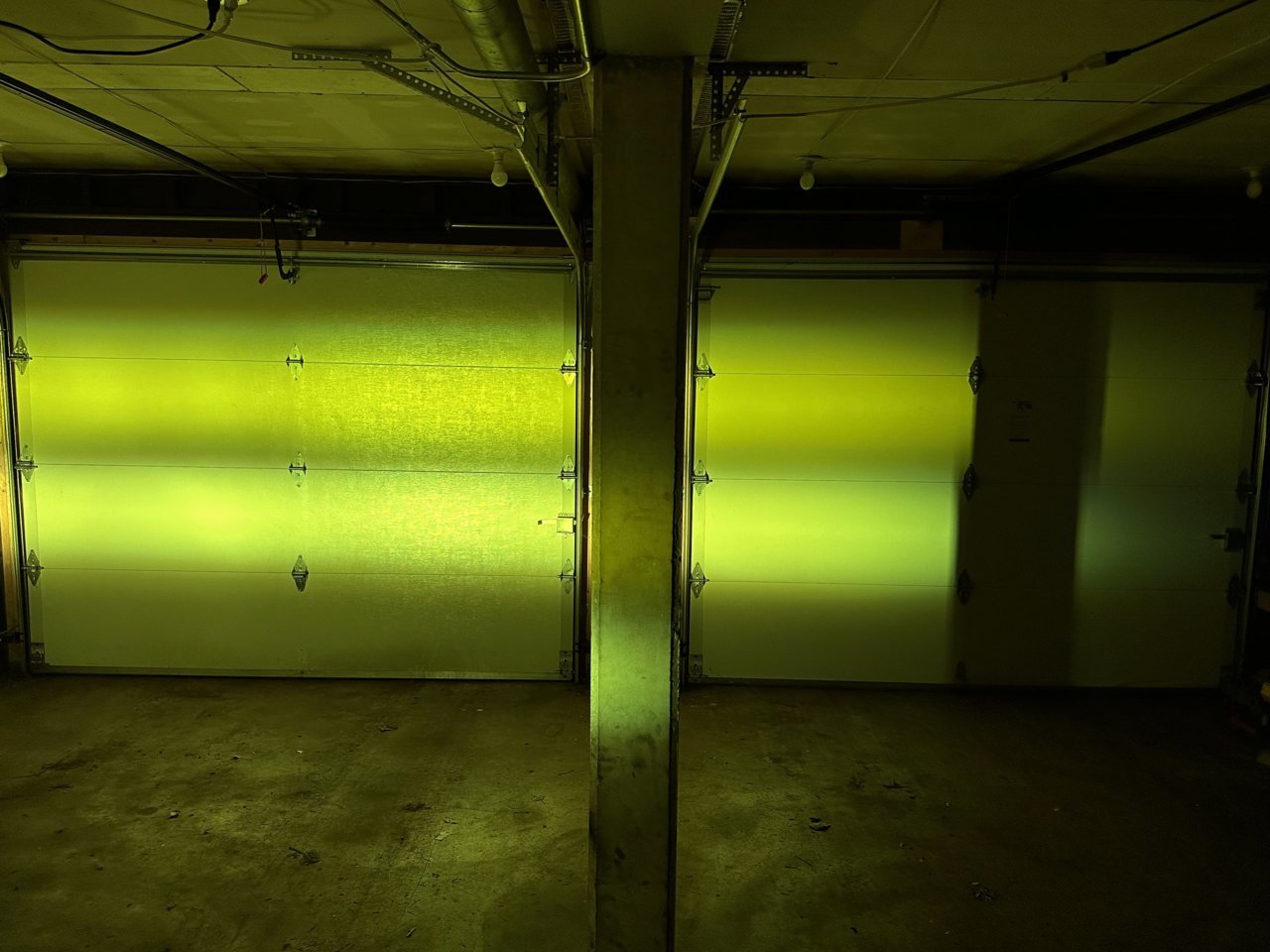

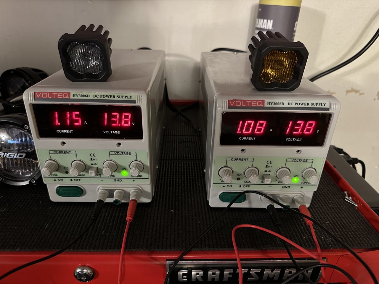

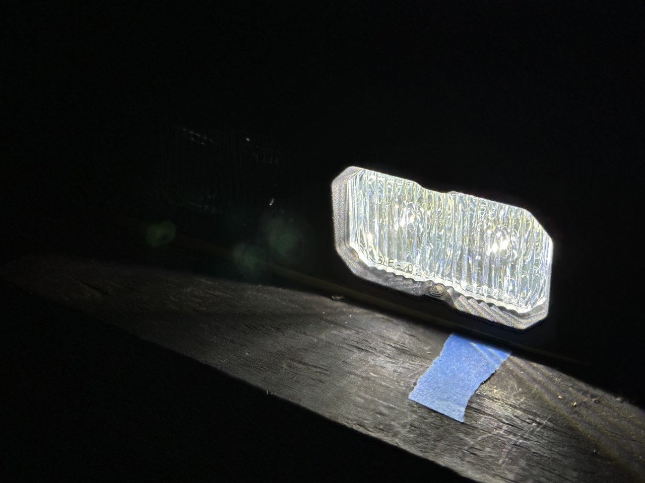

    Diode Dynamics SSC1s

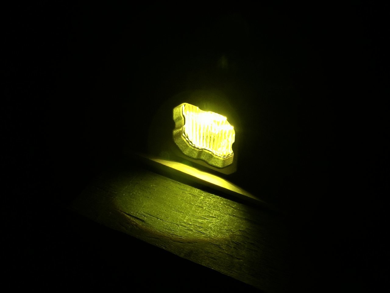

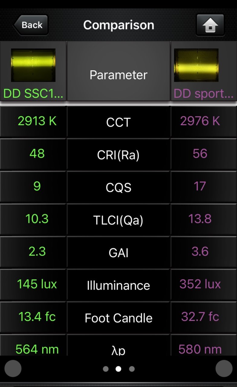

    The SSC1s are based on the same platform as the SS3 Max using Osram HX Boost emitters, which are only available in 6000k. As such there is no 4000k option unlike the other SSC1s or SSC2s and the selective yellow optic uses a darker amber optic like the SS3 Max fogs, vs the yellow optic found on the sports and Pros.

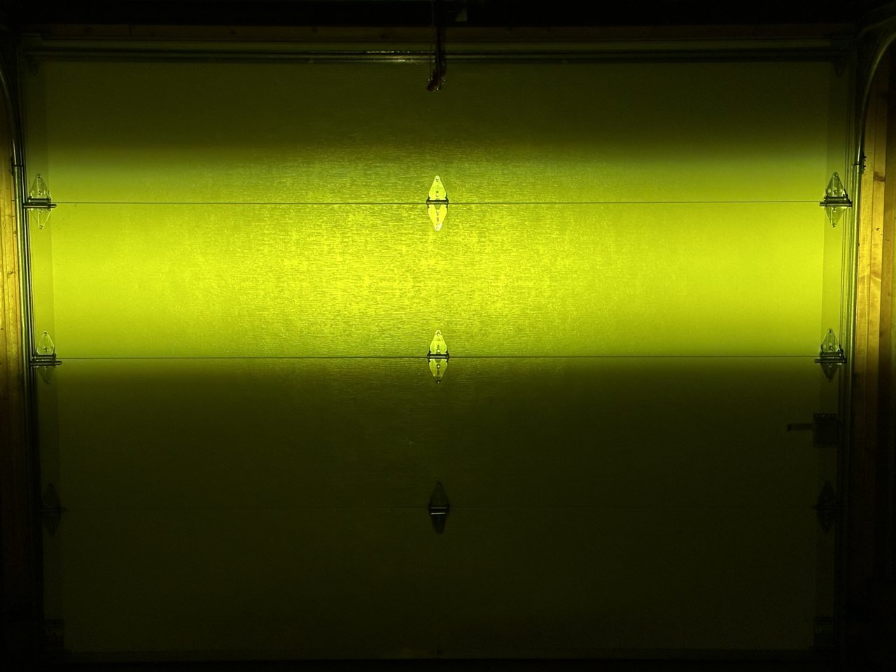

    SS3 Sport vs the SSC1 (Max) fog
    SSC1 fog top vs SS3 Sport bottom
    SSC1 spec 98* x 9* vs SS3 Sport spec 81* x 8*
    Surprisingly the SSC1 has a slightly taller and wider beam than the SS3 Sports. The beam isn't quite as green as the pictures make it appear.
    SSC1 pattern is ~1.3 panels high. Better cut offs than the Pros like the SS3s.

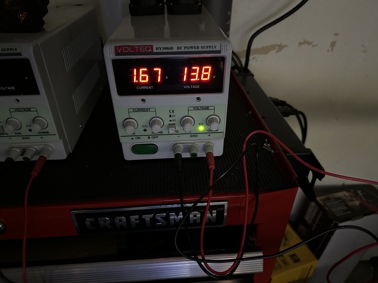

    Initial power, white left vs yellow right
    Power stable ~40 min in 66 degrees F ambient, white left vs yellow right
    The SSC1 lamps took a pretty significant power loss from initial to stable of nearly 20%. The SSC2s were only 4-6%. I have the white SSC1s pulling 15.9w and the yellow pulling 14.9w. The specs just state using an Osram Boost 20w LED but do not commit to an actual lamp draw. What was really interesting here to me though is the white vs yellow power discrepancy. I've tested a lot of lights, and lights of the same architecture do not usually deviate by a full watt. So I ran a second test with the other paired lights in each of the packages. Same result. So I swapped the optics between the white and yellow lamps and re-ran the test a 3rd time. The white lamps that previously ran at 1.15A with the now swapped yellow optic now ran at 1.08A, and the yellow lamps that ran at 1.08A with the now swapped white optic now ran at 1.15A. Filtration yellow optics run hotter than clear, and 6000k filtering amber runs hotter than 4000k filtering yellow. With the darker amber optic in the smaller body SSC1 it would appear that causes the overall lamp to run even hotter to where greater thermal rollback is employed vs the white lamps, losing an additional 1w of power.

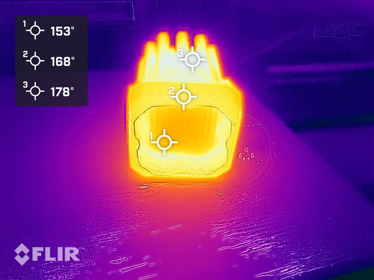

    Thermals on selective yellow SSC1 in 66 degrees F ambient
    With the lens at lens at +87 degrees F over ambient and the bezel at +101 degrees F over ambient, these should do reasonably well preventing freezing over in snow conditions.

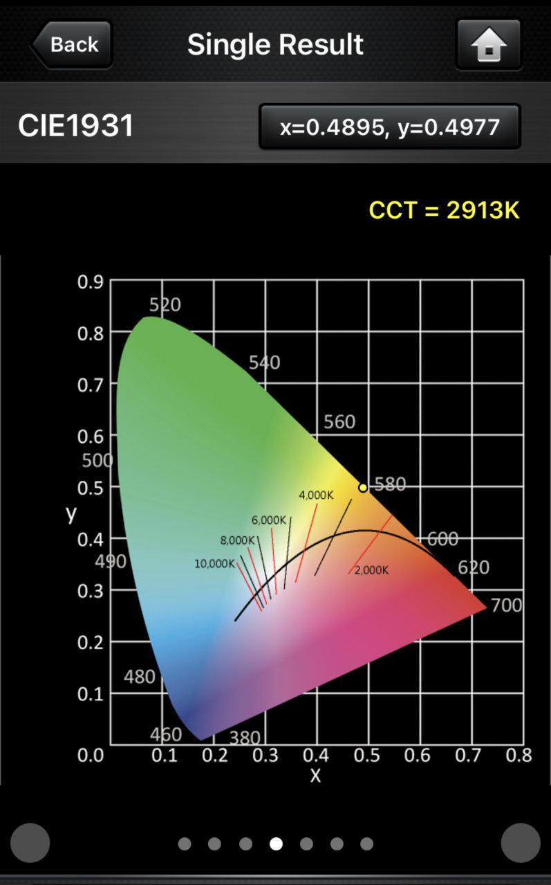

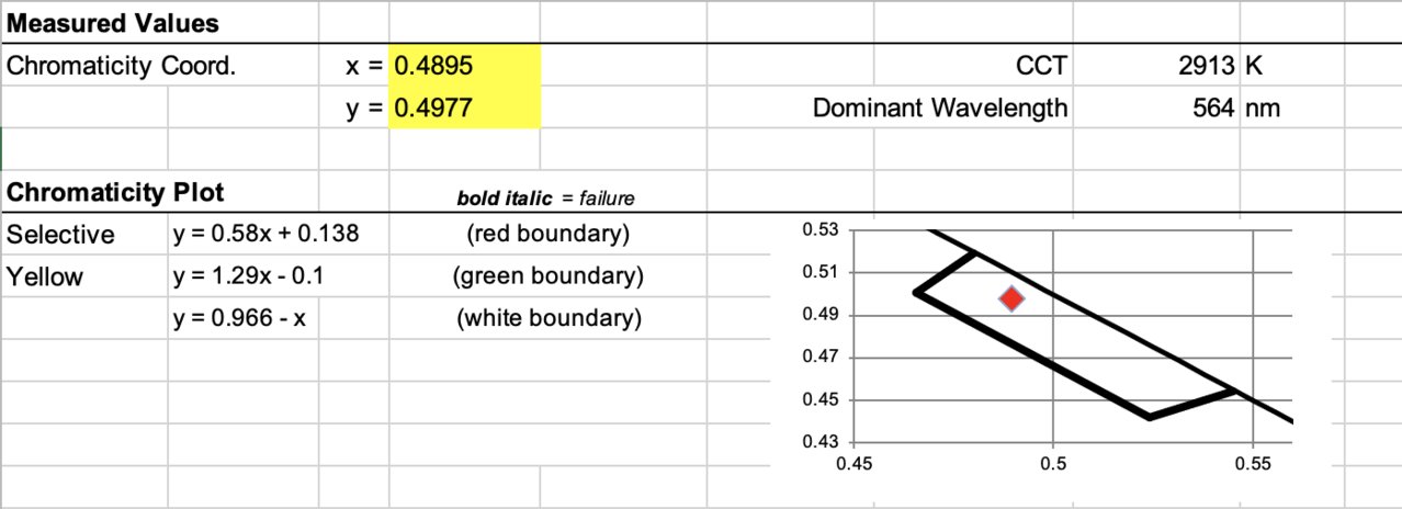

    SSC1 CIE plot
    SSC1 selective yellow chromaticity window plot.
    The SSC1s fall in the SAE chromaticity compliance window.

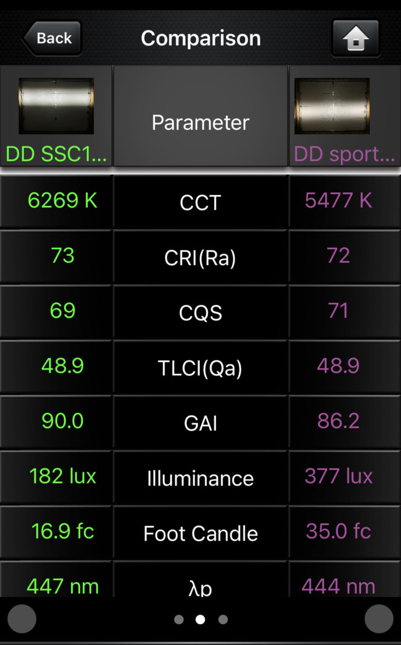

    SSC1 (Max) vs SS3 Sport
    With the greater filtration losses using a 6000k light source, greater thermal roll back due to heat, having a wider and taller beam pattern and using 1 emitter vs the 4, the SSC1 comes in at about 41% of the output intensity of the SS3 Sports.

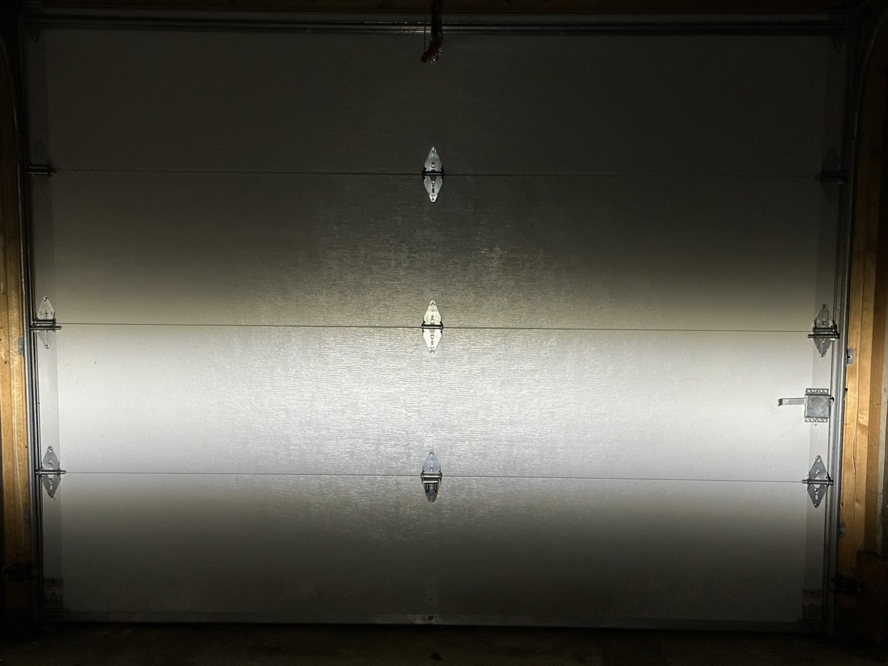

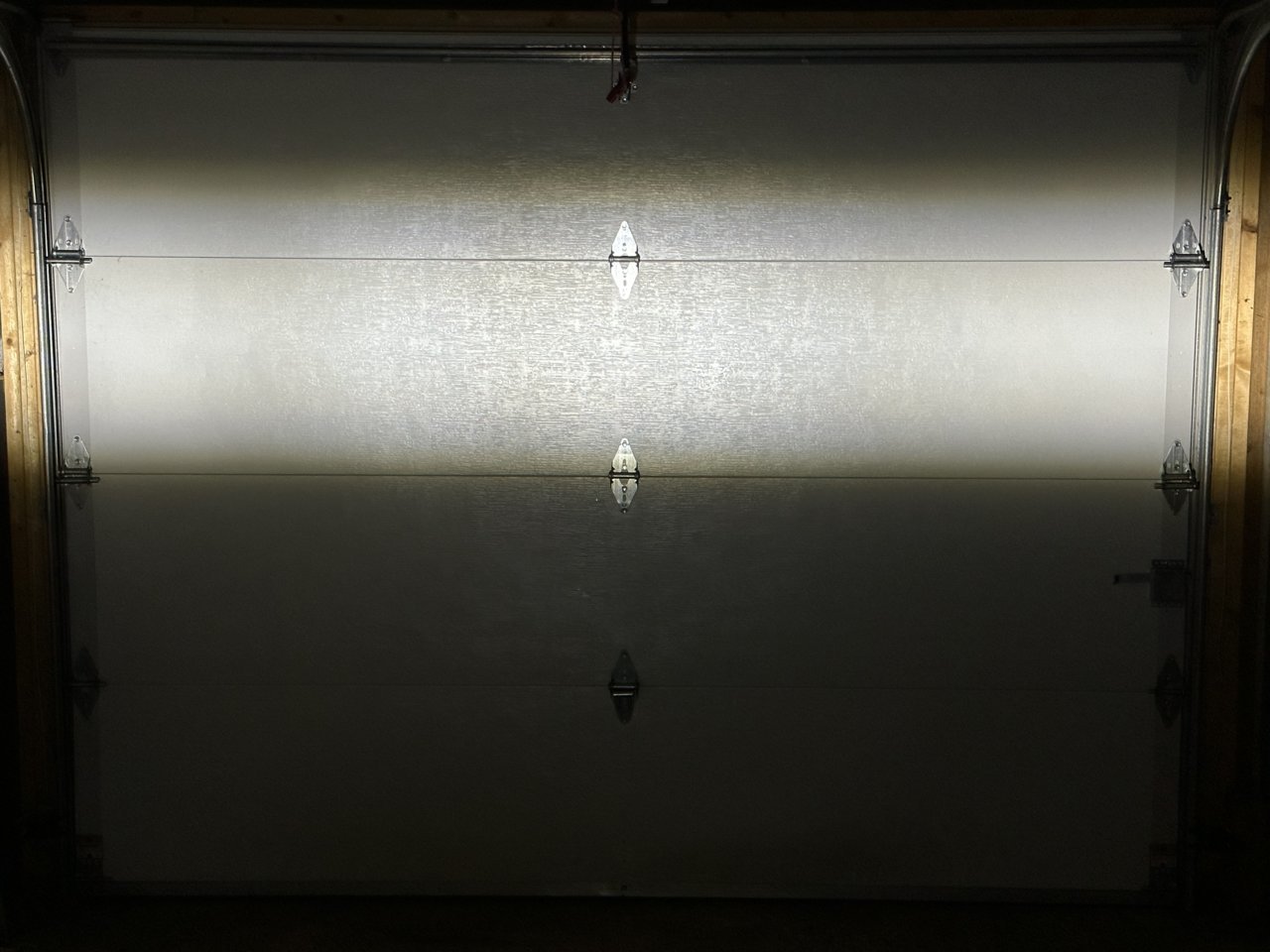

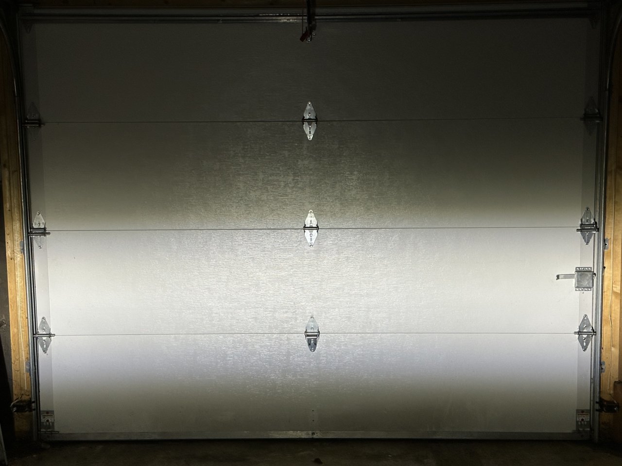

    White

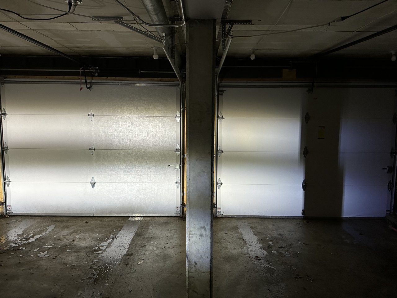

    Wall shot

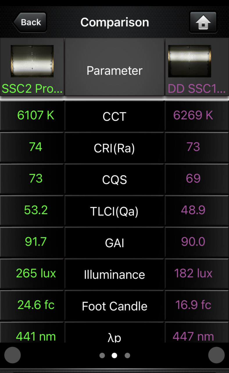

    SSC2 Pros vs SSC1 (Max) in white
    The SSC2 Pros are higher in output intensity than the SSC1 (Max), but the Pros do have the compromise of softer cut offs with more light spill than the more disciplined SSC1 (Max).
    SSC2 Sport vs SSC1 (Max) fog
    The SSC1 does outperform the SSC2 Sports.
    Just for good comparative measure, the SSC1 vs the SS3 Sports
    The SSC1s are about 1/2 the output intensity of the SS3 Sports. Easy to get hug up on the numbers, but the SSC1s are substantially smaller than the SS3s, roughly 1/4 the size but 1/2 the output.

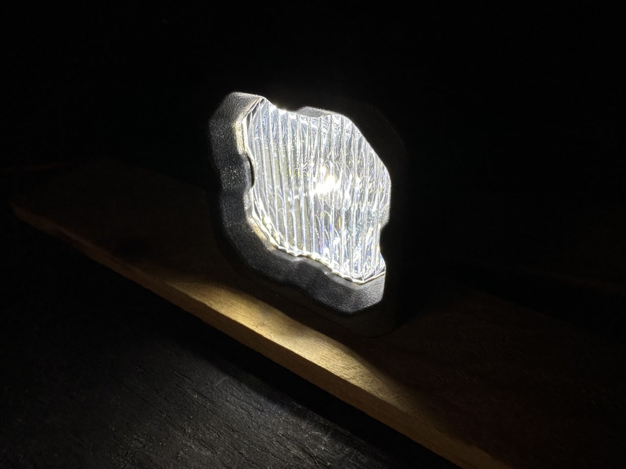

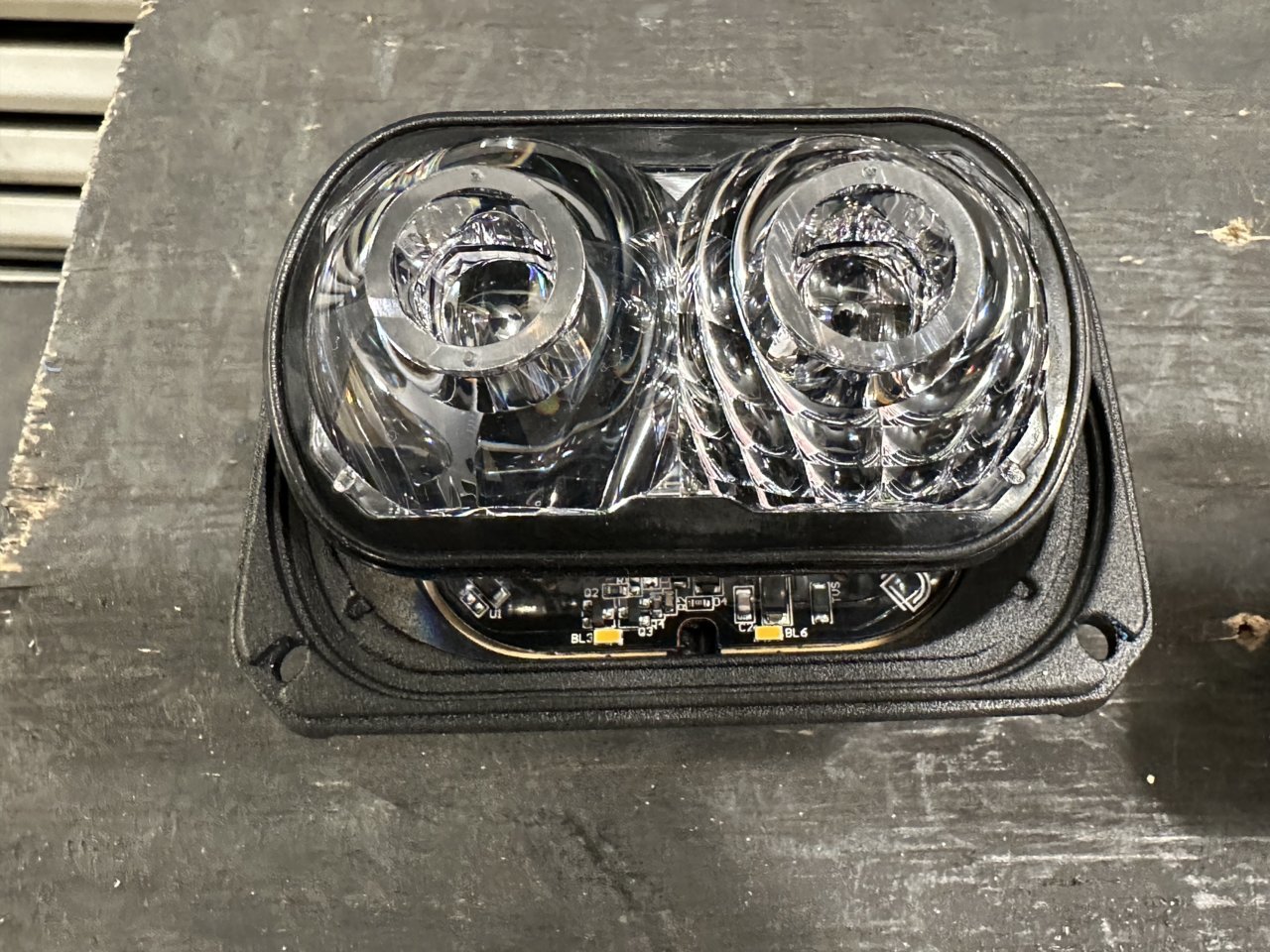

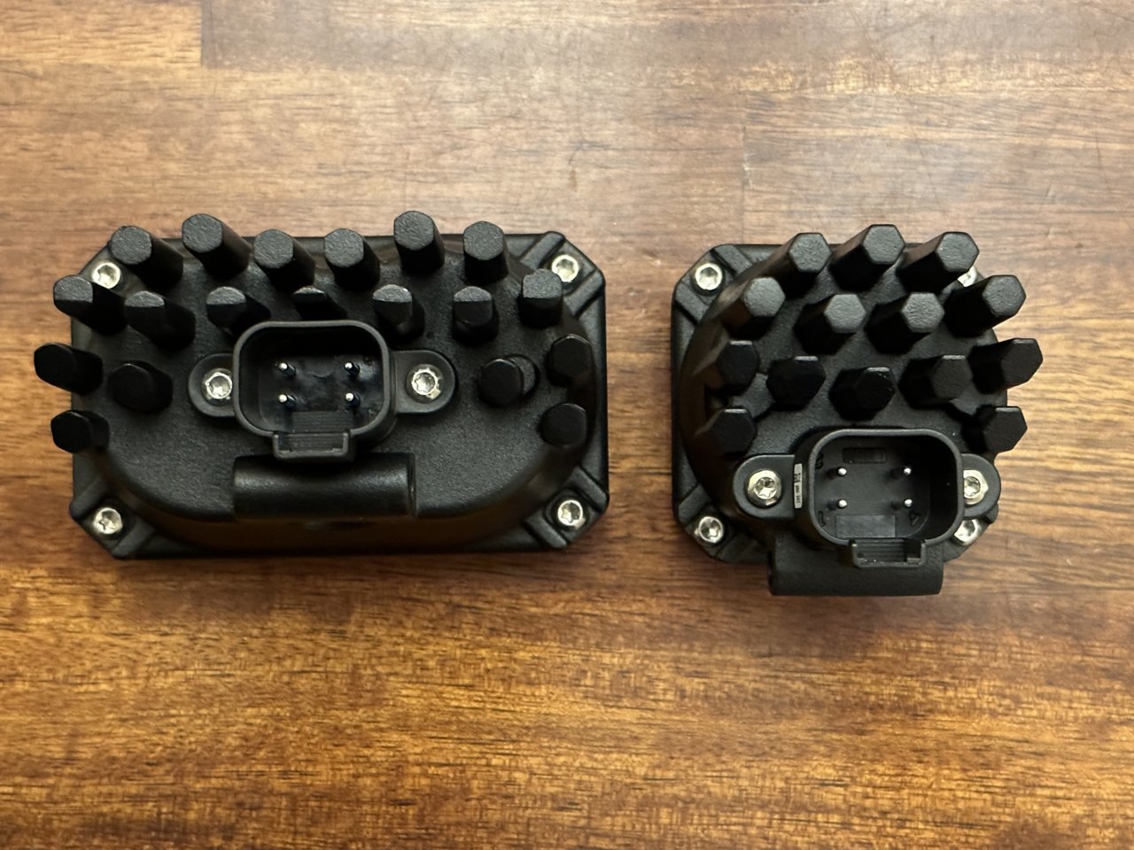

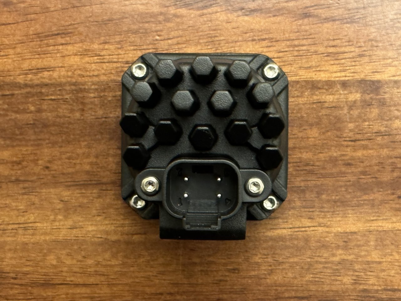

    The SSC1s use a bottom cross mount with a bottom breather.
    The SSC1s have flat spots on the top and bottom of the optic, so it can only be rotated in 180 degree increments, not 90 degrees. You can see the backlight LEDs around the perimeter on the board.
    The SSC1 (Max) HXB emitters appear to be installed in a different orientation than the SS3 Max. While the Max uses a horizontal layout which makes sense for a fog (as shown below) the SSC1 orients the emitters vertically, giving a narrower and taller pattern, seemingly not ideal orientation for a fog.
    Max vs Pro vs Sport

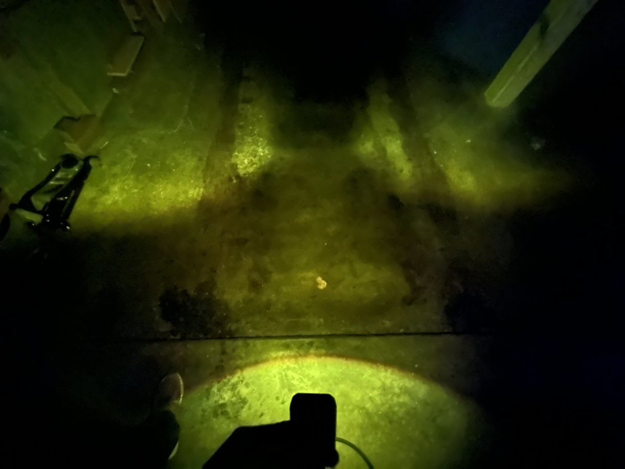

    Backlight
    I was looking to understand the backlight optics, because it was pretty obvious the light doesn't actually shine forward. Note how the emitters are at 12, 4, and 8 o'clock.
    In pointing the lamp at the ground with backlight only, the backlight shines at the inverted 10, 5 and 6 o'clock, exactly inverted from the emitter location but most noticeably no light to the center of the pattern. This has nothing to do with the performance characteristics of the backlight, just interesting observations on how the optics interact.

    Hmmm, looking at the backside here, it looks like I could print a collar that gets anchored by the outer four security bolts. That collar could then be used to sit flush against a cutout. Then, a second bezel from the front could sandwich the collar against the cutout.
    I could prototype all this with my 3D printer, but I’d be a little nervous about the material being a permanent solution and might have to source a final print from online.
    I appreciate the photos, the backside is a view DD doesn’t have in their website drawings.

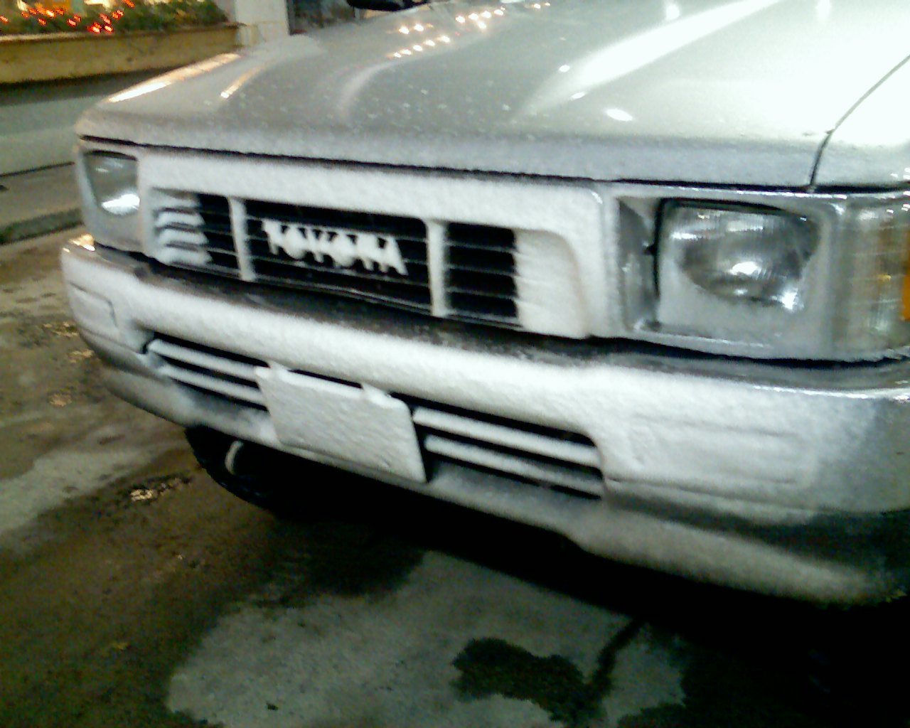

    Fun story. This is my old 88 Toyota pickup with Hella H4 E-code conversions using a 12 AWG HD relayed headlight harness running the highly exotic 85/80w Osram Hyper bulbs. And despite running one of the most extreme halogen setups possible, the headlights were still attempting to freeze over in crossing the Cascade passes at night in a bad snow storm. Never underestimate the mountains.
