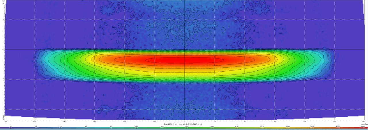

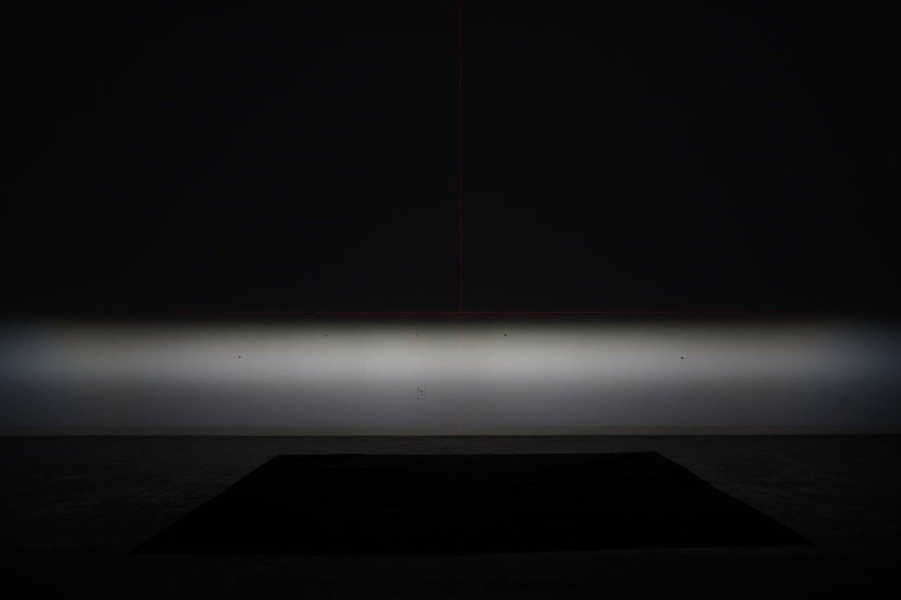

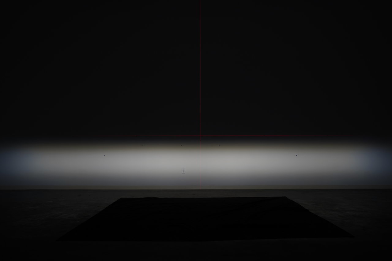

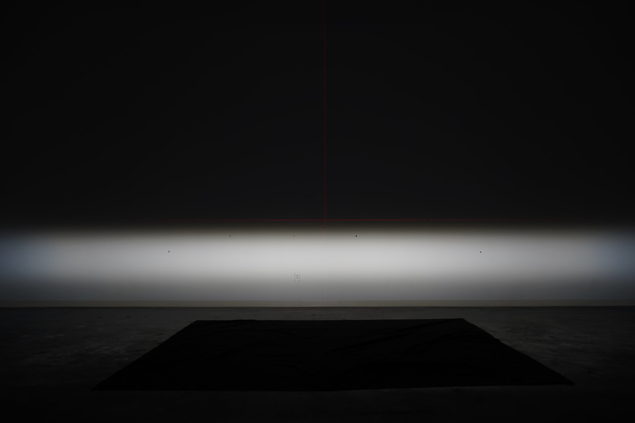

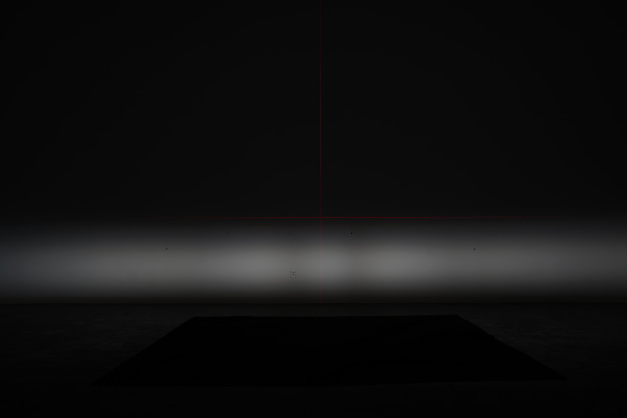

    Here is 1B Wide beam info. It's pretty much half power 2B HXB wide. Operation temp also very similar to 2 Banger HXB @crashnburn80 tested.
    Took about 25~30 min to reach output stabilization phase. Same thermal roll back logic.
    Pressure equalizing vent is same style as 2B
    If anyone has particular technical questions, let me know.
    Measured beam center intensity was about 7,800Cd (I gave spec minimum as 6,750Cd) at T=30 min mark. Ambient temp 23C on provided U bracket mount.
    1B Wide beam photo
    For comparison, this is 2B HXB Wide
    2B NCS Wide
    And here is SSC1 SAE Fog

    Appreciate the comparisons. Would you happen to have beam angles? Width in particular.

    That IsoCan plot is pretty accurate representation of beam spread. Each grid is 10 degree in that plot. Prime 500+Cd beam is about 75 degree wide. When aimed as SAE Fog, 0.75D to 6.5D carry higher intensity Total vertical spread is 9.25 ~9.5 degree
    High intensity band is fairly uniformed, feel free to aim lamp upto 20 degree outward. And it still will cover forward angle

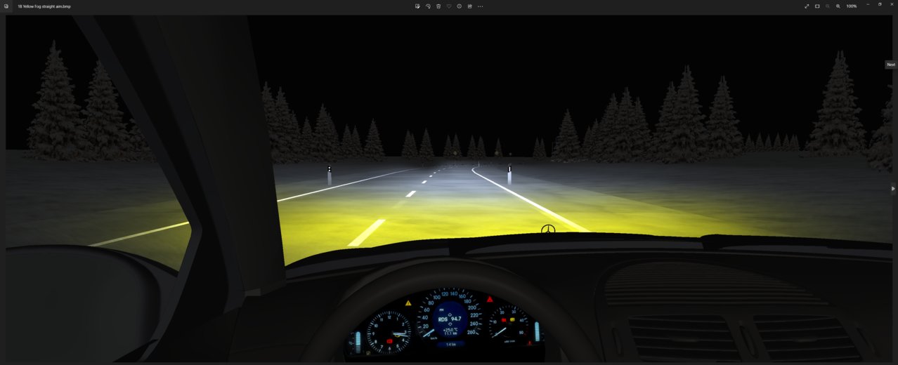

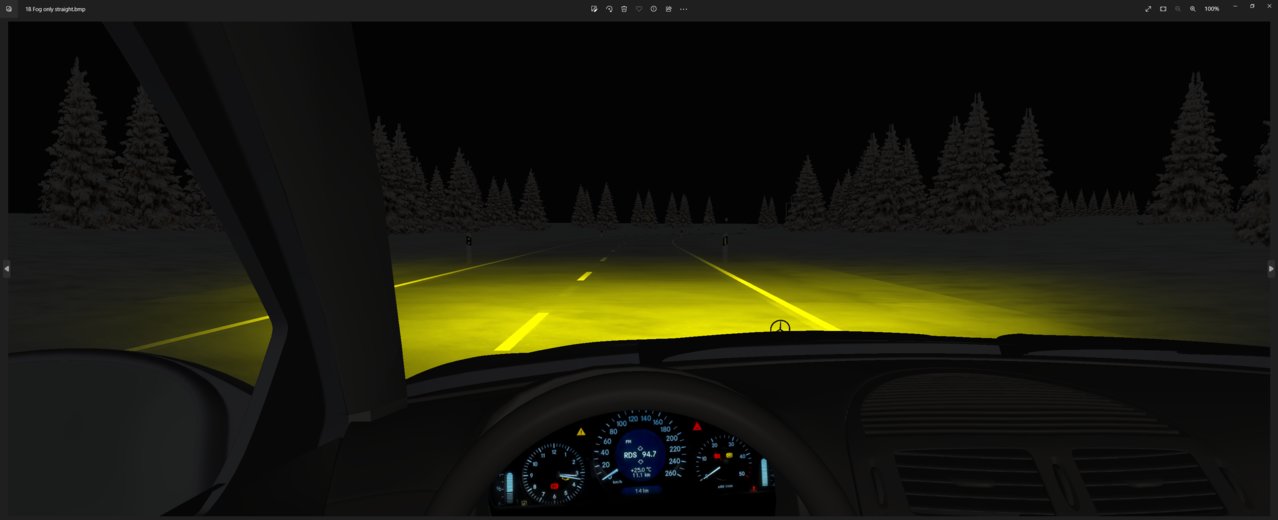

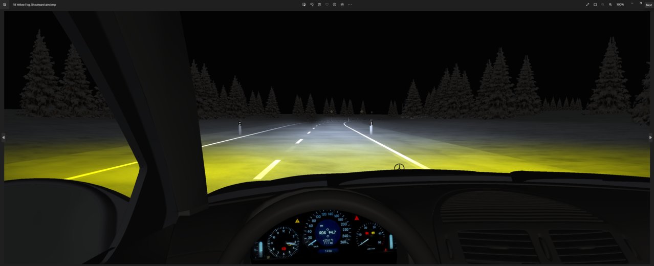

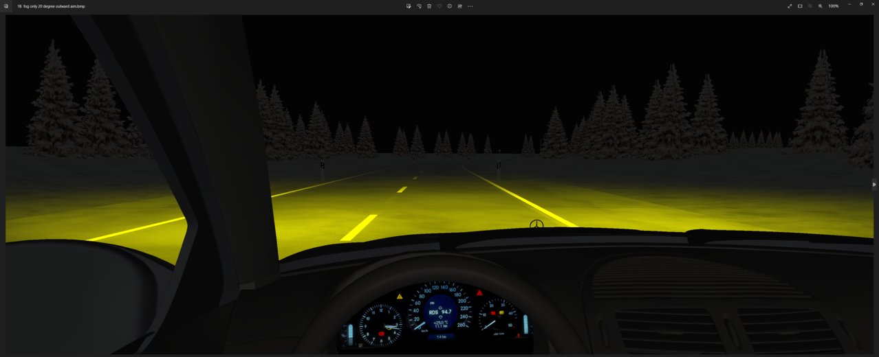

    Here is impression difference between straight aim and 20 degree outward aim
    This is straight aim, SAE F 0.75D aim
    This is each lamp aimed outward by 20 degree. It still covers forward zone at moderate intensity.
    Straight aim with low beam
    20 degree outward aim with low beam

    Thanks, I should have looked closer at the plot and I would have picked up on that. The intensity scale is a bit weird; not linear, and yet not logarithmic. What intensity is considered the FWHM with regards to visibility?

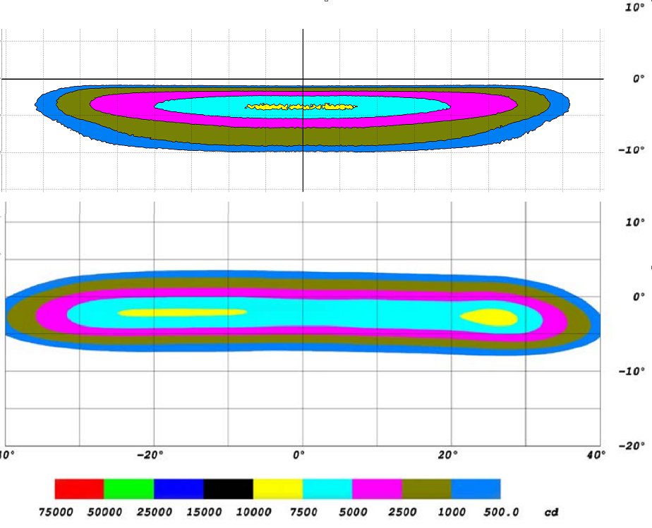

    FWHM is not useful parameter for vehicle front lighting "aim" dependent projection character, those are more for general lighting like ceiling lamp or as light source Lambertian spread describing type of parameter.
    Visibility is based on lamp mount height, aim and distribution, it may require some study on but IsoCan really is only and best way to describe beam character.
    I can generate driver view, etc, what mount height, aiming and road condition you have in mind to see view impression?
    For IsoCan scale
    It was Log scale plot but iso line interval config may be not familiar scale.
    To make it easier comparison, I borrowed DD website SSC2 Pro Fog lamp data sheet scale and color coding style adopted.
    C2 plot on their data sheet isn't aimed view as SAE, but you can see overall distribution character. C2 Pro fog has 5,000+Cd range 25 degree wider
    This is great comfort in offroad wide beam applicaiton.
    For Fog lamp use, C2 Pro still need to be aimed down another 3 degree or so
    Top is 1B Wide Bottom is SSC2 Pro Fog
