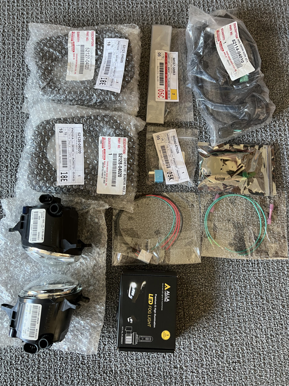

    Might see if this seller is willing to separate theirs if they still have them. Bezel part numbers in the images.
    https://www.tacomaworld.com/threads/fog-light-kit-for-3rd-gen-sr.774885/

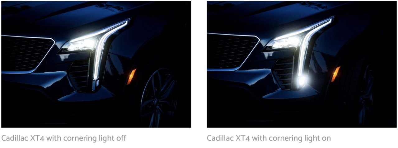

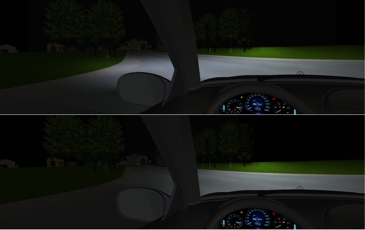

    It seems there is a misunderstanding of some sort. What was being discussed was reusing that design for a completely different purpose that the OP had intended, not as a light bar supplement and not off-road, but using it on the street as an SAE cornering light tied into the vehicles turn signal circuit just like an OEM SAE cornering lights on many vehicles that activate with the turn signal.
    Example of an OEM SAE corning light on a Cadillac
    The design intent did not slip my mind. My comments have nothing to do with the OPs design/intent/use/thread, other than pointing out that reusing that same setup for an entirely different purpose than intended as was being discussed, as a way to run an off-road light that activates with your turn signals as a cornering light on the street would be ill-advised and unsafe. To run a cornering light on the street that activates with the turn signals like an OEM SAE cornering light pictured above, you'd need to use an SAE lamp with cut offs to not blind other drivers. Baja does not offer an SAE lamp in a 1 emitter lamp size. Morimoto and Diode Dynamics do.

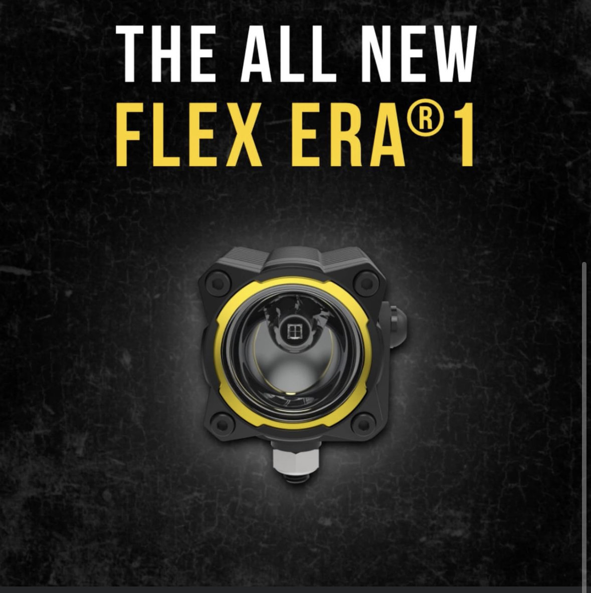

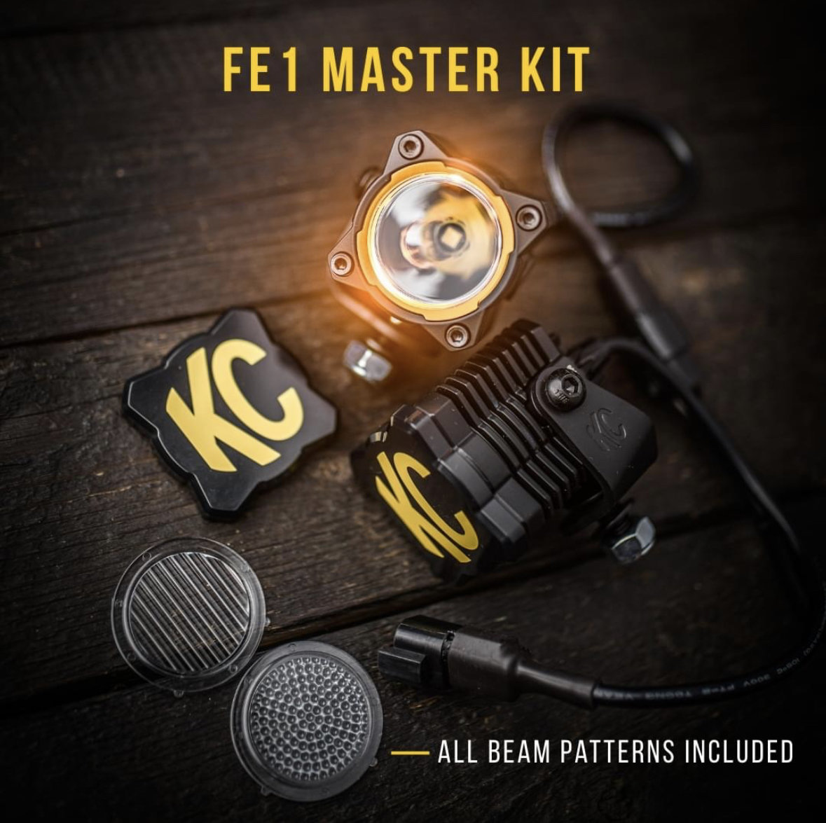

    Not available in an SAE optic, so not for street use but interesting none-the-less, KC just released the most powerful 1 emitter pod lamp on the market to date with their Flex Era 1. 23w, 2430 lumen, 5000k. With KCs deep pod body, it has potential to have some reasonable thermal capacity for the high power, which is typically a challenge in the more compact lamp sizes.

    Spec is showing Flex Era1 Spot beam to be about 31K Cd, It's in between SSC1 Sport Spot (50K Cd) and Pro Spot(23K Cd) It's forward facing emitter + parabolic reflector, beam character will be very much like BD S1 spot beam. S1 spot is about 17K Cd Lots of spill around center focus. Considering the size of pod and claimed power rating, it's modest output.
    Edit>>

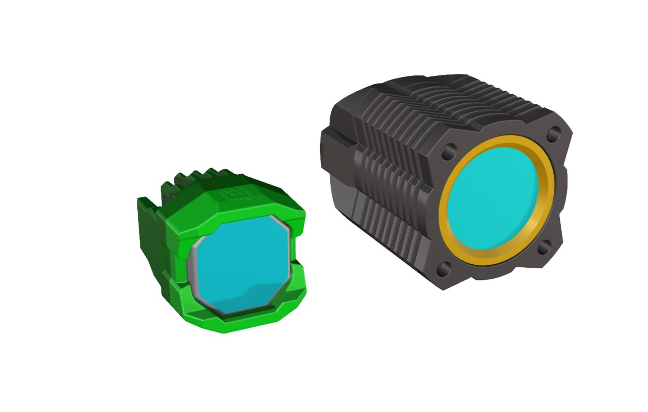

    Flex Era 1 doesn't look that compact though. 2.6" x 2.72" x 2.9"
    SSC1 and 1 Banger is much more compact. Below is 1 Banger vs Flex Era1 size comparison. SSC1 is about same size as 1 Banger. Off topic but if you are looking for Tiny high potency spot beam, 1 Banger is very strong for it's size. 1 Banger spot is tight beam. 12x10 degree box with 6 degree high focus spot. Measured 93K Cd 15W

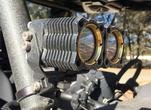

    Hmm. I should post this from a personal account, but frankly speaking, the design is very familiar.
    Heretic, 2014:
    Rip Dark (alibaba copy), 2015:
    I'm also not clear on how this "all-new" product differs from the Flex LED modular Pod that's been available since 2018. Higher power and backlight added?
    Genuinely curious, I don't mean to be bashing this. KC has certainly been getting back to real design work, and I'll give them credit for some really great features like these kitted lenses. But I feel that calling this an "all-new" product is a stretch. It would be nice to know exactly how it varies from the previous Flex and older derivatives.
