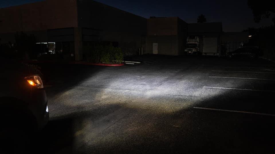

    Shared in another group, Baja had the following to say on this output photo of their new SAE fogs.
    “These photos were taken utilized with our prototype Projector Optics we developed back in October. Our spread has since increased along with a much better smooth blend”
    Will be interesting to see output from the production units.

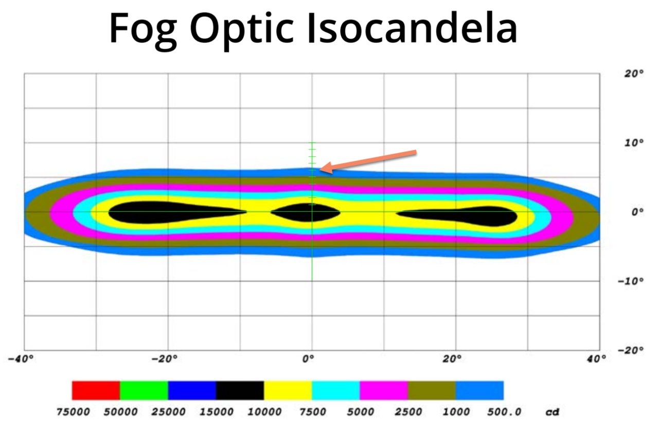

    Let me aid adding resolution to "glare" subject about Pro.
    Pro "scatter" worse than Max? No actually NOT. At after 6.5~7 degree up range from beam center, no difference in spill/scatter level in uncontrolled light leak.
    What I have been pointing out about Pro shall not be used for on road fog is due to
    1. Difficulty of aiming ( due to lack of visual referable cutoff line)
    2. Uneducated/wrongly educated general public's usage of Pro as fog, representing false impression of Pro at wrong aiming.
    it's physically difficult to aim, and psychologically, false impression of excessively high aimed beam impression make new user don't want to aim lower
    When Pro is aimed to prevent certain angle, it does not cause glare any more than Max, I tested, measured it.
    but to achieve this, amount of aiming down is much more than vast majority will comprehend.
    Look up DD website, Pro data sheet, 500+Cd range reaches over little over 6 degree line, around 6.3
    This data is highly consistent to independent lab observation, and above this 500Cd limit line, no SCATTER
    To use Pro as Fog lamp ( to prevent undesired scatter to come back in driver view, and to prevent glare to on coming traffic)
    at H line ( vertically 0 degree line) canNOT exceed 585Cd from 10L to 10R zone.
    Edge of the blue line shows min 500Cd, I assume 585Cd to be slightly towards beam center, to make that happen, CalCoast aimed lamp 6 degree lower globally to make glare/scatter free aim
    Basically, bring aim down enough to make arrow indicated point down to horizontal line ( 0 degree ) or lower. Problem is, our eyes can't detect 585Cd visually. We need instrument and knowledge to measure properly.
    At that lowered aim, Pro has any more glare than Max, 4B HXB. But at the same time, beam is aimed so low, very hard to justify benefit of Pro to be used as Fog.
    This is the reason, I am generally label pro is not suitable as fog lamp, and suggest max or Sport over Pro.
    It's just very difficult to aim. Because Max or Sport can be aimed bit higher than Pro and still not exceed glare definition limit. = more meaningful beam coverage as fog lamp.
    I can aim, because I can read IsoCan DD provided, and I also have scan myself. But there is no way for general end-user to visually aim Pro lamp based just on human eye perceivable impression.
    Our eyes can't detect such slight gradient difference, then many logic out using subjectively brighter looking impression zone border, believing that's the cutoff line.
    Without understanding that kind of aim is way too high photometrically,
    And this result in "scatter" impression. Because lamp isn't actually aimed low enough.
    Soft transition cutoff is still way above H line and seeing that bounce back in fog, getting impression of it scatters more.
    In summery,
    As long as Pro is aimed 6 degree or more downward, No, no scatter, it will NOT glare. Scatter impression is coming from numerous end-users who had been using Pro at WRONG aim.
    But to do so, you can't visually adjust, using subjective brighter zone beam upper edge is NOT cutoff, can't use as reference. I suggest using phone app, digital level to make 6 degree or more aim down.
    If you think 6 degree down aimed beam is too low and don't like it, use Max or Sport Or Elite to be highly refined F3 beam quality. ( Elite is most appropriate beam as fog)
    Or Enjoy Pro as offroad wide beam, feel free to enjoy ample volume coverage.

    Looks awful narrow for a fog pattern to me.

    To be clear, that is the preproduction photo. According to Baja they have widened the pattern since then. TBD on how much.
