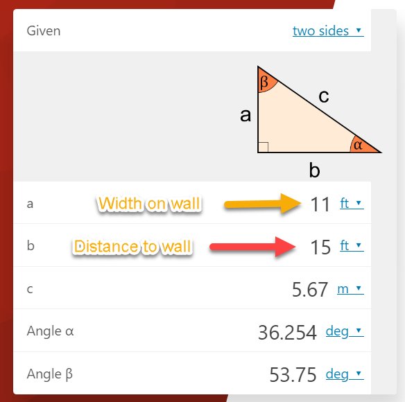

    When you play around, can you check beam angle? I would like to learn some information about beam composition.
    Here is convenient tool,
    www.omnicalculator.com/math/right-triangle-side-angle
    Type in distance to wall, and width on wall ( you can change unit by drop down) It will tell beam spread angle this way very easily.
    " a" can be full width, or center to beam end, whichever convenient.

    No problem at all :thumbsup:. That one's easy!

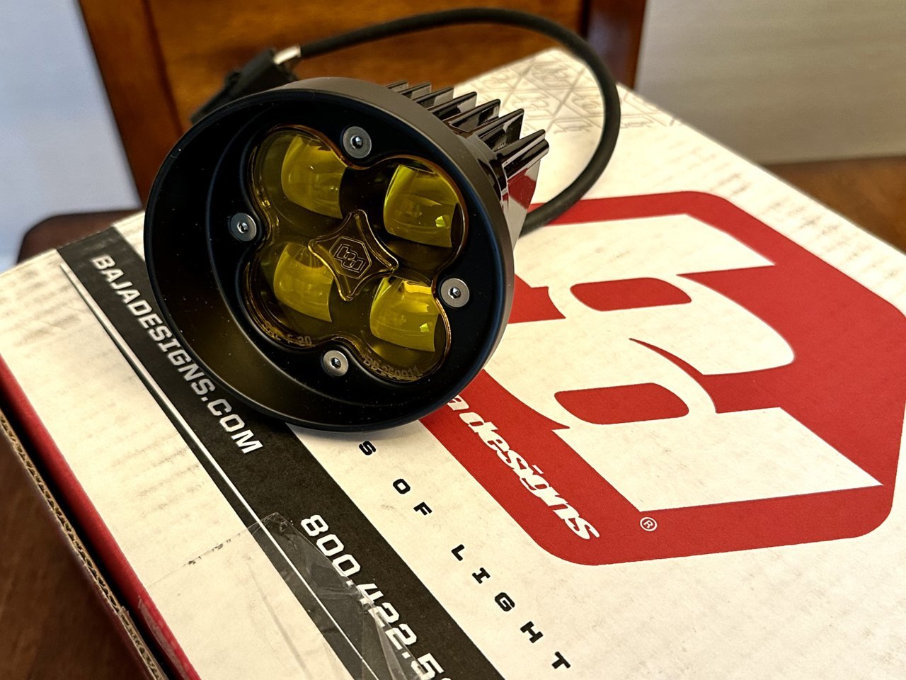

    Just showed up minutes ago. Looking forward to seeing how they perform.

    Very interesting, can’t wait for the review
