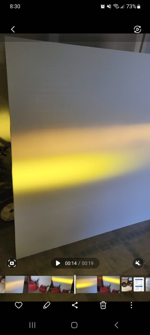

    Here is a screen gab from my factory TRD fog assembly with an osram fogbreaker 55 watt vs the DD ss3 max I upgraded to.

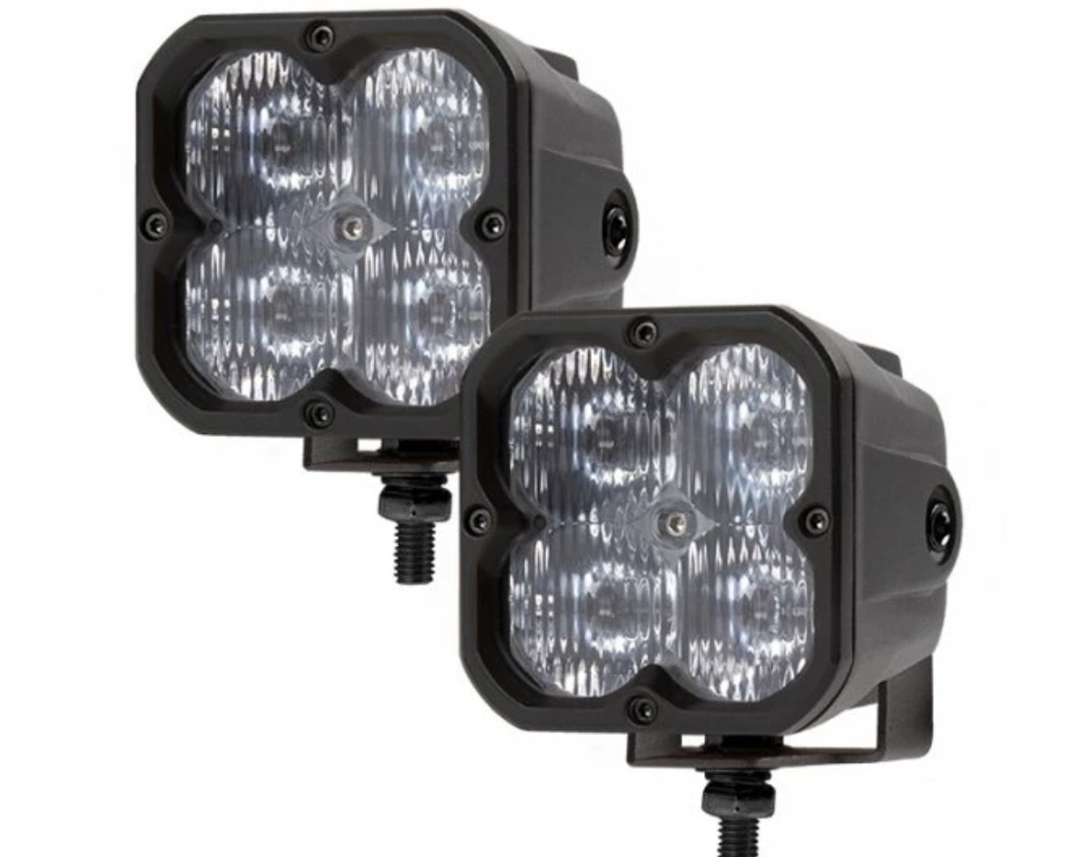

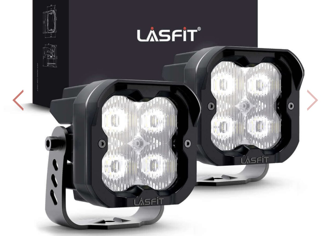

    You sure about that? The pod bodies are not alike. The output and power specs do not match between products.
    Lasfit
    Superbright LEDs
    Although the beam patterns for height and width appear to match exactly for driving and fog. Way too much of a coincidence for an advanced optic. Counting ridges in the driving optic appear the same for both, both with the unique center screw in the optic. So it may appear they are sharing a common poorly reverse engineered Chinese TIR optic, placed in their own housings and boards that differ from each other. As demonstrated in the original post in this thread, Superbright LEDs is nothing more than a flipper of Chinese pod products where other brands sell exactly identical products under their own label. And the type of company Lasfit is has already been covered.
