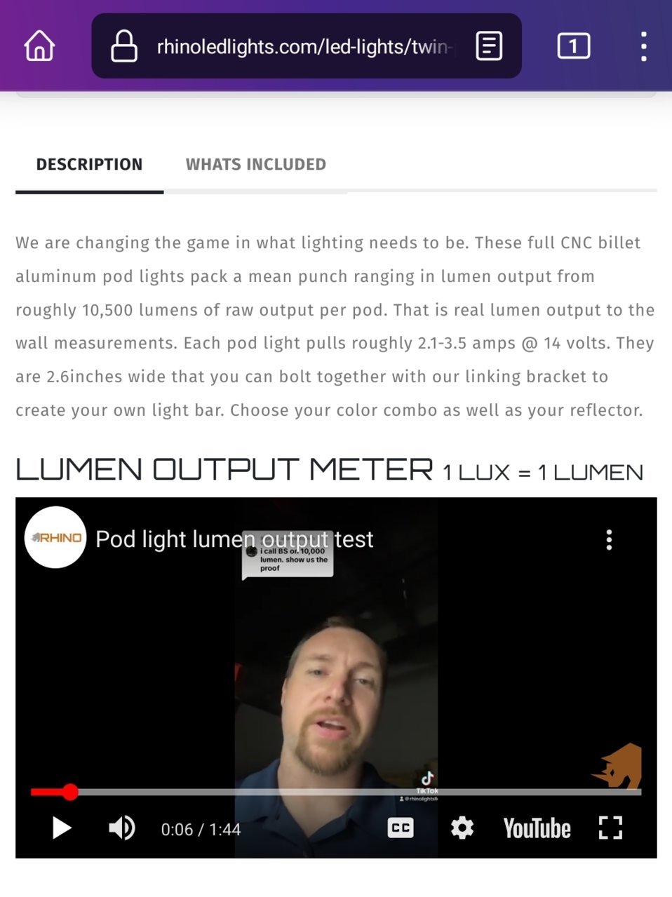

    This isn’t really a fog light exactly, but I keep getting ads for RhinoLightsLLC on my instagram feed. Wondering how these actually fair as pods in general. Anyone have any experience with that brand?

    Lots of complete, and contradictory BS on the site.
    >Picrel
    I have my doubts thats a multi-spectrum light meter. A Lux meter that is only meant for an incandescent lihhtsource will Vastly over estimate the light intensity of an HID or LED source.
    Secondly, he's got it in print that 1lux = 1 lumen. That's true, if that intensity is evenly distributed over 1 meter^2 of surface area. You can use a lux meter to determine the lumen output of a lightsource if you use an integrating sphere. Basically you use the polished, plain white reflective surface inside a spherical enclosure of a known surface area, and take an indirect intensity measurement. Pointing a lamp at a meter painters taped to a white wall is a way to take a poor intensity measurement. And intensity is increased/decreased by the distance from the lightsource.
    His power draw measurements are all over the map. He's saying between 2.1 and 3.5 amps current draw at 14 volts. But a steady 10,500 lumens. So he has a supplier for some of the most efficient, record breaking LEDs available, at between 357 lumens per watt and 214 lumens per watt. At 25+ watt input power, that's amazing, Cree/Philips/Osram/Nichia must be beating a path to his door.

    I appreciate the rundown on the info, very helpful.

    I'm not going to say whether its a poorly made light. Just the output claims are bad enough to immediately turn me away from the product.

    Right, the build seems decent, but as you said, the claims seem a bit odd.

    Not to mention botching basic terminology. There is so much wrong here.
    He is using a cheap $30 Chinese lux meter, not capable of accurately measuring LED output.
    https://www.amazon.com/URCERI-Illum...t=&hvlocphy=9033270&hvtargid=pla-521576659373
    The guy clearly doesn't know basic math. A lumen is 1^2 meter of light, aka 1m x 1m. What he has is a meter circle. A meter circle is only 78% the area of a meter square, meaning he is inflating the numbers by 22% at least, in just the area alone. But the 1^2 meter measurement also requires uniform distribution, which that optic will not have. Instead it will be brightest in the center where he is measuring, which will inflate the measurement significantly and on top of that he is adding a 22% multiplier because of the circle vs square. Also just holding by hand while filming yourself is also going to be highly inaccurate. Why would you not hard mount the light?
    He also didn't wait for stable output, can take 15-30 minutes of run time before taking a measurement. And stable output is a major challenge in the smaller compact pod sizes, as it is easy for the pod to start bright but then rapidly reduce output intensity as heat soak sets in and minimal material to absorb and shed the heat.
    So he is not using a tool capable of accurately measuring the output.
    His math is all wrong in calculating the output, greatly exaggerating product performance.
    He didn't wait to get an accurate measurement, exaggerating product performance.
    Errors x Errors x Errors = Look fantastic performance! o_O
    And if you have the engineering and manufacturing resources to make pods in the USA, then why are your product videos self filmed without help on a phone from what looks like a a clutter filled storage area using cheap off-brand lighting tools to sell your product, and botching basic lighting terminology in your video? Personally I wouldn't be buying anything from this company.
