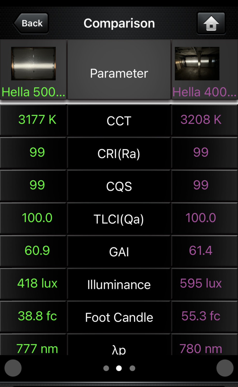

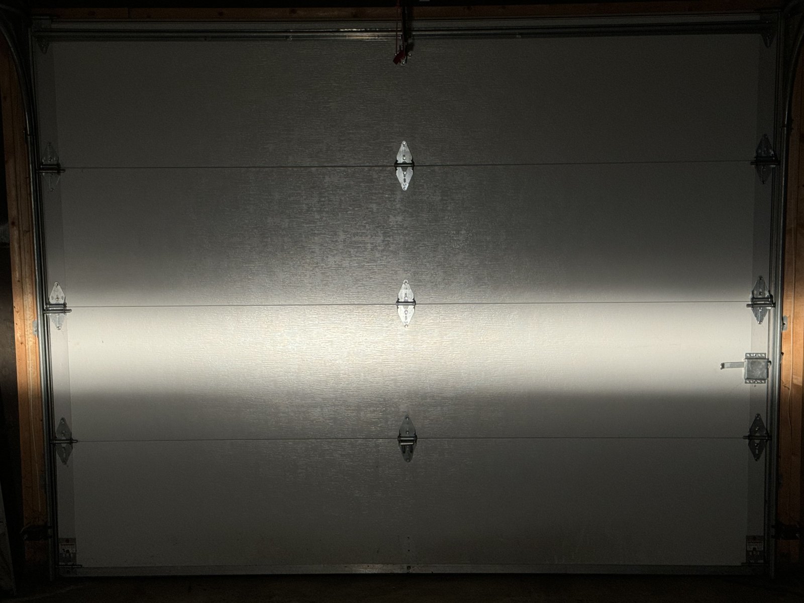

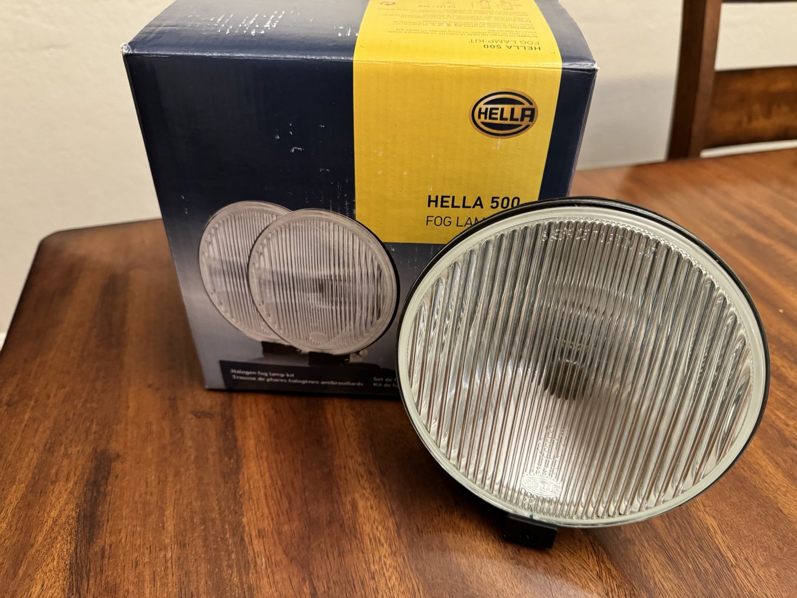

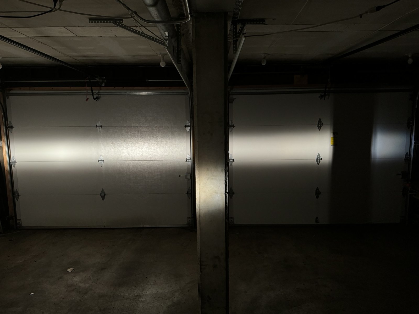

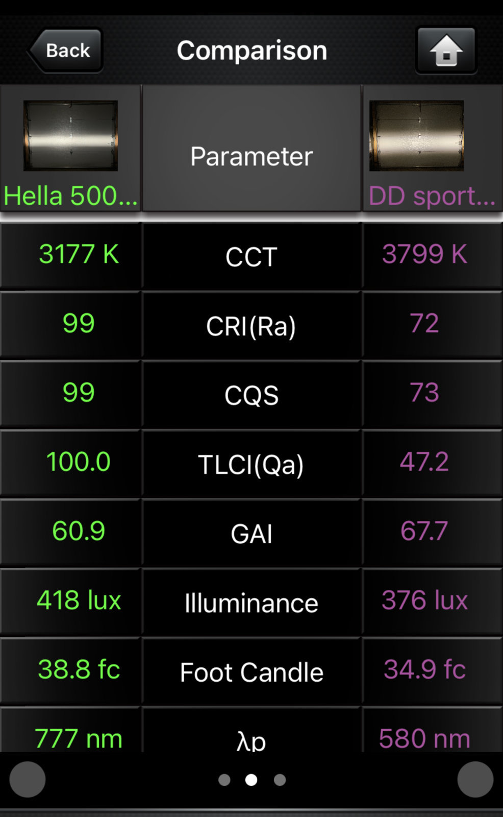

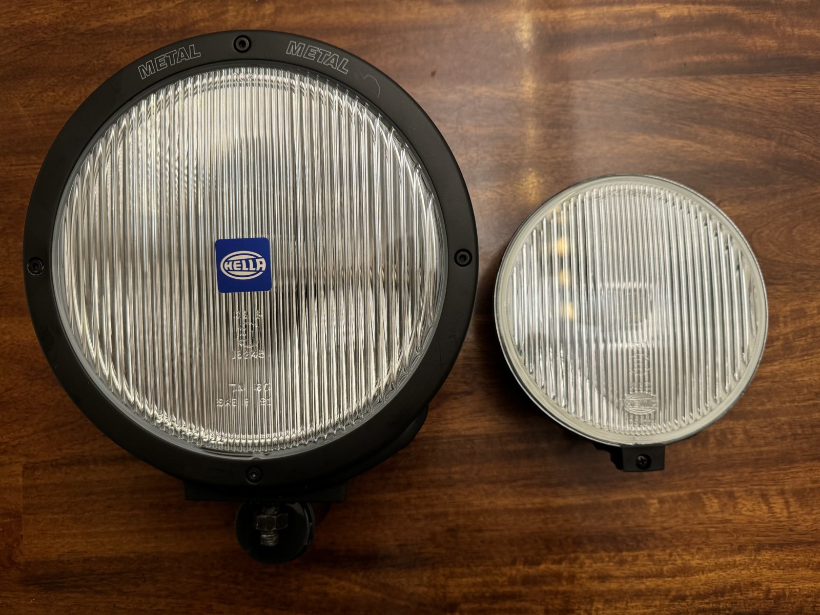

    Fun comparison, how do the modern LED fogs from this thread compare to long time halogen performance fog classics? For those in heavy snow environments this may be of interest.
    Hella 500 halogen fogs

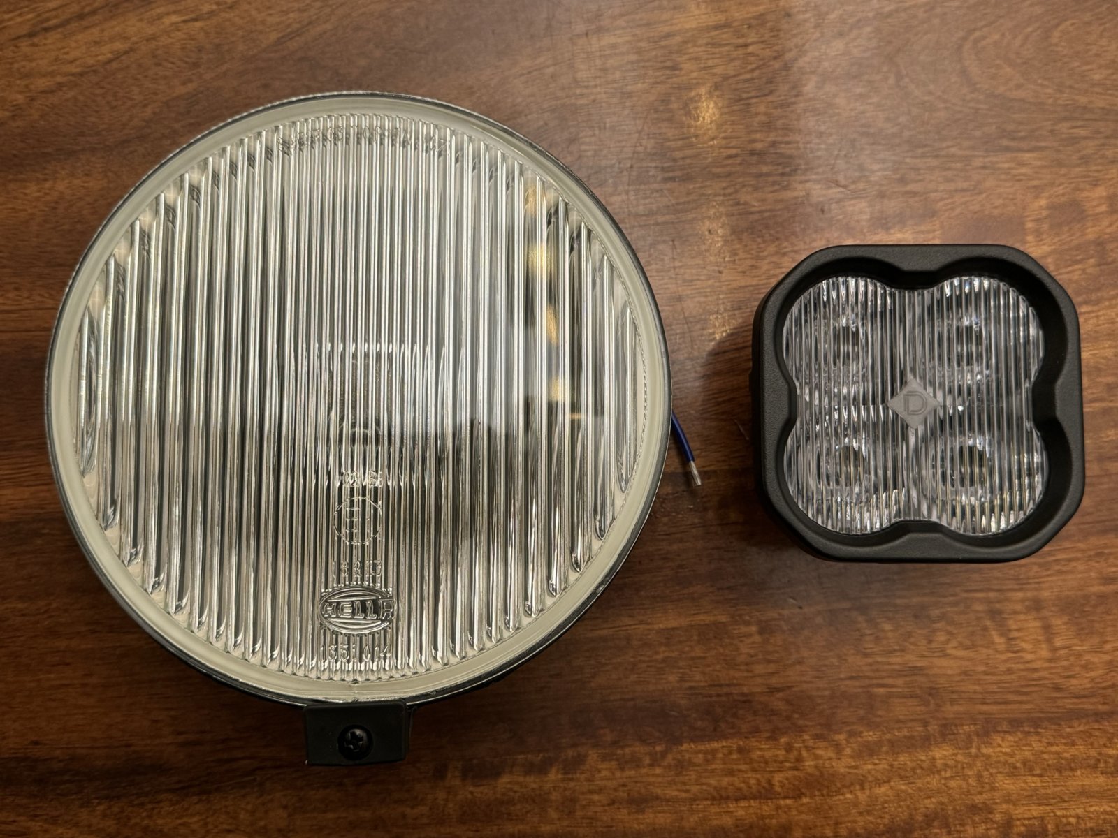

    Fist thing is obvous, the form size of the 6" Hella 500s are much larger than the traditional 3" pods like the popular SS3s. Depth is nearly identical. Though notice the somewhat similar, but different, fluting lens optics.IMG_2485.jpg
    The beam pattern of the 500s has tight cut offs, labeled as an SAE F 03 fog.

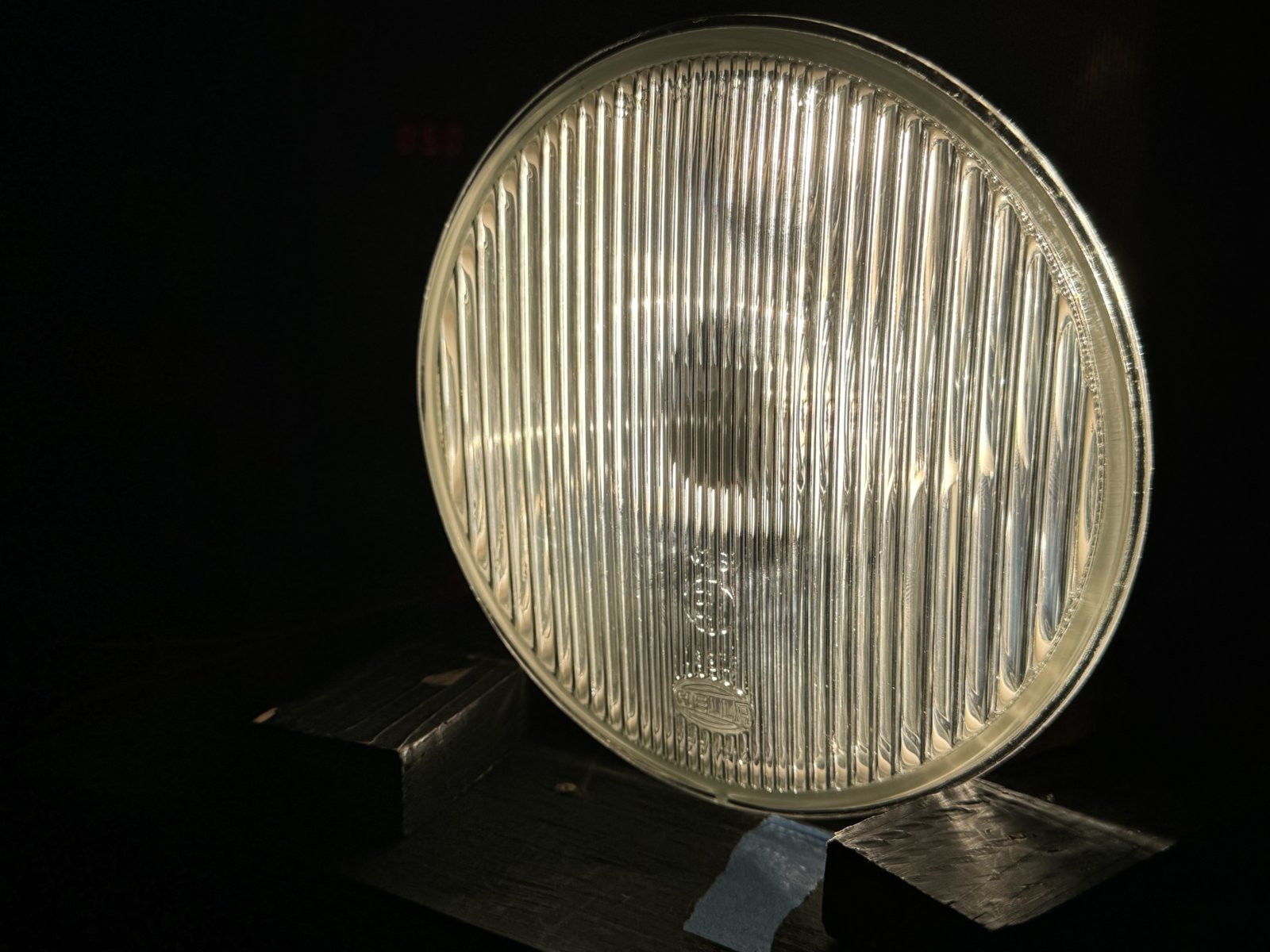

    Output with stock Hella 55w bulb
    Hella 500 fog w/ Hella 55w bulb
    The beam pattern is absurdly wide, wider than anything else tested.

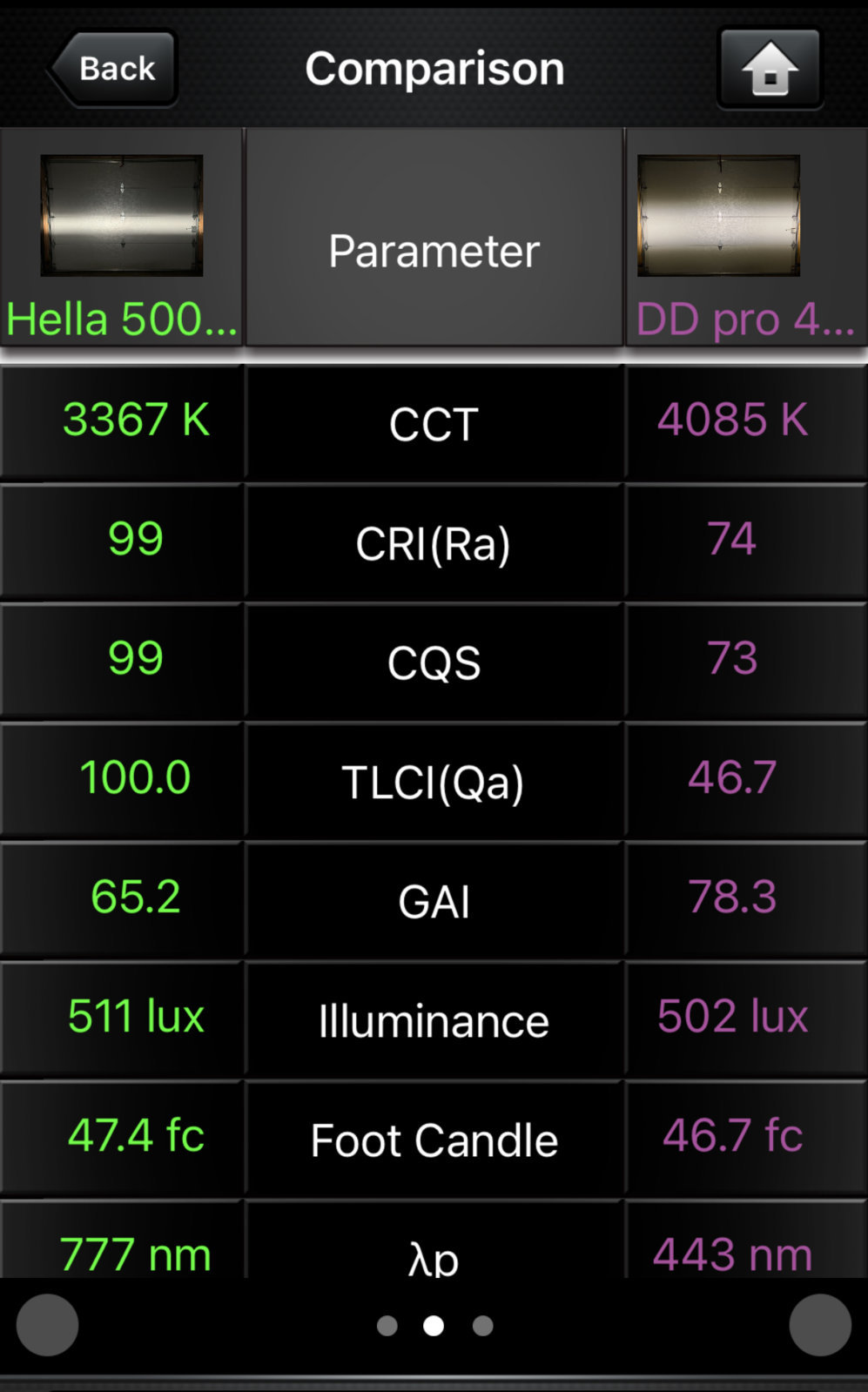

    Comparing output intensity with the SS3 Sports
    Hella 500 w/ stock 55w Hella bulbs vs SS3 Sports in 4000k
    Out of the box the Hella 500s come in about 11% higher in peak output intensity over the SS3 Sports.
    But every lighting enthusiast knows that most Hella bulbs should go straight to the trash and be replaced with a much better performance bulb. Quality halogen lamps are highly dependent on the quality and precision of the bulb for their performance, so running good bulbs is essential to get the most out of the lamps. So before really digging into the performance characteristics of the lamp lets get some good bulbs to truly see what they are capable of.

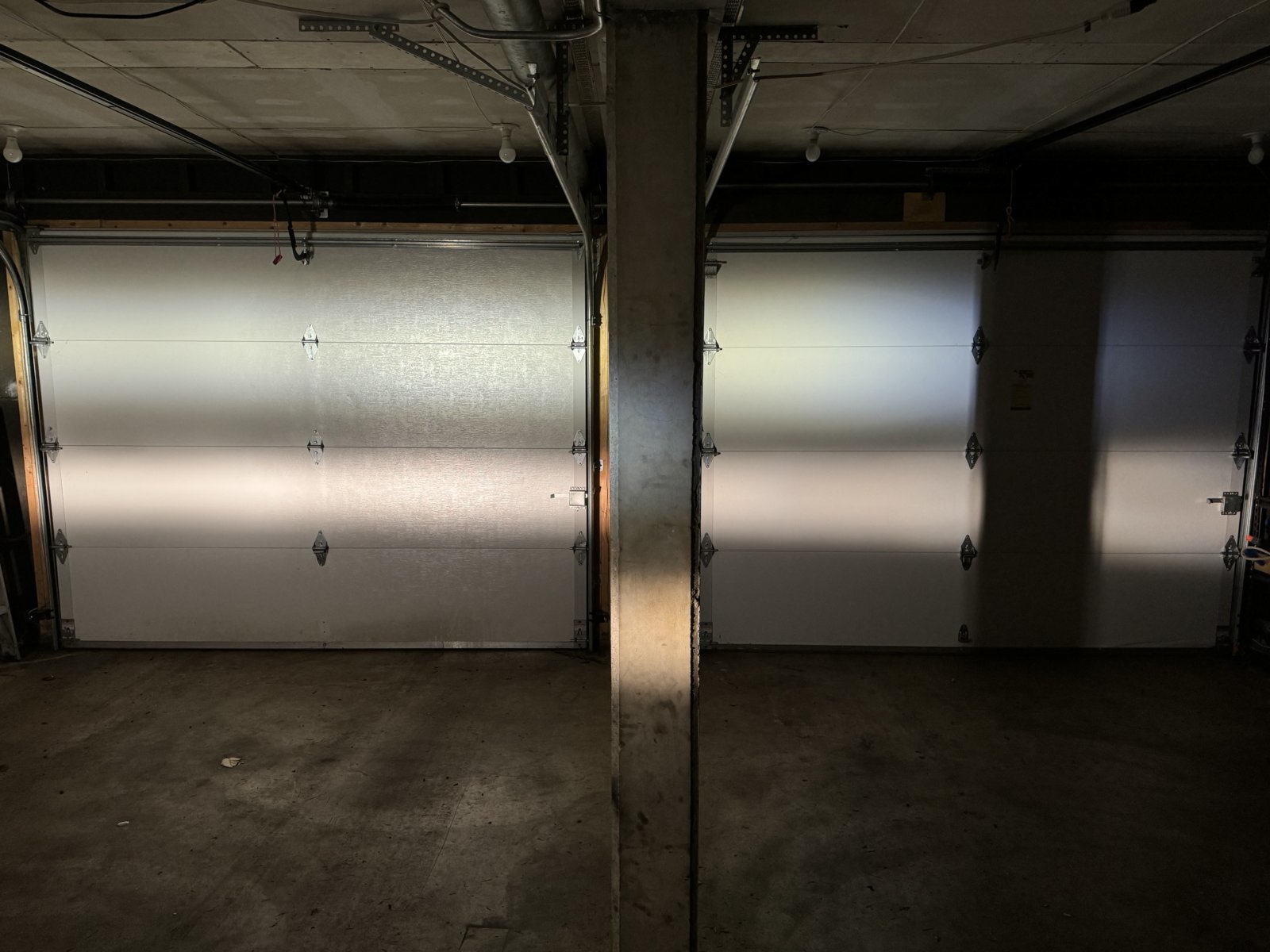

    The lamps take H3s, and the best stock wattage H3s are currently the Osram Night Breaker Laser +150s and for high wattage the Osram Super Brights (same as the Ultimate Headlight Upgrade thread).
    Hella 500 w/ Osram Night Breaker Laser +150 (bottom) vs DD SS3 4000k Sport (top)
    The Hellas have a much sharper defined pattern, much wider pattern, and interestingly where TIR optics narrow at the outside of the pattern the halogen optics actually expand the pattern coverage. Remember the fog is to illuminate the edges of the roadway so greater coverage to the sides is beneficial. What is also interesting is how the Hella pattern narrows on center, this would reduce the foreground light compared to patterns that maintain the same width, without sacrificing that wider shoulder coverage. The more focused center area does drive higher forward output intensity.
    Hella 500 w/ Osram Night Breaker Laser +150 vs DD SS3 Pro
    The Hellas gain +22% output intensity over the stock bulbs. Not only do the Hella 500s running a legal performance stock wattage bulbs have a far more disciplined pattern with better cut offs than the Pros, they outperform the DD SS3 Pro fogs in peak output intensity, though the pattern area is vertically smaller and also wider. (Note Pro pattern not pictured).

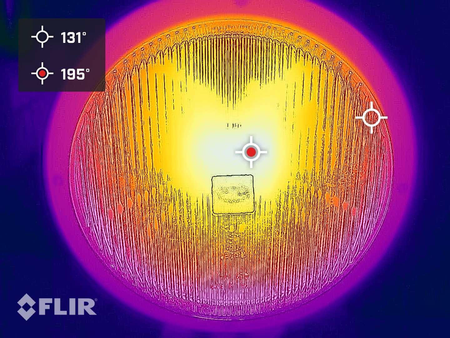

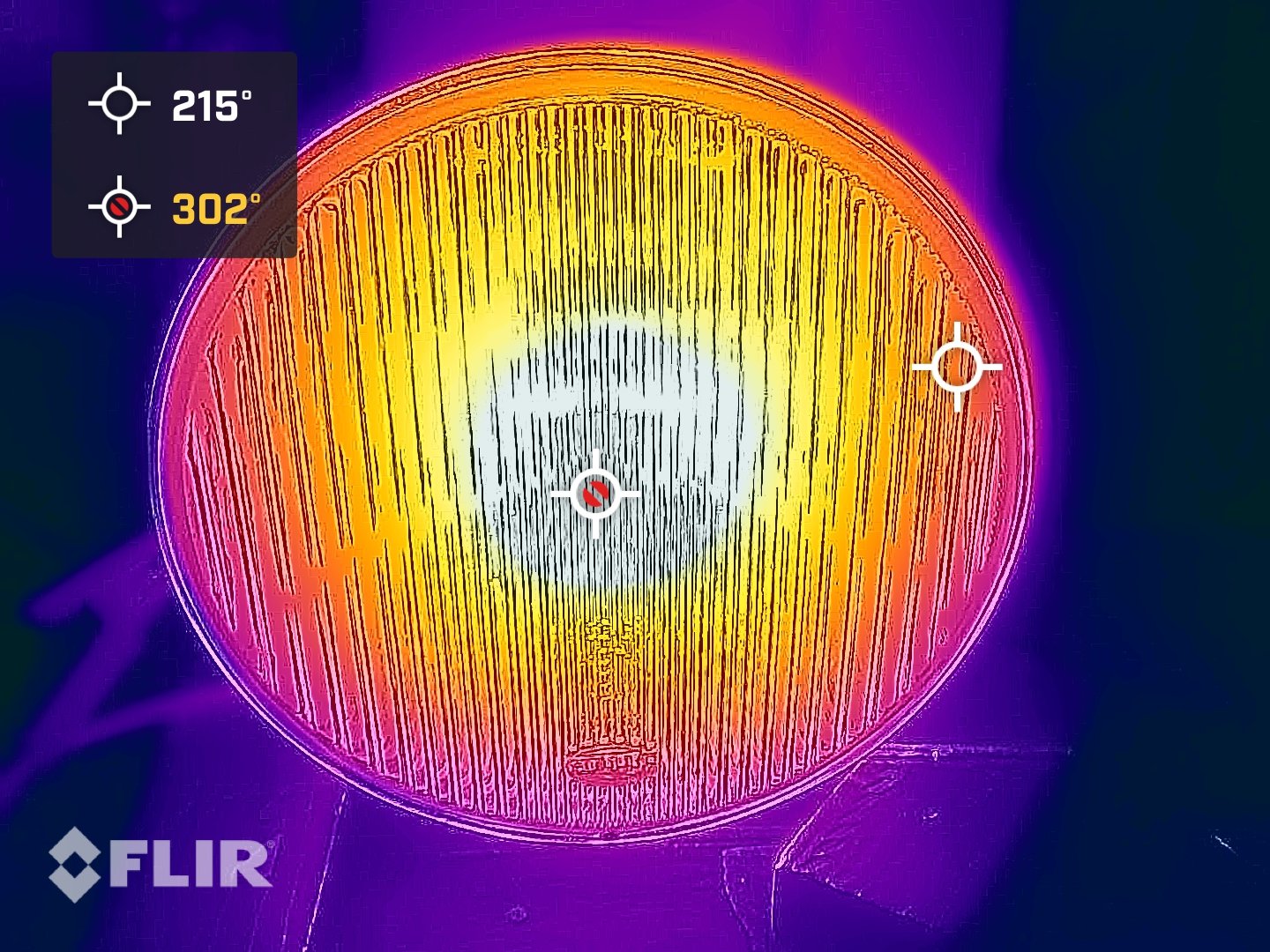

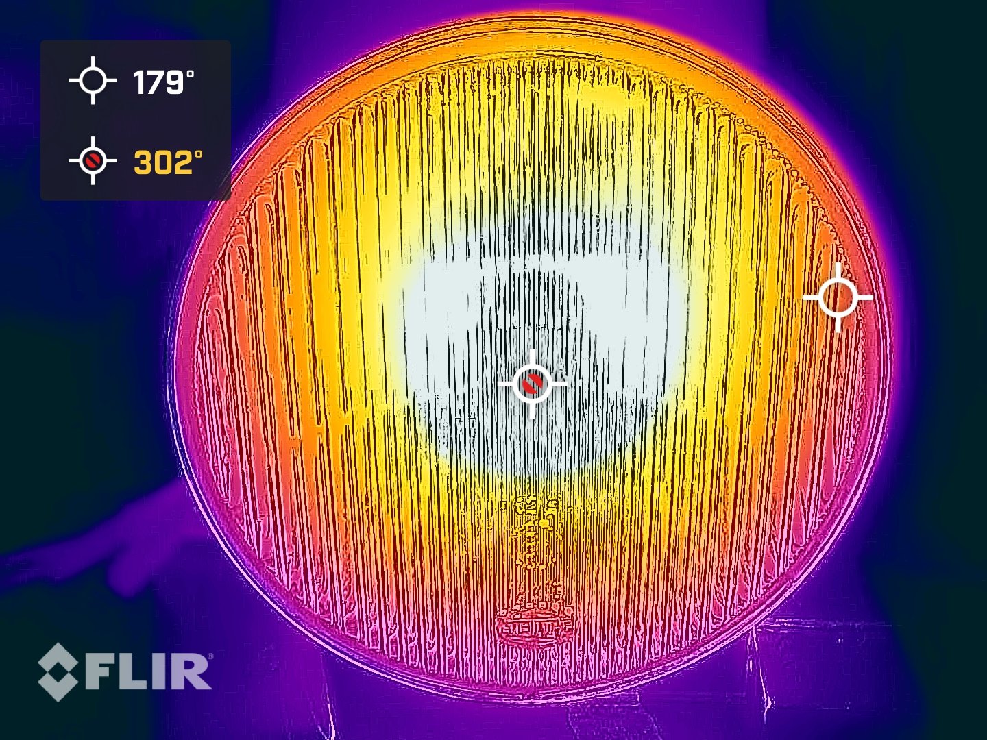

    Hella 500s w/ Osram Night Breaker Laser +150s tested in 69 F ambient.
    These lamps run off the chart hot compared to any LED, like melting flesh at the touch hot. Standing in front of the lamp it feels like an IR heat gun. For comparison the DD SS3 Max selective yellow (one of the hottest LEDs) hit 173 F on the lens after a long warm up period, these lamps are running over 300 F in minutes. In extreme snow environments the extreme heat of halogens for snow clearing will be beneficial to ensure the lamp is always clear.
    Stepping up to the Osram 100w Super Brights. The bulbs are actually about 90w as measured, it is common for high wattage bulbs to round to nice numbers.
    Osram Super Brights in Hella 500 Fogs
    Hella 500s w/ Osram Super Brights (bottom) vs DD SS3 Sports 4000k (top)
    The Osram Super Brights are an off road bulb and not legal for on-road use as the wattage is above the legal max. Testing of high wattage bulbs has shown Osram Super Brights to be some of the best at maintaining output quality at higher wattage. Osram is also a Toyota OEM supplier. The Hella 500s with the Osram Super Brights appear to have better cut offs than DD SS3 Sports, even though using a high wattage bulb.

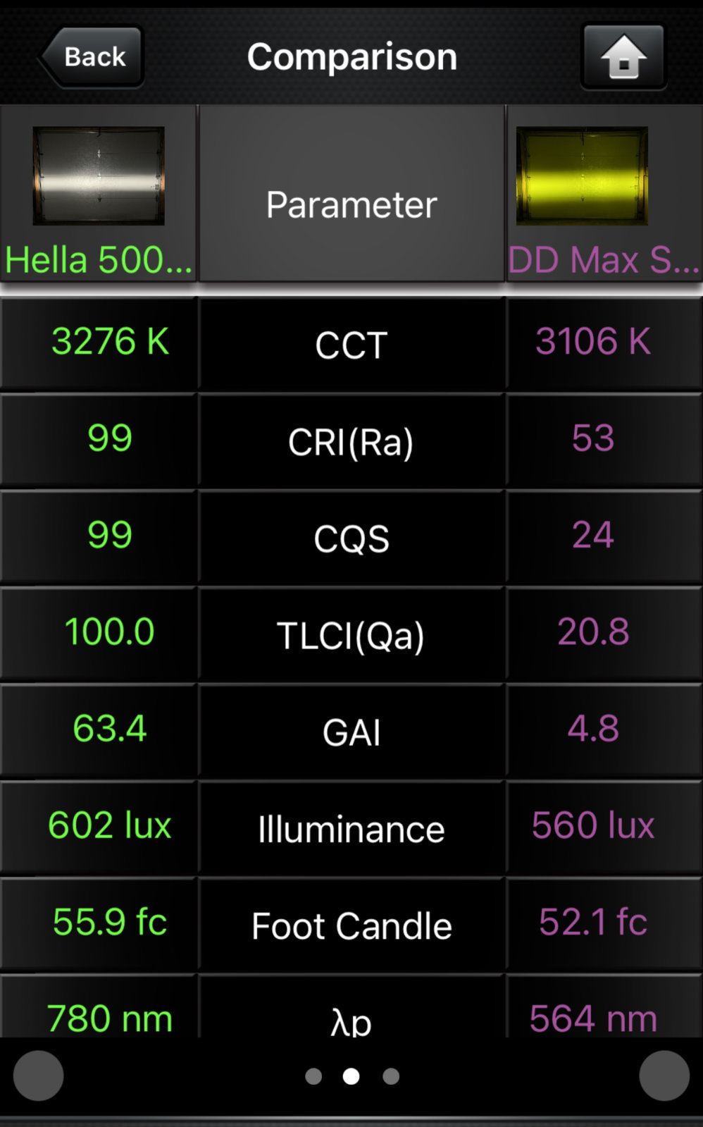

    Hella 500 w/ Osram Super Bright vs DD SS3 Max selective yellow
    The Hellas gain +44% output intensity with the Super Brights over the stock bulbs. The Hella 500s with a Osram Super Bright bulb upgrade beat out the DD Max selective yellow by about 7.5%. Now the 6000k Max will do much better and easily beat out the Hellas, however 6000k is a not a ideal color for fog/poor weather use, hence comparing to 4000k and yellow vs ~3200k-3400k halogens. The Max is not available in 4000k.
    Hella 500 w/ Osram Super Bright in 69 F ambient
    Interestingly the lamp peak temp is the same as with the Osram 55w +150s, this must be due to more focused output. The overall lamp is much hotter with the Super Brights as shown by the proximity temp measurement coming in at 20%+ hotter.
    Lots of trade offs with halogens, great at melting snow but larger lamp size and short bulb life. The Osram +150s H3s have a lifespan of 150 hours and the Super Brights about 50 hours. But while that is short, in a fog application use time should be minimal, as fogs should rarely be used, only when conditions call for slow speeds where visibility is limited and it is difficult to find the edge of the roadway.
    Note that thermal shock with water splashing on a hot lens in very hot halogens can cause lens failure/cracking.

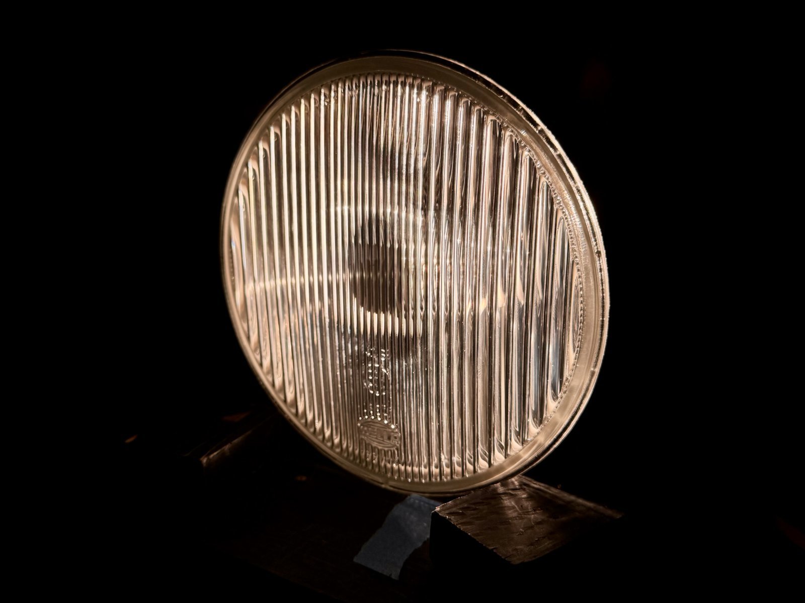

    But the 500s are not Hella's best performing reflective fog.

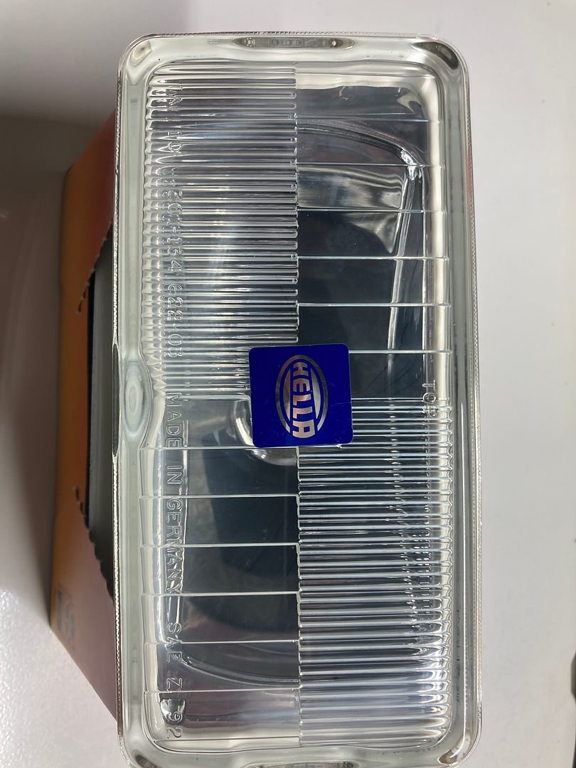

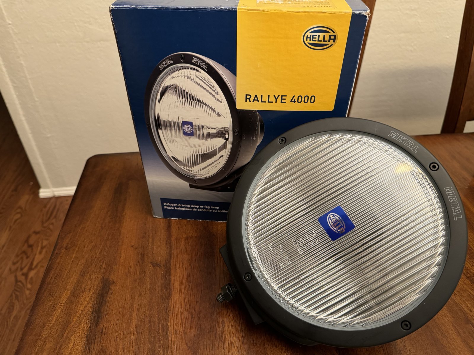

    Hella 4000 Rallye Fog
    This lamp is massive.
    Hella 4000 vs Hella 500
    The 4000s are stamped SAE F 91.
    Hella 4000 (far) vs Hella 500 (near)
    The outer fluting didn't stagger as much on the 4000 vs the 500s, so the outer edge of the beam didn't fan out like the 500s and it isn’t quite as wide as the 500.

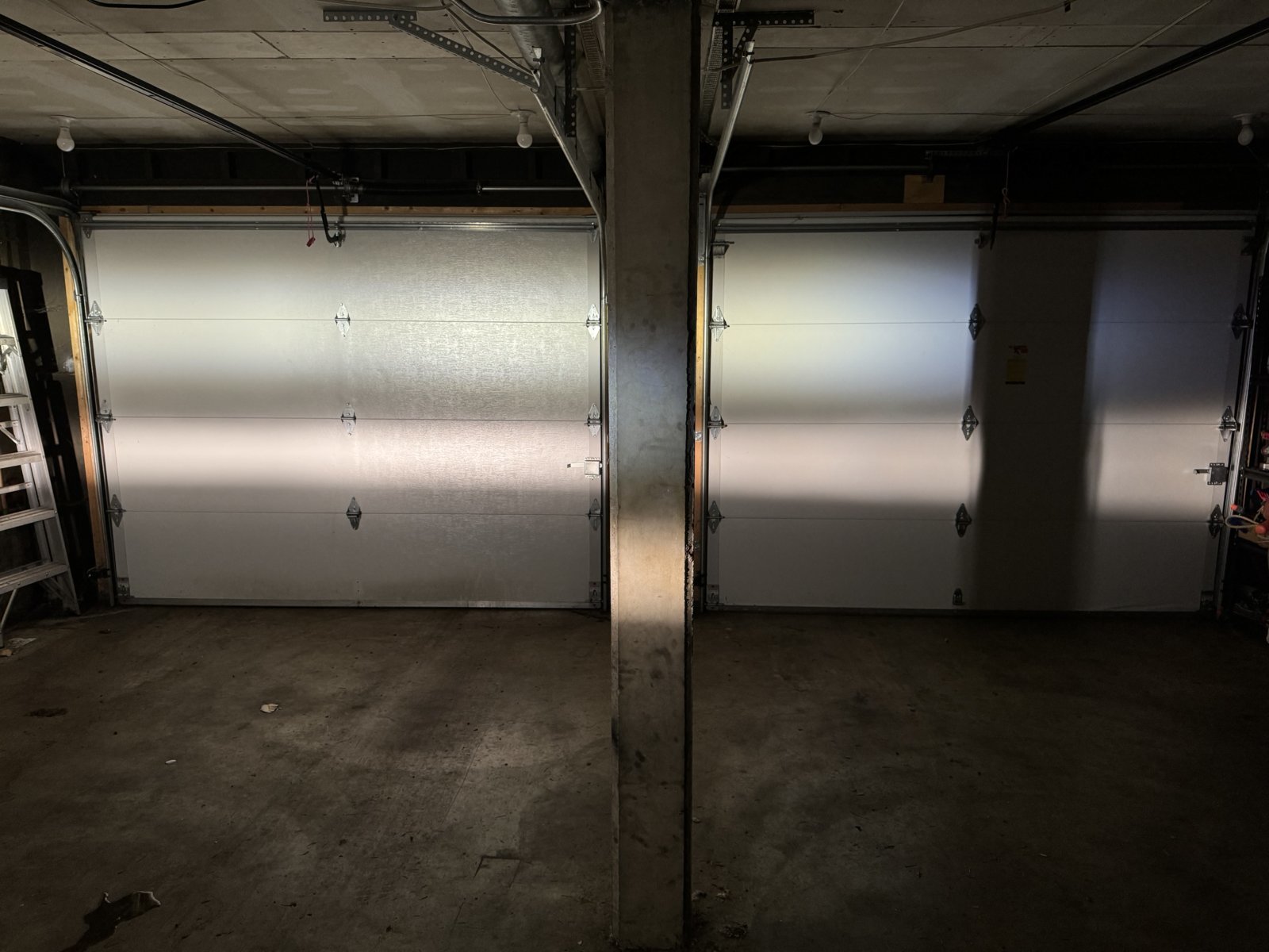

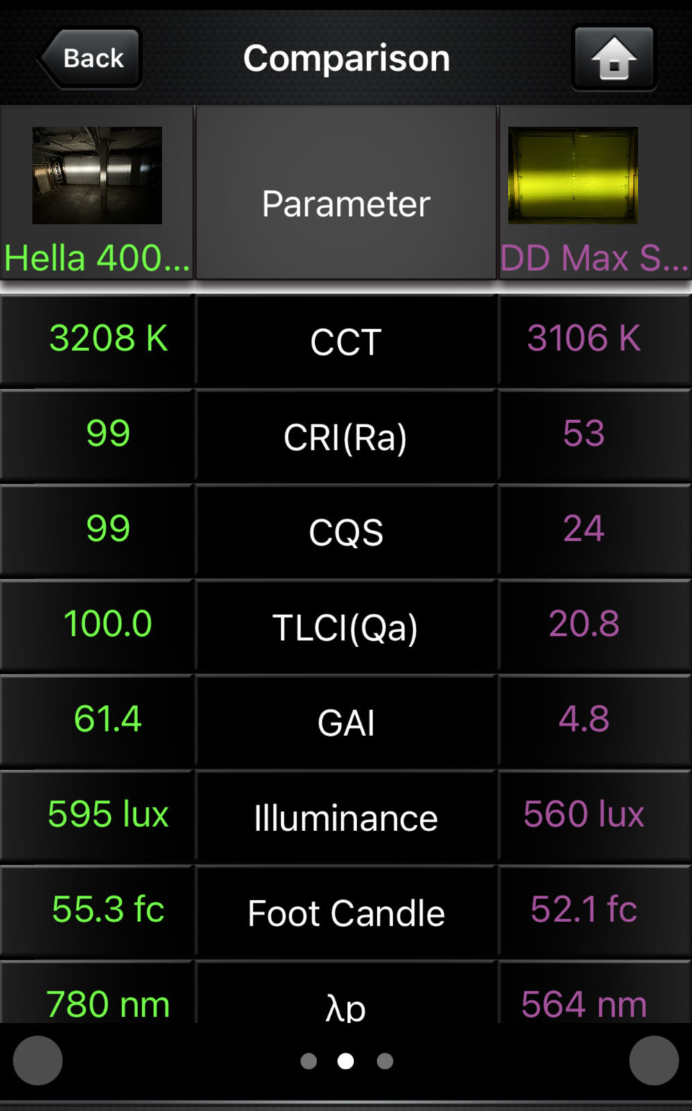

    Hella 500 w/ 55w Hella bulbs vs Hella 4000 w/ 55w Hella bulbs
    Wow.
    In reflector optics larger and deeper optics are more efficient than shallower and smaller optics, the 4000s are much larger and deeper. The 4000s return an impressive +42% output intensity improvement over the 500s using the same stock Hella bulb. The stock 55w bulb in the 4000s provides roughly the same level of peak output intensity performance as the Osram Super Brights in the 500s. These 4000 lamps will excel with bulb upgrades.
    Hella 4000 w/ stock Hella bulb vs DD SS3 Max in selective yellow
    The Hella 4000s outperform the SS3 Max in selective yellow in peak intensity without any bulb upgrades, running the stock Hella 55w bulb. The 500s gained +22% output intensity with the Night Breaker Lasers and +44% output intensity with the Osram Superbrights over the stock Hella bulbs, this being a larger and more efficient lamp I'd expect even better gains.

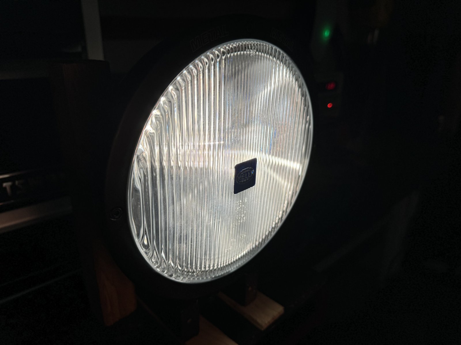

    Hella 4000 w/ 55w stock Hella bulb
    The 4000 lamps are very large and heavy, I won't be able to use them. So I plan on returning them without taking them apart for further bulb testing.
    LED lamps certainly have the small form factor, life longevity, durability and efficiency but it is very interesting to see how classic halogen fog lamps stack up to the modern LED ones in terms of performance, as it isn't quiet as one sided as it may initially seem.

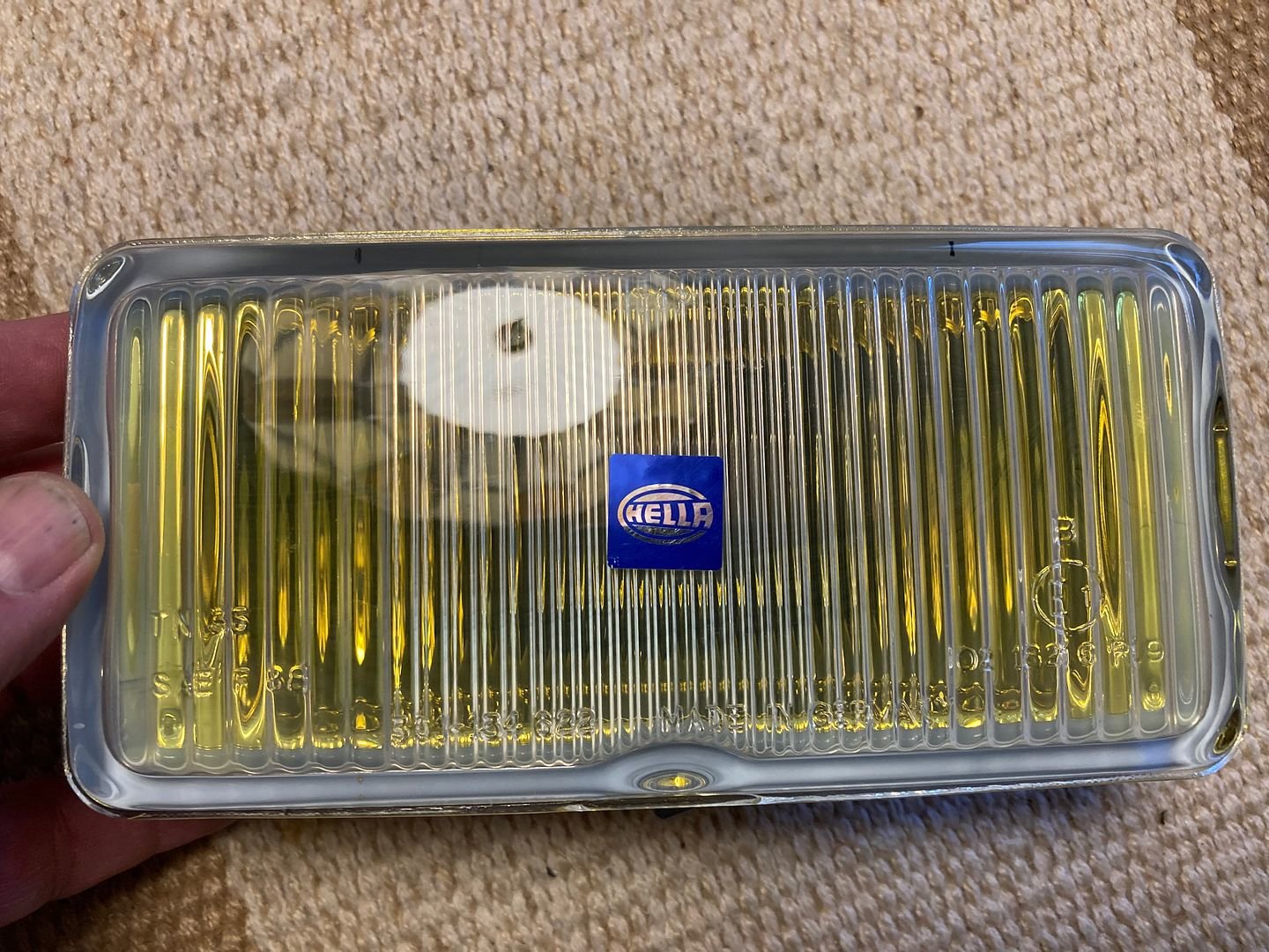

    Yes, I do have a set of Hella 550 yellow fogs in perfect condition. Would you like me to loan one or two to you for testing?
    Toy_Runner likes this.

    No problem. I'll send you one in a housing. Don't worry about the 500's I sent you. I'm sure you can put them to good use - or dispose of them properly. I'll try to get it packaged up and shipped this weekend. I will need the 550 back though. BTW, note the neat yellow reflector with a clear glass lens.
    PS: I also have the extremely rare 550 mid-beam. Do you want one of them just for giggles?

    Consider it done. I will need this one back to someday. These bad boys are rare!
    And for those of you that don't know what this particular light looks like:
