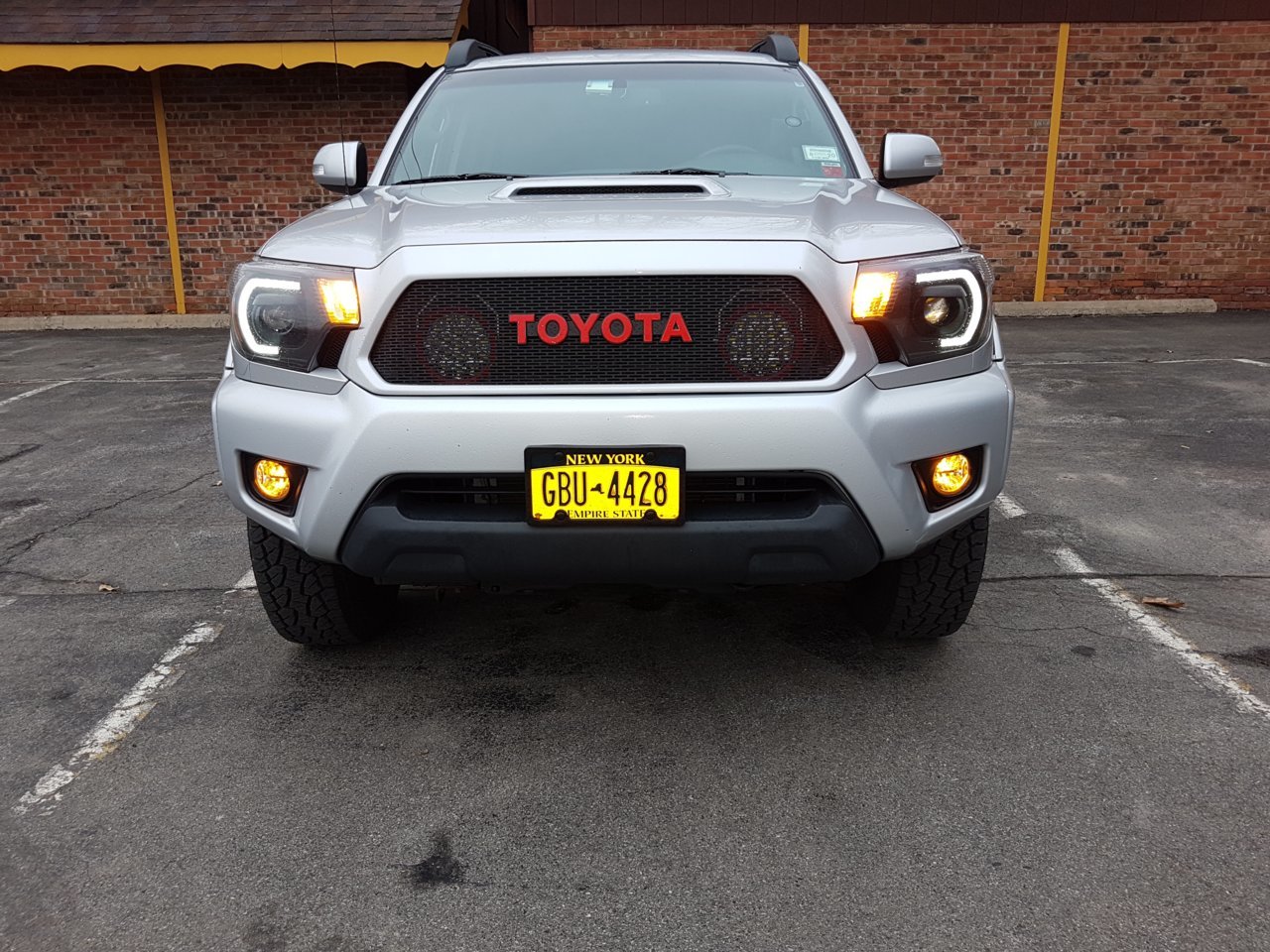

    I bought the KC G4's after seeing them here and doing a bunch of follow up research. I'm very happy with them.

    Been very happy so far. I have 5000k HID's in the headlights and they work nicely together. I have not driven in any super figgy conditions but have been in light fog. Flicking them on and off I could see a nice difference.
    I have them running pretty much anytime the truck is on. I did the fog light anytime mos and run with my marker lights on.
    I think it looks great, and a but more visible on the road is a good thing.

    No opinion on the 1st option, but I have the KC's. Was amazed at how easy they were to install. I had the headlights out already, so super simple. No splicing, straight bolt on. Could get them in amber from the factory.
