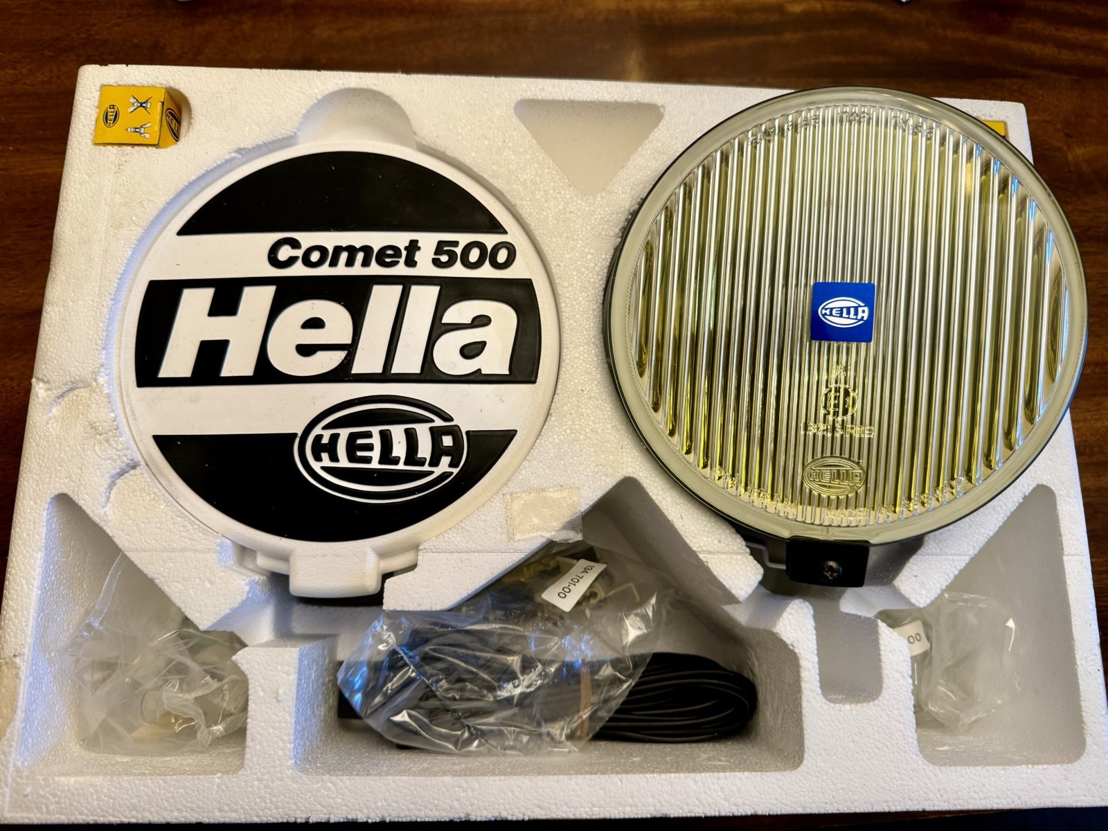

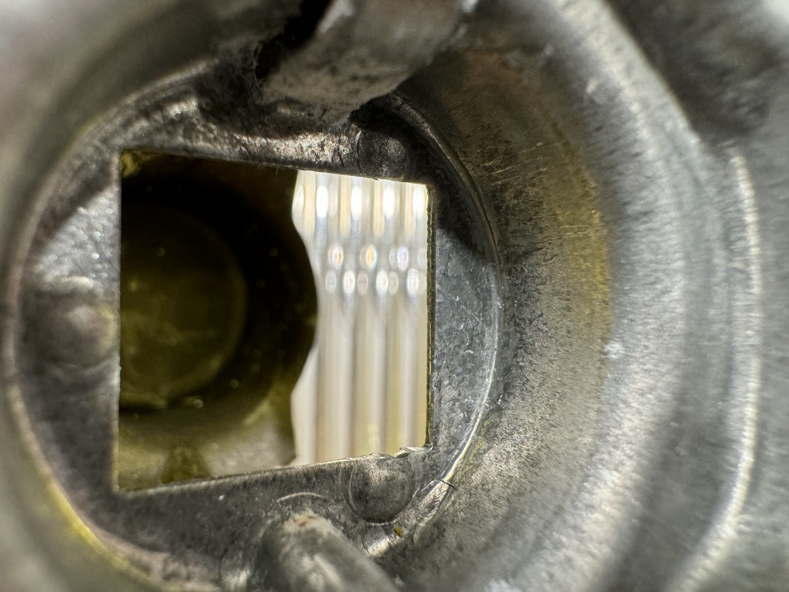

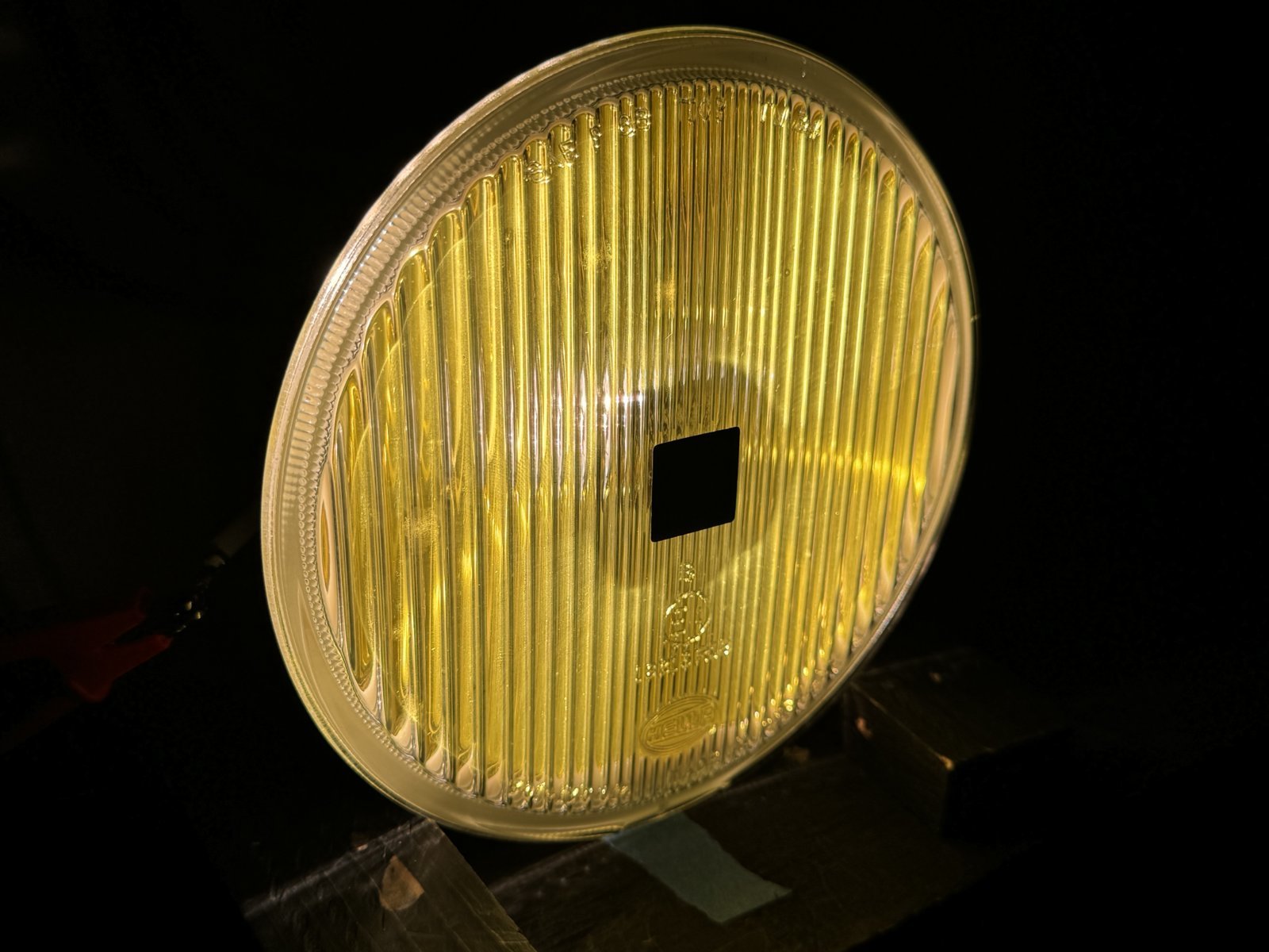

    Hella Comets are the yellow version of the 500 fog. These are the original German made lamp and no longer in production. I managed to find some rare new in box old stock.

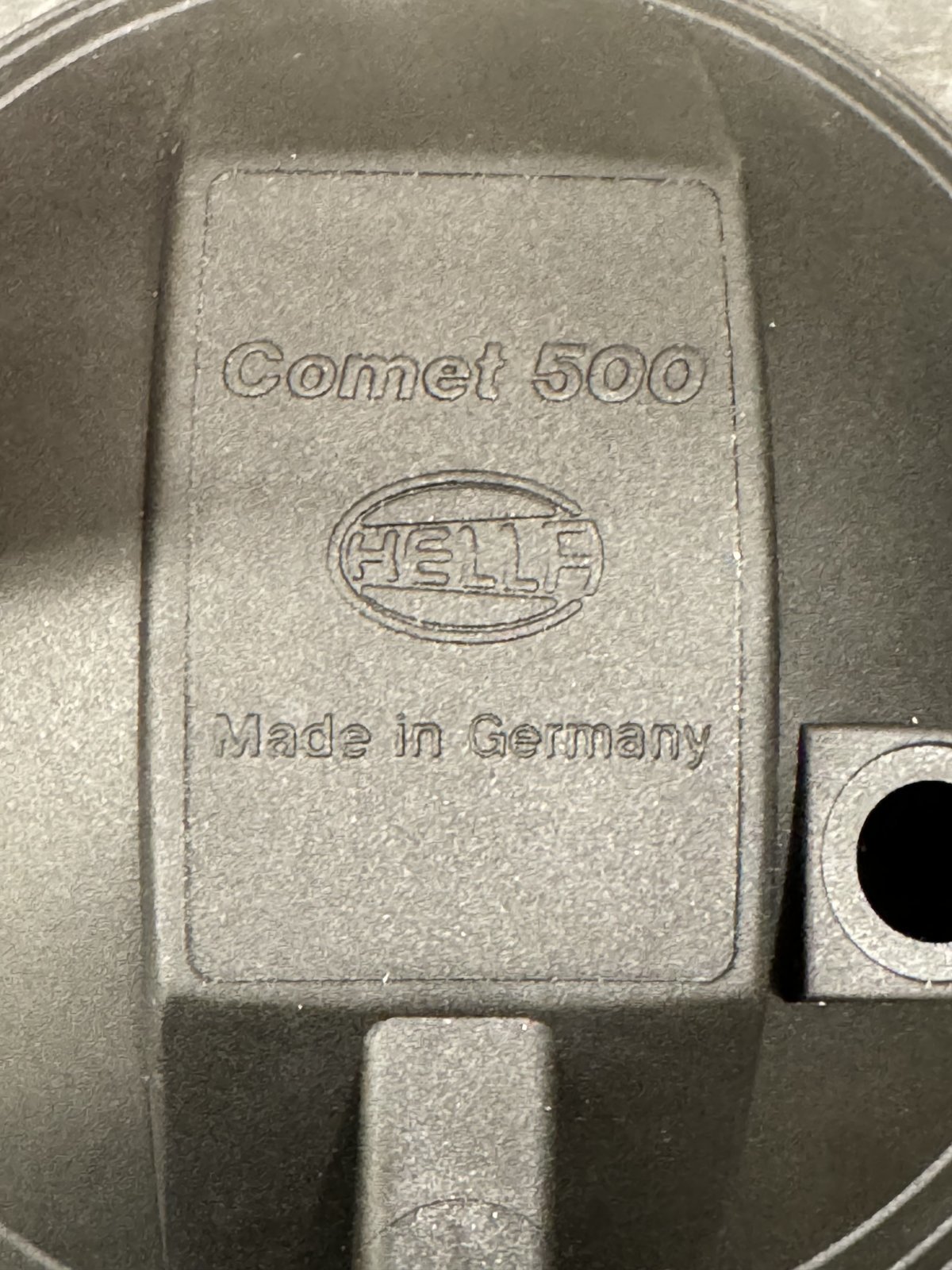

    Made in Germany, things you rarely see for Hella assemblies anymore.
    These Hella lamps do not use a yellow lens, instead they use a yellow reflector. Also worth noting the internal bulb glare shield for excellent light control. Looking into the back of the lamp, you can see the lens is clear and a hint of yellow reflected onto the glare shield.

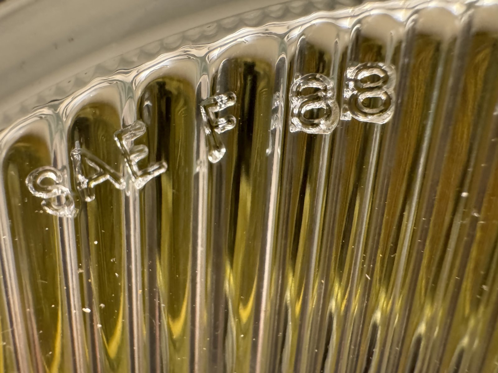

    These are stamped SAE F 88, much older than the current Indian SAE F 03. The numbers are the SAE compliance code date.
    Powered on the lights do look yellow
    Its yellow. But not the same rich level of yellow we've come to expect from the LED SAE selective yellow fogs. This is more of a warm white/yellowish halogen color.
    Vs clear 500s

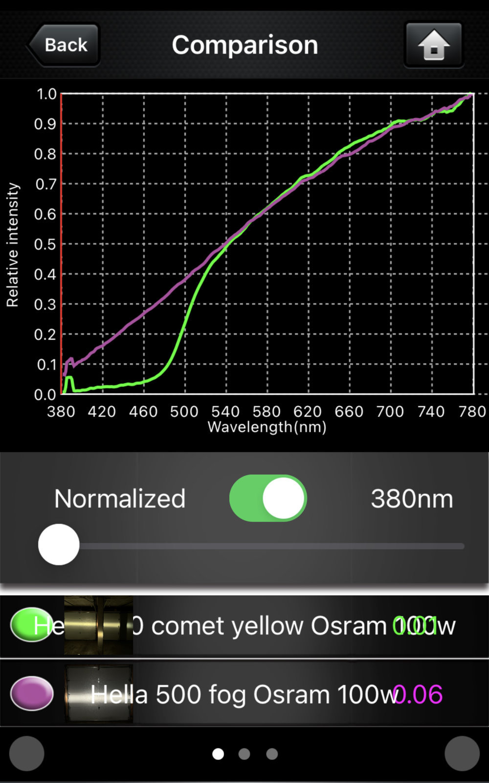

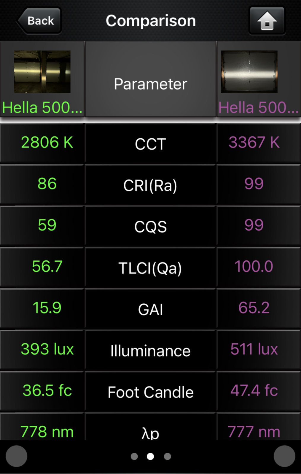

    Looking at the normalized spectrum comparison, the yellow comet lamps (green plot line) are very effective at removing the short wavelength light for better poor weather performance.

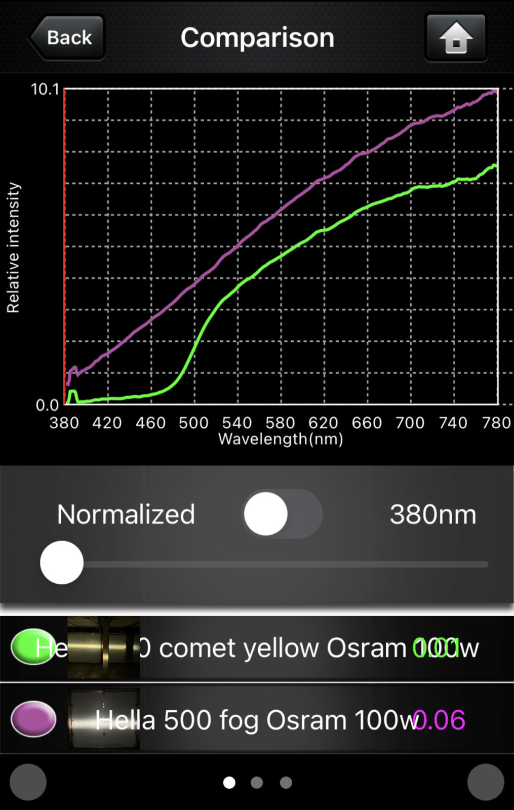

    However, looking at the absolute value comparison, the yellow reflector appears to be much less efficient, taking losses across the entire spectrum.

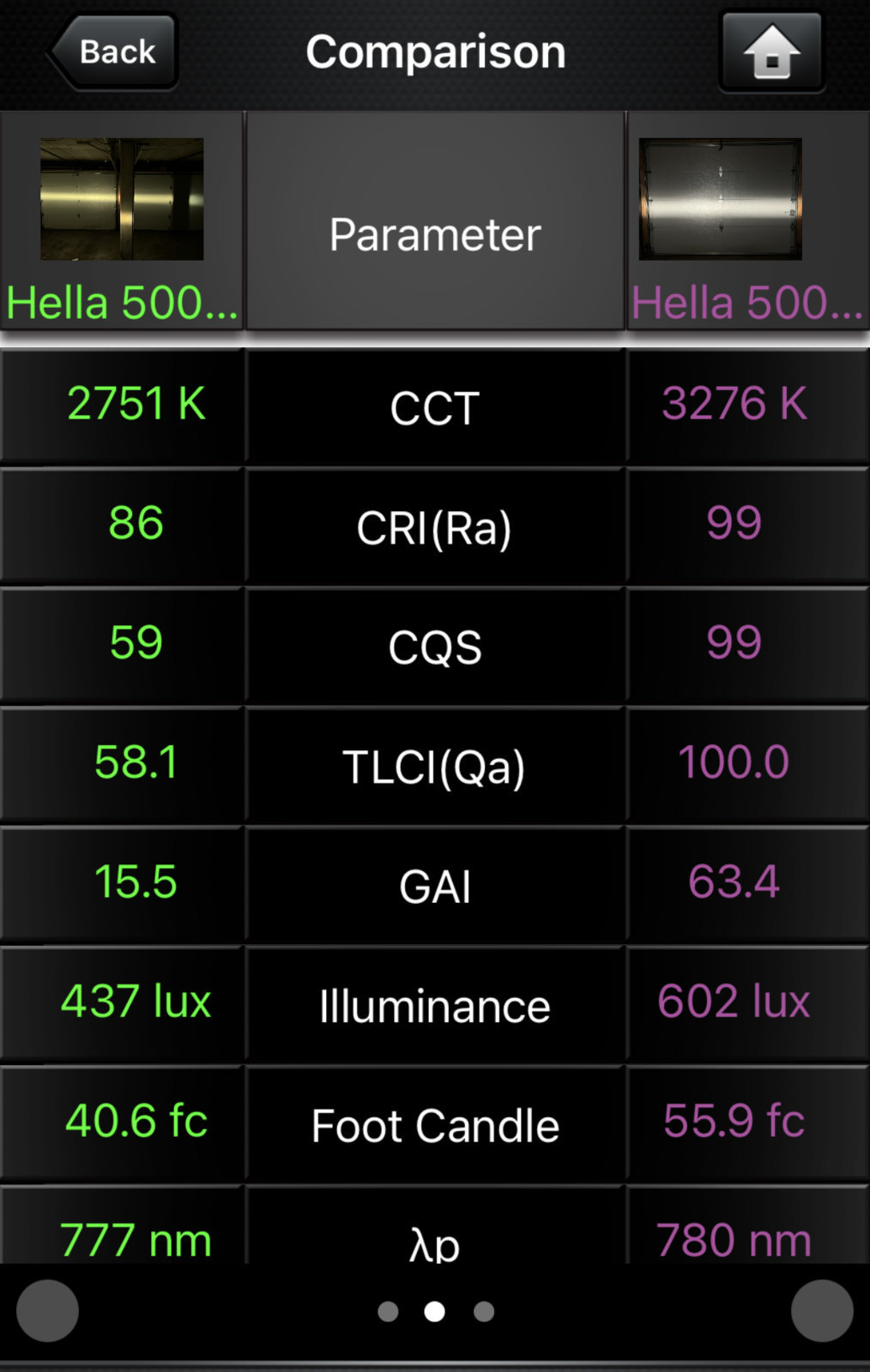

    Hella 500 yellow vs clear with Osram Nightbreaker Laser +150s
    The yellow lamps take a surprising 23% loss in output intensity compared to the clear lamps. This places the Hella yellow lamps just slightly above the DD Sport 4000k fogs in peak intensity (393 vs 376 lux).
    Hella 500 yellow vs clear with Osram Superbright 100w bulbs (90w actual)
    The yellow Hella lamps take a 26% loss in output intensity compared to the clear lamps. This places the lamps above the DD Sport 4000k fogs, but still below the Pro in peak output intensity. (Hella yellow 437, Sport 4000k 376, Pro 4000k 502 lux).
    The losses are out of line for converting halogen white to yellow. Diode Dynamics 4000k LED white conversion to a much richer yellow incurs losses roughly 1/3 of what we are seeing on the Hellas with a much smaller color shift.

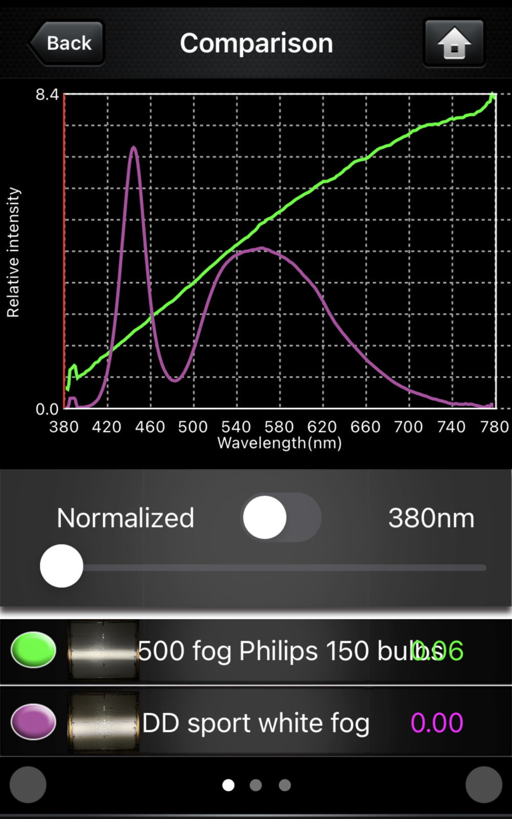

    Spectrum comparison of the Hella clear fogs vs 6000k DD Sport fogs
    You can see that high amplitude spike in LED output isn't present in halogen output. While there is some short wavelength light, is is a minority of the output.

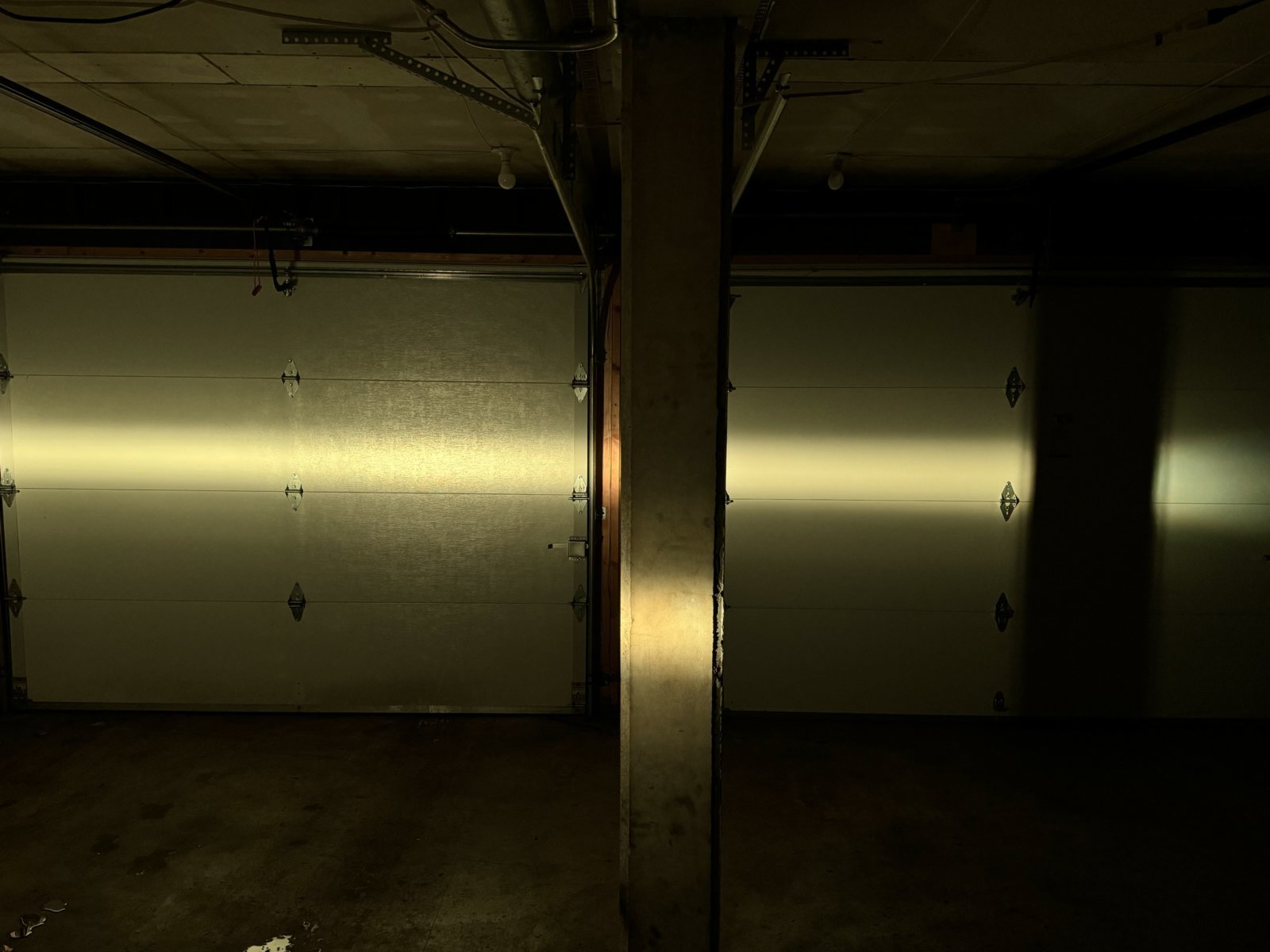

    Selective yellow painting
    I tried painting the clear Hella 500 fogs yellow, following the procedure on Stern's site using the Duplicator metalcast yellow. This is a commonly accepted practice for converting halogen lamps to selective yellow, but insufficient for LEDs due to the LED high color temp needing greater correction.
    I went very light on the coats, applying 5 light initial coats and let dry for 1 week. I was careful to initiate and end the spray not facing the lamps to avoid irregularities/splotches in the spray pattern.
    After 5 coats painted Hella yellow 500s top vs Hella Comet 500s bottom.
    The painted yellow 500s clearly didn't have the desired color correction, it wasn't yellow, more of a very warm yellow-ish-white. It also seemed to affect the sharpness of the cut off. I started to question whether this is a legitimate solution.
    German Comet 500 left vs Indian painted (5-coats) 500 right.
    I added 4 more coats, trying to make them still very light, but just slightly heavier than the initial ones.

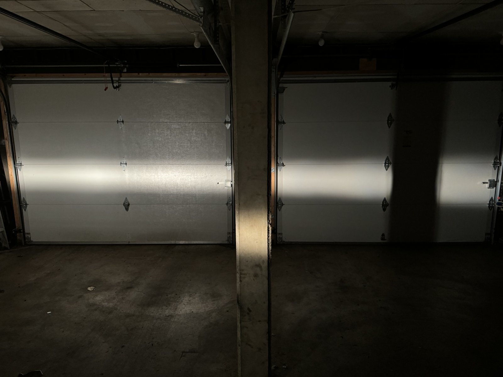

    Cameras play funny tricks with lighting and color, but this is next to the DD 4000k sports. The lights look much more yellow with the additional coats.

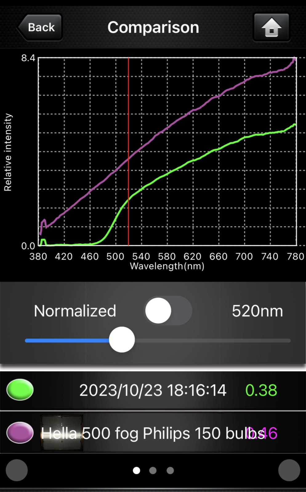

    I’d expect the pre and post painting output spectrum to look something like this for absolute (this is normalized). Output loss below ~520nm-ish, the short wavelength spectrum. This is what a yellow filter should accomplish, reducing the short wavelength light without significant effect to the longer wavelengths.
    Painted Hellas green vs clear Hellas purple, both running Philips +150s
    But here are the absolute measurements. Significant losses across the spectrum, resulting in massive output loss.
    While halogens produce little short wavelenth light they seem to be incurring losses across the entire output spectrum with a yellow filter. That doesn't make sense.
    For perspective context, the original Rigid D2 selective yellow fogs had some of the highest output filtration losses in the industry for selective yellow at 20% (but also the first selective yellow LED fog to market). Diode Dynamics has highly optimized 4000k emitter based selective yellow fogs with excellent efficiency at 7-8% loss.
    Painting the lenses of the Hella 500s resulted in a crazy 42% output intensity loss.
    Hella painted yellow lens vs clear 500 fogs w/ Philips +150 bulbs
    Any light color change is achieved through a filter and filters reduce output. But in this case the color correction of a halogen to yellow shouldn't be greater than a higher color temp LED correction to yellow in a well executed scenario, since the halogens will require less color correction (aka filtration) than a typical 6000k LED, meaning the should incur lower losses.
    Back to this picture.
    My working theory is that the micro-fine surface texturing of the lens caused by the repetitive light coat painting has caused the outer lens to act as a diffusing surface, reducing the focused peak output intensity and diffusing the cut off. You can see the micro-texturizing in the reflection on the lens. The lens paint is smooth to the touch and the fluting of the lens is internal.
    Very disappointing results. Evaluating repeating the experiment as I cannot believe this is the expected result.
