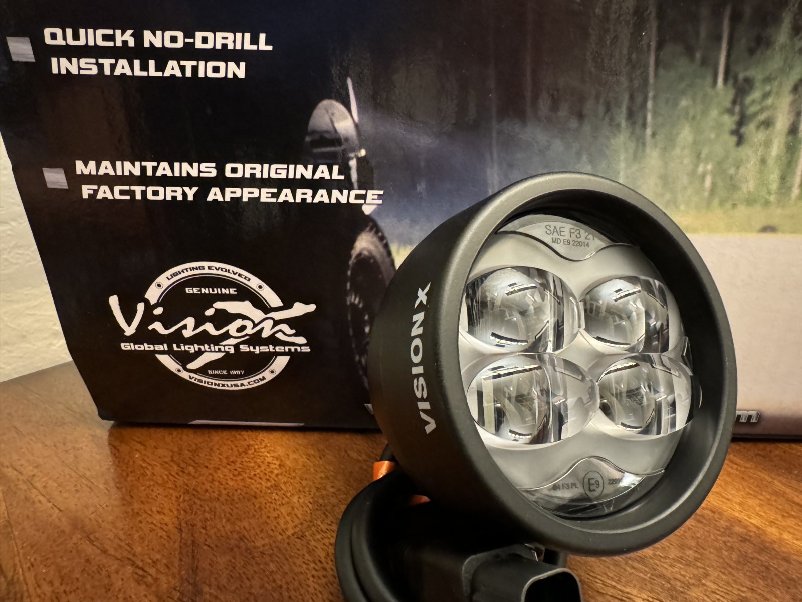

    Next up, the long anticipated Denali/Vision X SAE fogs. Claiming 40w power, more than the SS3 Max while specing an F3 compliant pattern.
