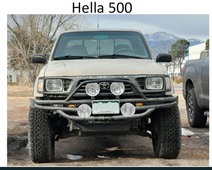

    Personally, i like the hella 500s the most. Cheap and great performance

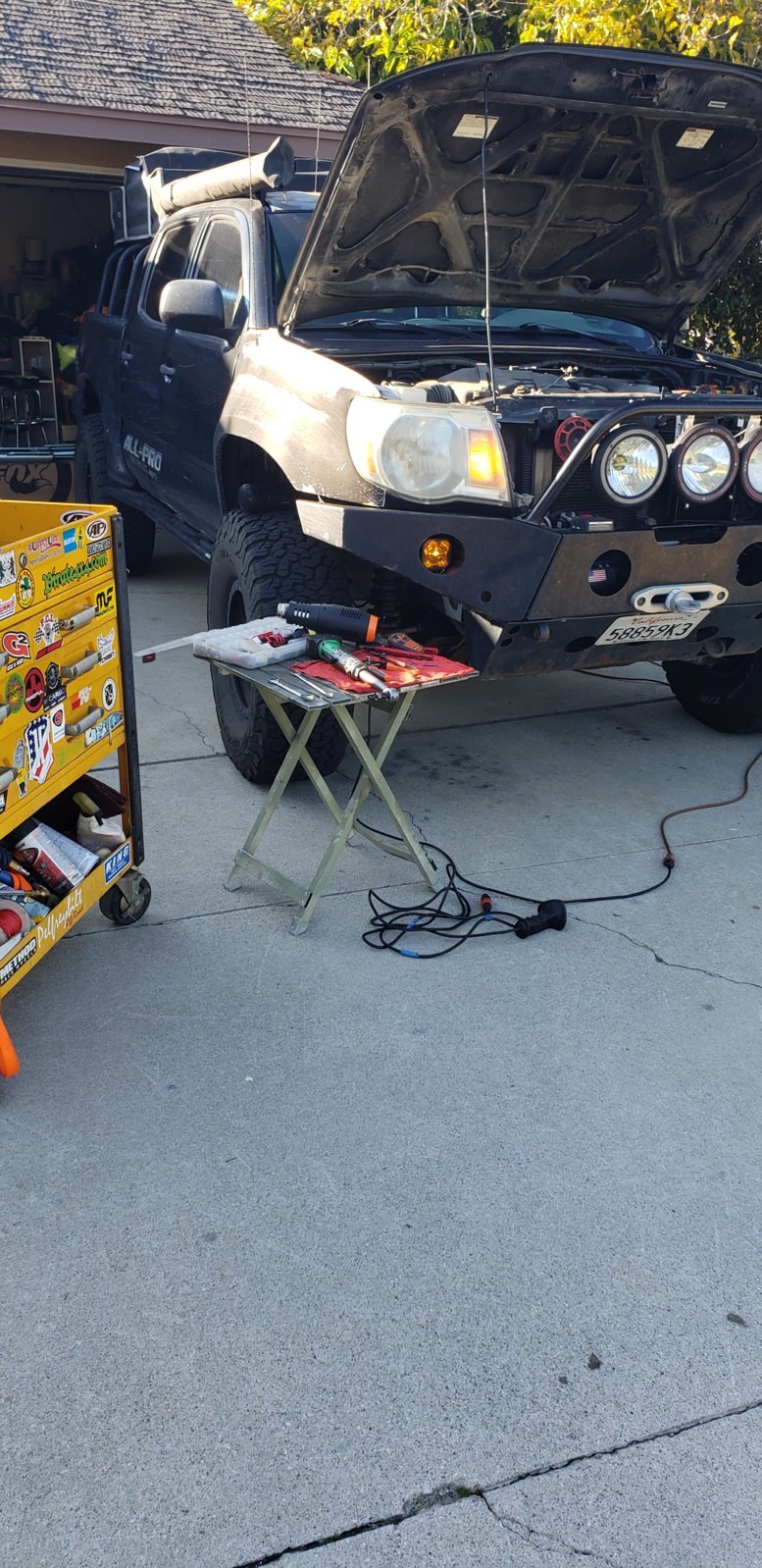

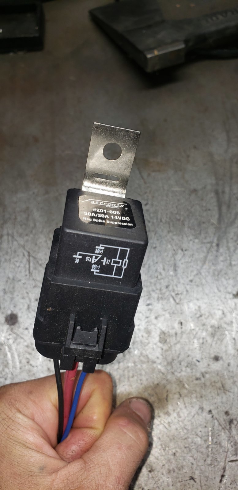

    Here's another huge shoutout to @crashnburn80 for this spectacular thread and to @Yoshi I for his nerdy breakdowns of all the technical stuff that makes Fog Light.. a Fog Light. Thanks guys!!
    After years of having a Love and Hate relationship with my PIAA 510 Yellow Fogs. It was finally time to upgrade after I had discovered that one of my PIAA 510 lenses had fallen off the housing somewhere along a very washboarded dirt road in Death Valley.
    I had in mind to purchase a set of BD SAE Yellow fogs because well.. they are a big name and have some well known products with decent customer service. After reading this thread and after watching a ton of YouTube videos, I purchased a pair of DD SS3 Pro SAE Selective Yellow instead of the BD Fogs. I chose the Pro version because the cut-off is not as sharp as the Sport or Max. I'm thinking less of a cut-off maybe a little more ideal while on a dirt road in the middle of nowhere.
    I purchased the SS3's directly from Diode Dynamic during their BlackFriday sale, I thought what a great price until I saw that @memario1214 -hotshotoffroad had a way better deal going on. Oh well, next time I'll buy from hotshotoffroad when ready for the next lighting upgrade which will be very soon.

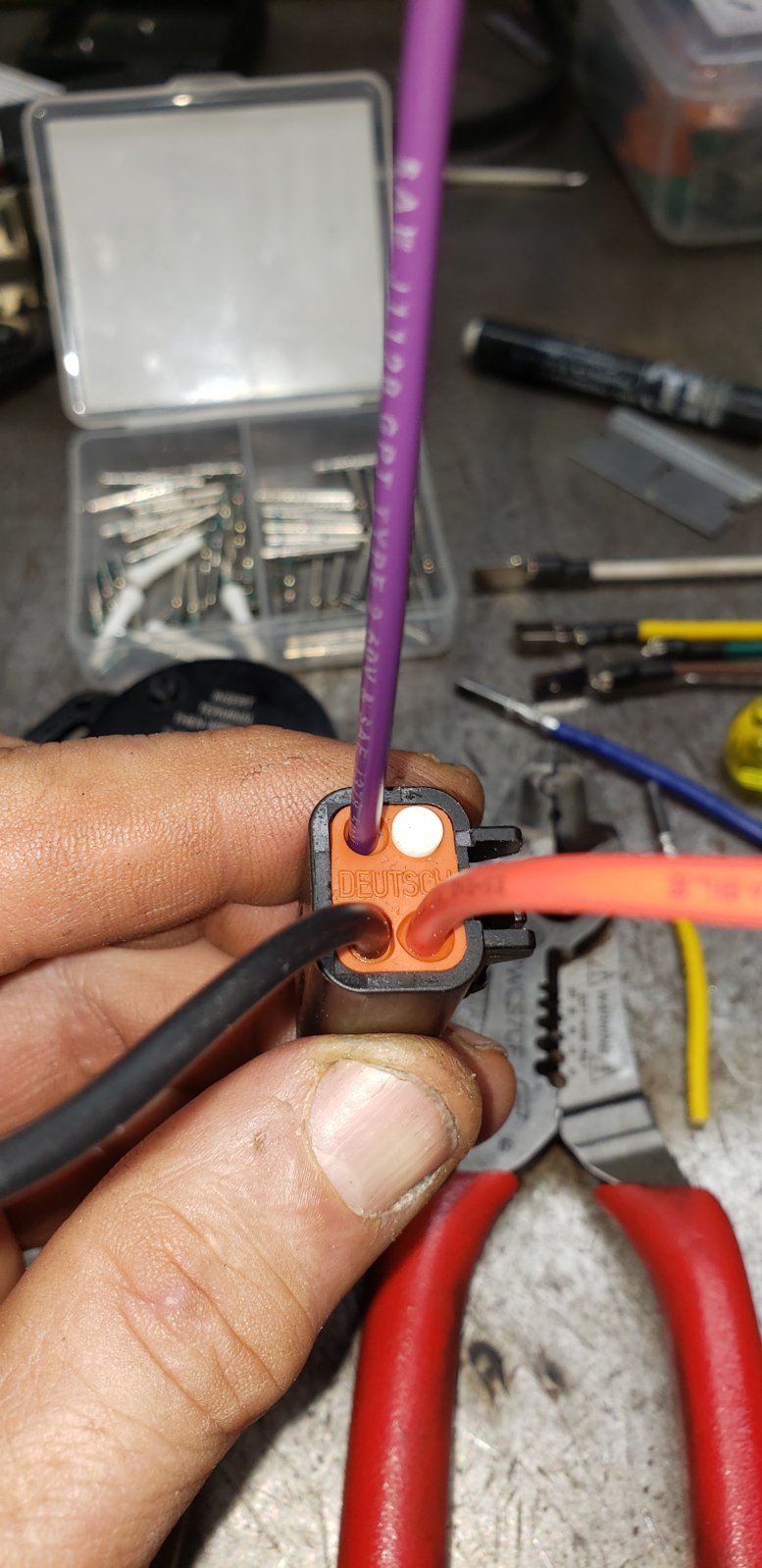

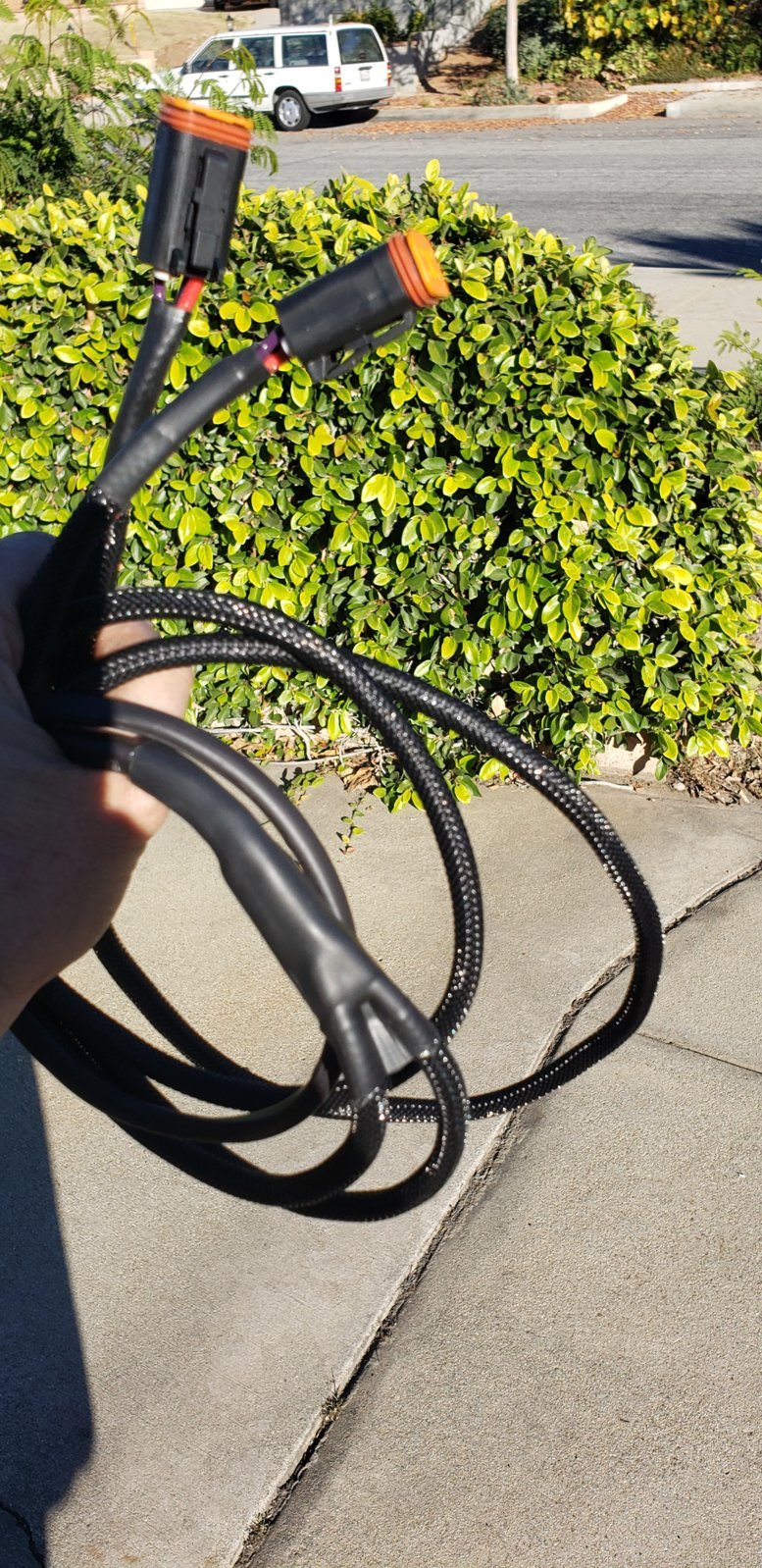

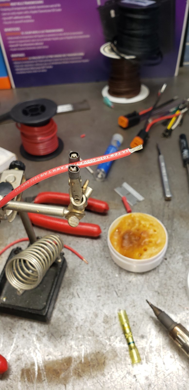

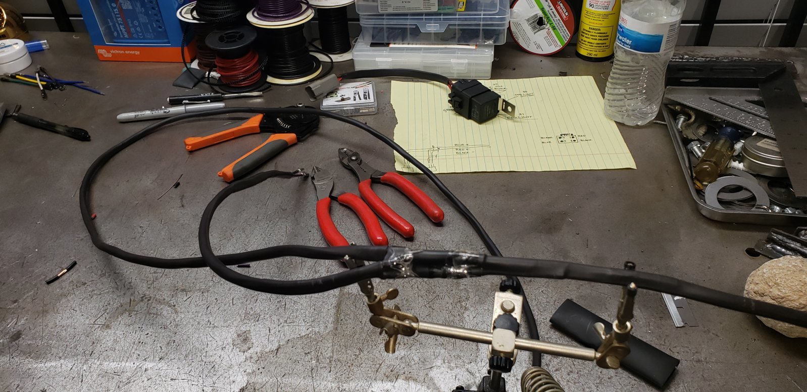

    I made my own dedicated wire harness to Power the SS3 Pods with Back Lighting using a weatherproof 5 pin relay. The relay turns on when the Ignition is ON. Since this a 5 Pin Relay, Pin 87A will have +12v on it until I tell it not to with the Fog Light Switch. Pin 87A is powering the Backlights. Pin 86 powers the Fog Lights. When the Fog Lights are ON, the Back Lights are OFF. I spliced the Factory +12v Fog Light wire to the relay at Pin 30. This allows me to use the Factory Fog Light Switch.

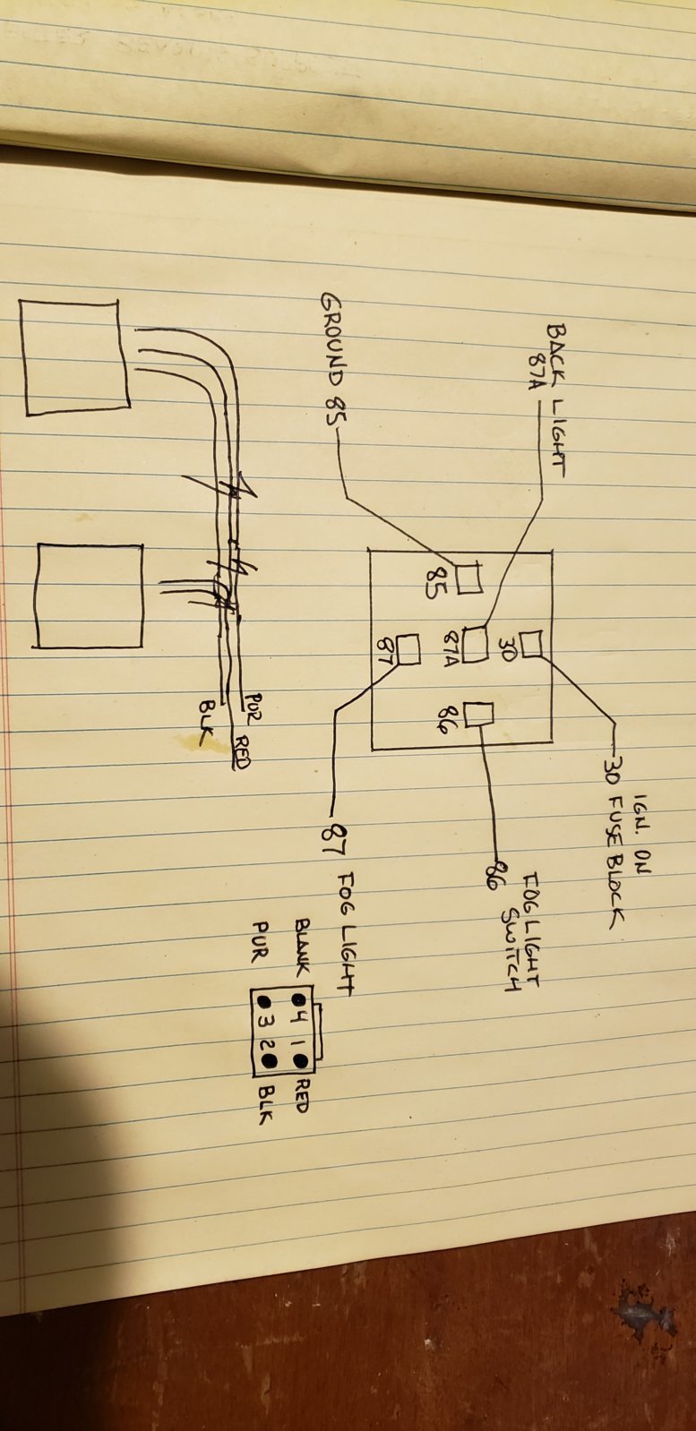

    Here's the basic relay diagram

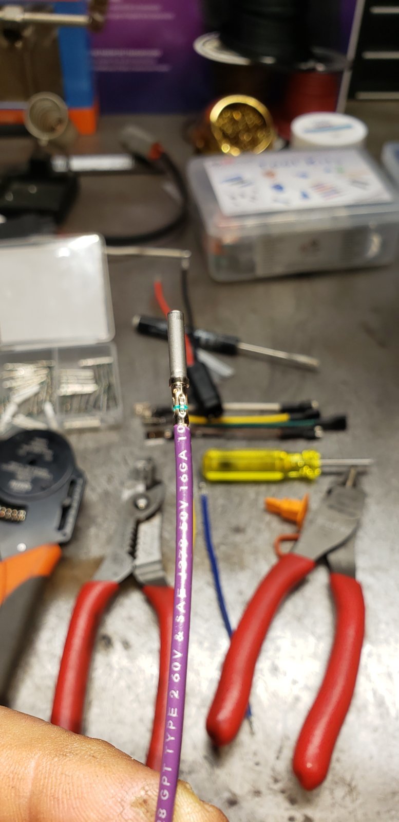

    de-pinning the extra wire not used from the connector and re-pinning the Back Lighting wire in a new color. Deutch Connectors are Rad! So glad that Diode Dynamics uses them..
    Getting tinned before crimping

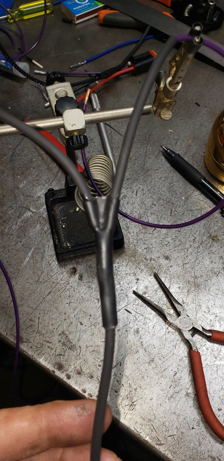

    14g into a two 16g Splice, repeat the same for the Ground and Back Light Circuits..
    Adhesive lined heatshrink..
    Tying it all together..
    And we get this..

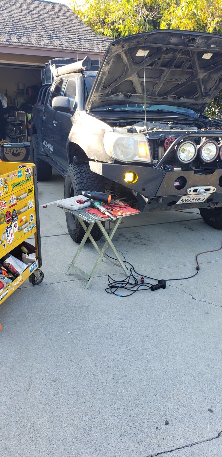

    Splicing a new longer wire into the Factory +12v Fog Light wire so it will be long enough to reach the relay. The DriverSide Headlight was removed for access.

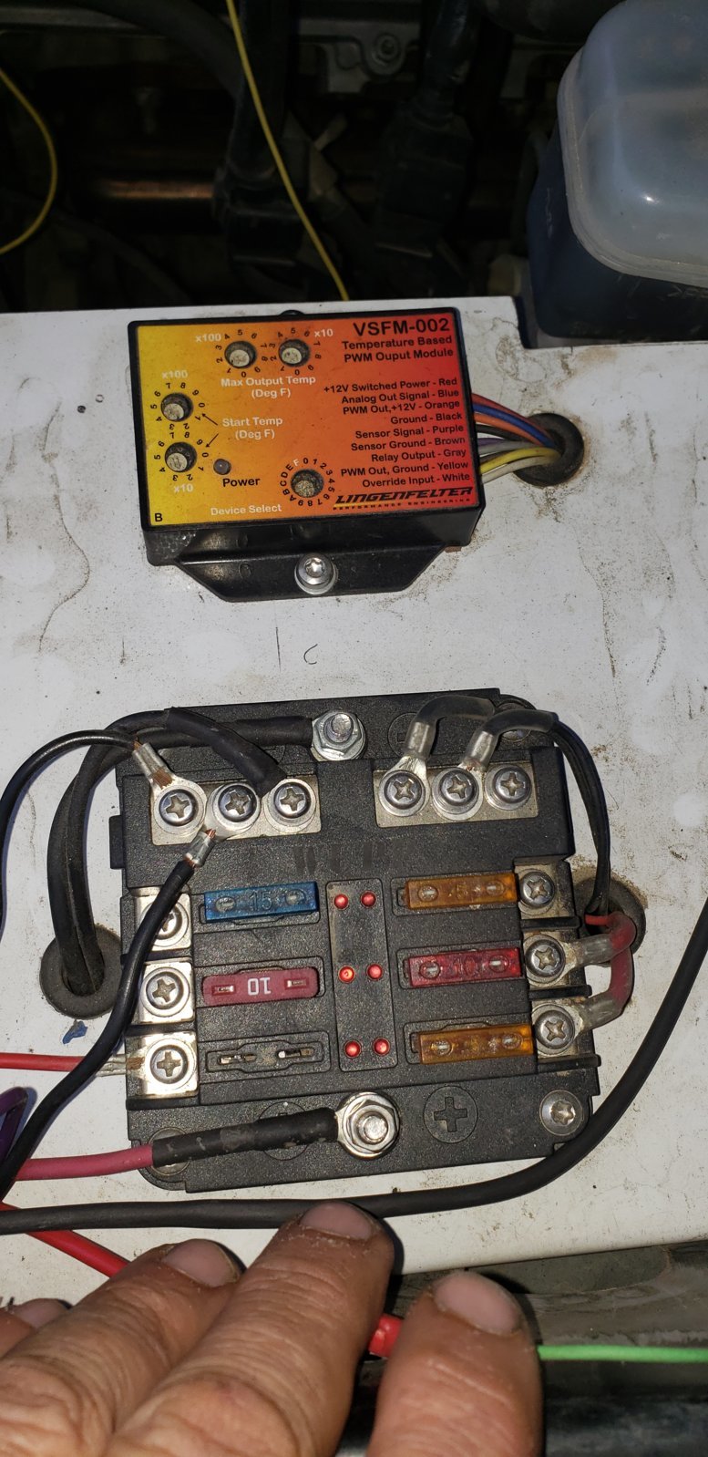

    The new Fog Light relay is under this panel I made. This fuse box turns On by a relay when the IGN is ON. Sadly, I forgot to take pictures of the relay when it was all done.

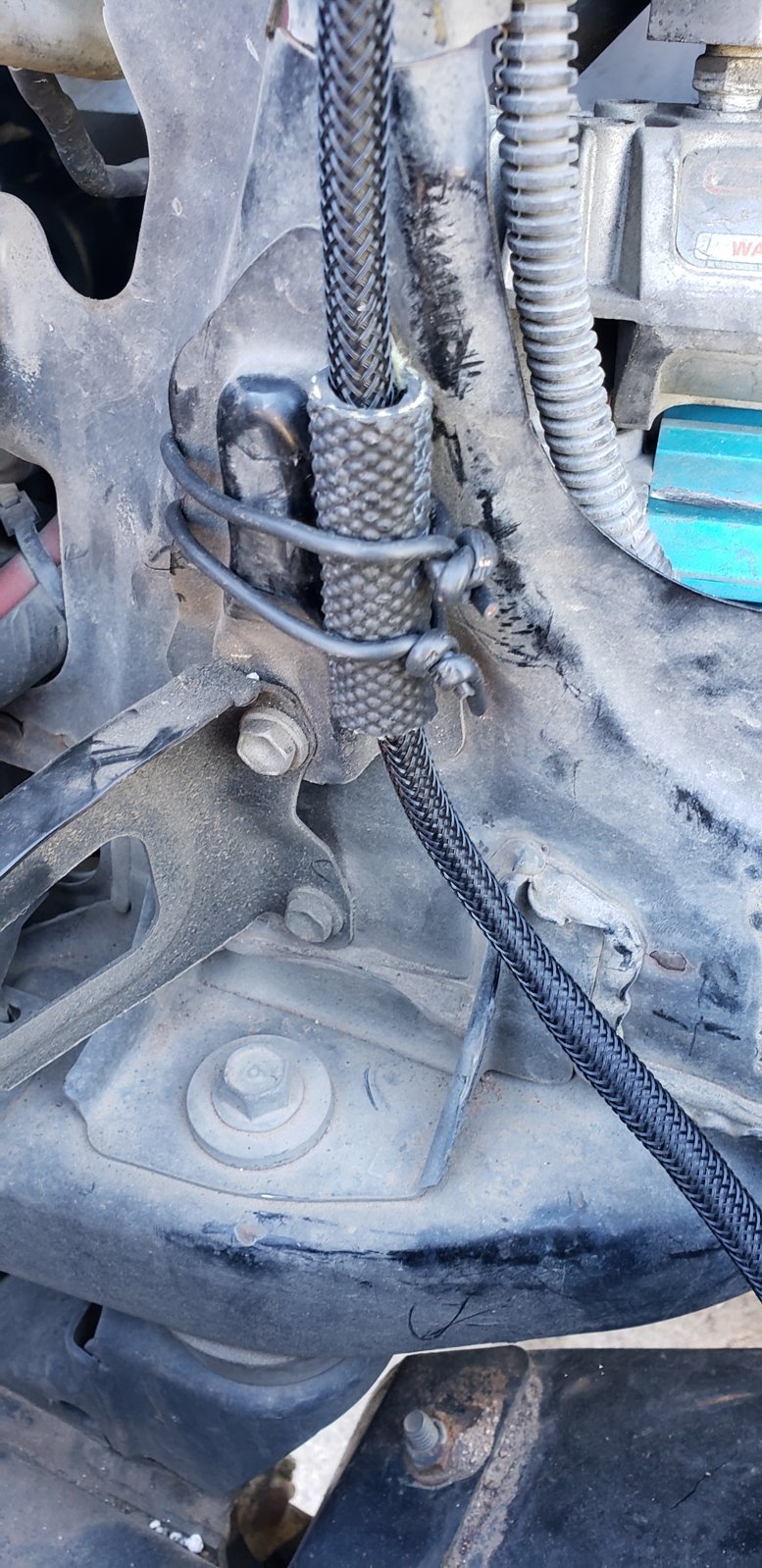

    I try and go the extra mile always trying to prevent chafing where needed. Unfortunately I ran out of zipties so I used some wire. This is all temporary anyways, ill be installing a pair of JDFab Inner Fenders very soon.

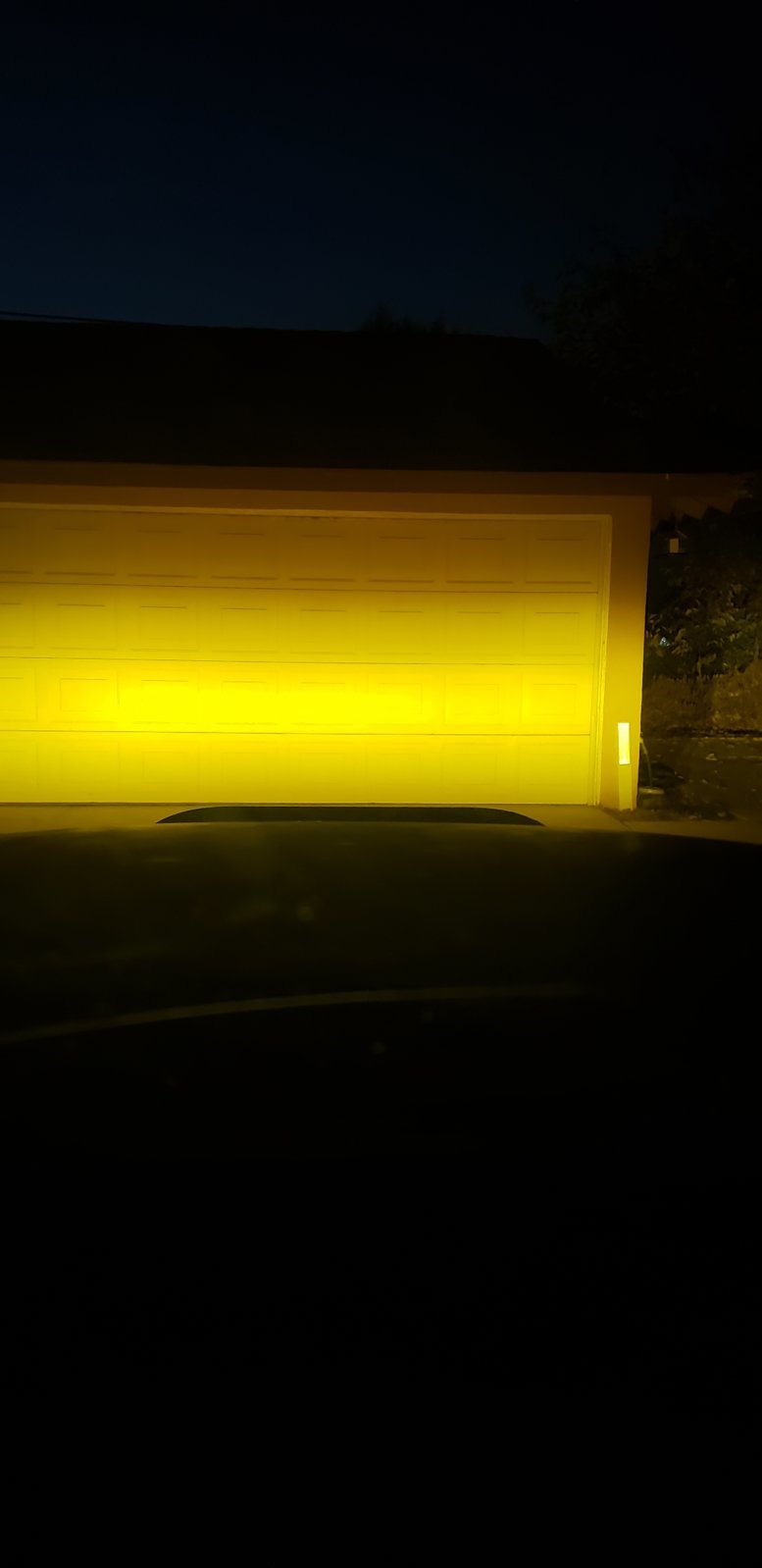

    Everything's wired up correctly. Here's the SS3 SAE Fog Light with the Backlight On and how it looks in the middle of the afternoon..
    And with the Fog Light ON in the middle of the afternoon..
    Not really aimed properly yet at a distance of 25' or so. And wow,,night and day difference compared to my old PIAA 510'3!! Totally happy with my decision going with Diode Dynamics!!
    My next lighting upgrade on the list is to finally retire my 7" Kragen Red Ring HID's that I'm still rocking after all these years. I have it down to two choices, either (4) Diode Dynamics SS5's or (3) Baja Design's LP6's. What does TW recommend going with?

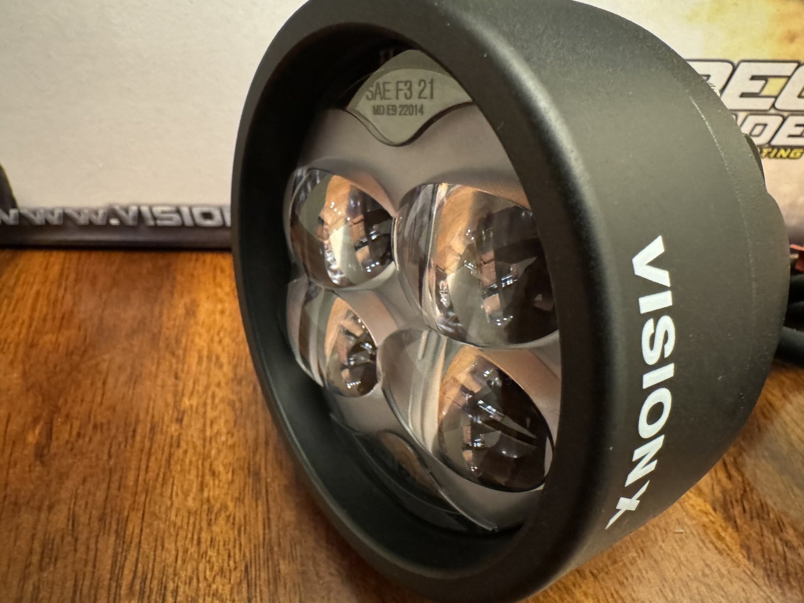

    Denali originally launched the CR-4 SAE fogs and used Vision X as their 3rd party manufacture to produce the lamps. Vision X later acquired Denali and now offers the CR-4 lamps under both brand names.
    The CR-4s are available in white, selective yellow and amber. Rare to see a manufacture offer 3 different fog color options and uncommon for true amber fog to be offered. Industry trend has been to move away from amber toward selective yellow for fog lights which is higher performing. Amber CR-4s are only available under the Denali label, Vision X offers only white and yellow. This review will cover the white lamps only.
    Vision X specs the lamps at 40w (3.3A) power draw, which is higher than the SS3 Max. The lamps also spec the modern F3 compliant pattern. These are available in a Tacoma fog pocket it (also fits 4runner/Tundra) or standalone pods. Vision X offers a lifetime warranty on the CR-4 lamps.

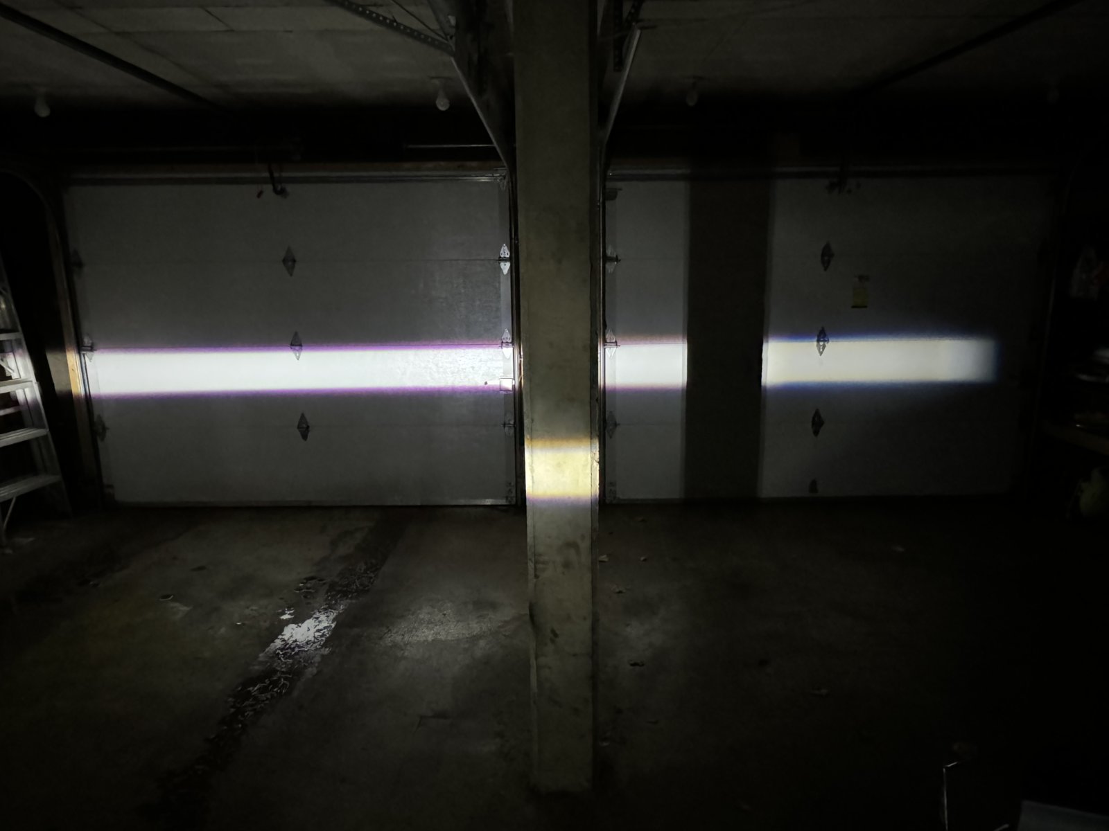

    The lamps use a protruding aspheric projector optic. Somewhat challenging to see in the photo, but the lamp face is not flush like Baja or Rigid that uses similar optics behind an outer cover lens, the lens on these lamps is very 3-dimensional.
    Powered on.

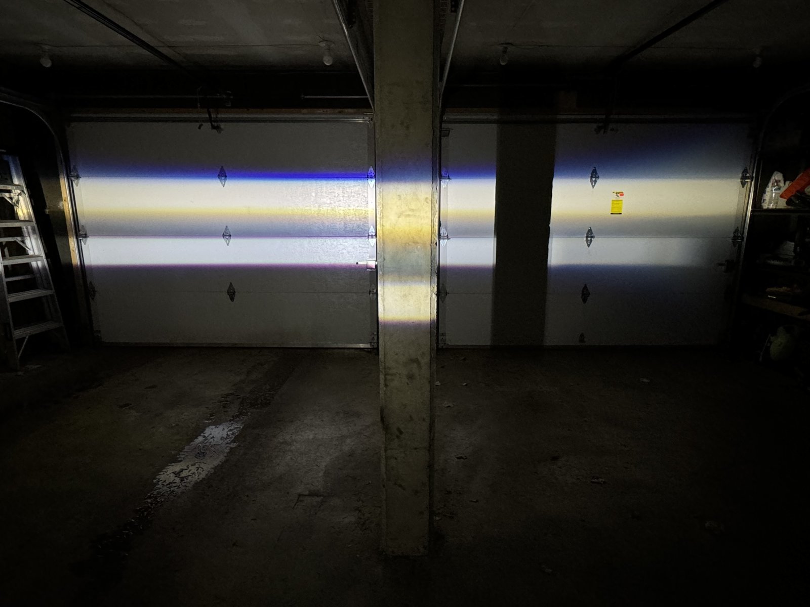

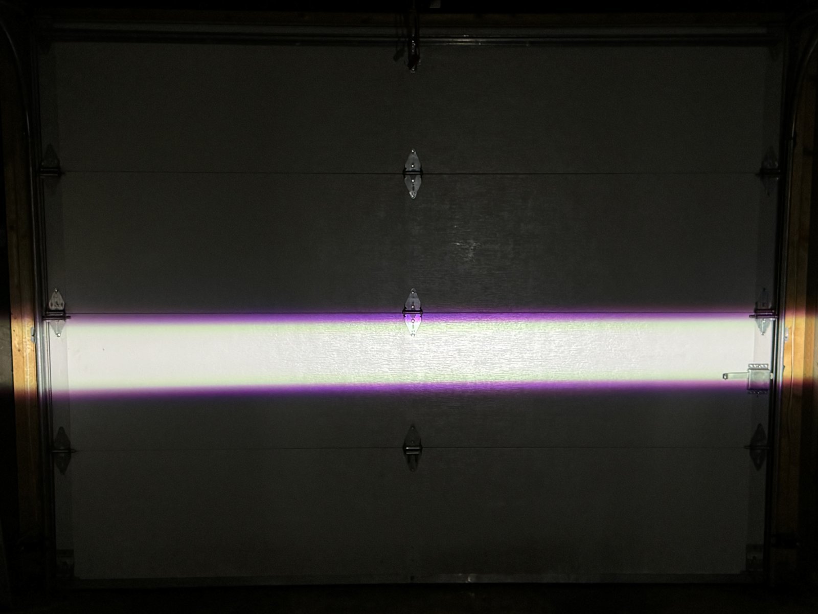

    The beam pattern is extremely tight and uniform with sharp cut offs and colorful purple bands on the top and bottom of the pattern.
    The pattern is nice and wide, intensity does fade some to the far sides of the pattern.

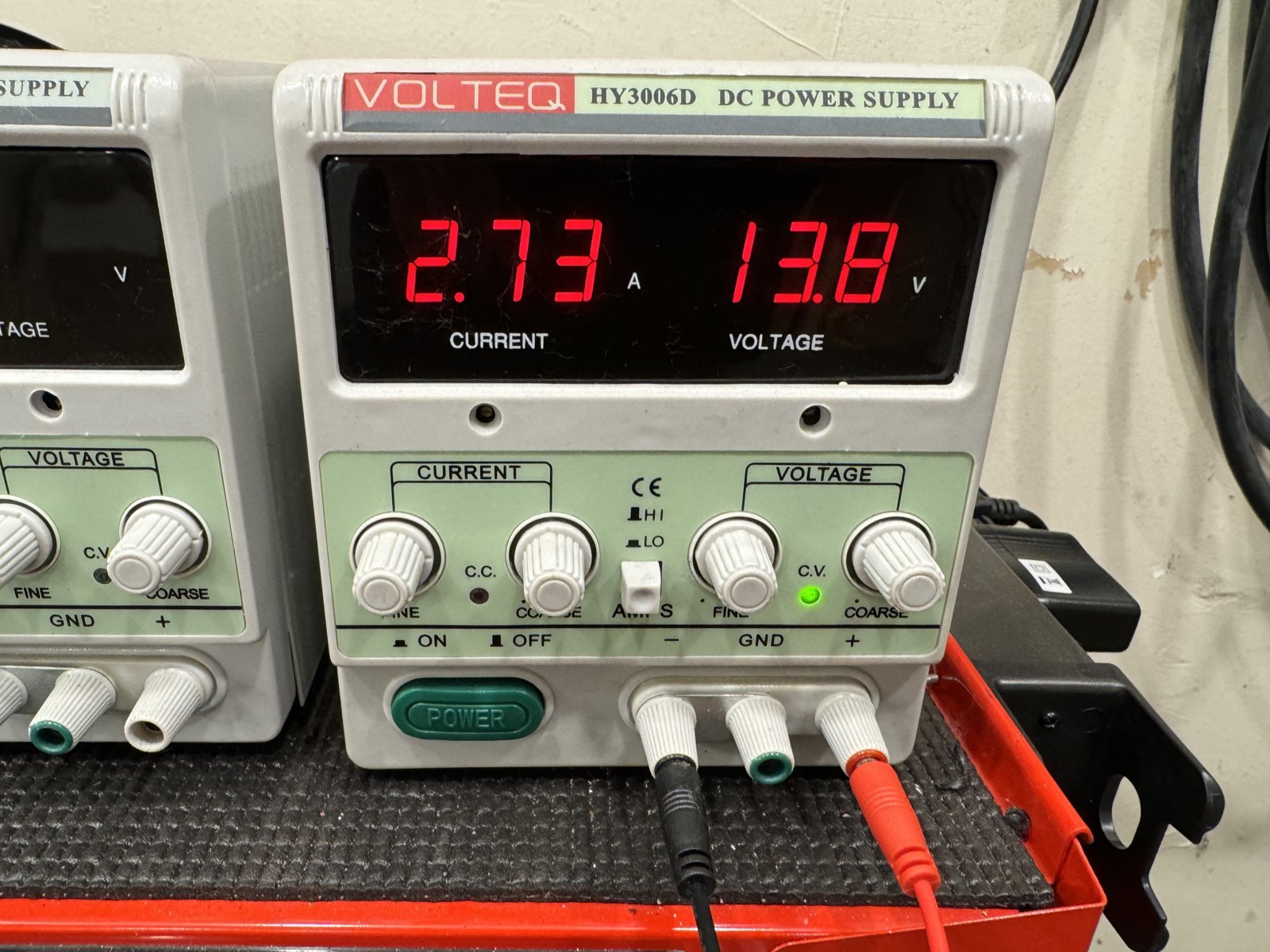

    Cold start in 63 degrees F ambient. Measured 37.7w / 2.73A vs 40w / 3.3A spec.
    17.3% below power spec at cold start.

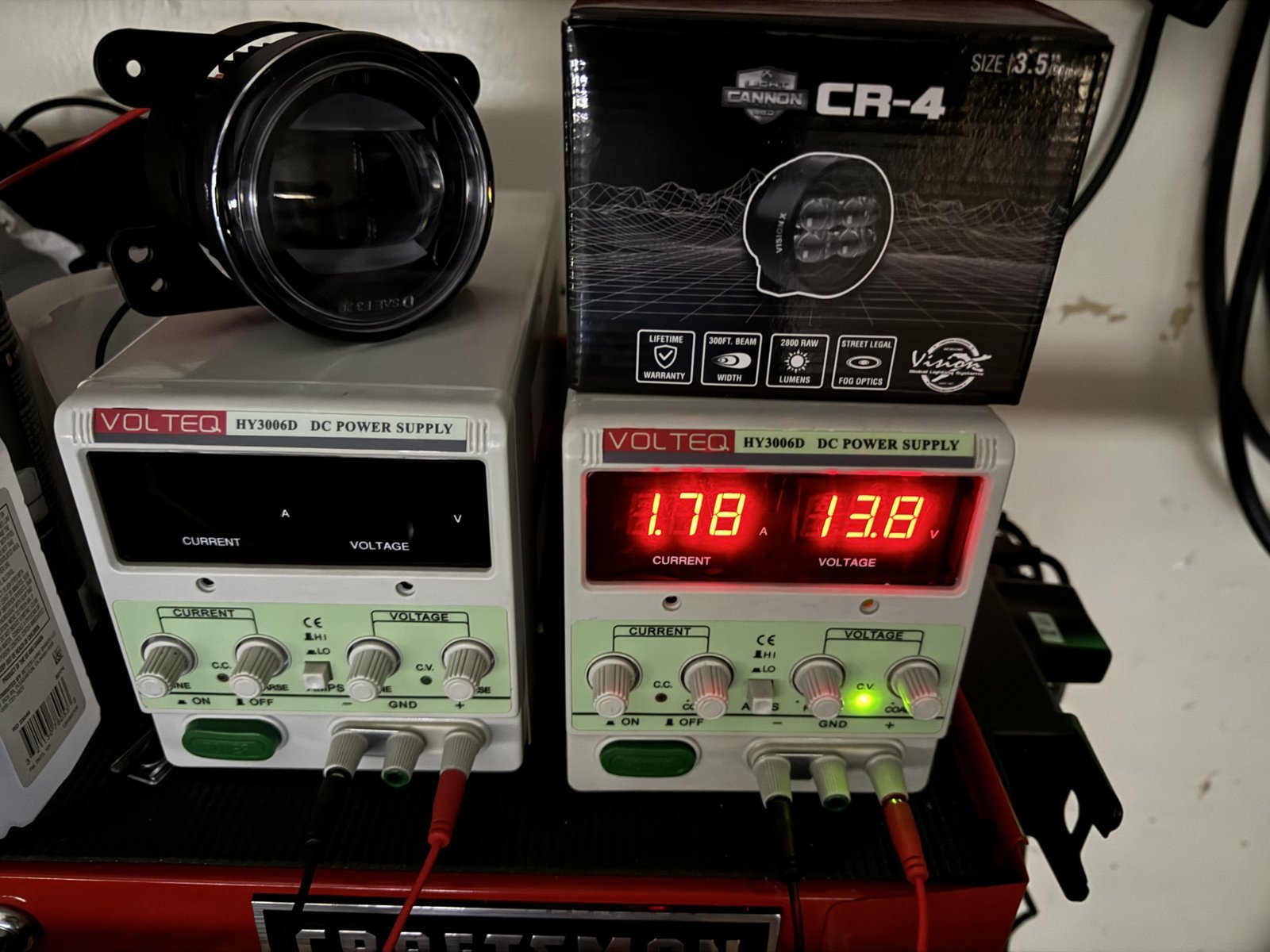

    After 20 minutes of runtime the CR-4s pull 24.6w / 1.78A. vs spec 40w / 3.3A.

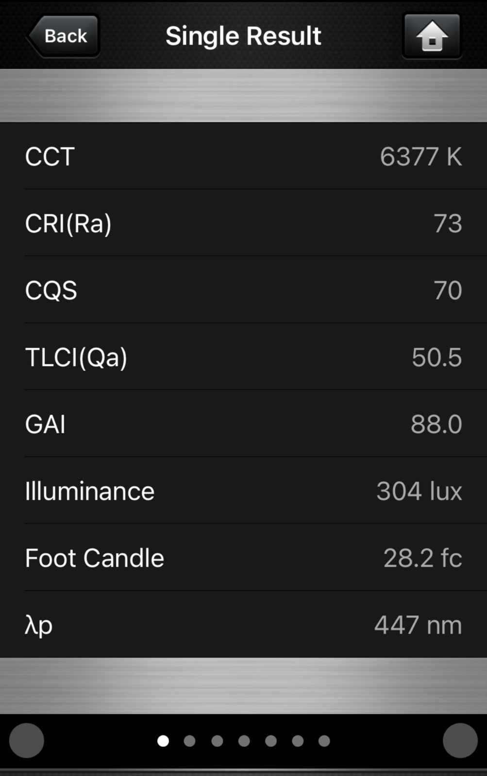

    CR-4 white measured output

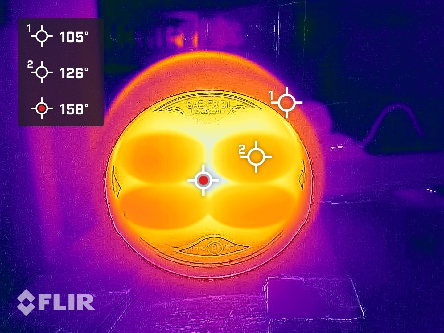

    The outer body bezel of the CR-4s is plastic, unlike most pods that use aluminum. Plastic can seem ideal for its corrosion resistance compared to a coated aluminum housing which can pit of flake with poor coatings, however plastic is an insulator. To drive LEDs to their maximum performance LEDs need to shed heat and aluminum as a conductor that does that well, which is why most LED pods use aluminum bodies. Vision X does not.
    Thermal FLIR image at 63 degrees F ambient.
    The hottest parts of the lens are the opaque areas that don't allow light to pass though, areas of light emission are significantly cooler. The bezel being a plastic insulator is much cooler than the aluminum bodies we've seen from competing products. While the areas around the optics run reasonably hot due to blocking all light energy, the protruding optic and bezel do not run hot enough to be recommended for snow use. The yellow CR-4 would likely do better.

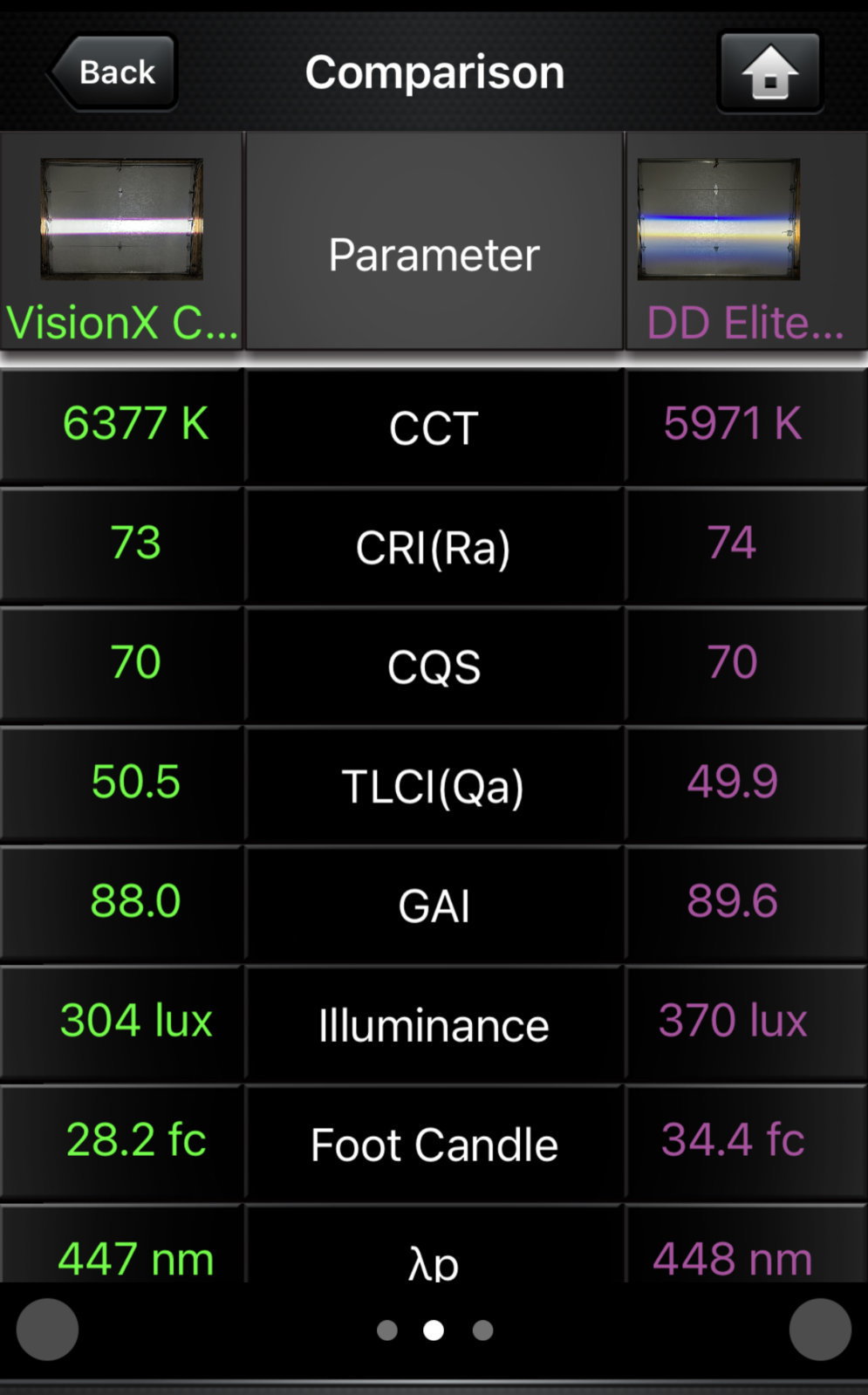

    Looking at other F3 fogs with sharp cut offs like Vision X, the competitor I'd compare them to fog OEM fog pocket mounting would be the Diode Dynamics Elites.
    DD Elites top vs Vision X CR-4 bottom
    The Diode Dynamics Elites have a slightly taller and wider pattern than the CR-4s. Diode Dynamics also replicates OEM Toyota with blue banding at the top but instead using warm color banding at the bottom of the pattern, unlike Vision X that uses purple banding on both sides of the pattern.
    Vision X CR-4 vs DD Elite
    The Elites come in at 21.7% higher output intensity that the CR-4s with a taller and wider pattern and arguably better color temp.

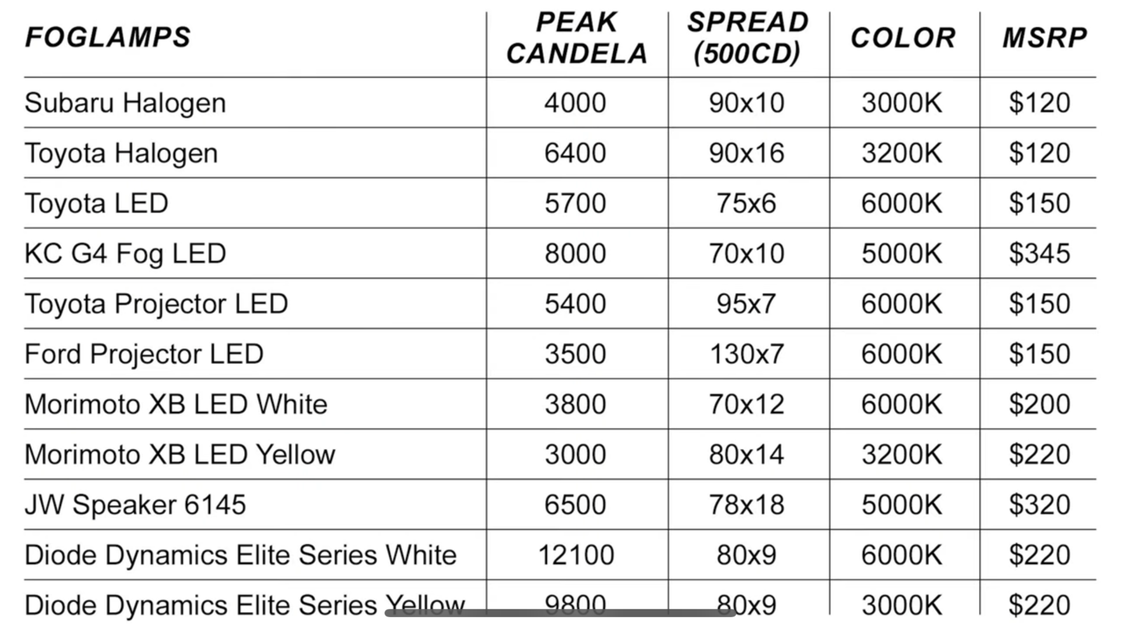

    Post #724. Admittedly not a great comparison post on my part.
    You can also see Diode Dynamics test numbers screen captured from their YouTube video below. The Toyota projector LED fogs are the non-pro LED fogs from the LED package.

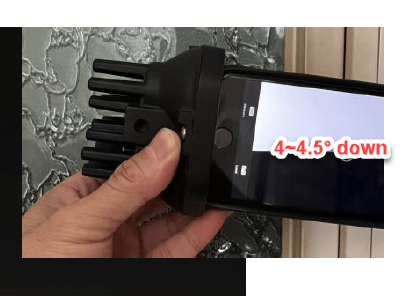

    Max is much better than Pro as fog, elite just is "proper" fog for actual fog usage. Pro, I wouldn't even call that as fog Far away from SAE, gradient is too weak, can't be aimed. Many aim too high up using as if high beam, fog aren't low beam helper. Fog beam never should illuminate any more than direct in front of driver view. I see widely misused photo example all over.
    You made right choice go Max over Pro for sure. Elite is most appropriate as fog, but downside is it can't combat snow accumulation.
    As long as you aim lamp correctly, it won't cause glare.
    By aiming correctly, you may find it shockingly low aimed, different from many SS3 max fog photo you may see online, but they are the one doing wrong and you are trying to do right.
    Try angle finder, 4~4.5° downward aim to find approximate aim down reference. then match right and left. Hope you enjoy your new lamp!!!!
