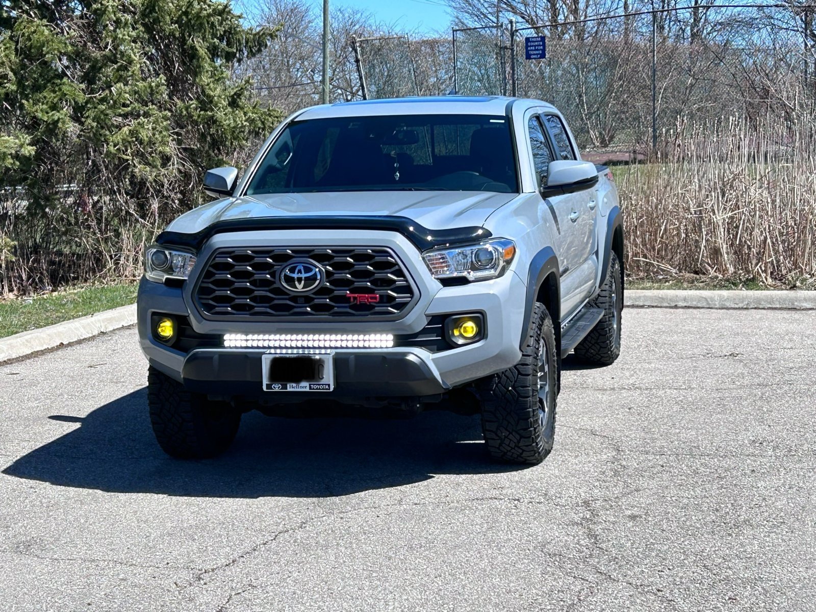

    [​IMG]you dont have a master with this data for all the lights you have tested do you? Ultimate showdown chart?

    When I bought my truck new I upgraded to the OEM LED fog/ditch lights in white and was never impressed. I just upgraded to the DD Elites in Amber. I was a bit sceptical as to how much of an improvement they would be, what a difference in light output and beam spread, its fantastic. Their SAE compliant, a snap to install, plug and play and I followed the alignment videos post install. Could not be happier.

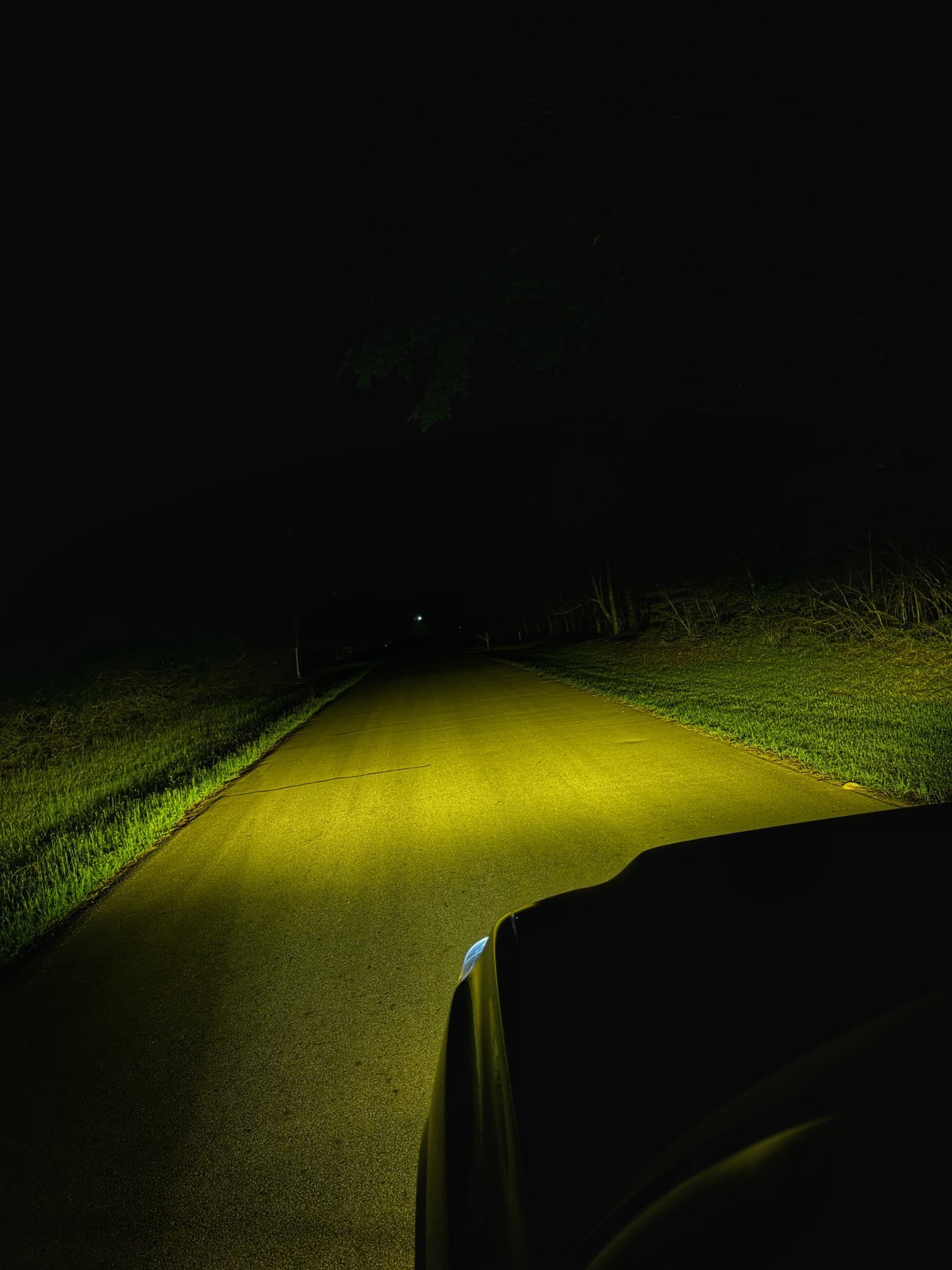

    my SS3 pro are great for seeing the deer just off the shoulder. the ones that may spook and jump directly in front of you. Had one start to come out yesterday and the superior lateral throw from the fogs lit it up before I could get close enough for danger.
    My dirt roads are 10-25mph depending on the particular section so they are 100% useful. they light up the road in front for ruts/debris, but the ditch/shoulder are where they shine (pun intended)
