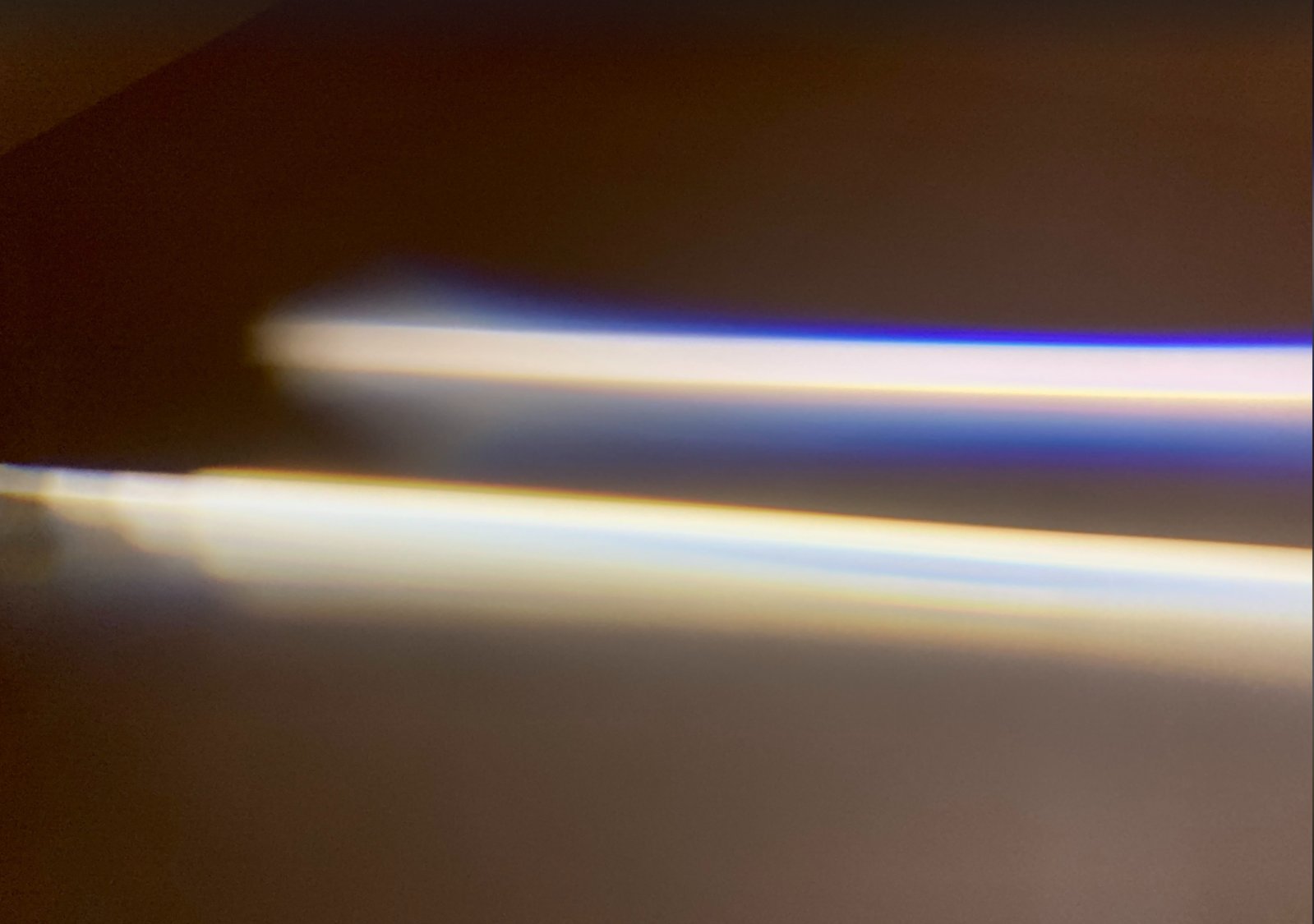

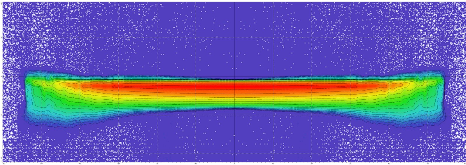

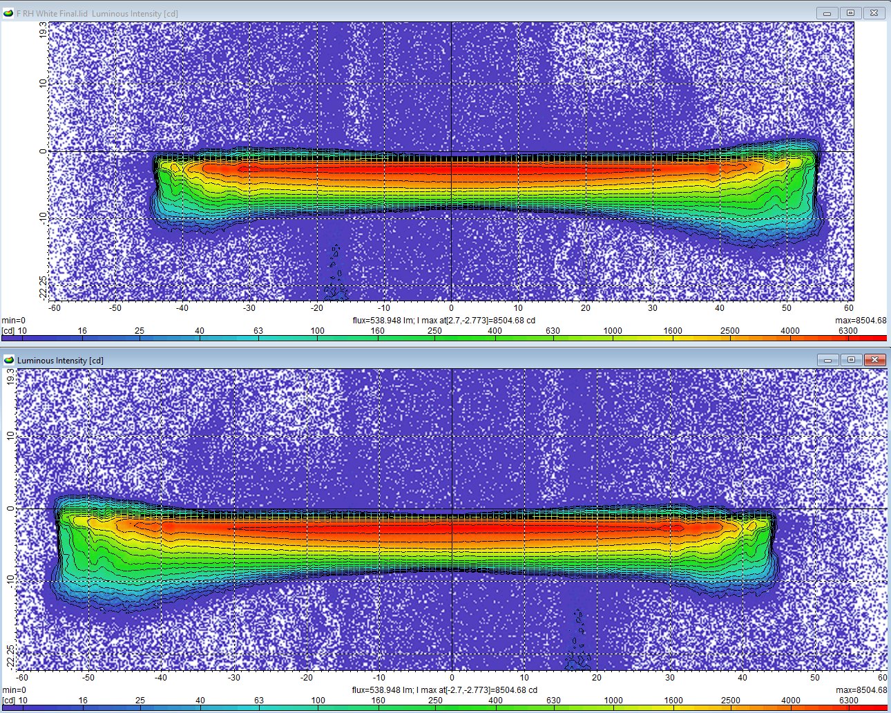

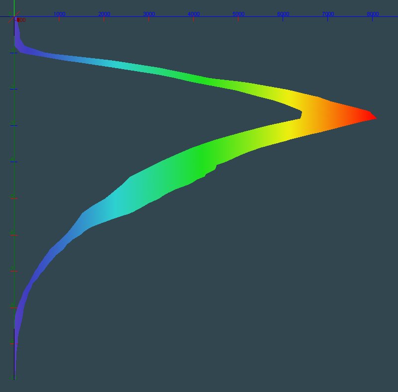

    Beam pattern remain identical between White and yellow switch.
    Check video at following link
    https://i.imgur.com/25SRvrD.mp4
    Optics is designed to use line focus, and both white and yellow is layout on same line axis
    Beam is generally about 100°~106° horizontal stretch(pairwise), Vertical 7° at beam center upto 10° at beam outer zone.
    Zone D intensity is about 8500Cd for white, 6800Cd for Yellow
    Vertical intensity mapping is clean exponent curve to zone D peak ( 1D aim for F3 lamp) upload_2024-8-2_8-41-37.png
    Pairwise combined beam
    White emitter is Oslon
    Compact PL, KW CWLPM3.TK Color BIN 6M0~7L0 = 5500K~5700K white
    Yellow emitter is Nichia
    NCSY131 native selective yellow
    Color impression is warmer, blue spectrum is blended out. Top is Elite 11,500Cd (Zone D) bottom XB Evo Fog 8,500Cd (Zone D)
    ** Elite fog F2 is as wide as 100° beam Below pictured is their 80° model I didn't have F2 sample with me.
    No, No back light. This is just a fog, SAE J583 F3 and ECE R19 F3 and similar power to Elite fog, can't melt snow.
    Highlight is distribution refinement. I particularly allocate lower angle stretch at outer angle zone, as this outer lower zone provide driver view width comfort. Ground coverage smoothness is good!
    LMK any additional questions

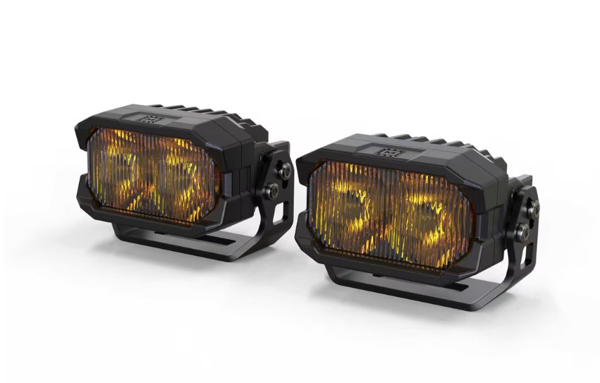

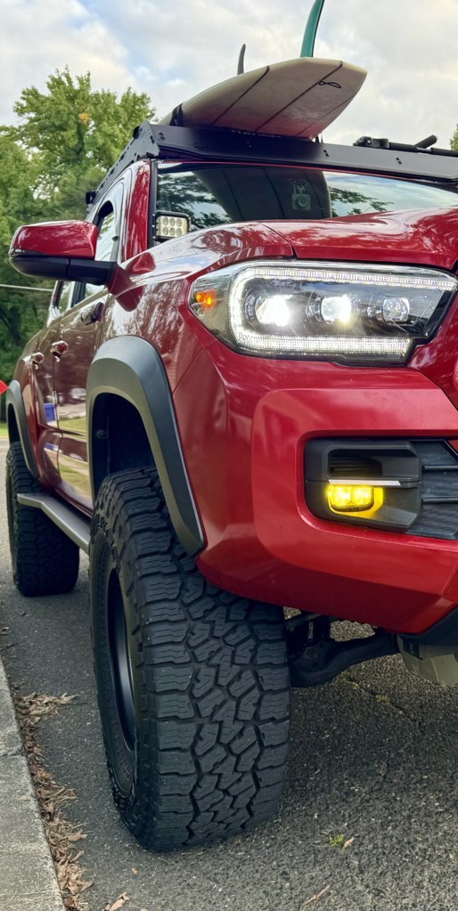

    Recently upgraded my fogs. Posted in another thread but adding the write up here as well. Love the styling of the OEM rigid fogs but wanted more performance without switching to the typical (baja style) fogs everyone runs.
    Huge shout out to @crashnburn80 for the help, guidance, and product recommendations. Ended up going with the Morimoto 2Bangers in amber with the SAE wide pattern. Purchased a simple deutsch to h11 adapter and that made them plug and play with the existing factory fog light wiring & stalk switch.
    https://www.morimotohid.com/2Banger-LED-Pods-HXB-Wide-Beam?quantity=1

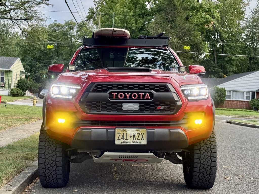

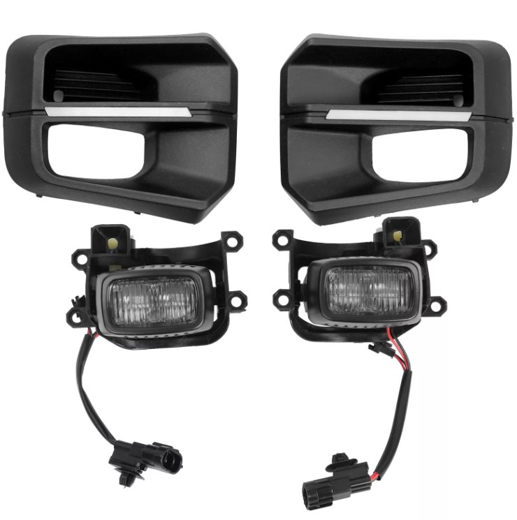

    Grabbed a knock off set of the Rigid fogs on ebay so I could get a badgeless bezel and bracket to mount new fogs to. These have an additional LED accent strip where the rigid badging typical is, but I didn't bother wiring them up and just zip tied those leads off to the side.
    https://www.ebay.com/itm/363549173405
    Thankfully the Morimoto pods had mounting holes that lined up perfectly with the replica brackets and made it very easy to mount & properly aim them.
    Stoked with how they turned out! Soon enough, I'll be cleaning up the OEM Rigid fogs w/ amber clip on lenses & bezels to post for sale. Great lights, just wanted a bit more output.

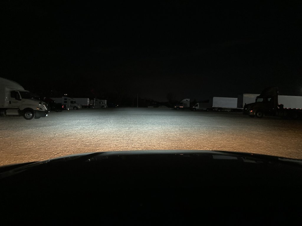

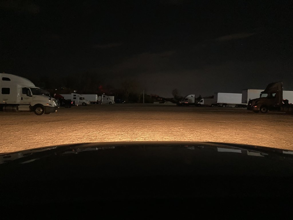

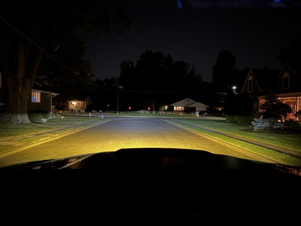

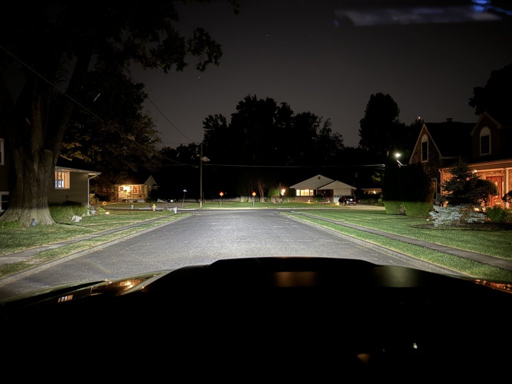

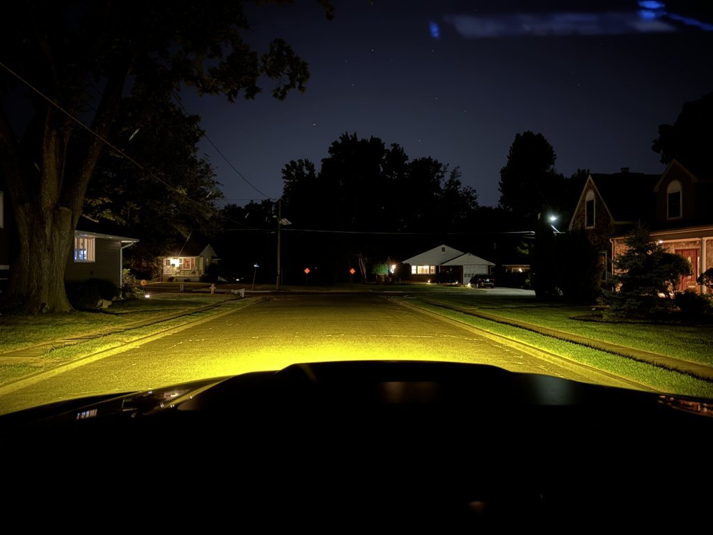

    Output shots below:
    1st shot: low beams w/ fogs
    2nd shot: 2banger HXB wide amber fogs only
    3rd shot: low beams only

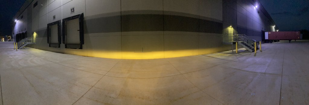

    For two years in a row now I've had problems with snow packing into the recess around the fog lights, adhering to the lenses and rendering them useless.
    The DD Max setup is the only LED option that gets hot enough to melt snow. Seems like a super product but, unfortunately, they're too expensive for something I have no need to use on a regular basis. That said, I went retro on the advice of crashnburn80 and found some H11 halogen fogs from the 2016-19 TRD trucks (part #s: 812200802000 812100802000). Vosla selective yellow H11's are the lamp. Total cost of this setup was about $120.
    Winter is coming. I'll report back with results.
    Below is post-aiming. Truck is 25' from the wall. Wall block width = 12'. Wall block height = 6.5'.
