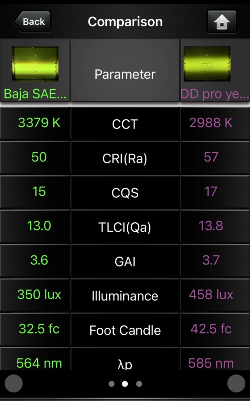

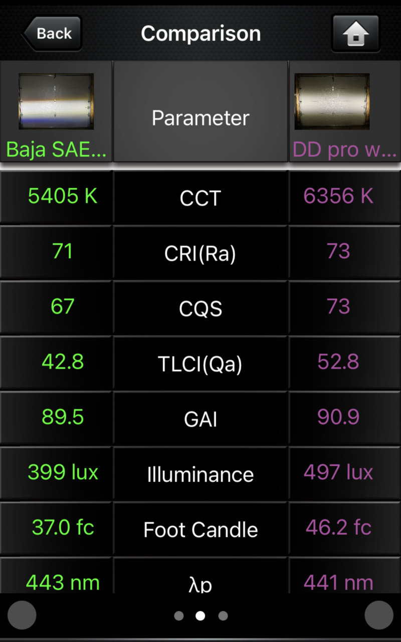

    Bit late to this discussion but as someone that went from Ss3 pros to the new bd sae it's been really interesting to actually look at the numbers after running the 2. As upto now everything was based on perception.
    I will say the pros softer cut off made is a far better supplemental driving light than an actual fog light. Where as the new bd sae is a far better true fog light than a supplemental driving light. That wider spread of the ss3 helps alot with seeing well off into the ditch where as the bd really puts that light within a narrower but still very optimized zone for use in poor conditions. I found substantially less glare off the bd compared to the ss3 pro in fog/snow making it far superior in my eyes.
    Having said all of that id be curious to see the sport and max in use as that much tighter cut off would remedy what I experienced. I'm not saying the pro is a bad fog light but id say there's much better to be had. Also the fact that diode can't colour match their light bar to the fog lights was enough for me to switch.

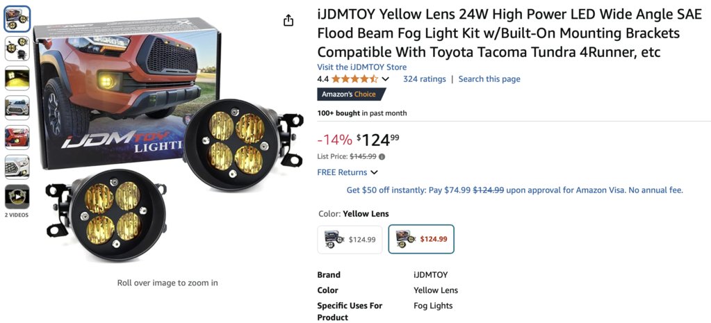

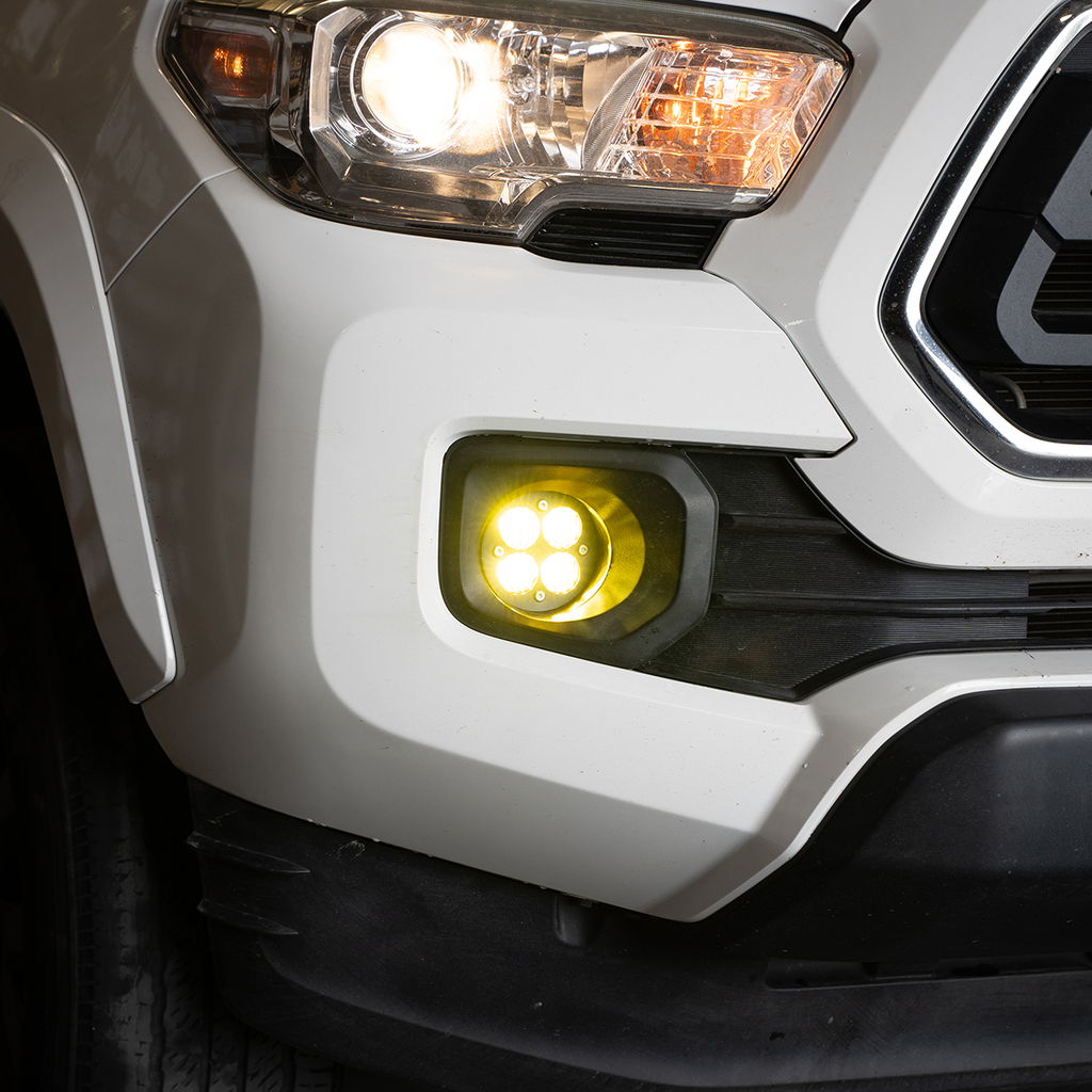

    Just in case Cali deletes their thread promoting non-SAE fog counterfeit products.

    I looked at the posts yesterday (they also put up a light bar), realized they had no SAE designation, and thought to myself, “nah, I’d just get the basic SS3 before I’d buy that for about the same money.”
