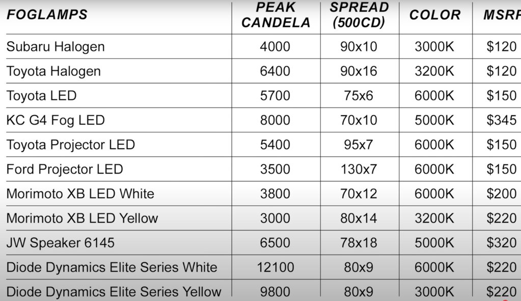

    You can see the table from DD. The Toyota halogen fogs are easily upgradable via bulb upgrades (they take H11 not H9). DD's Elite in selective yellow has good intensity output increase over both the OEM LED and halogens, though slightly narrower pattern than the halogens. Toyota's OEM halogen wide angle fogs on the 12-15 Tacomas and the 16-18 TRD Tacomas have exceptional pattern width.

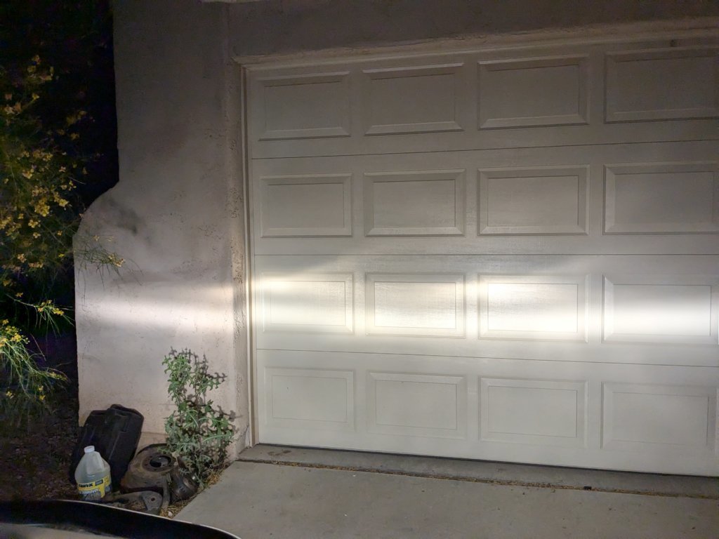

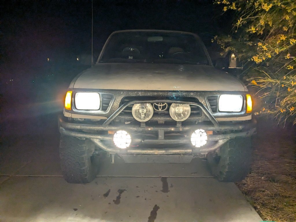

    Despite being discontinued, I managed to hunt down a pair of the KC 6" Apollo Pro fogs for the Tacoma. With 100W bulbs, I'm extremely happy.
    I adjusted the angle for a wider pattern
    Gotta include this shot.
    Pretty wide pattern
    Fogs alone
    Low beams alone (Hella E code with performance bulbs with a good number of hours on them)
    Both
    I've got kapton tape on order per the recommendation on Daniel Stern's website. To my knowledge nobody on here has tried it.
