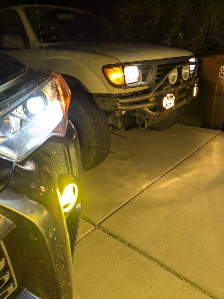

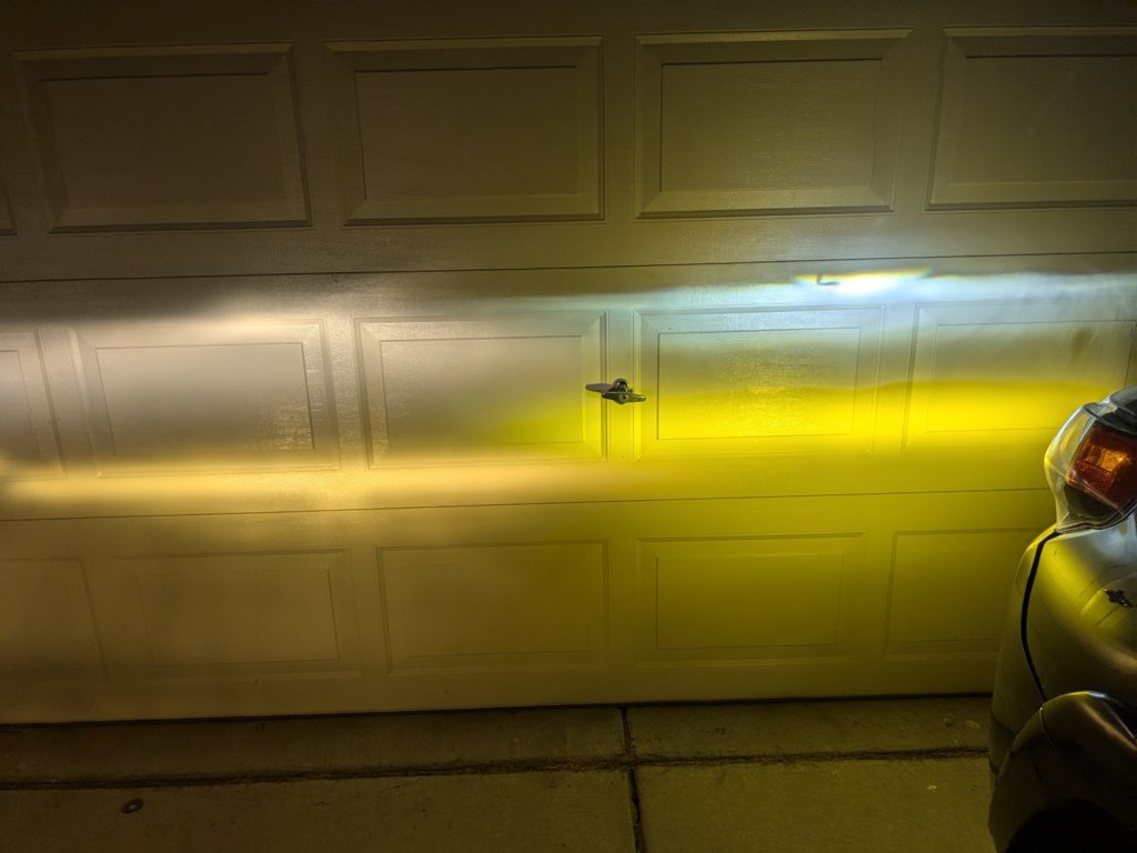

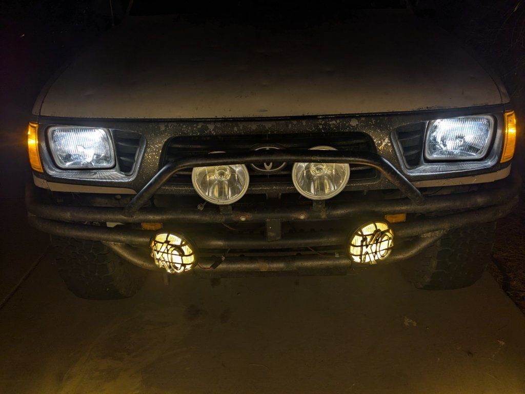

    Kapton tape finally showed up.
    I applied a single layer to each light, keeping it as smooth as I could. Unfortunately the kapton doesn't have very much stretch, and the lenses are slightly convex. I considered Lamin-X instead, but I couldn't find a max temp rating, and I'm running 100W Osrams in these, so I figured I'd play it safe.
    Powered off, lit by a 6000k Harbor Freight work lamp.
    Powered on. The headlight bulbs are uncoated, high performance, standard wattage halogens. The color temp in this picture is shifted higher than it is in real life.
    Truck's lighting is the same as the previous picture, the 4Runner has stock 5000k headlights, 3000k DD SS3 fogs. This picture is pretty close to the actual color temp.
    Same setup, camera pointed the other way. The color temp here is also shifted up slightly.
    I haven't driven with them since applying the kapton tape. The color temp shift with the kapton appears to make the output similar to the Hella Comets tested earlier in this thread.
    Overall I'm very happy with them, and I'd be very interested in how they compare to the Hella 500 fogs.

    I think you'll really like them with the kapton tape. I had a set of halogen cibie super oscars (for a short time, smashed them in a wreck) with kapton sheeting over the lenses on my first vehicle years and years ago.
    The nice thing is that it's cheap to replace when/if it starts to get nicked up from road debris.
