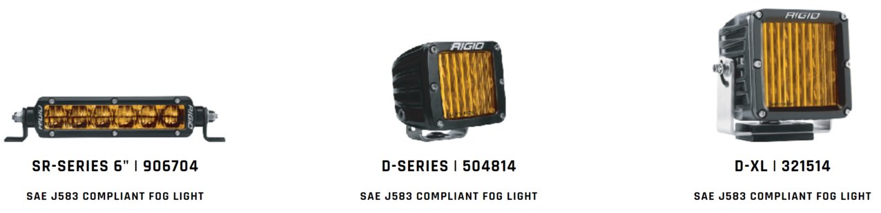

    Per Rigid's Engineering Director, they are doing a soft launch on the SAE selective yellow pods, the distributors are actually going to be selling them first. Rigid will start direct sales in roughly 2 weeks.

    Looks like 4WP jumped the gun a bit, Rigid isn't ready to ship the new selective yellow pods just yet. They will be this month, but the vendors cannot fulfill placed orders for a couple more weeks.

    I wonder if Rigid would sell just the yellow lens? I would think swapping the lens would be fairly straight forward. But I could be missing something

    As long as you are swapping the same optic, SAE fog to SAE fog for example, it is very straight forward. Opening the pod to do so would void the warranty, if that matters. You’d just need to be careful closing it up afterward to avoid leaks.
    I haven’t officially heard if Rigid will be making the lens available independently, I know others are interested in that as well.
