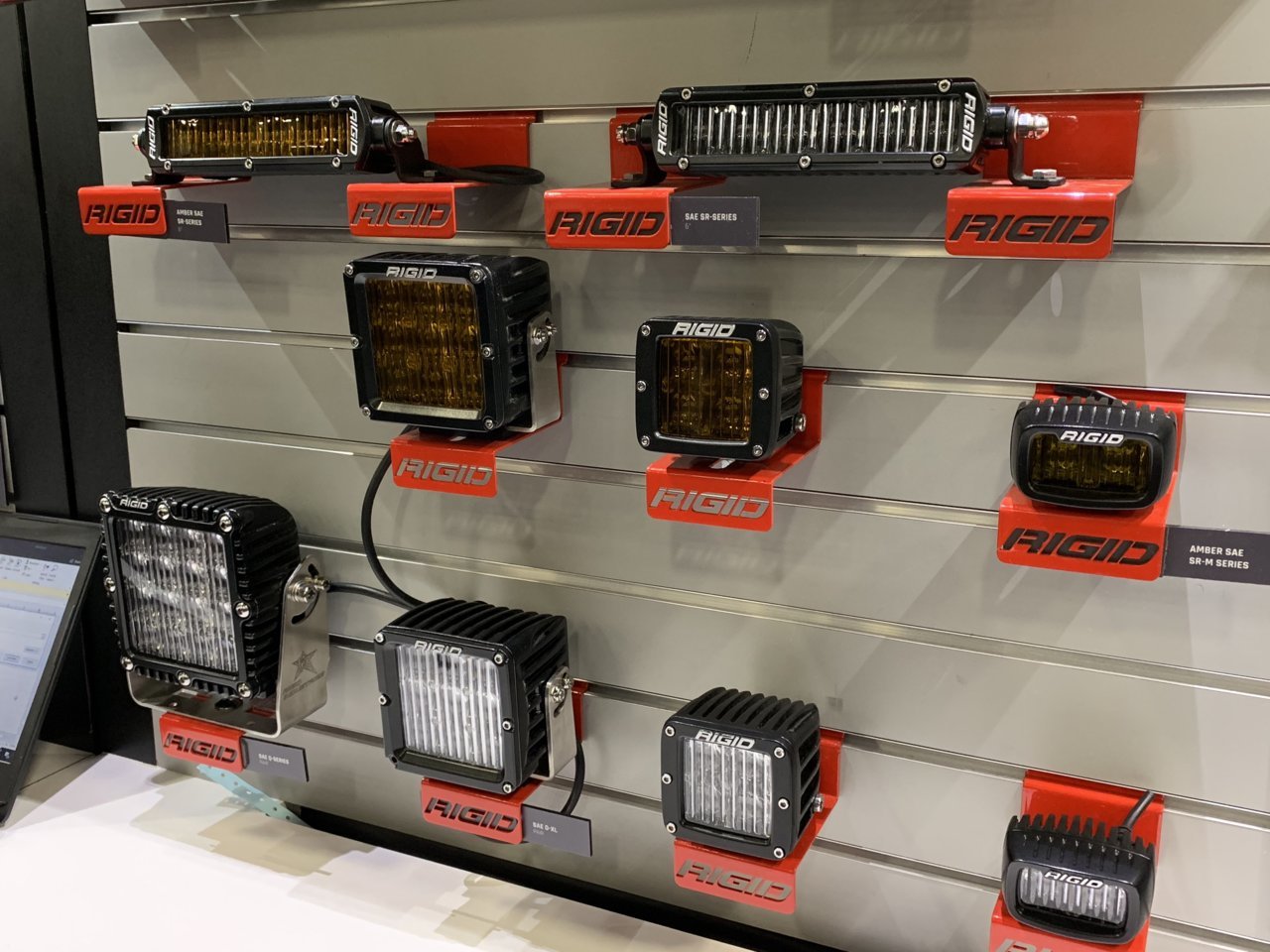

    Met with the Rigid guys at the 4WP Jeep and Truck Fest today. I talked with the same Rep I met with last year and got a bunch of good info.
    1) Rigid uses this very thread as mandatory new hire training reading for their sales staff!!! How cool is that!?
    2) There were design changes to the selective yellow SAE pods since the prototypes I tested. The new pods use different lower color temperature LEDs than their SAE white units, which is a change from the prototype that had just used the lens only. They could not hit the legally required chromaticy window with just the lens alone. Meaning the new lights will be a bit more yellow and have less green hue. This also means that just swapping the lens for those that have white SAE pods will likely not be an option.
    3) Rigid has some really exciting products coming in the pipeline. They are investing in the SAE patterns which is cool to see. As the rep put it, what's the point of buying all these nice lights if you cannot use them on the street. Having helped with the selective yellow lights, I got a sneak peak at unreleased pictures of product prototypes on their phone. Their next generation lights won't be pods or bars...
