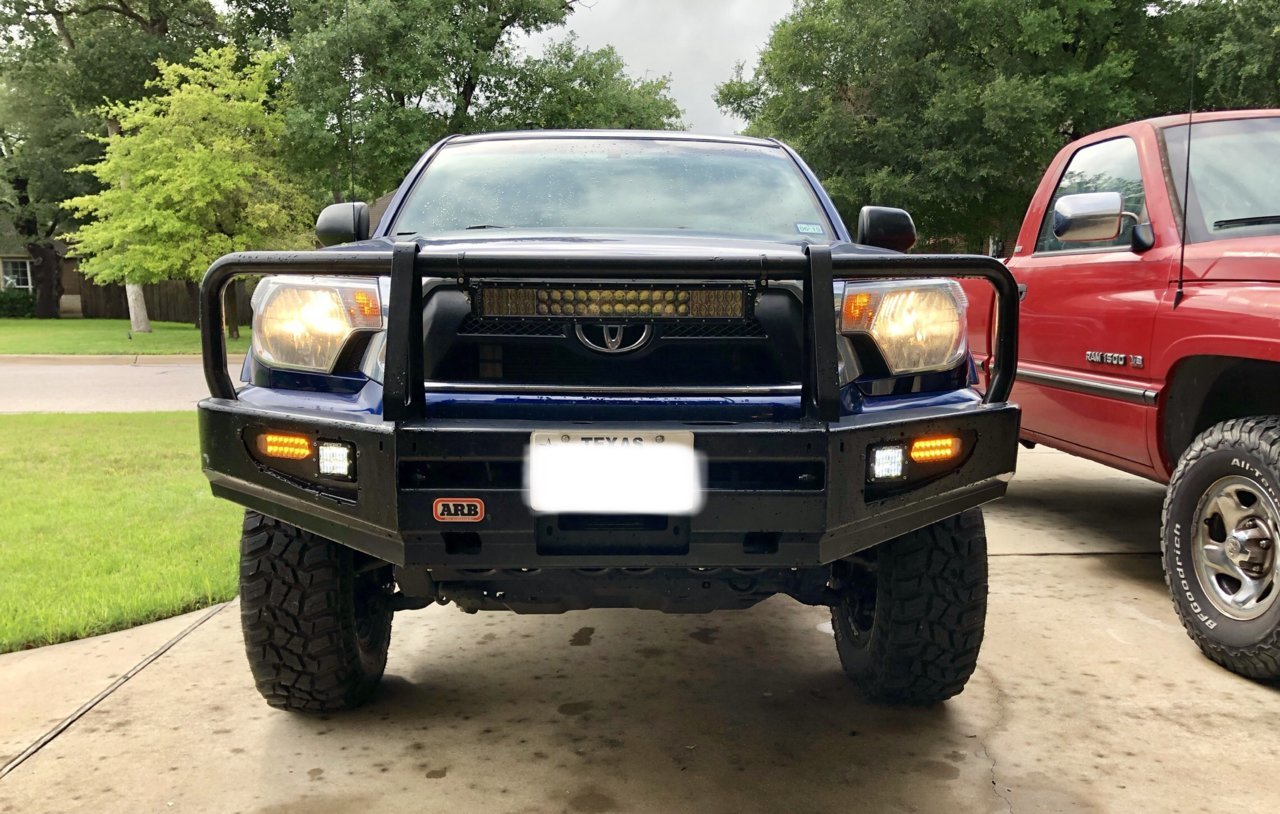

    So almost a year later from my earlier post and I got things installed in a way I like. I had called Rigid and they told me they don't put their SAE fog pods on flush mounts because that would make them unadjustable/aimable and thus not SAE compliant, which makes sense.
    I searched around and found some ARB bumper replacement inserts made by Slee Offroad in Colorado that would be compatible with the Rigid SAE fog pod mounts. I ordered a set from them and got them installed.
    Now that I've got my Rigid SAE fogs on and I can actually aim them I'm much happier with this setup than with my previous flush mount fogs setup.
    Edit: Thanks to crashnburn80 for the research and testing for this thread!

    With flush mount, assuming you had some small play around the opening and it wasn't completely flush, I would seem you could elongate the rear mount holes on the mount to tilt the back of the pod up/down a little, which would give some vertical adjustability. Would be a PITA to adjust though.
