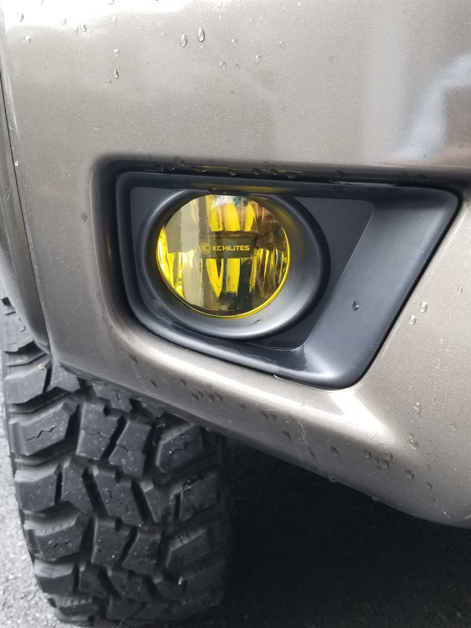

    This is how it is on my 4Runner. I know with the Morimoto mounts, they use the same part for Tacomas, 4Runners and possibly other Toyotas. The mounting holes on the 4Runner are slightly offset compared to the Tacoma, so I can only use 1 screw to mount the lights. Maybe KC does the same.

    Very true. Now that I remember, the stock housing on the third gens is 2 tabs on one side and 1 screw on the other. So I assume the KCs follow that. It seems pretty secure. With the Pods, the two "tabs" are replaced by screws instead and then another screw on the opposite side.

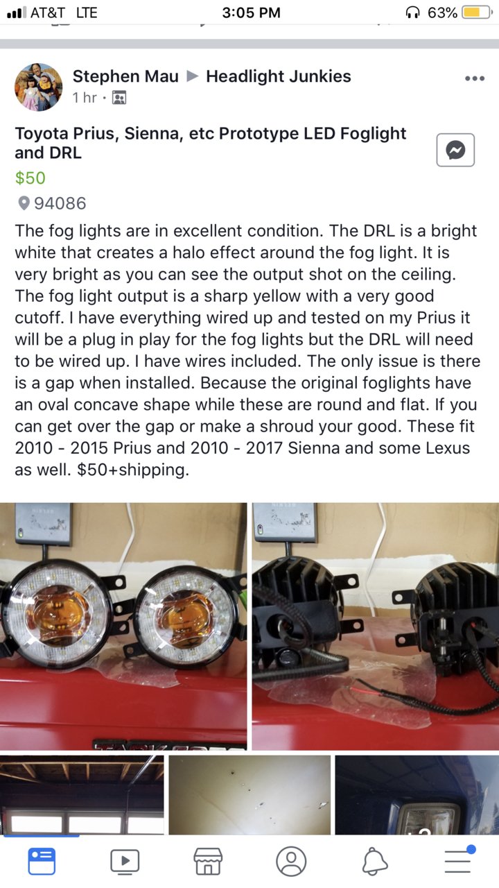

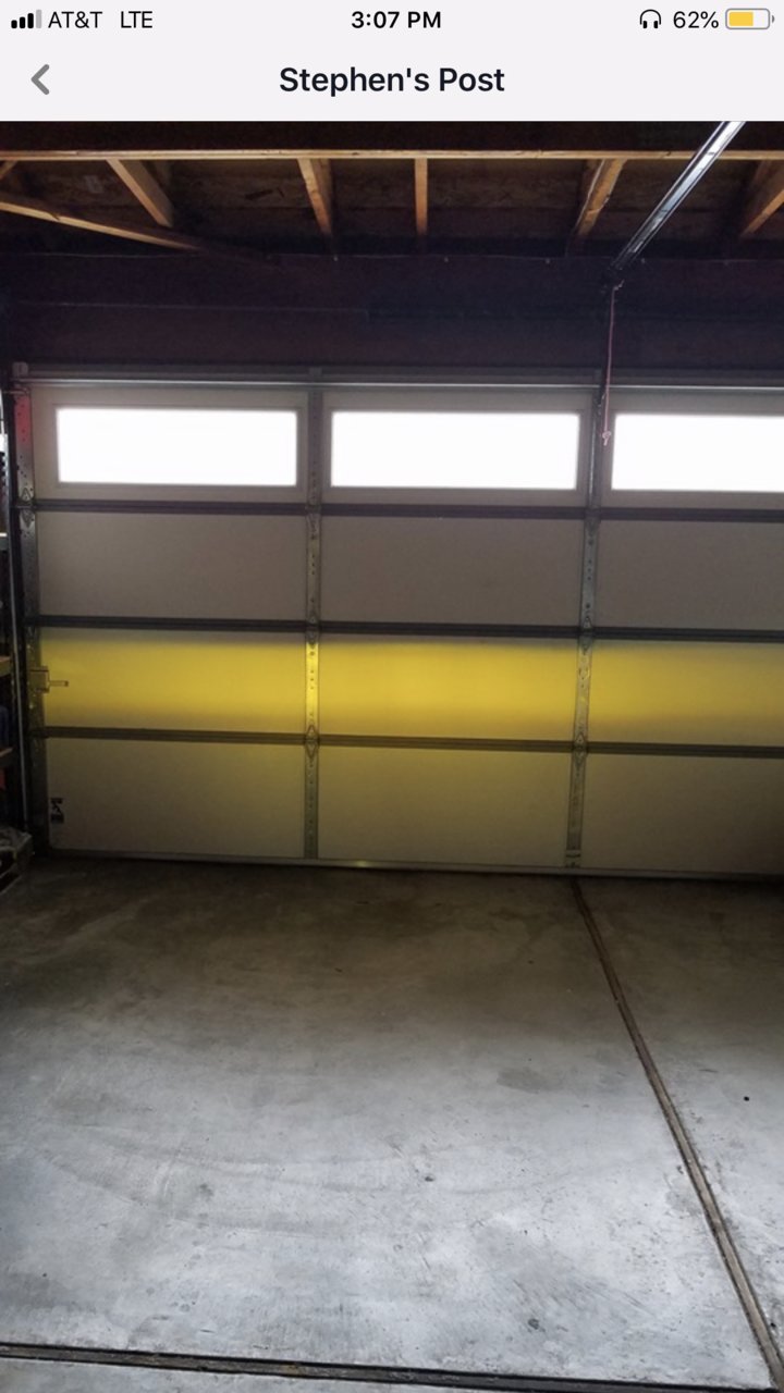

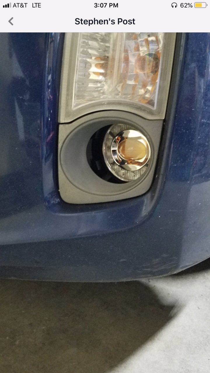

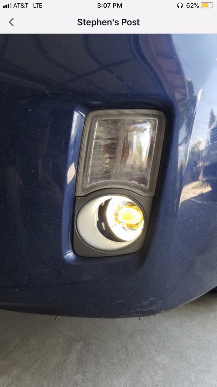

    check these out someone is selling wonder if they would fit a tacoma.

    Wow for that price just do some Dually's and put Hella Color Shieldz on them. That looks like that ugly orange color that comes from LaminX.

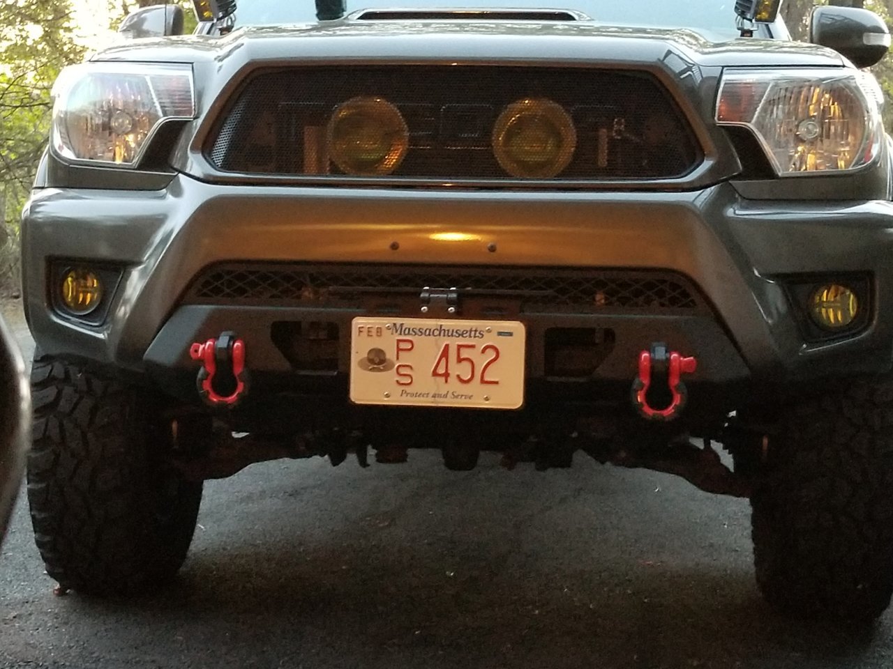

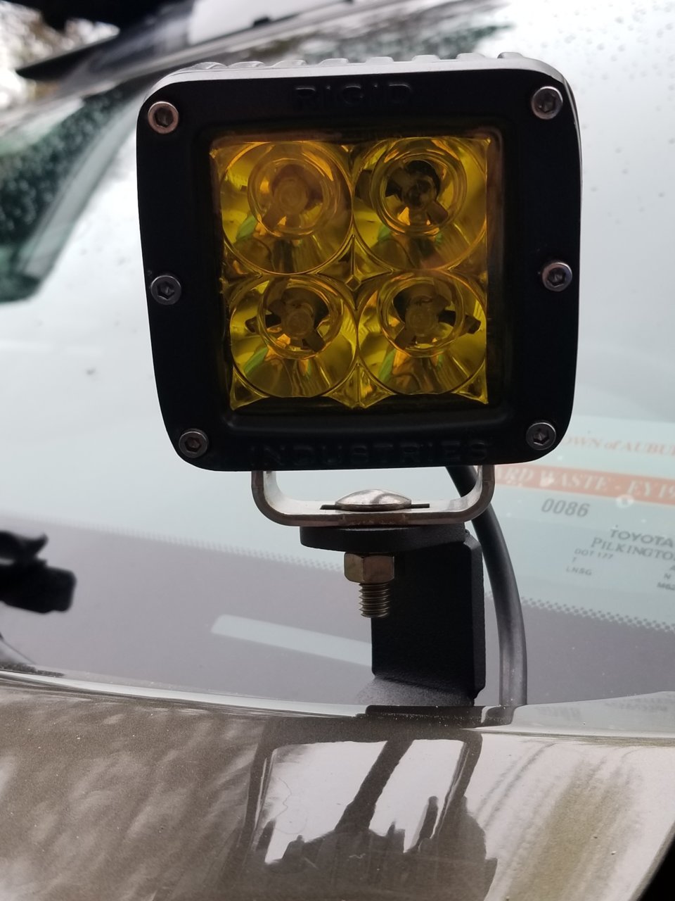

    Completely too it apart, removed the lens and put it all back together. 10 minutes a pop.

    They match the Hellas behind the grill, and the new KC G4's.

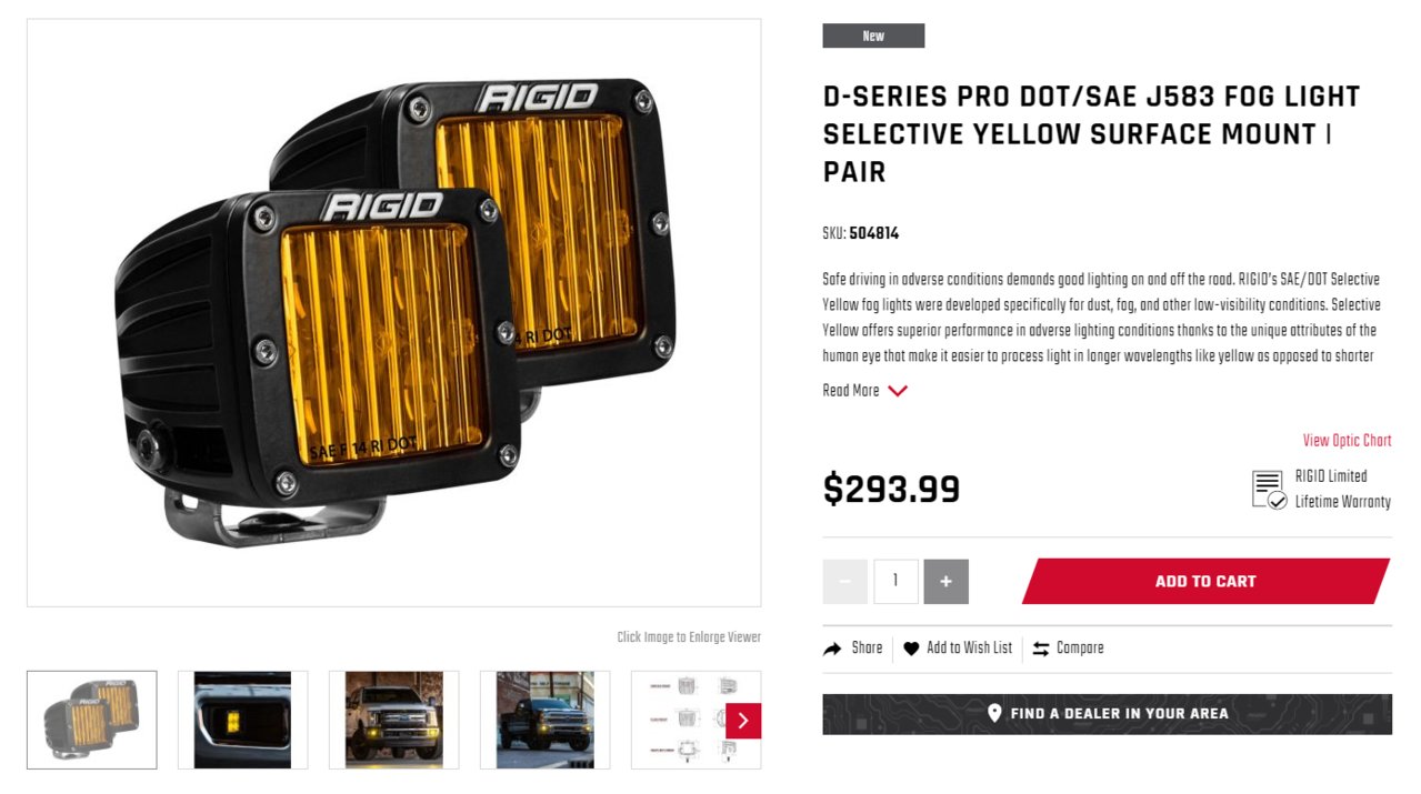

    They have been ‘available’ for order for maybe a month, but still not shipping. I have yet to recieve mine.
    The SAE selective yellow series lights have a real fog beam pattern with hard cut offs to work effectively in poor weather conditions and not blind other drivers, the other Rigid pods do not. They are the same price as their white SAE lights.

    Good to know, just yuck on the orange color. But I use my Dually's as Ditch Lights actually pointing at ditches.

    Yeah, different pattern for different purpose. The orange color is just the filter, the light output is yellow. The Hella filters on your Rigids are a good way to knock down the color temp out of that high temp bluish spectrum the white Rigids use.

    Indeed and those H3 Philips Night Breakers I put in the Hella 500's are amazing.

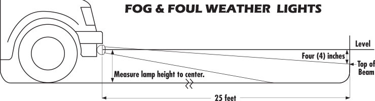

    Also I used the guide posted up in this thread for aiming as a double check and it was pretty helpful, so thanks for posting that up here! IMG_1063.jpg IMG_1051.jpg IMG_1053.jpg
